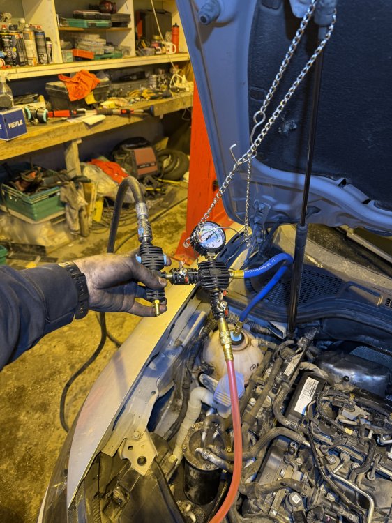

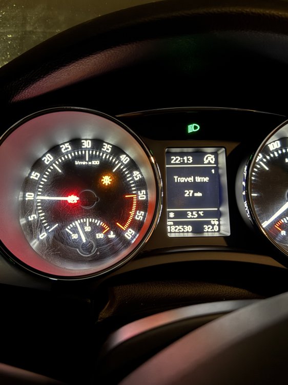

  5. Yes, im using 50/50 pemco 912+ I had a front wheel drive superb 2013 model. 2.0tdi CFGB 170hp version. Driven 311.000km. The temp gauge did not behave like this. This is not normal behaviour for this engine.
