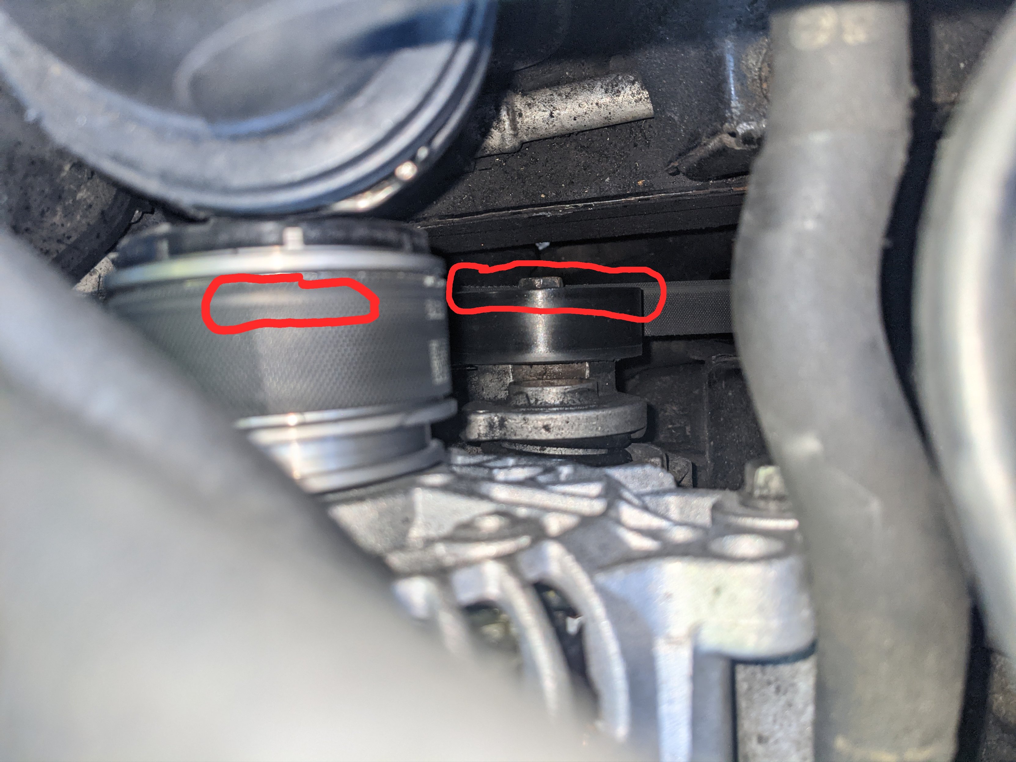

  1. I have a Sony MEX-BT3100U. USB and Bluetooth (although the USB can be flaky when connected to some devices) pretty happy with it though.
