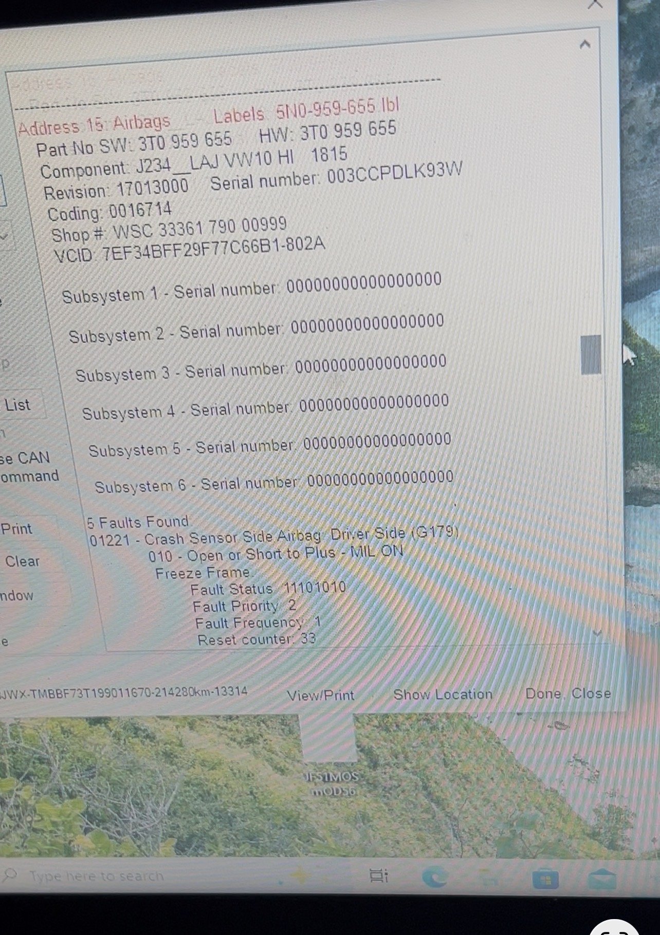

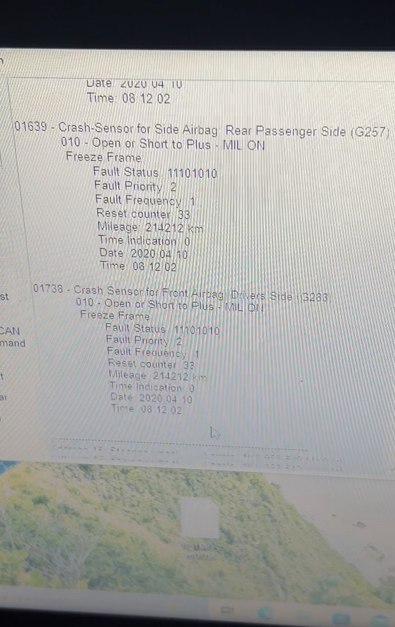

  1. Hi Pete, Thanks for this write up! I decided to take a punt and fire the parts cannon, changing the airbag module as it was only £14 on eBay for a used one. Was the same part number etc. Changed and all went away, verified with VCDS, all the crash sensor serial numbers came back etc. Did a few power cycles and ignition on and off and was fine. Checked with VCDS and again, all good. Looks like it had an internal fault or corrupted itself from one of the many potholes in the UK haha. Thank you
  2. Thanks for the reply Pete. I did check the drivers side (all ok), and I will passenger tonight. I removed the steering wheel airbag, all visually ok. Clock spring looks sealed and undamaged (all buttons and lights work) It is showing for all crash sensors, not just in the doors. Is the airbag loom or SRS system on a LIN network? The loom going into the module behind the dash on the tunnel is fine and undamaged.
  3. Hi all, My Skoda Superb 2 2008 TDI, whilst driving, popped up with an airbag fault. VCDS was connected and all of the crash sensor sub systems were showing “000000” Does anyone know what would cause this. I do not have VCDS but have a friend that does. Has anyone come across this or know where to start so that when they next come round we have a good place to start fault finding. Thanks all
  4. Hi all, Long term lurker (without account), first time poster. My partner (used to be my car) has a 2008 Superb 2 CBBB DSG SE spec. I’m wondering if the collective hive mind could help me, or the very least point me in the right direction? I’m getting multiple crash sensor driver and passenger faults in VCDS, indicated by an airbag MIL. Could this be a faulty ABS module due to crash sensor faults on passenger and drivers side? And the sub system serials showing “000”? Is there common issues or any known locations to look for? Could loom fatigue at the door hinge cause this? Though I can’t see both sides having the issues exactly at the same time. I will check behind the radio as that was removed and refitted about 11 months ago. Any input would be fantastic! Fault codes below Address 15: Airbags Labels: 5N0-959-655.Ibl Part No SW: 3Т0 959 655 HW: ЗТО 959 655 Component: J234_LAJ VW10 HI 1815 Revision: 17013000 Serial number: 003CCPDLK93W Coding: 0016714 Shop #: WSC 33361 790 00999 VCID: 7EF34BFF29F77C66B1-802A Subsystem 1 - Serial number: 00000000000000000 Subsystem 2 - Serial number: 00000000000000000 Subsystem 3 - Serial number: 00000000000000000 Subsystem 4 - Serial number 00000000000000000 Subsystem 5 - Serial number: 00000000000000000 Subsystem 6 - Serial number: 00000000000000000 5 Faults Found 01221 - Crash Sensor Side Airbag; Driver Side (G179) 010 - Open or Short to Plus - MIL ON Freeze Frame Fault Status: 11101010 Fault Priority: 2 Fault Frequency: 1 Reset counter: 33 Mileage: 214212 km Time Indication: 0 Date: 2020.04.10 Time: 08:12:02 01222 - Crash Sensor Side Airbag: Passenger Side (G180) 010 - Open or Short to Plus - MIL ON Freeze Frame Fault Status: 11101010 Fault Priority 2 Fault Frequency: 1 Reset counter 33 Mileage: 214212 km Time Indication 0 Date: 2020 04 10 Time: 08 12 02 01638 - Crash-Sensor for Side Airbag: Rear Drivers Side (G256) 010 - Open or Short to Plus - MIL ON Freeze Frame Fault Status: 11101010 Fault Priority: 2 Fault Frequency: 1 Reset counter: 33 Mileage: 214212 km Time Indication: 0 Date: 2020.04.10 Time: 08.12:02 01639 - Crash-Sensor for Side Airbag: Rear Passenger Side (G257) 010 - Open or Short to Plus - MIL ON Freeze Frame Fault Status: 11101010 Fault Priority: 2 Fault Frequency: 1 Reset counter: 33 Mileage: 214212 km Time Indication: 0 Date: 2020.04.10 Time: 08:12:02 01738 - Crash Sensor for Front Airbag: Drivers Side (G283) 010 - Open or Short to Plus - MIL ON Freeze Frame Fault Status 11101010 Fault Priority: 2 Fault Frequency: 1 Reset counter 33 Mileage: 214212 km Time Indication: 0 Date 2020 04 10 I also have odd faults with the central electrics too. The rear light is a dodgy cable to the very side light on the rear cluster and the front dipped bulb was replaced last week. Address 09: Cent Elect. (J519) Labels: 1K0-937-08x-09.clb Part No SW: 1K0 937 086 A HW: 1K0 937 086 A Component: BCM PQ35 M+ 020 0360 Revision: 00020000 Coding: 489B0AB8D861F1C040080084110081A407791BAE4320816 Shop#: WSC 25087 526 92301 VCID: 2E53BBBF79174CE661-807A Subsystem 1 - Part No: 3T2 955 119 Labels: 1KX-955-119.CLB Component: Wischer 15070 22 0602 Coding: 00D7B7 Subsystem 2 - Part No: 1K0 955 659 AH Labels 1K0-955-559-AG.C Component: RLS 240708 05 54 0402 Coding: 0730ED Subsystem 3 - Part No. 1K8 951 171 Component: DWA-Sensor 00 001 0104 Subsystem 4 - Part No: 1K0 961 605 C Component LIN BACKUP HO H03 1301 01134 - Alarm Horn (H12) 002 - Lower Limit Exceeded - Intermittent Freeze Frame Fault Status: 00100010 Fault Priority: 4 Fault Frequency 5 Reset counter: 62 Mileage: 211521 km Time Indication 0 Date 2020.04.10 Time: 18.15.54 Freeze Frame Term 15 On Voltage 10.45V ON ON Term 50 On ON ON 00985 - Right Tail Light (M2) 014 - Defective - Intermittent Freeze Frame Fault Status: 00101110 Fault Priority: 2 Fault Frequency: 100 Reset counter: 73 Mileage: 211937 km Time Indication: 0 Date: 2020.04.10 Time: 20:05:59 Freeze Frame Term 15 On Voltage: 13.40 V ON ON Term 50 Off OFF OFF 00446 - Function Limitation due to Under-Voltage 002 - Lower Limit Exceeded - Intermittent Freeze Frame Fault Status: 00100010 Fault Priority: 6 Fault Frequency: T Reset counter: 69 Mileage: 213616 km Time Indication: 0 Date: 2020.04.10 Time: 18:52:58 Term 15 On Voltage: 10.20 V ON ON Term 50 On ON OFF 00978 - Lamp for Low Beam; Left (M29) 010 - Open or Short to Plus - Intermittent Freeze Frame Fault Status: 00101010 Fault Priority: 1 Fault Frequency: 7 Reset counter: 65 Mileage: 213956 km Time Indication: 0 Date: 2020.04.10 Time: 15:17:19 Term 15 On Voltage: 13.85 V ON ON Term 50 Off OFF ON Thank you all
