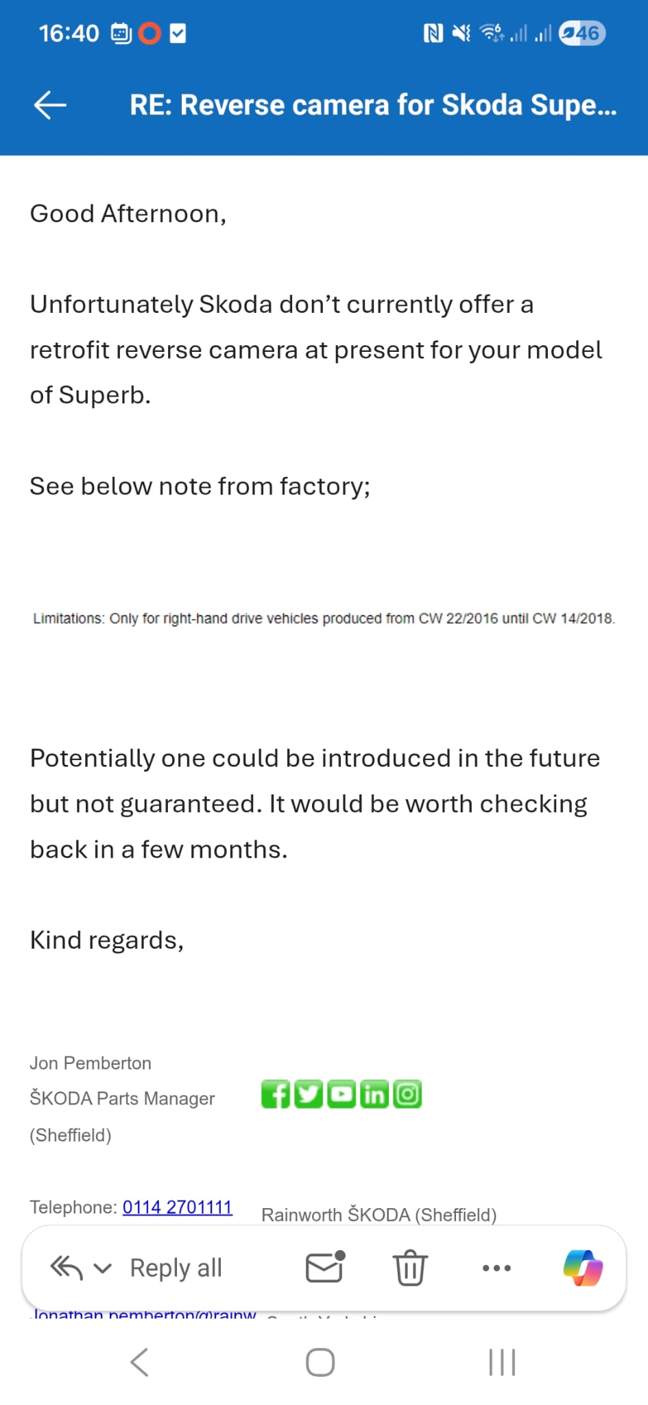

  9. Good afternoon all, We've just bought a '72 Superb Estate with the power tailgate. It's perfect, aside from missing a reverse camera. We've contacted our local dealer who say there isn't a retrofit kit for this model; they apparently only go up to 2018. If an official Skoda retrofit kit isn't available, is it possible to source used parts from wreckers/eBay and code them in? If so, would anyone happen to know the part numbers I need to look out for? I've seen a few kits on Ali* but they don't look compatible with the power tailgate. Pic for anyone interested. Cheers, Andy
