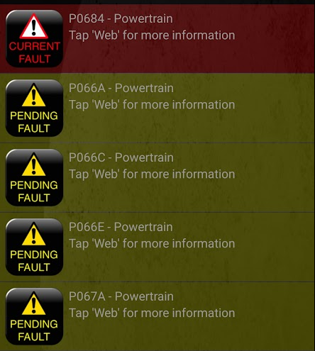

I appreciate similar questions have been asked once or twice, just I have additional codes. I'm seeing P0684, which would indicate I need to replace the glow-duration unit (04L907282B / 0281003085). Though at the same time I have pending codes for each of the 4 glow plugs - Control Circuit Low Voltage. I expect the module is causing the 4 pending codes but thought I would check in with folks more knowledgeable than me to make sure.
Thanks in advance.
