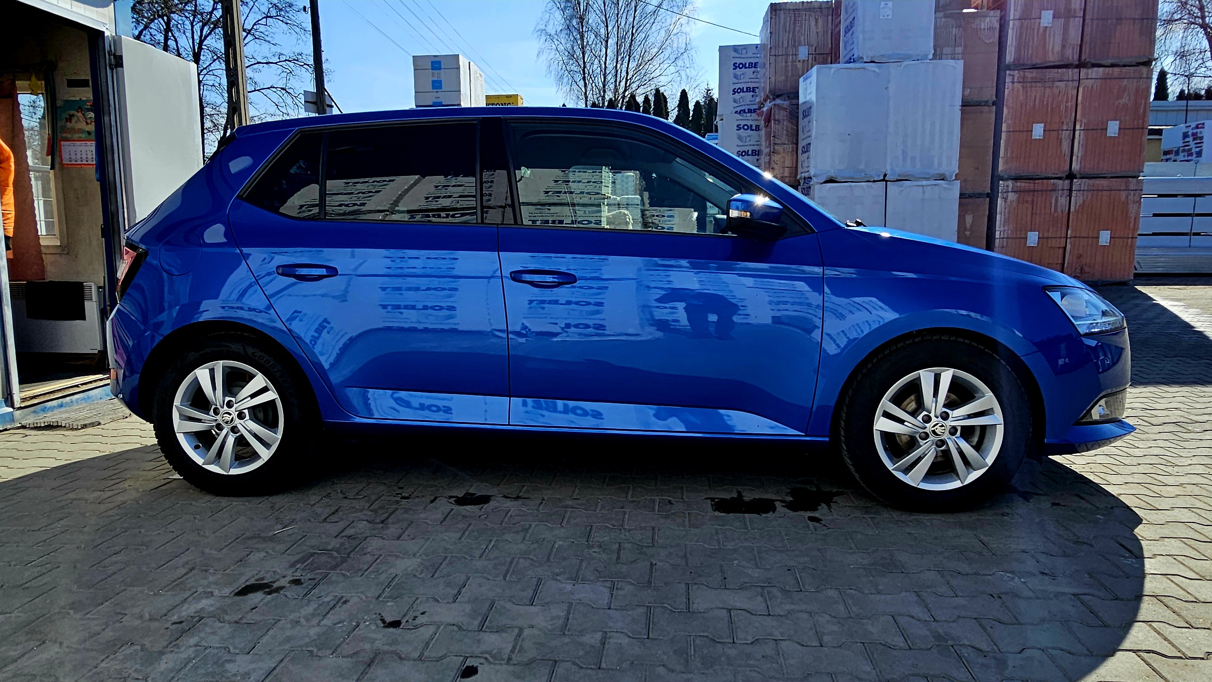

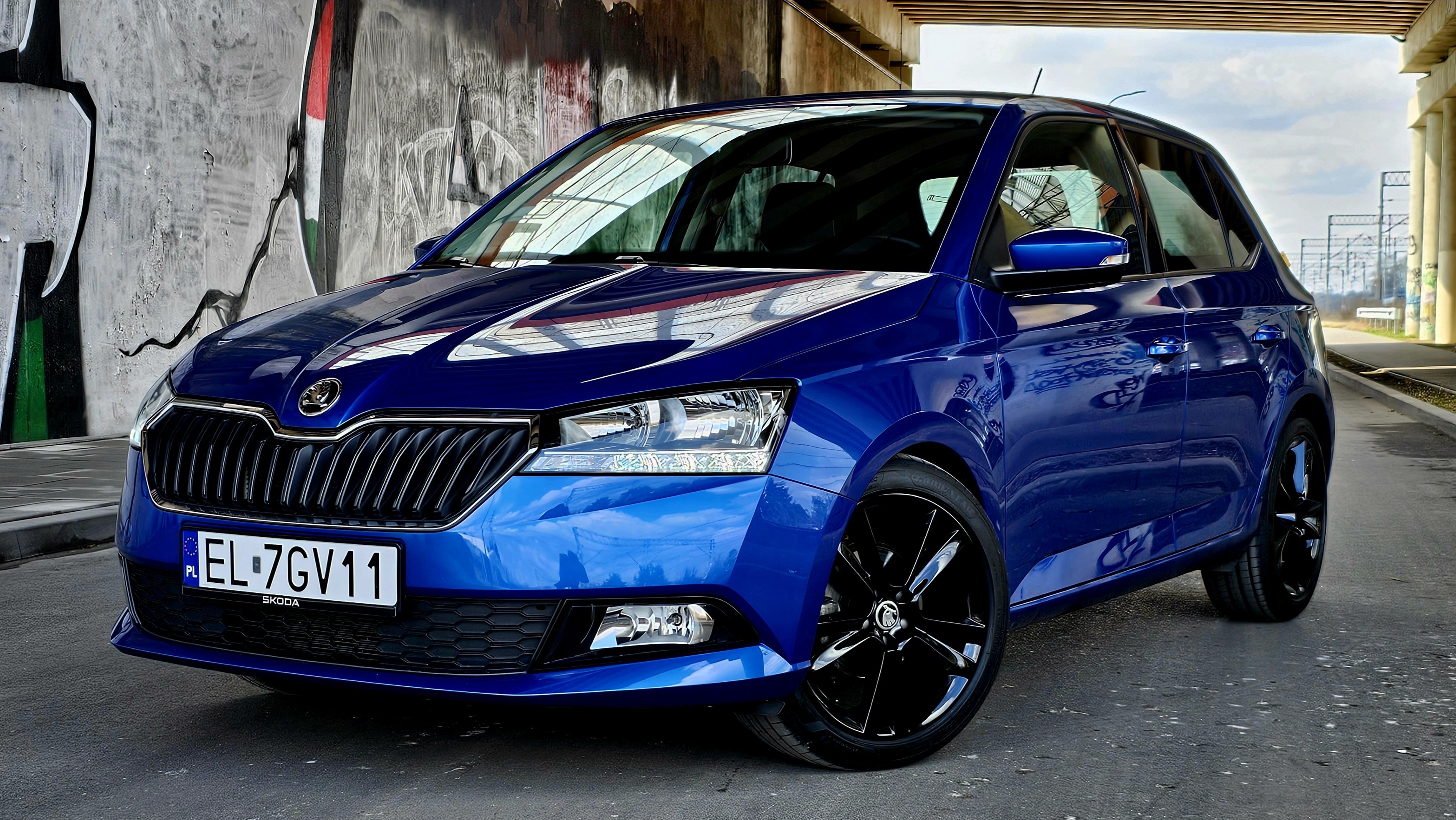

  1. Hi, I installed new shocks and springs on Saturday. The car sits exactly as I wanted. It's not too low. It's very firm, yet still manages to maintain a subtle level of comfort. For such a firm suspension, it's also exceptionally quiet. The suspension works perfectly, and the car handles wonderfully, even with 185/65/15 winter tires. I have a front suspension alignment scheduled for Wednesday at 10:00 AM, if needed. I also ordered new summer tires today. I chose Goodyear Eagle F1 Asymmetric 6 tires in size 215/45/17.

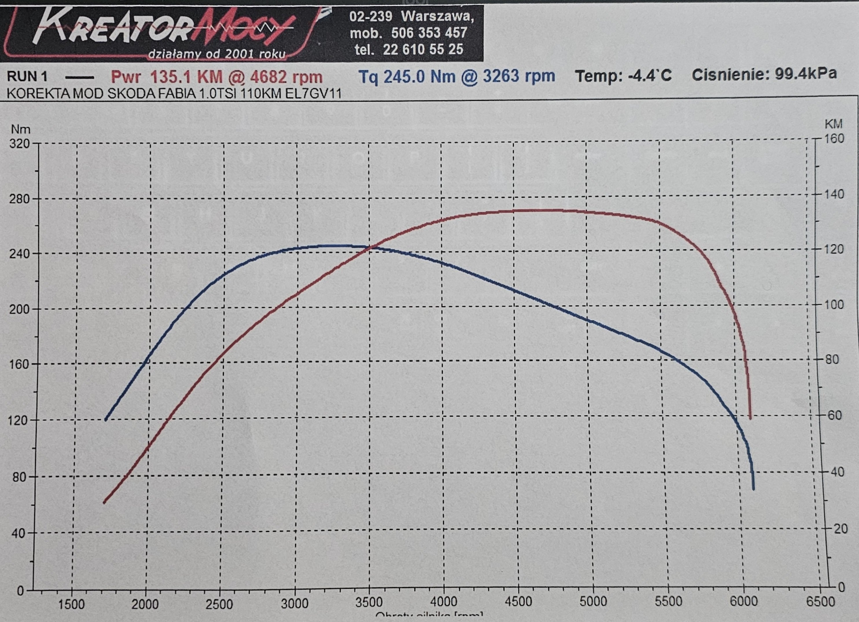

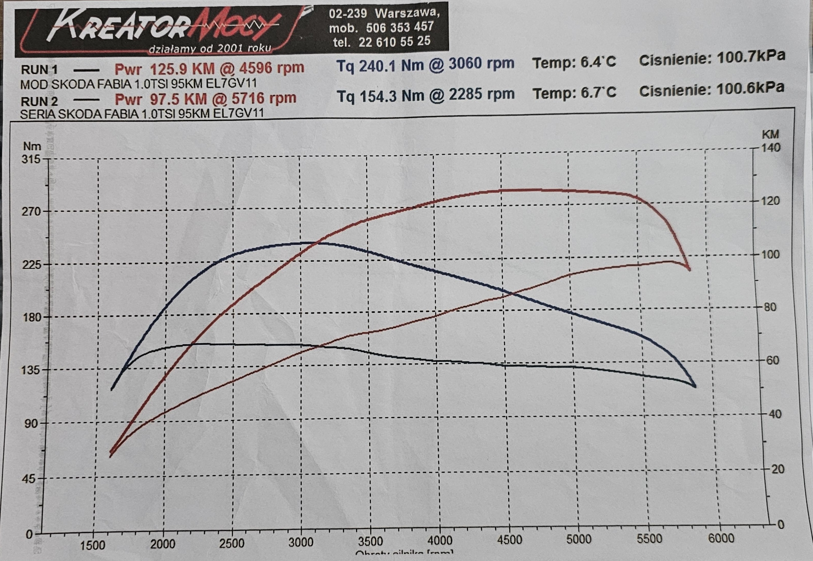

  4. Today I went to the dyno to further improve the engine's performance. The final result was 135 horsepower and 245 Nm. Now the Fabia is pleasantly fast. Below are the dyno graphs. First attemp Today's result

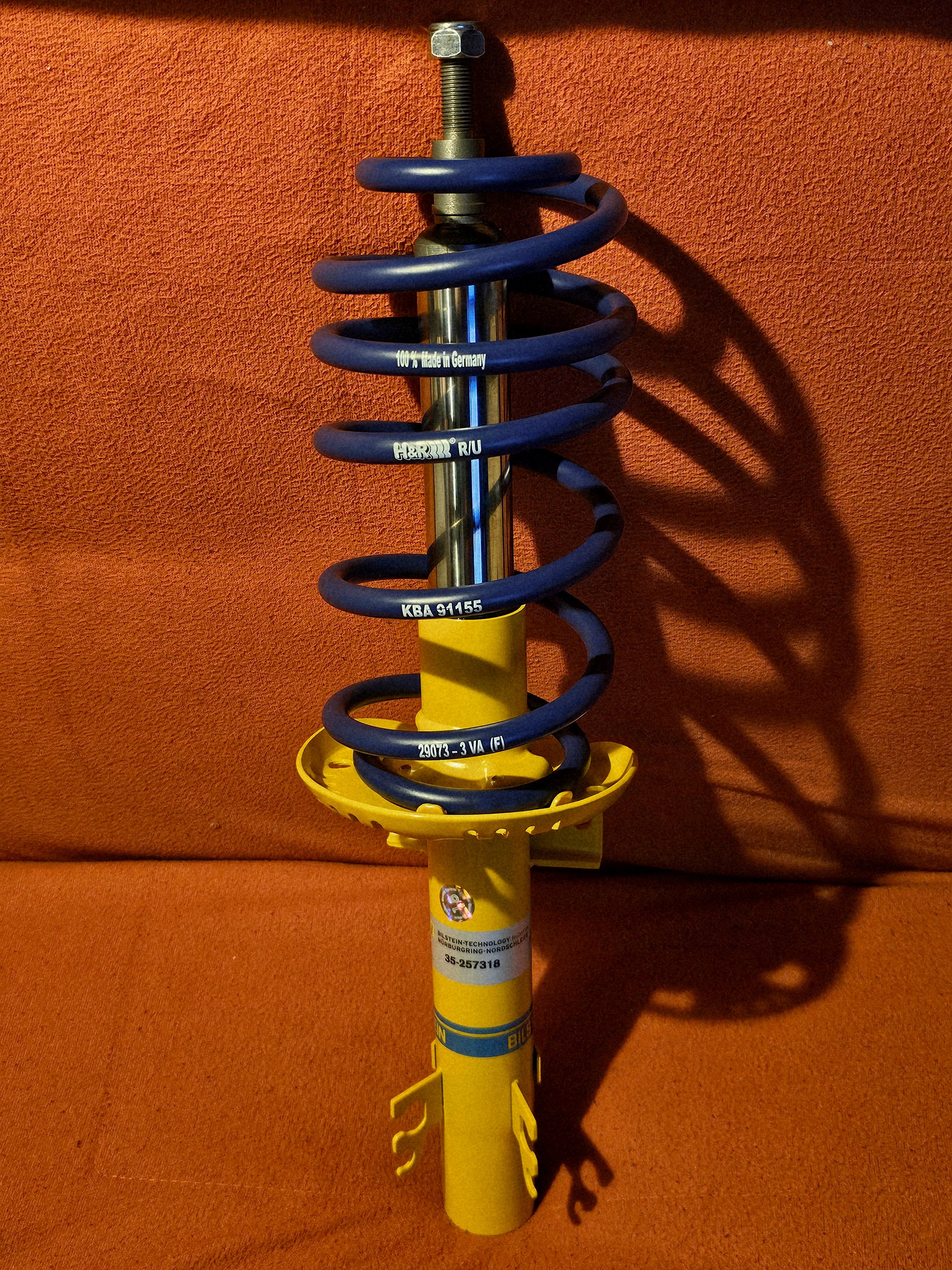

  7. The shock absorbers arrived today. This is what it looks like with the spring. I can't wait for everything to be installed. I'll have to be patient. We're having a real winter here with heavy snowfall.
