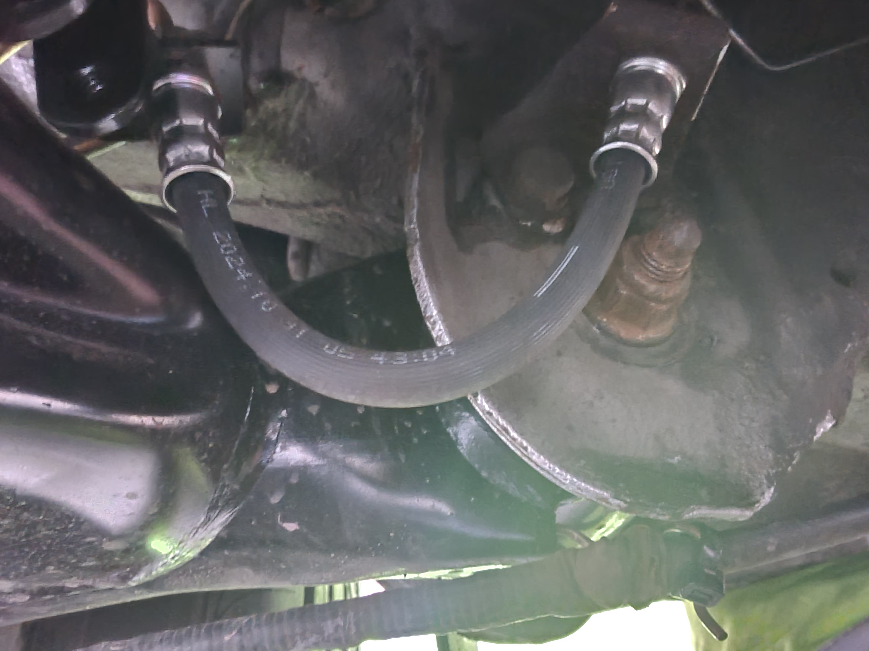

  2. Hi, everybody just an update on the brake hose problem. Job all done now, finished up with a rear hose for a Audi A2 it's a febi billstien, 215mm long part number 23158. Has same ends as original hose So if anyone else has this problem I hope this helps them. Here's new hose in place.

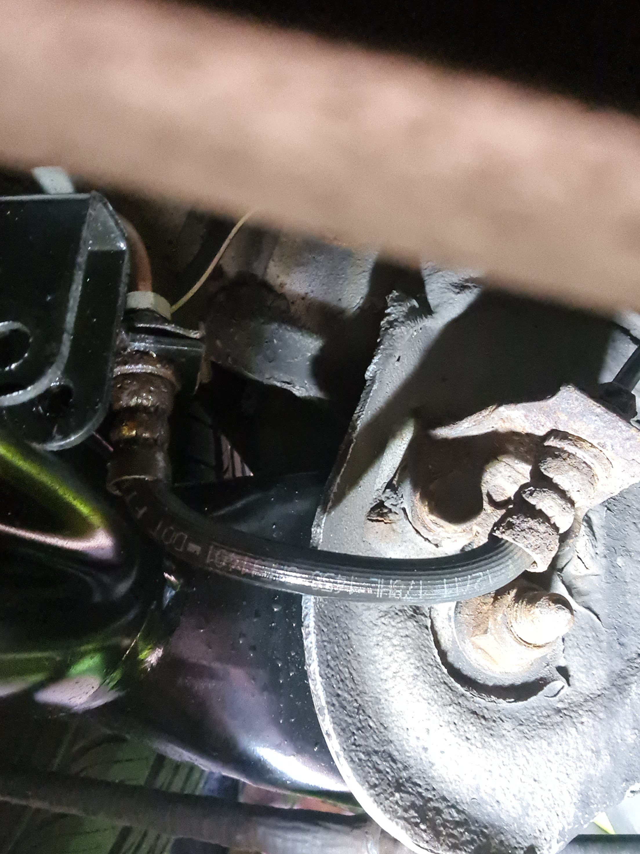

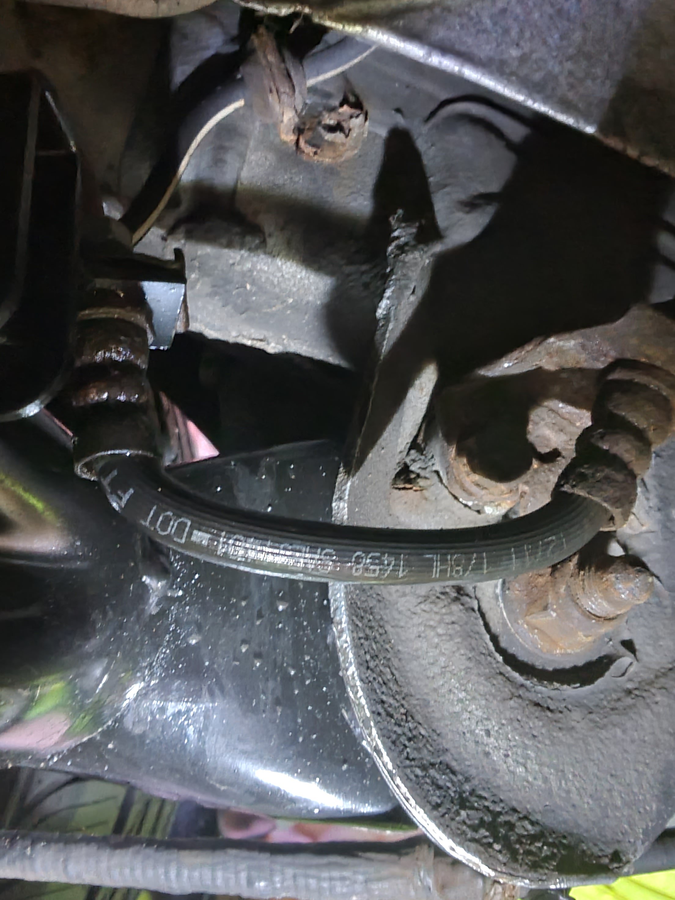

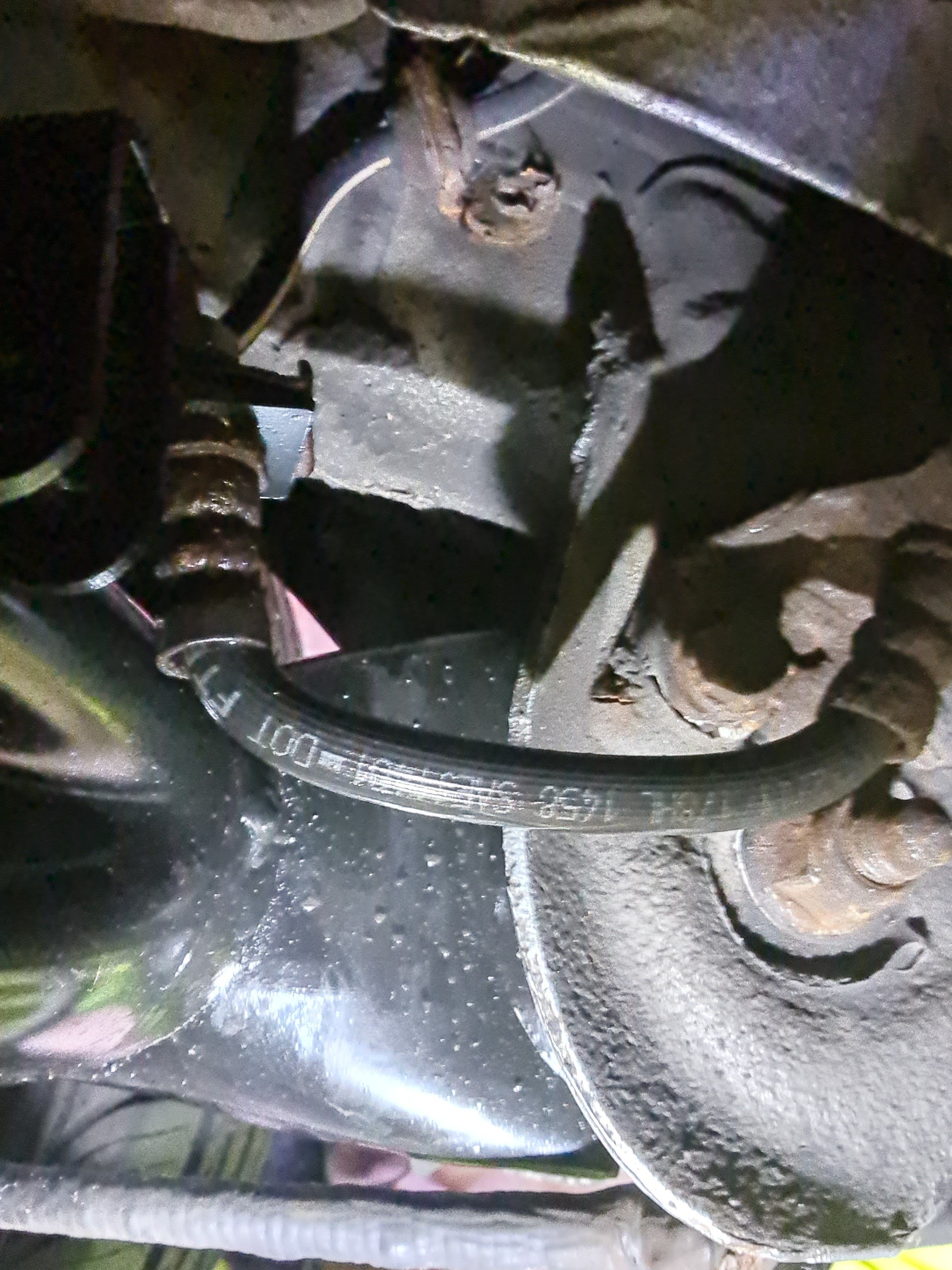

  4. Yep,the original in the picture is168mm which is the correct one for the car from new ( I have measured it ). I've researched loads of brake hoses you would think it would be easy to find, but not so easy. So like I've said audi a4 hose is 208mm which will give me 40mm extra length and the yeti one is hopefully 244mm (not all are) which is 76mm extra so when it's on the ramp they have to be offered up to see which is best. Surprisingly mk4 golf rear hoses are same as fabia 168mm The original hose on the original axle only has a slight u bend in it for flexing so well see. My car has drums so only one hose each side. Thanks for your input.

  6. You obviously haven't read all posts! The axle fitted is from I'm axles, the proper one for the car. The issue is the nearside brake hose bracket has been manufactured short which has caused the problem of the original brake hose being stressed hence I'm now left with the job of finding a slightly longer brake pipe to rectify the problem. Please read all the posts relevant before jumping to conclusions that are total unfounded.
  7. No just the rear brake hose because the new skoda rear axle hose bracket is slightly wrong, have you read previous posts? Fitting an audi a4 axle not for me.
  8. Unfortunately no good both ibiza 6j and polo6rc front is massively to long and rears are shorter than in my picture. I have found one from audi a4 rear at 208mm long one in picture is 168mm long. Also waiting on skoda yeti rear at 244mm long so things are looking promising.
  9. Hi all, just an update on my axle woes. Axle from I'm axles now fitted by my garage i use but not without a few problems. When said axle arrived I opened up packing and noticed some of the shock mount welds were a bit questionable and contacted I'm axles, they replied saying all there axles were the same but said I could have a refund but by this time it was only 4days till it was to be fitted so decided to leave it at that and thought maybe I was being over cautious. So it was duly fitted and on collecting car the mechanic said although it went well the nearside brakehose bracket didn't seem right and now the hose was a bit tight. (See pics ) So I contacted them again with pics and voicing my concerns to which they replied bend the bracket to release the tension. That could of been done on the offside bracket if needed but the nearside is a much beefy thing with a very short tab on it which bending wouldn't of helped as it's 40- 50mm to short. So I'm now trying to find a brake hose that's slightly longer than the original which will sort it. I've replied to them stating the safety issues of this, they recon there selling approx 10 skoda axles a day and never heard of this before so maybe I got a Friday afternoon axle who knows?
