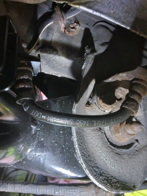

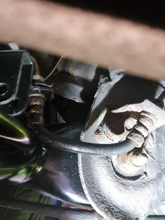

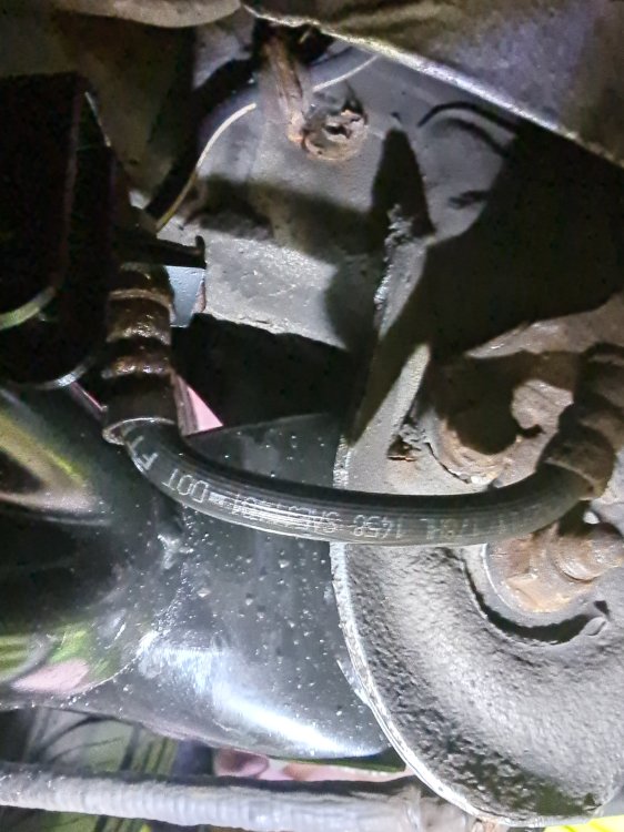

So it was duly fitted and on collecting car the mechanic said although it went well the nearside brakehose bracket didn't seem right and now the hose was a bit tight. (See pics )
So I contacted them again with pics and voicing my concerns to which they replied bend the bracket to release the tension. That could of been done on the offside bracket if needed but the nearside is a much beefy thing with a very short tab on it which bending wouldn't of helped as it's 40- 50mm to short.
So I'm now trying to find a brake hose that's slightly longer than the original which will sort it.
I've replied to them stating the safety issues of this, they recon there selling approx 10 skoda axles a day and never heard of this before so maybe I got a Friday afternoon axle who knows?

Any chance someone could have put a different flexi on it before? I'll get a pic of how mine sits in a bit.

Yep,the original in the picture is168mm which is the correct one for the car from new ( I have measured it ). I've researched loads of brake hoses you would think it would be easy to find, but not so easy. So like I've said audi a4 hose is 208mm which will give me 40mm extra length and the yeti one is hopefully 244mm (not all are) which is 76mm extra so when it's on the ramp they have to be offered up to see which is best. Surprisingly mk4 golf rear hoses are same as fabia 168mm
The original hose on the original axle only has a slight u bend in it for flexing so well see. My car has drums so only one hose each side.

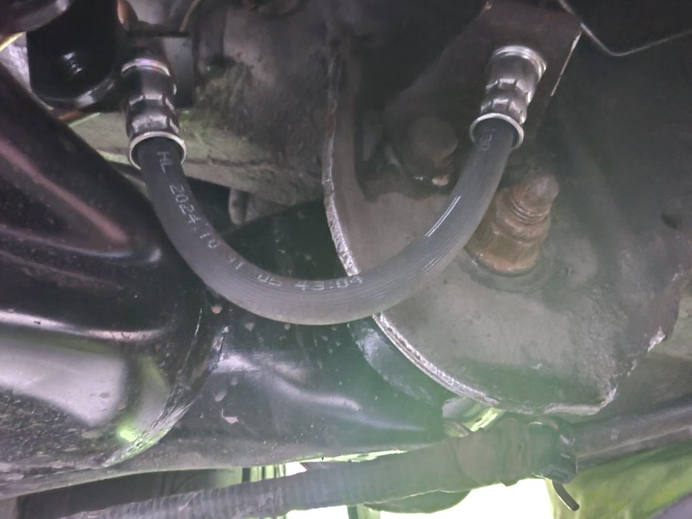

Here's new hose in place.
Glad you got it sorted. That looks a lot better. Remember to write that part number down somewhere for future ref.
