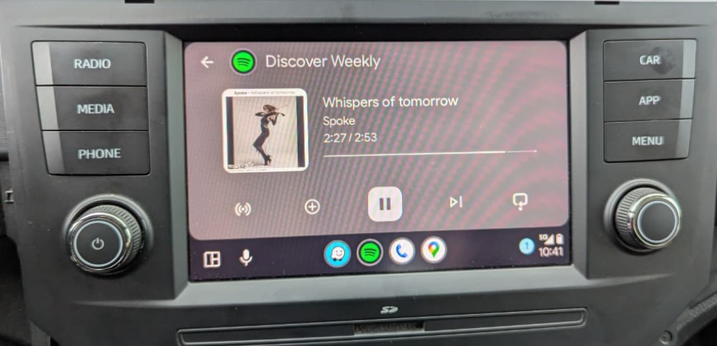

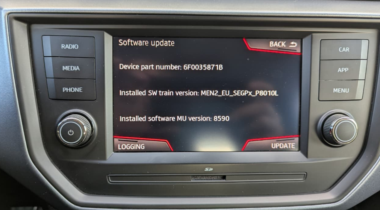

  3. Hello guys, I would like to share my experience specifically the Seat Arona MEN2_EU_SEGPx_P8010L unit. As of my knowledge all VAG cars from 2017-2022 that have a similar looking unit with an APP button are produced from LG meaning that can be patched with this method. Removing the unit first you must remove the trim and Seat doesn’t make it easy, there is a T10 bolt on the passenger side that you must remove first, hidden behind the plastic that has the airbag key disabler. The programmer was a pain in the ass with windows 11 i had to sail seven seas to make the drivers work. Opening the unit was easy, attaching the clamp not so much, after trying for so long I gave up as the clamp head became dull and wasn’t staying in place anymore. As of my experience the board tries to power itself and the programmer shuts down. I had to desolder chip patch it and resolder. That thing is tiny if you don’t have the right equipment don’t even try If you are not handy and don’t have all the required tools don’t even try it it’s not worth destroying the unit or having squeaky trim living in your head rent free 😂. Using android auto/ car play not that much of a must have upgrade, these are wired only meaning that you must connect via usb, using a wireless dongle to replace cable is possible but be prepared beat the **** of your smartphone battery it drains like crazy.

  5. Hello, Many thanks for the guide. I stumbled on this guide some days ago searching for something similar, since i don't have a Skoda but a 2019 Seat Arona with similar head unit MEN2_EU_SEGPx_P8010L. Can this patch work for this unit too?
