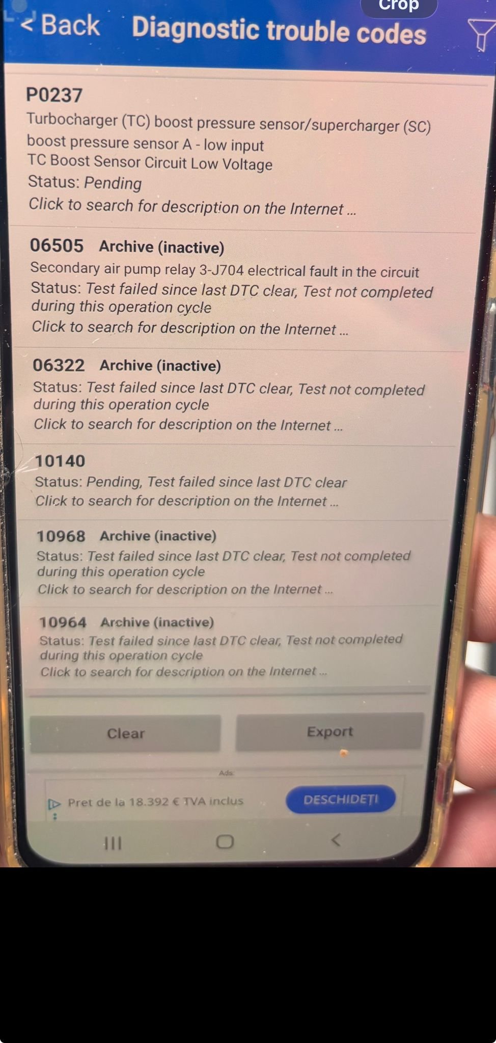

  9. So these are the errors from a scanner, idk how accurate they are because it was not a professional scanner, does it have something to do with the starting fault?

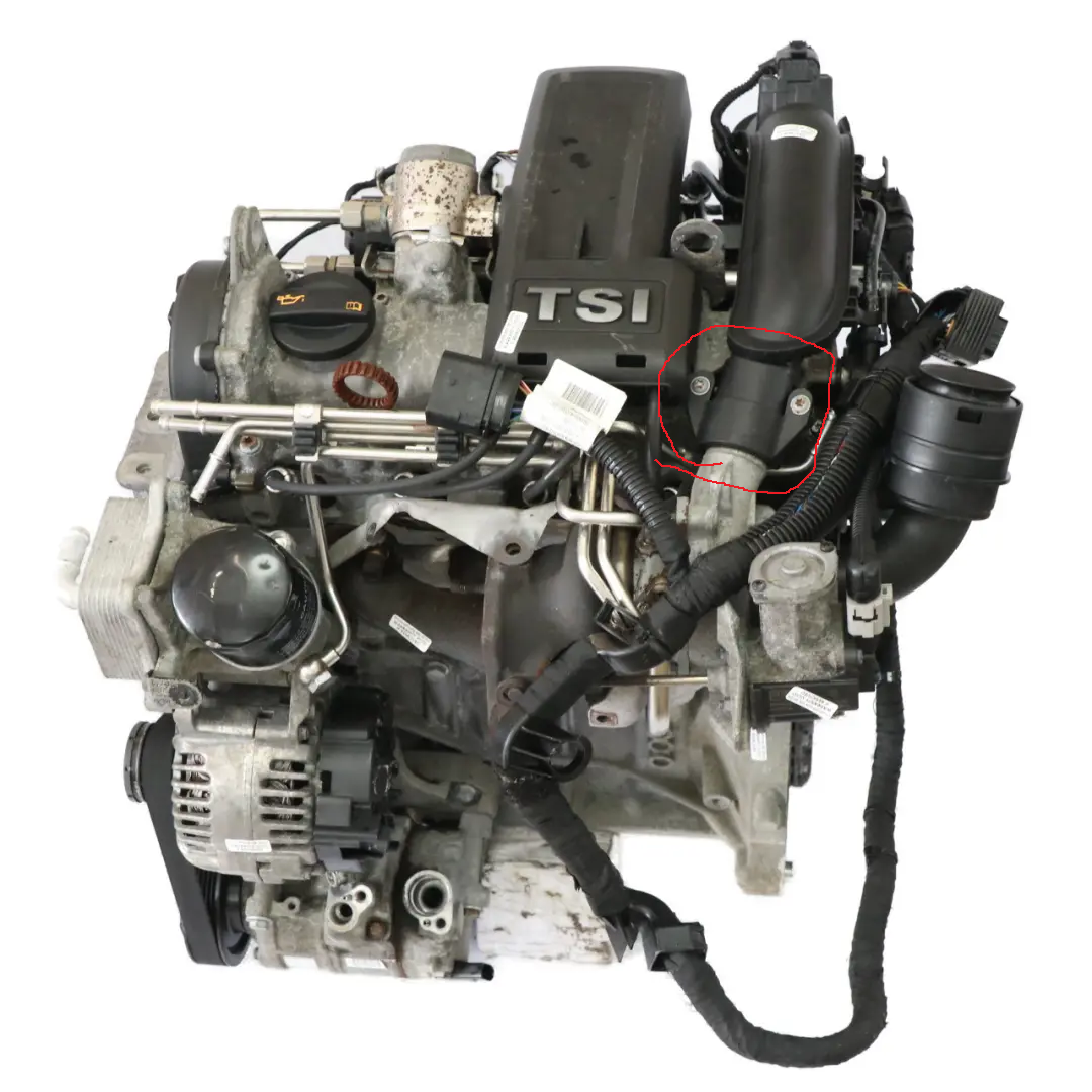

  10. Thank you, can you give me a reference to where the MAF sensor is placed?
