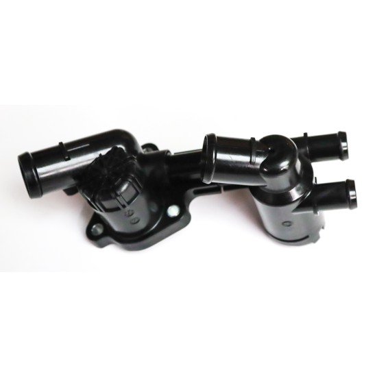

Hi, i have a Skoda octavia 2, 1.2 TSI, CBZB and I had problems with the old thermostat: the engine was warming up very slowly and barely reached 50°C, and the radiator fan would turn on even when the temperature didn’t go above 50–60°C.
I replaced it with a Topran thermostat, but now the symptoms are similar. The engine doesn’t go above 70°C, it reaches that temperature very slowly after long driving, and if I stop accelerating, the temperature drops.
The radiator fan does not turn on, but the hose going to the radiator is hot. Is it possible that the new thermostat is also defective, or could there be another cause?

Sorry if its an obvious question but did the Topran one come with a thermostat actuallyfitted. I see them online but its the casing only unlike the Febi one that has thermostat included/fitted. Also read that the temp sender in thermostat on topran can cause problems sometimes with turning on rad fans.

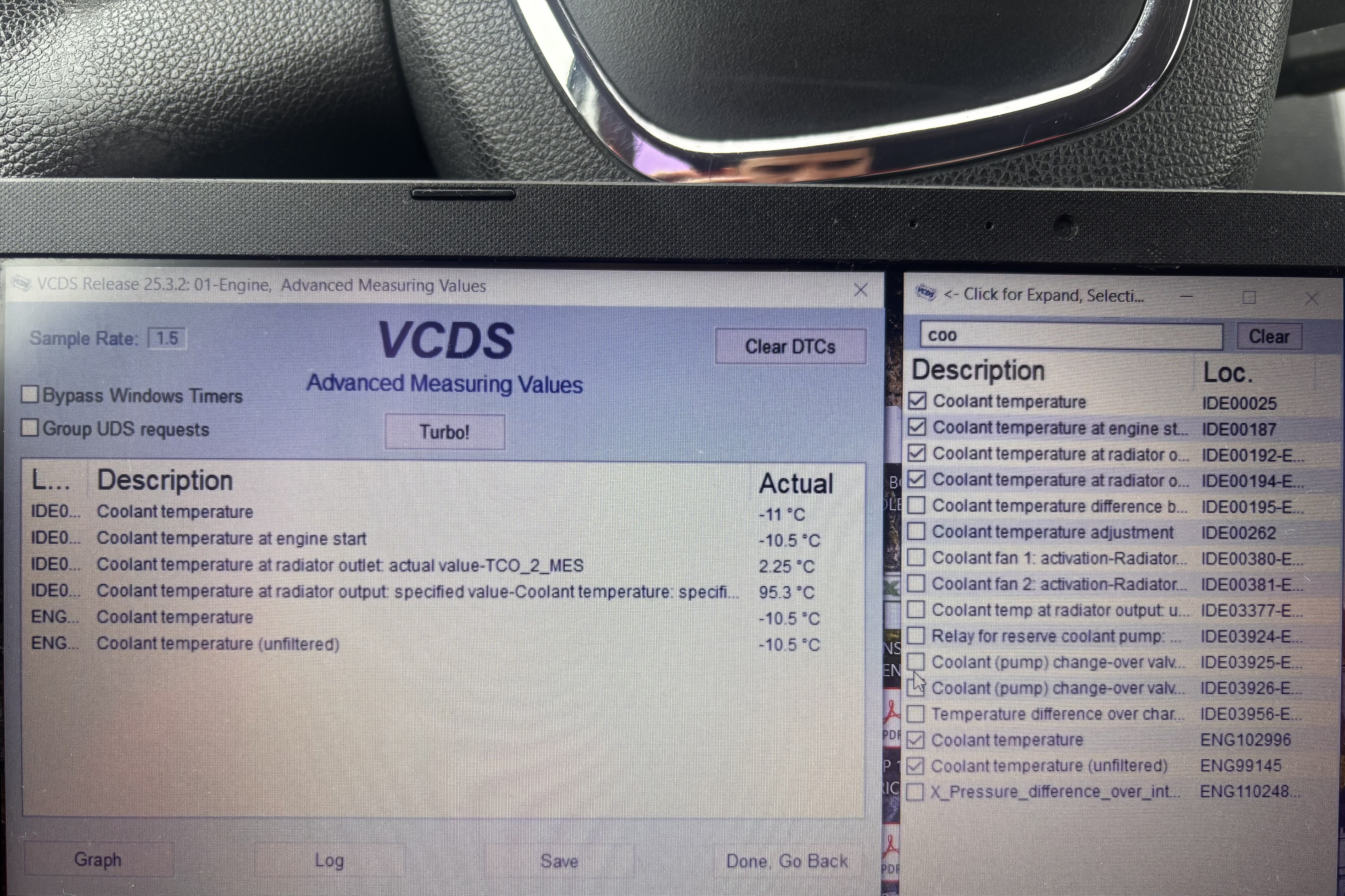

I found out that the coolant temperature sensor is faulty, showing -11 degrees with 2 degrees outside. But that should not be a problem because the thermostat is 100% mechanical, right?
Yes, and no, a faulty sensor will have no effect on the stat's opening temperature, but one would think that the coolant display should have stayed "permanently" below 50C as I presume it uses the same sensor.
If those VCDS readings were taken with the engine idling then the 95.3C Rad outlet doesn't tell a awful lot because the stat, even if working perfectly, will normally (eventually) go full open while idling and the radiator fan will cut in/out.
Replacing that sensor will tell alot if VCDS still available to you.
I looked at that VCDS incorrectly, the rad coolant outlet was apparently 225C, 95.3C might be the temperature which starts the radiator cooling fan, but if the coolant was 225C then the equivalent (saturation) pressure is > 25bar but the cooling system PRV lifts at ~ 1.5bar so don't know what's going on there.
Clearly, 225 deg.C isn't possible without the coolant system venting - so there is at least a sensor issue to address.

It says 2.25C, I think.
Which may be consistent with no flow through rad at that stage.
So radiator outlet temp sensor probably OK, main engine one not so good.
Edited by Breezy_Pete
You're right re the 2.25C but the stat should still operate normally?. I'd like to know what this 95.3C "radiator output specified value coolant temperature" refers to, is it the (a) actual radiator outlet coolant temperature.
Edited by Johngerard

I'm not sure that the thermostat was ever misbehaving. If the engine ECU was getting unreliable temperature info, it can't control things correctly.

Just came across this on some VCDS website...
IDE00025 Coolant temperature 85 °C
IDE00192 Coolant temperature at radiator outlet: actual value 55.2 °C
IDE00194 Coolant temperature at radiator output: specified value 90.0 °C
ENG105382 Coolant temperature 85 °C
ENG106503 Coolant temperature at radiator outlet 85 °C
The problem was at the coolant temperature sensor, i changed it and now works good.
