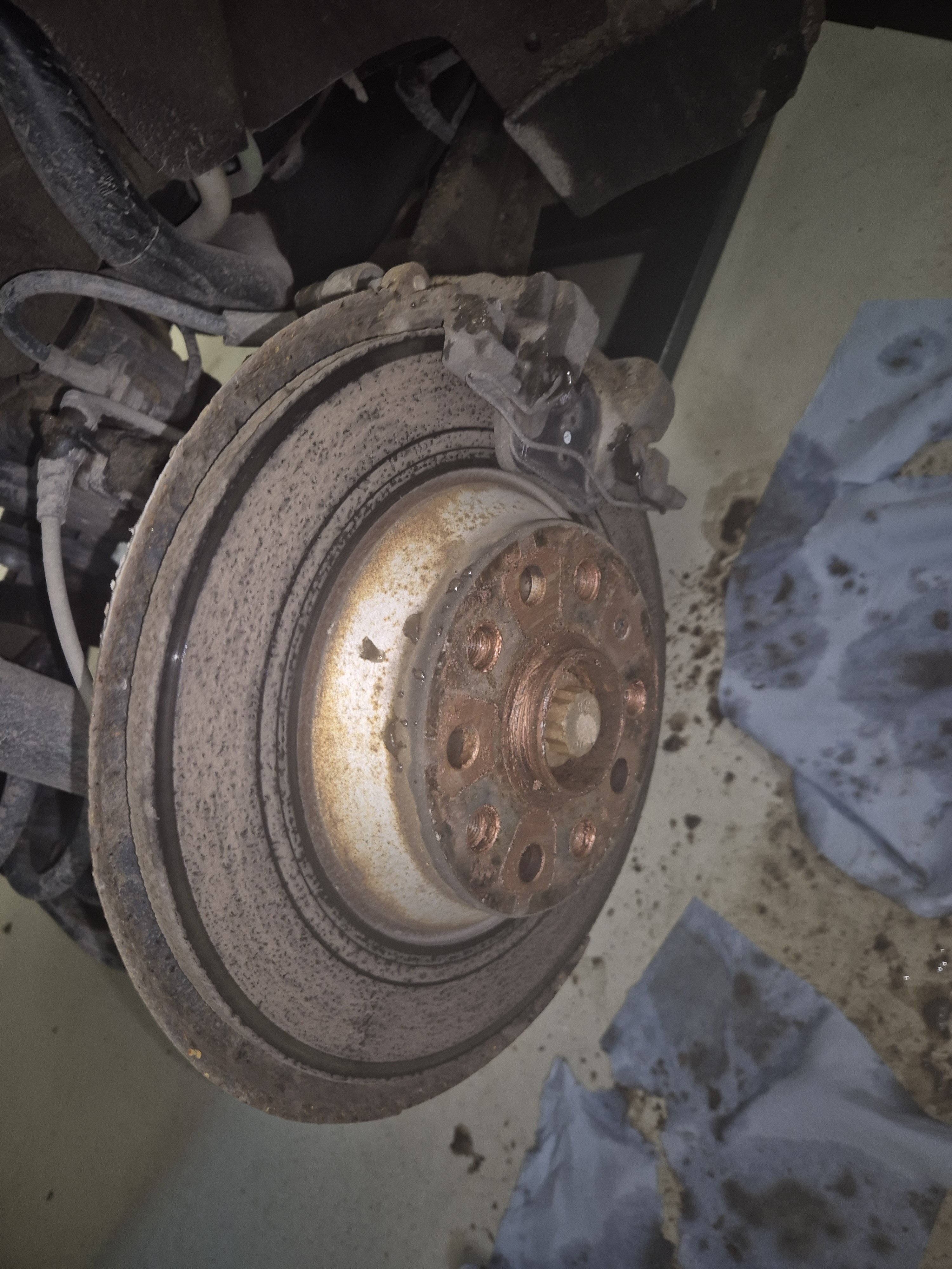

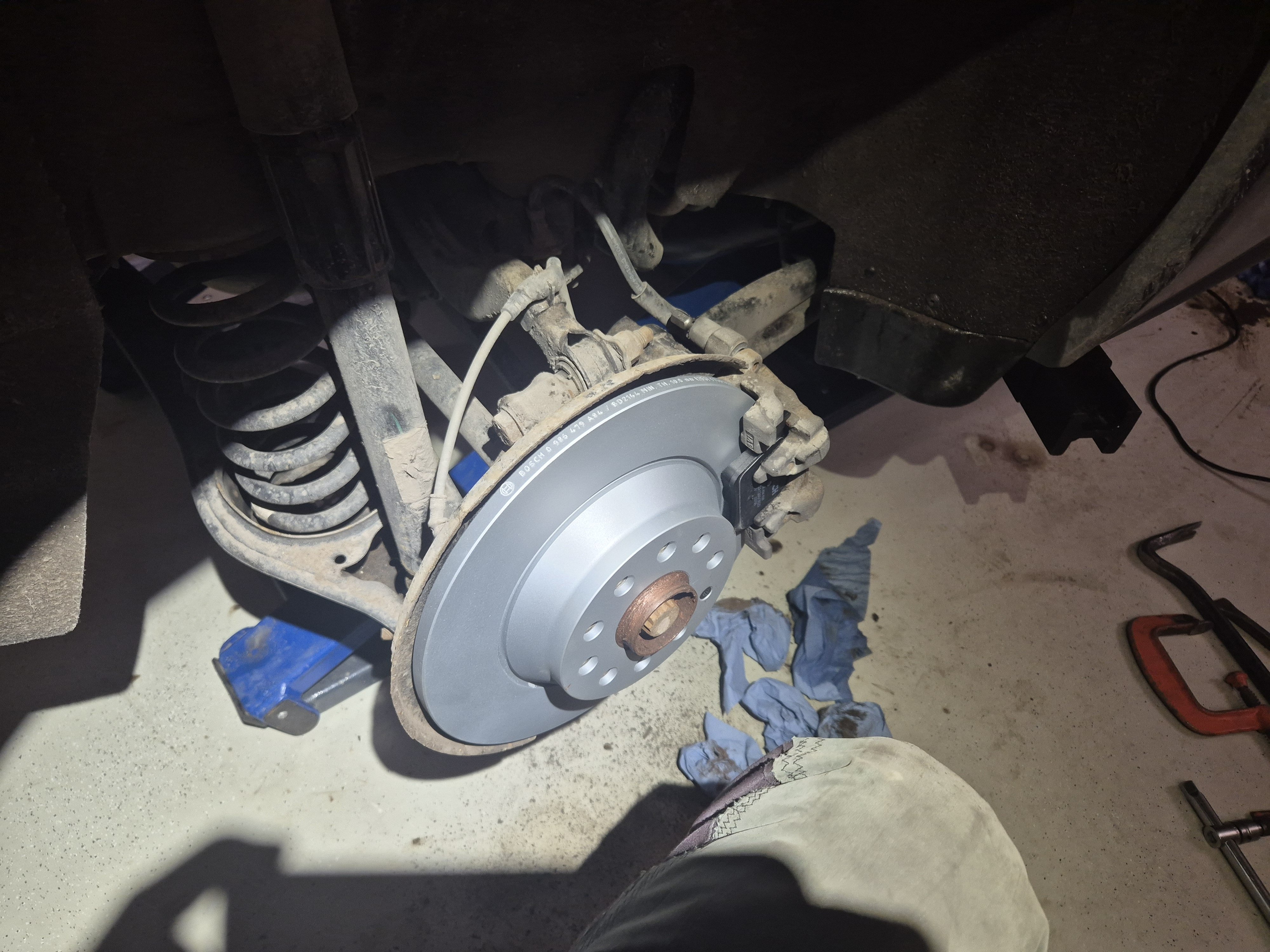

  1. Hi I can confirm that the OBDEleven commands "Start lining change mode" and "End lining change mode" worked as expected. By saying that I mean that at first there was an error message and nothing happened. But after closing and reopening the application on the phone and switching the car ignition off and on it worked like a charm. I had an external charger connected during the whole process in order to maintain the battery voltage. All brake pads and rear brake discs were changed yesterday on a MY2019 Sportline. Can you spot the difference in the images?
