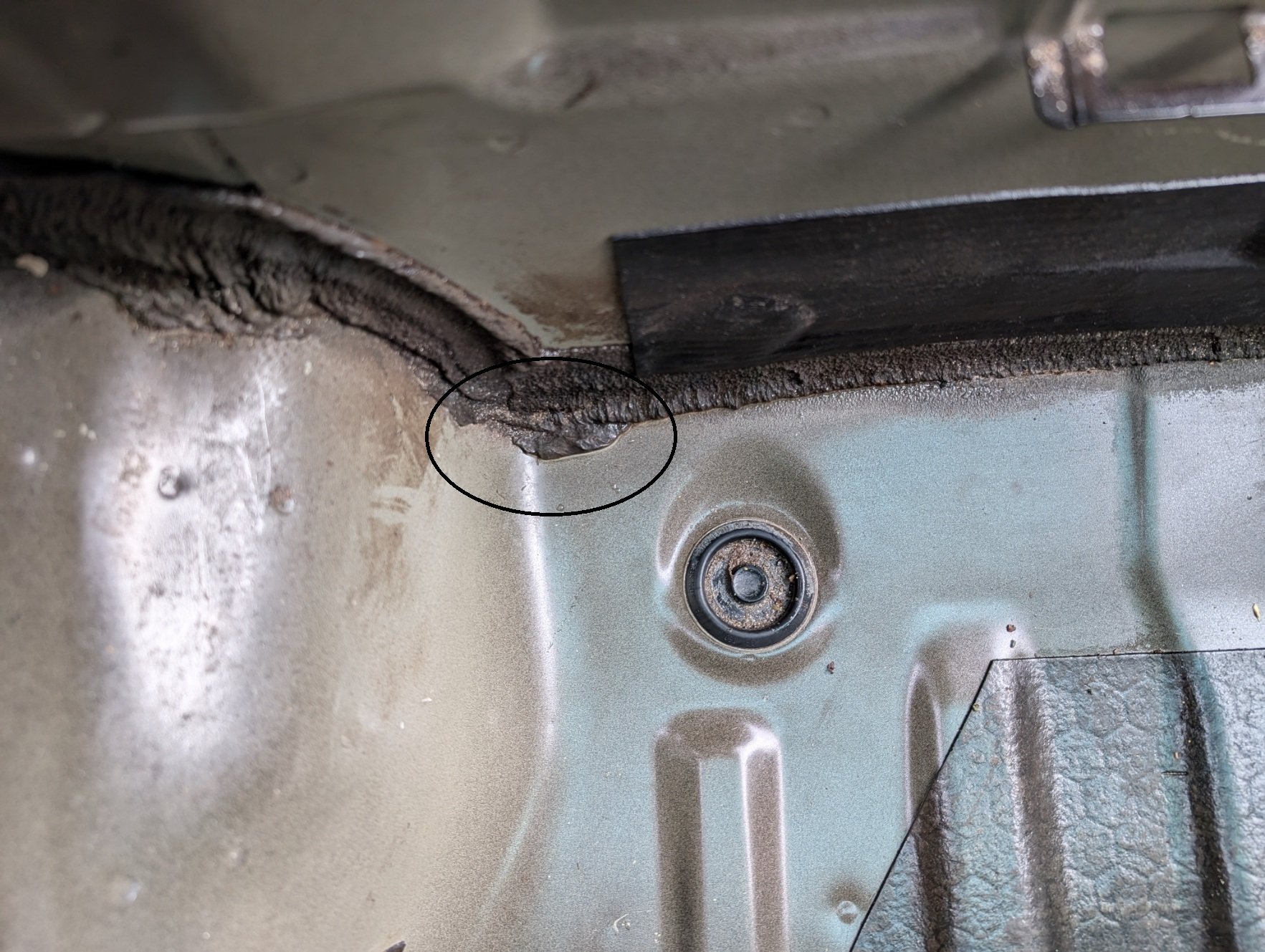

  1. Having removed the bumper and resealed all the joints it was disappointing to find the boot still leaking. Finally i bought a roll of 50mm wide PVC tape and sealed around the offside rear light fitting. Bingo the water has stopped coming in. I have now orered a new seal for the light fitting and when it stops raining will fit it, but I am enjoying a dry car. Thank you to everyone for the advice.
  2. Thanks for your feedback, lets see if it stops raining this week.
  3. I have had someone in the boot and hosed down the back of the car with a hosepipe. It is not the boot seal as it is dry on the inside. Looking in the various holes at the top of the boot lip on the inside there is no water visible when we have used a torch and looked inside. It seems to be getting in further down behind the bumper. Have checked the inside of the tailgate and that is completely dry also. I think the next step is to take the bumper off, but wondered if replacing the sealing material on the inside I could avoid this.
  4. I have the picture of where the water is coming in under the black sealant attached I was wondering wht people thought of scraping out the leaking sealant and then resealing it with an appropriate sealing materieal such as tiger seal . The leak is right in the corner.
