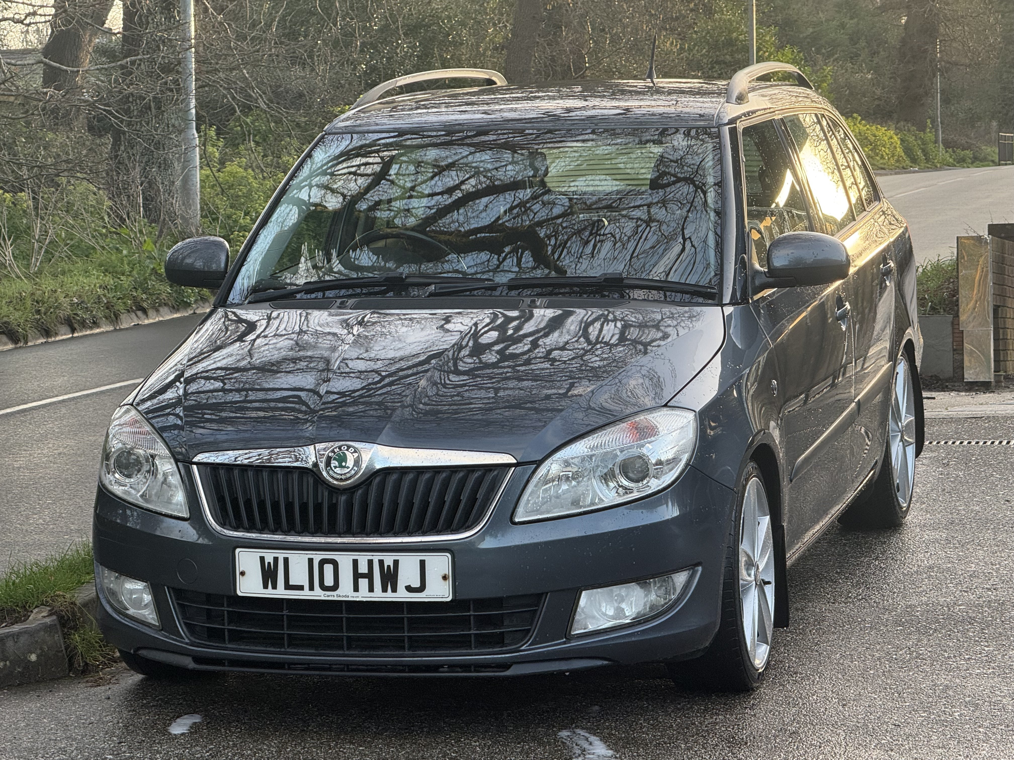

Thanks 😁 Yea I’m really happy with it. A few more bits to do but it’s looking good from what it was 😎

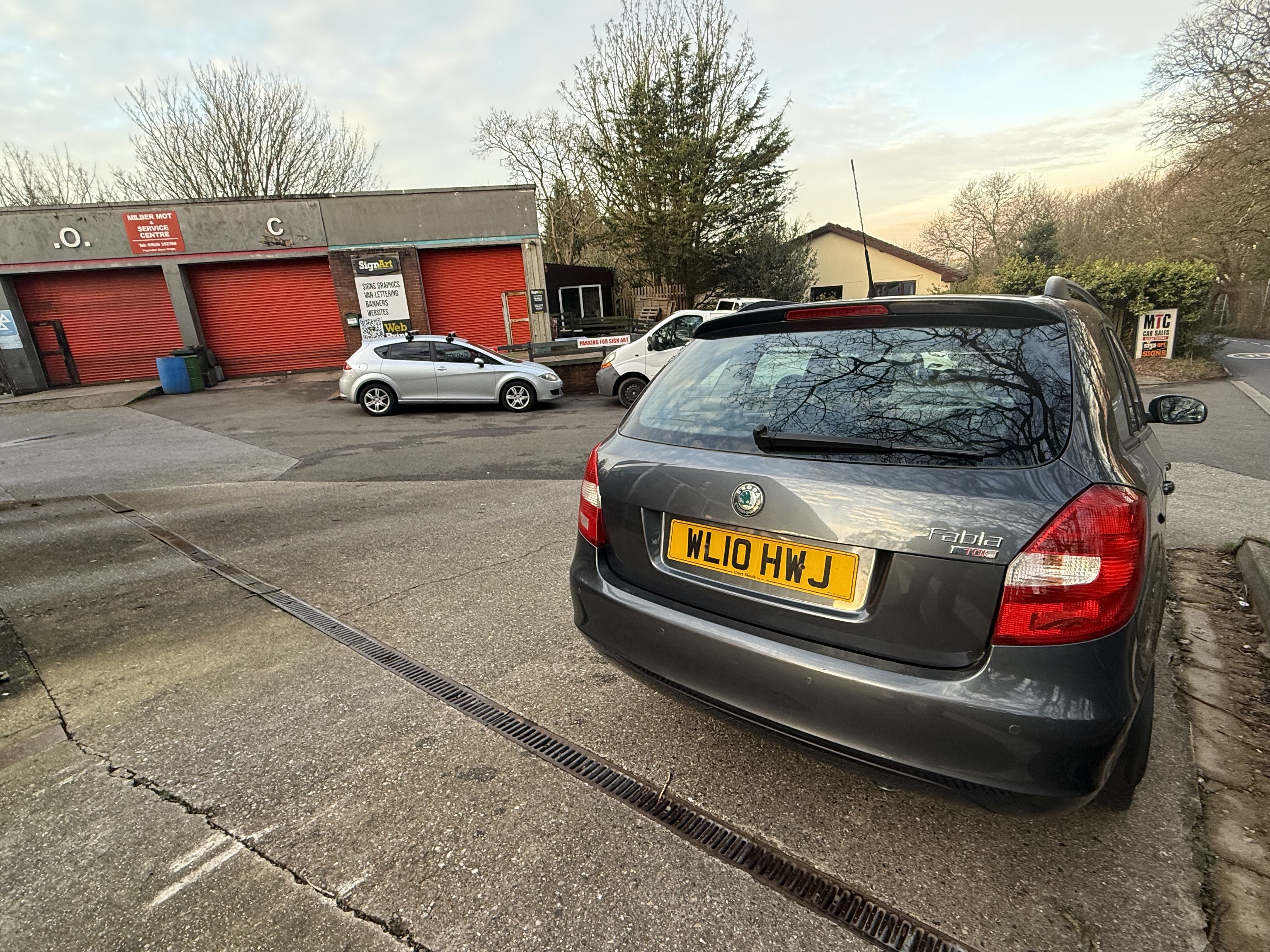

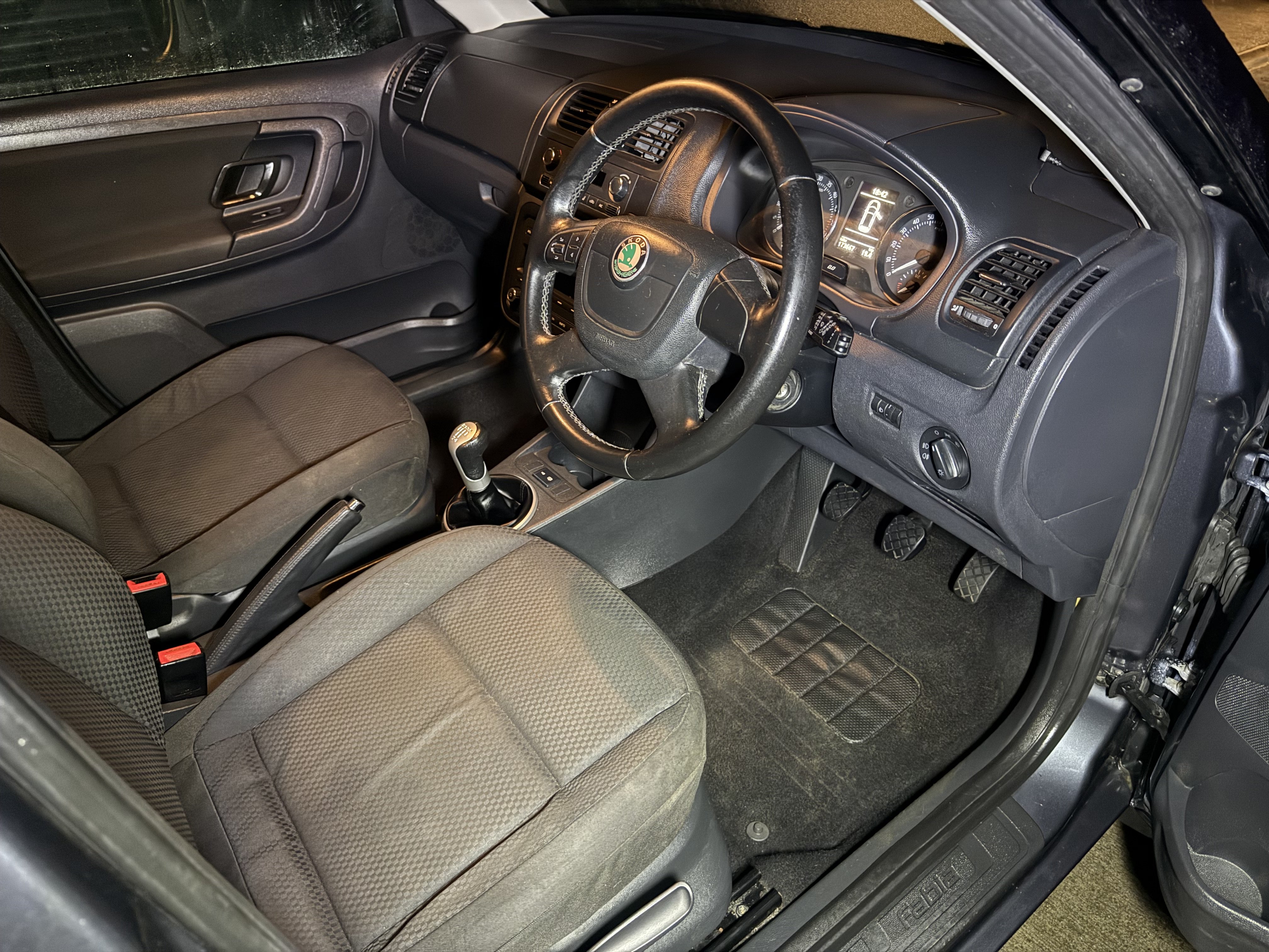

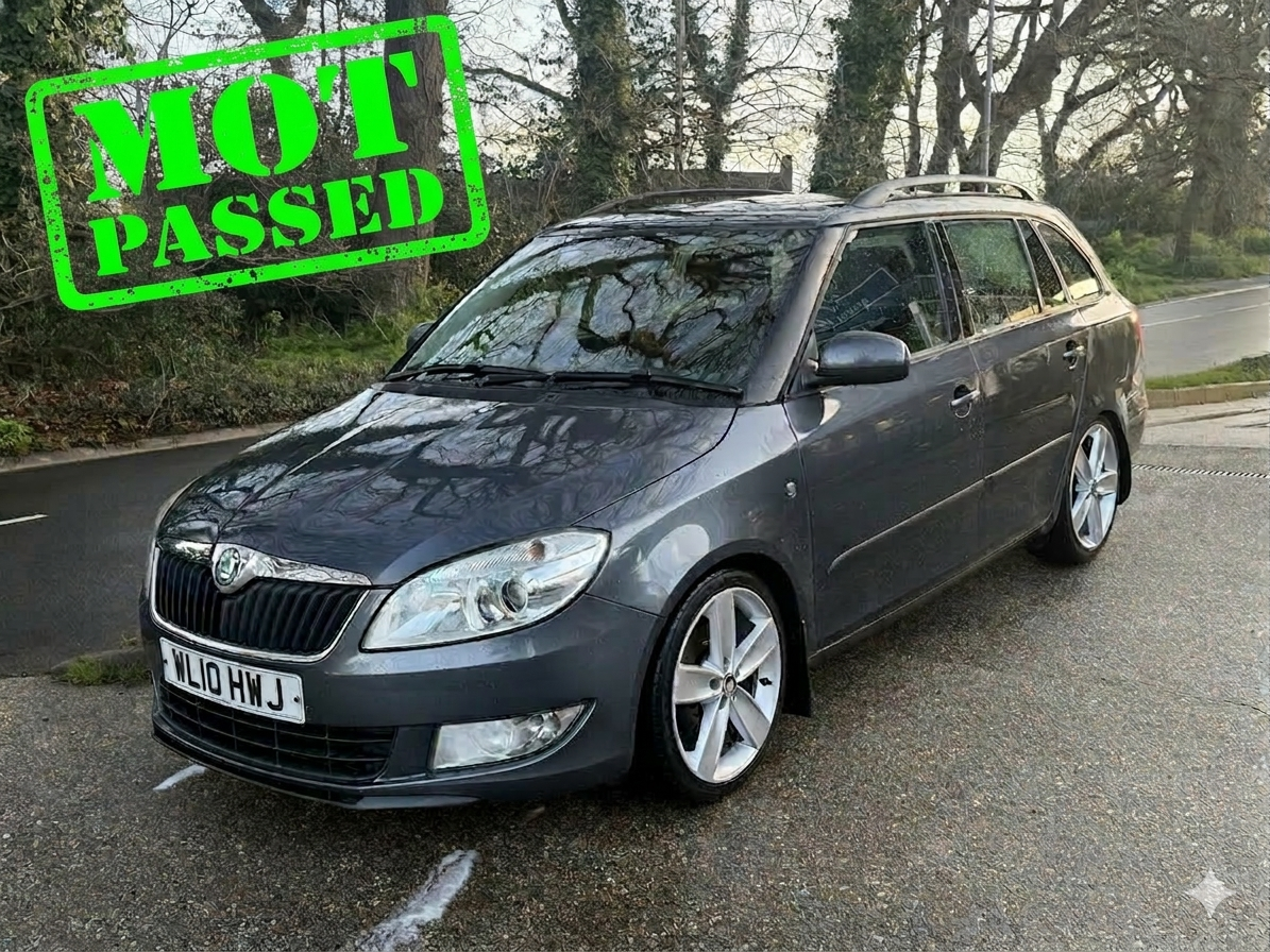

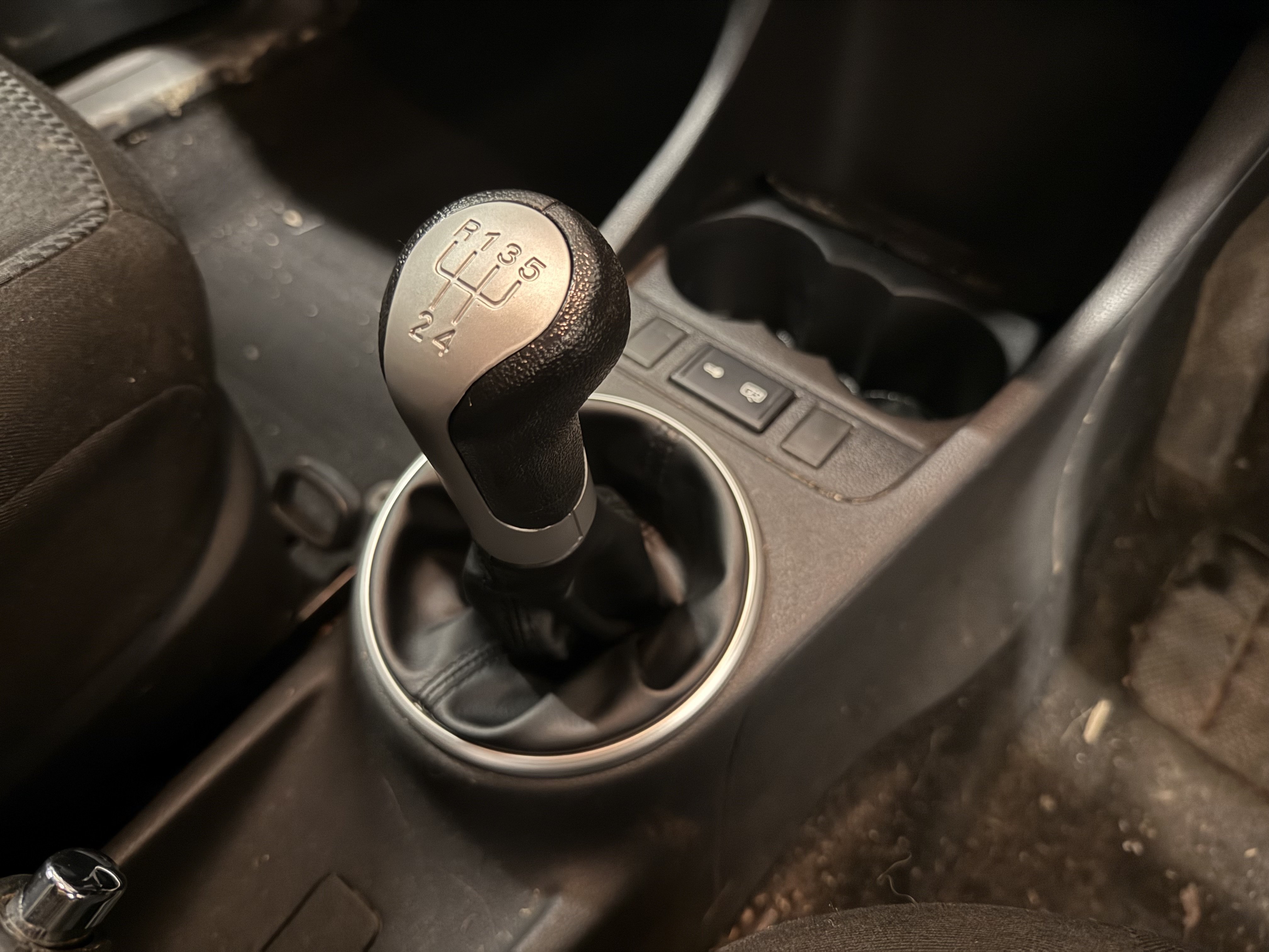

So after we seemed to have overcome the previous drama, I booked the car in for its MOT for the following week. This gave me a bit of time to do a bit more interior cleaning and fitting some new parts like a new (unbroken) gear knob and gator and some delightful (temporary) mats that my mate gave me 🤣. It still needs more work to be up to my standards but it’s much better and will do for now. Then it was MOT day………. AGAIN!! 😬 But this time it made it there without any issue at all! 👍 And later that day…….. WE HAVE A PASS! 💪😁

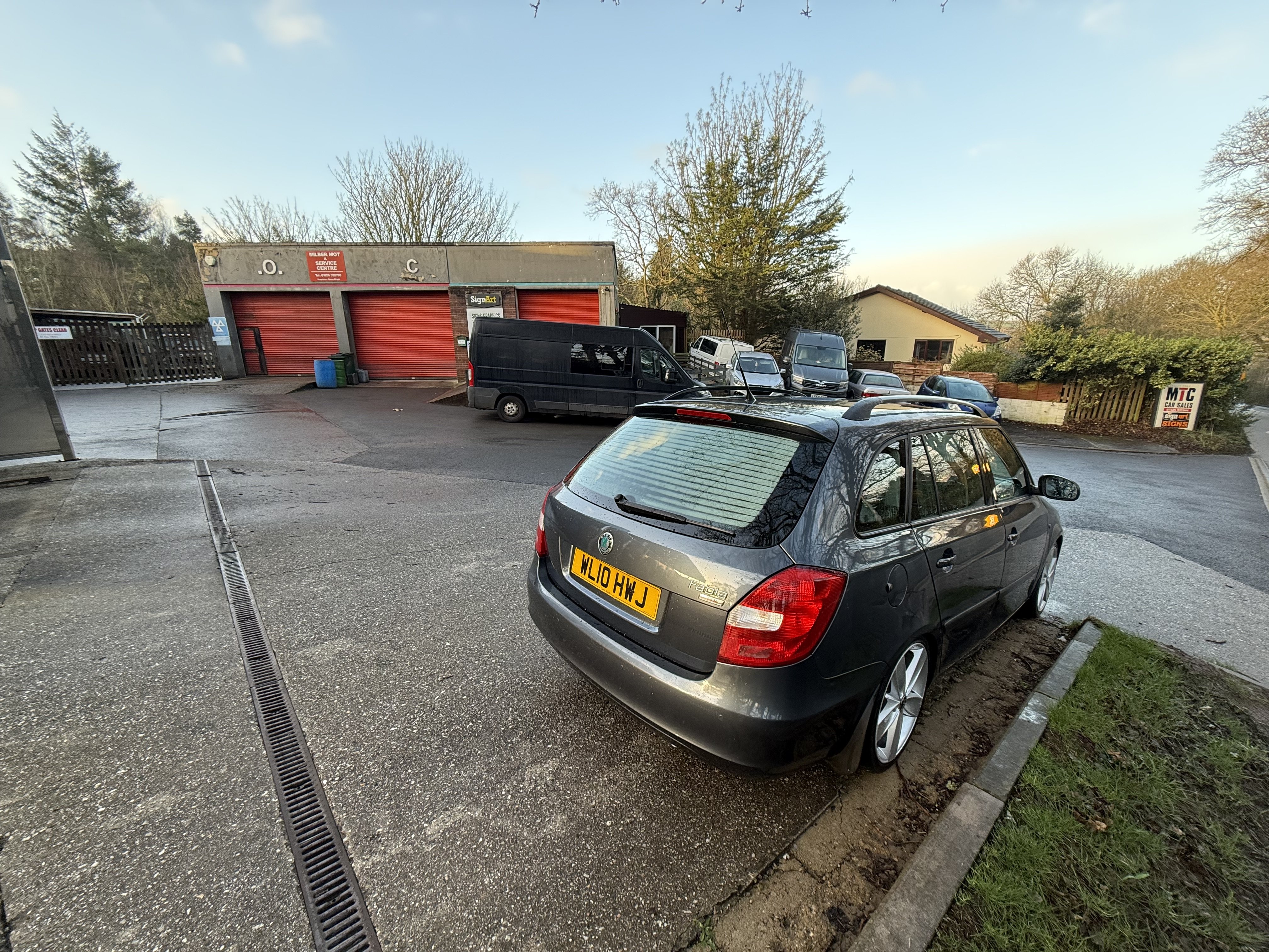

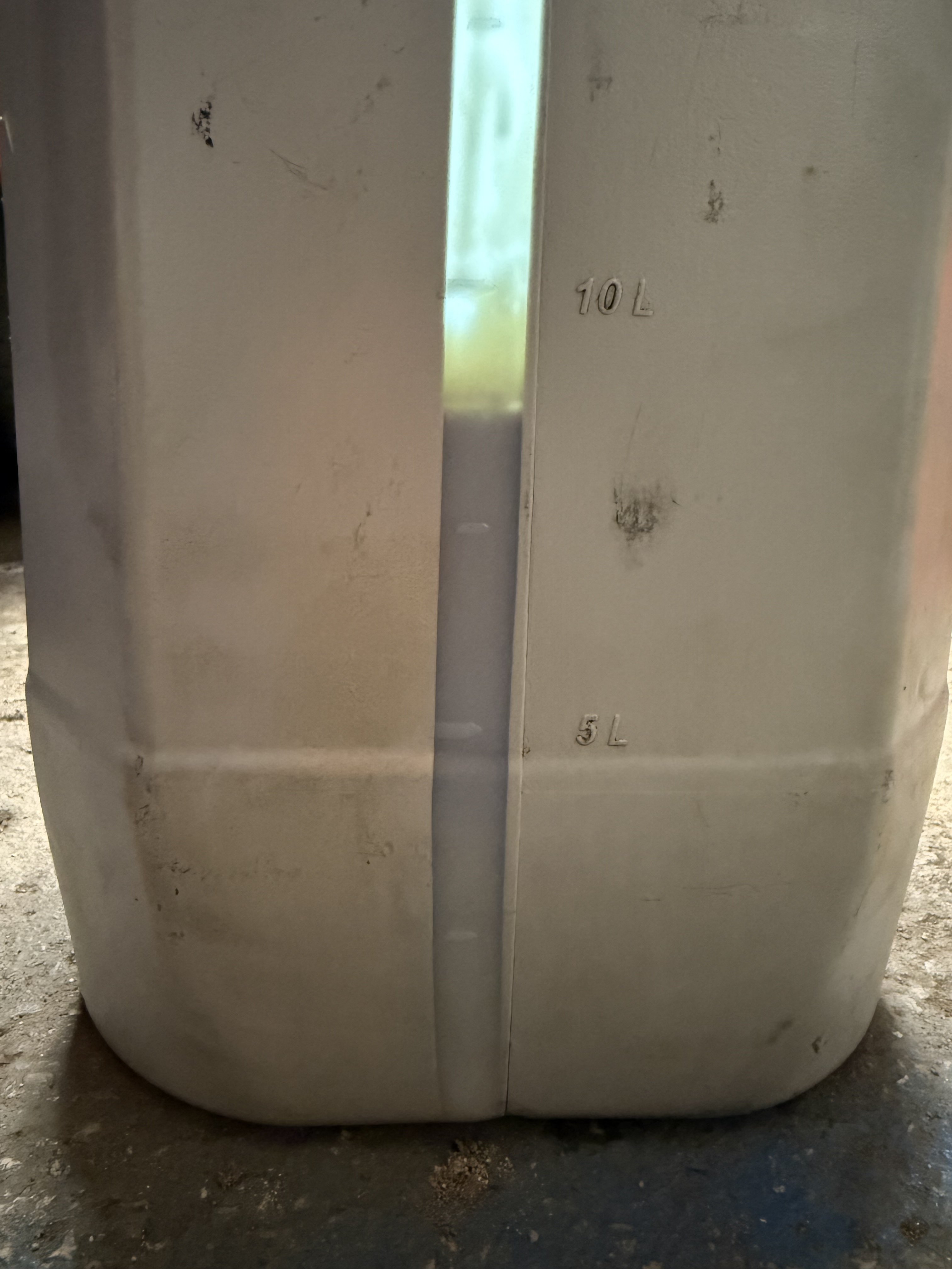

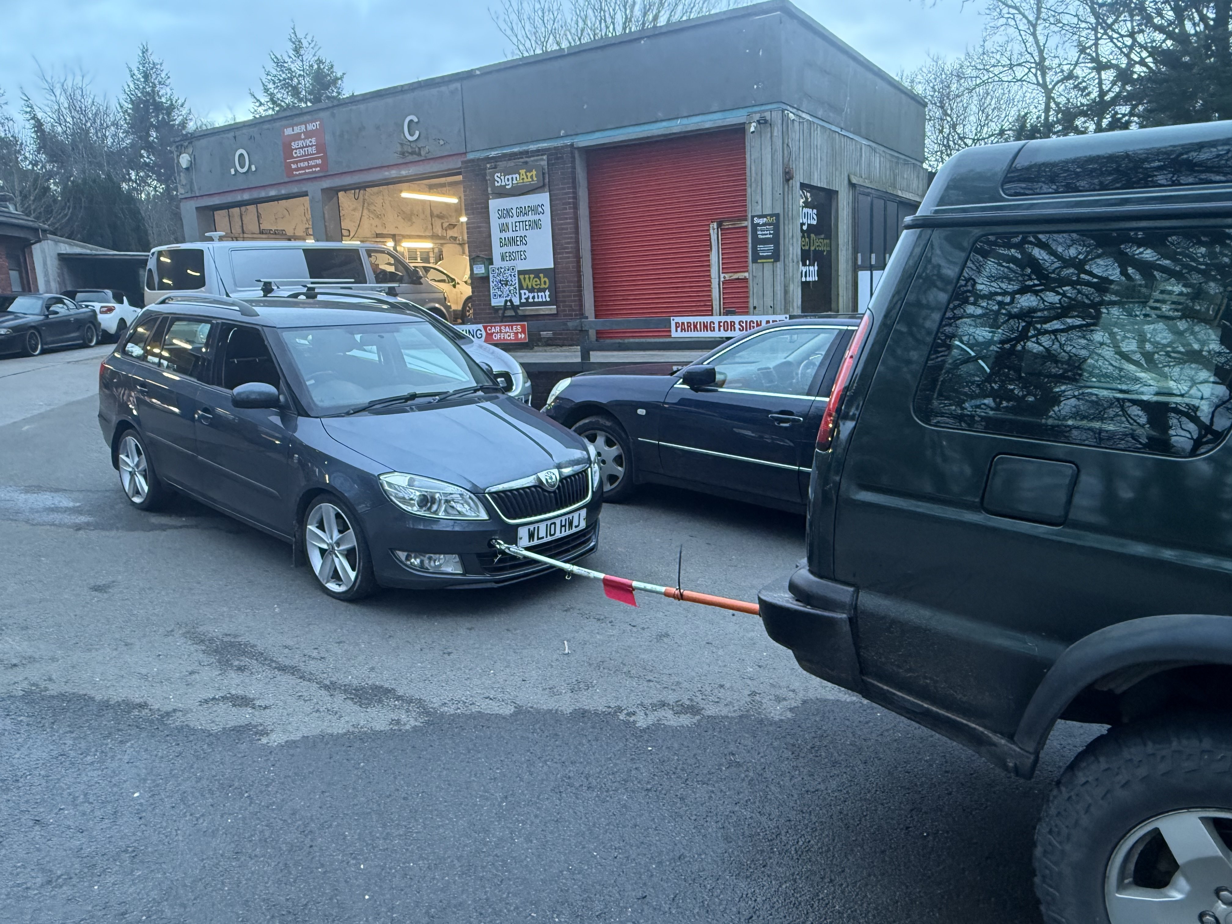

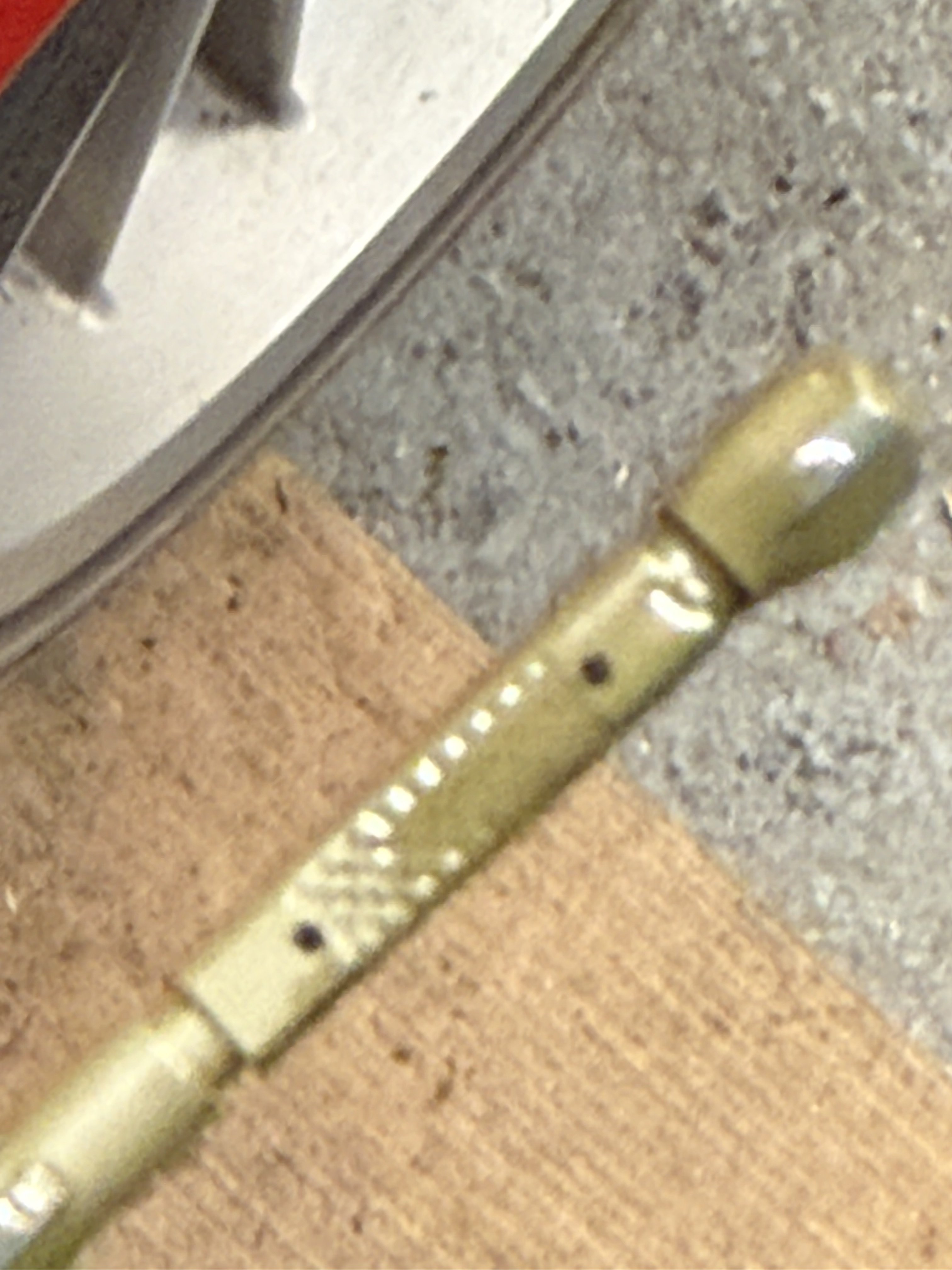

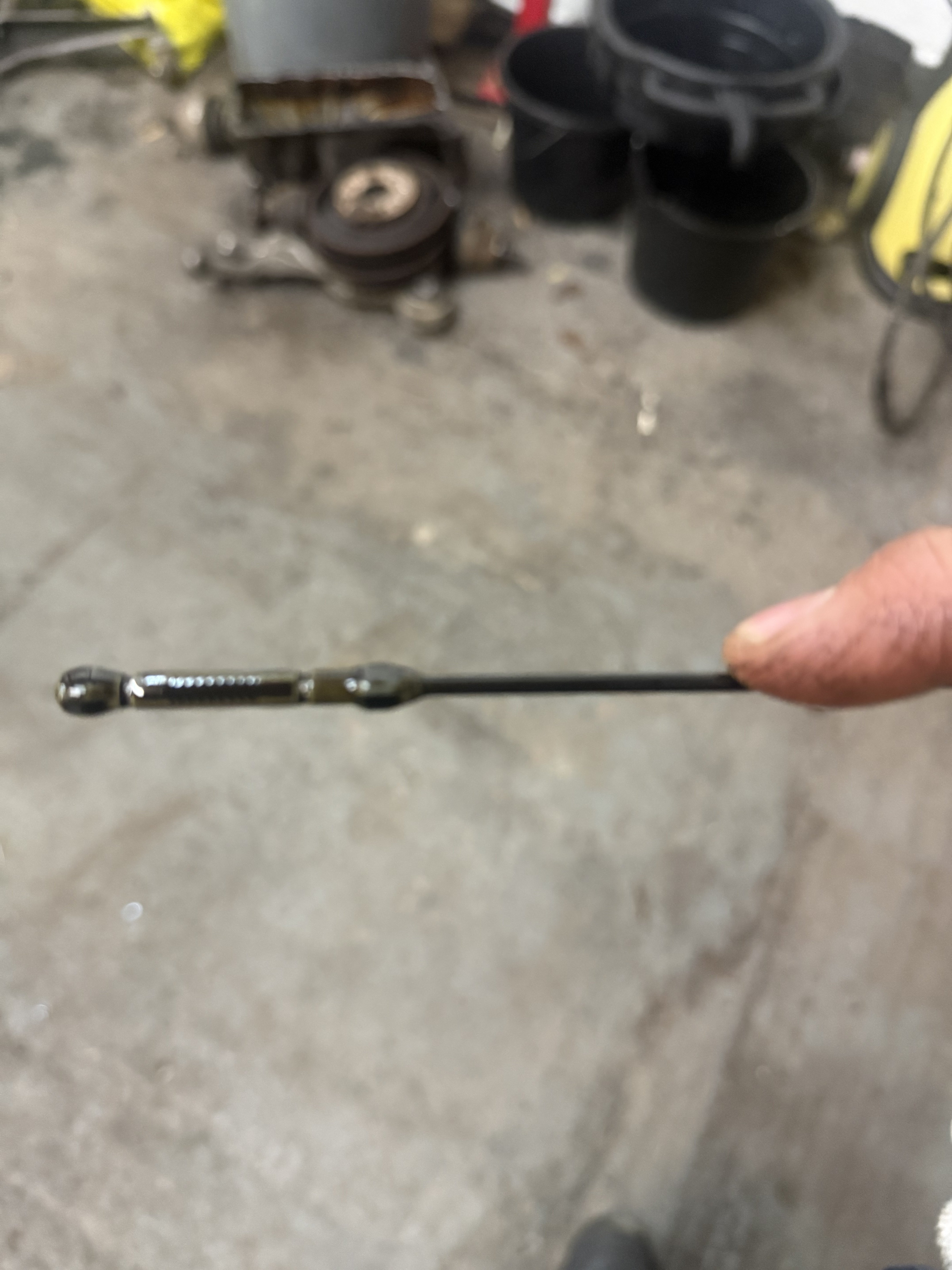

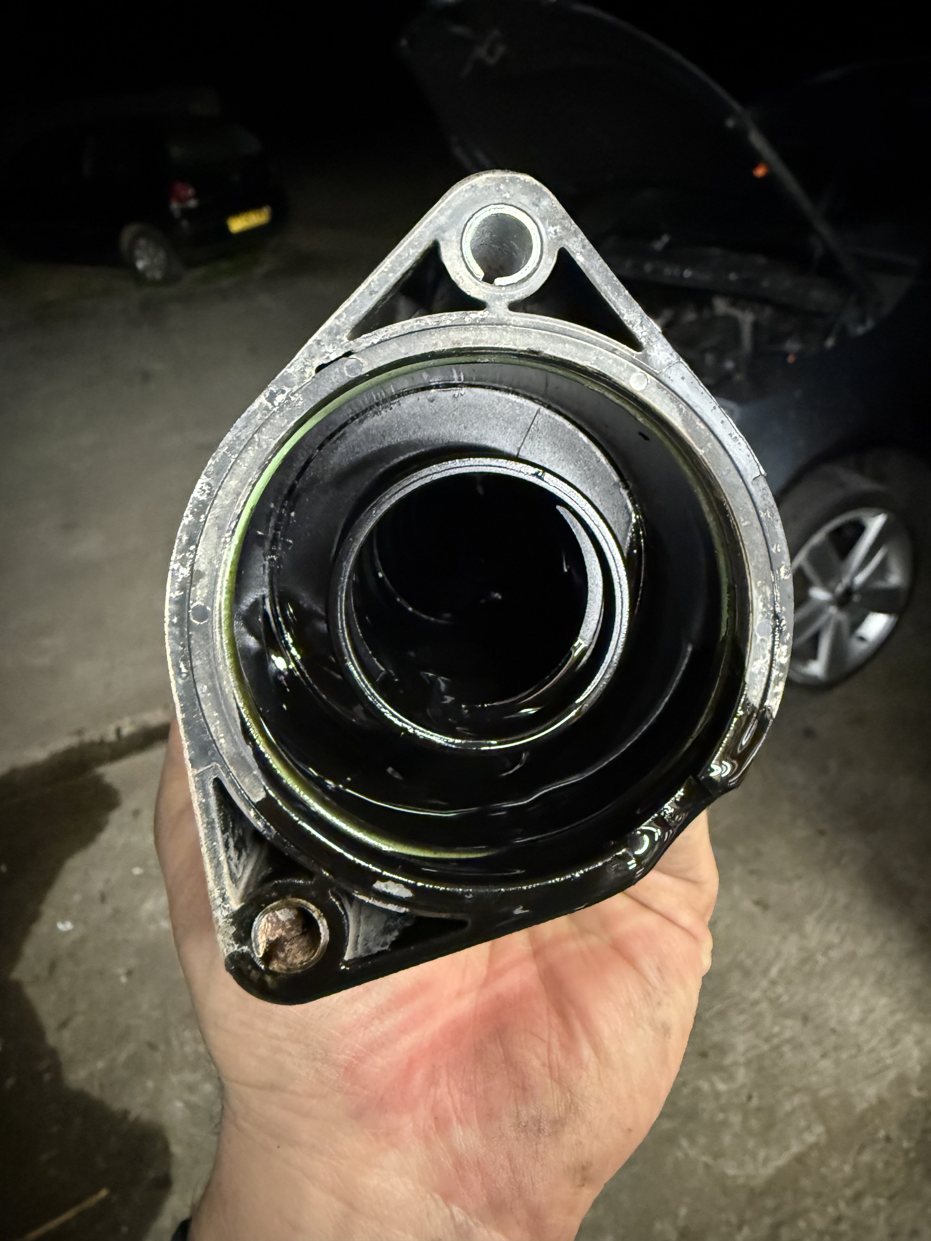

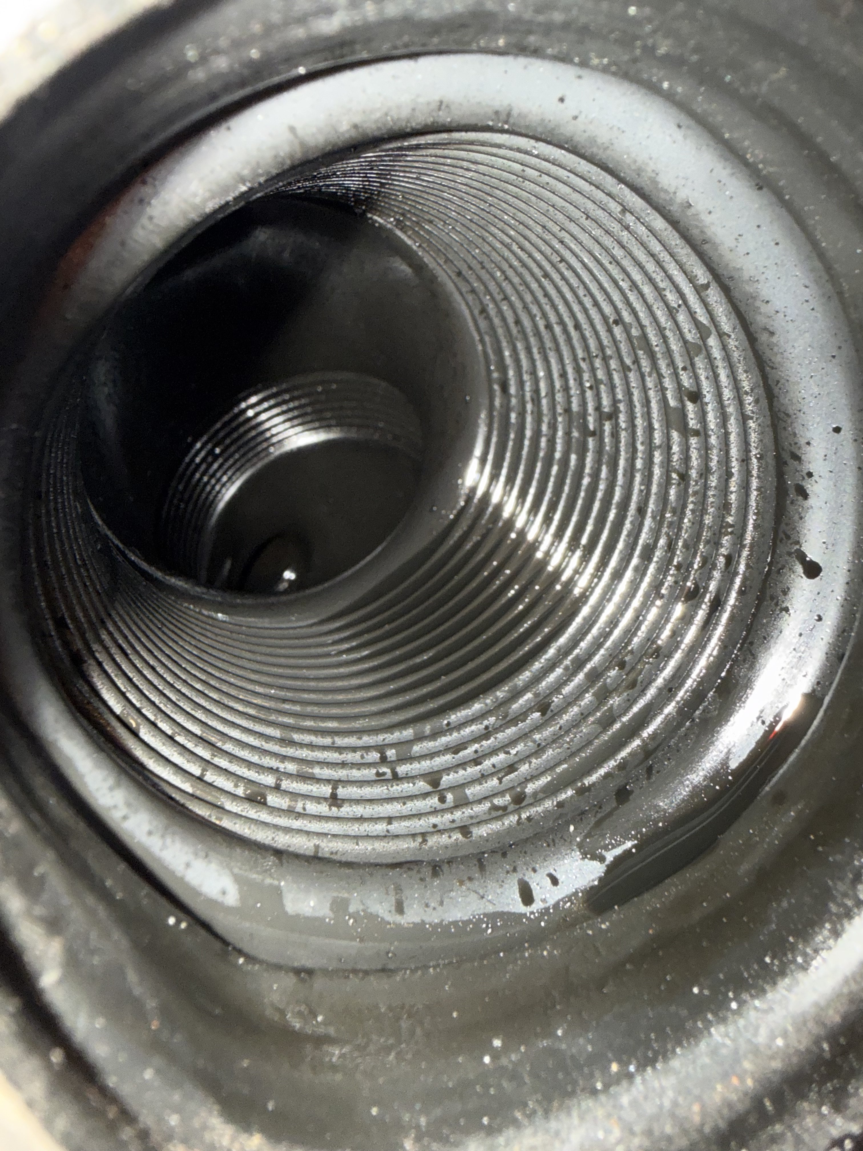

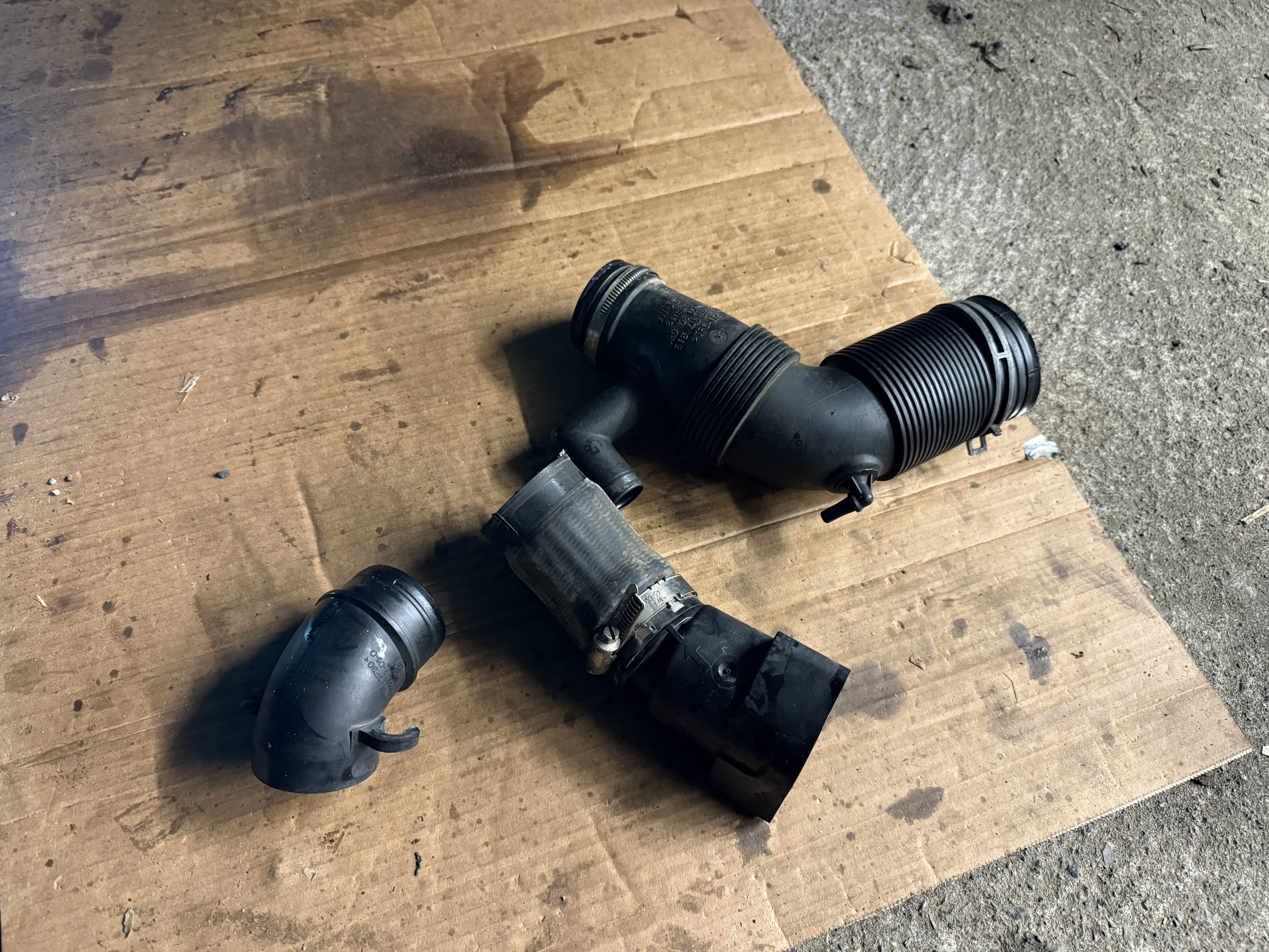

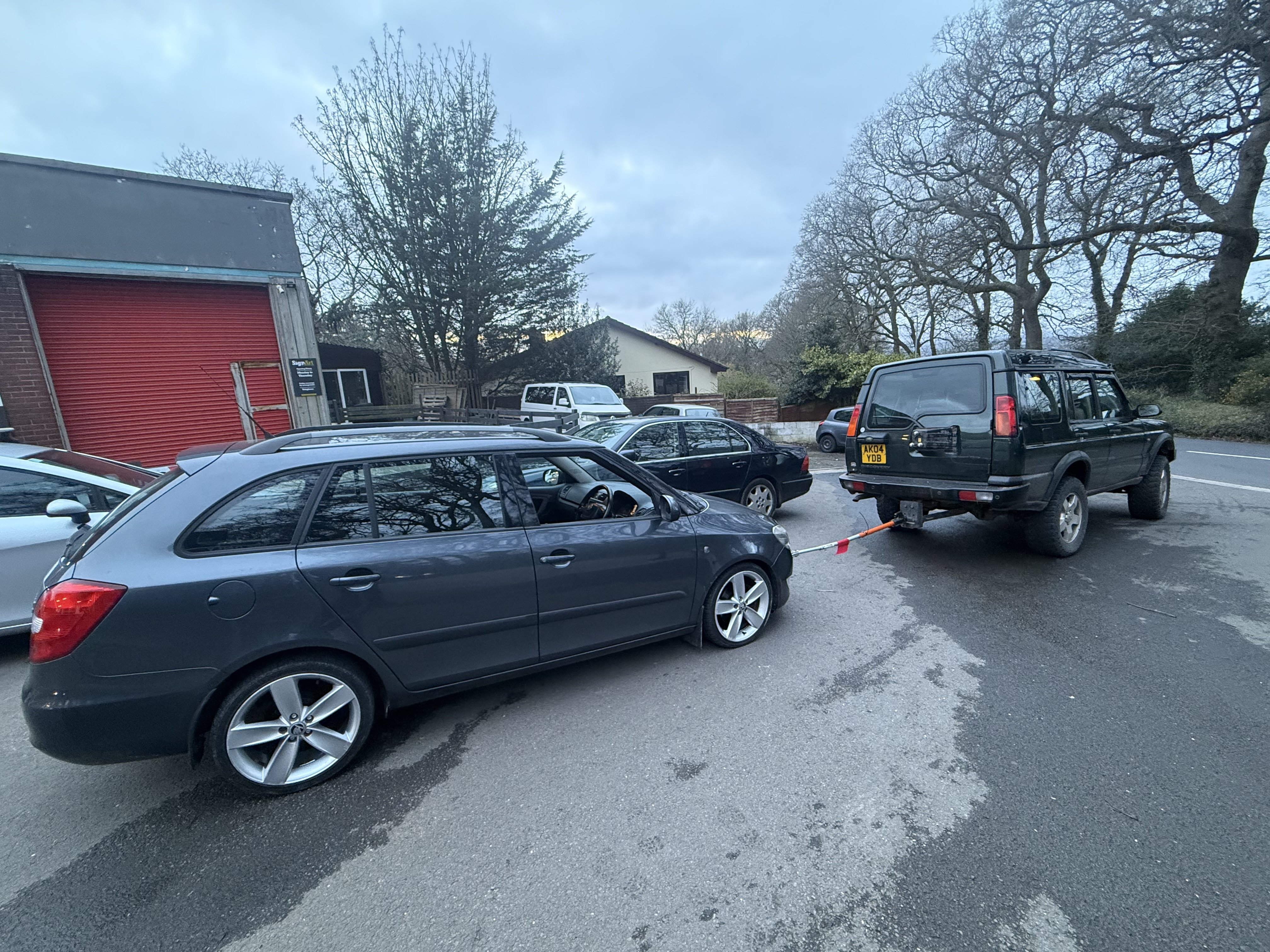

After spending 2 weeks prepping my little Fabia for its MOT it was finally booked in. However, after 99% of its journey to the test station being perfectly smooth and nice, the last 1% ended up in a cloud of smoke and an engine runaway (that thankfully stopped when I cut the ignition!!), right outside the test station! I was gutted after all the work I had done and was worried that it was as serious as it looked, and it looked to me like turbo oil seal failure! 😢 So I bailed on the MOT and the garage took a look at the issue instead! When I went to collect the car from the garage later that day, they said it’s definitely the turbo failed as there was lots of oil in the intake, BUT they did mention that the oil level was also slightly high (they said 1cm). By chance I got chatting to a guy outside who turns out to be a VAG specialist and told him about my runaway issue. He said it’s likely to be turbo seals BUT it could be the oil over full being sucked up through a breather into the intake. So I got the car towed back to my mates unit to investigate further! Well on further inspection it turns out the oil level was way higher than I or the garage noticed it seems. The oil was so thin it barely showed on the dip stick over the max level, but looking more closely you could just see a sheen on the stick! Well after realising the oil level was high, I dumped all the oil out to see how much by. To my surprise there was about 8.5 litres in there!! That’s about double!! 😮. It also smelt of diesel and was thin like water so likely cause would be long term failed Regens by driving lots of short journeys. Yes it could be a failed injector but it still drives really smoothly so is looking less likely. I had all the turbo pipes off and drained the small amount of oil in the intercooler as best as I could. I did find that the oil starts in the system from the crank case breather, which is BEFORE the turbo, so it was now looking less likely the turbo seals were at fault 🤞. So it now has the correct amount of new oil and a new filter. It now runs so much smoother and quieter with no smoke at all. So after a lot of drama and worry that my budget car was about to fail me or cost me, with no more than a good service we seem back on track!! Phew!! 😁👌

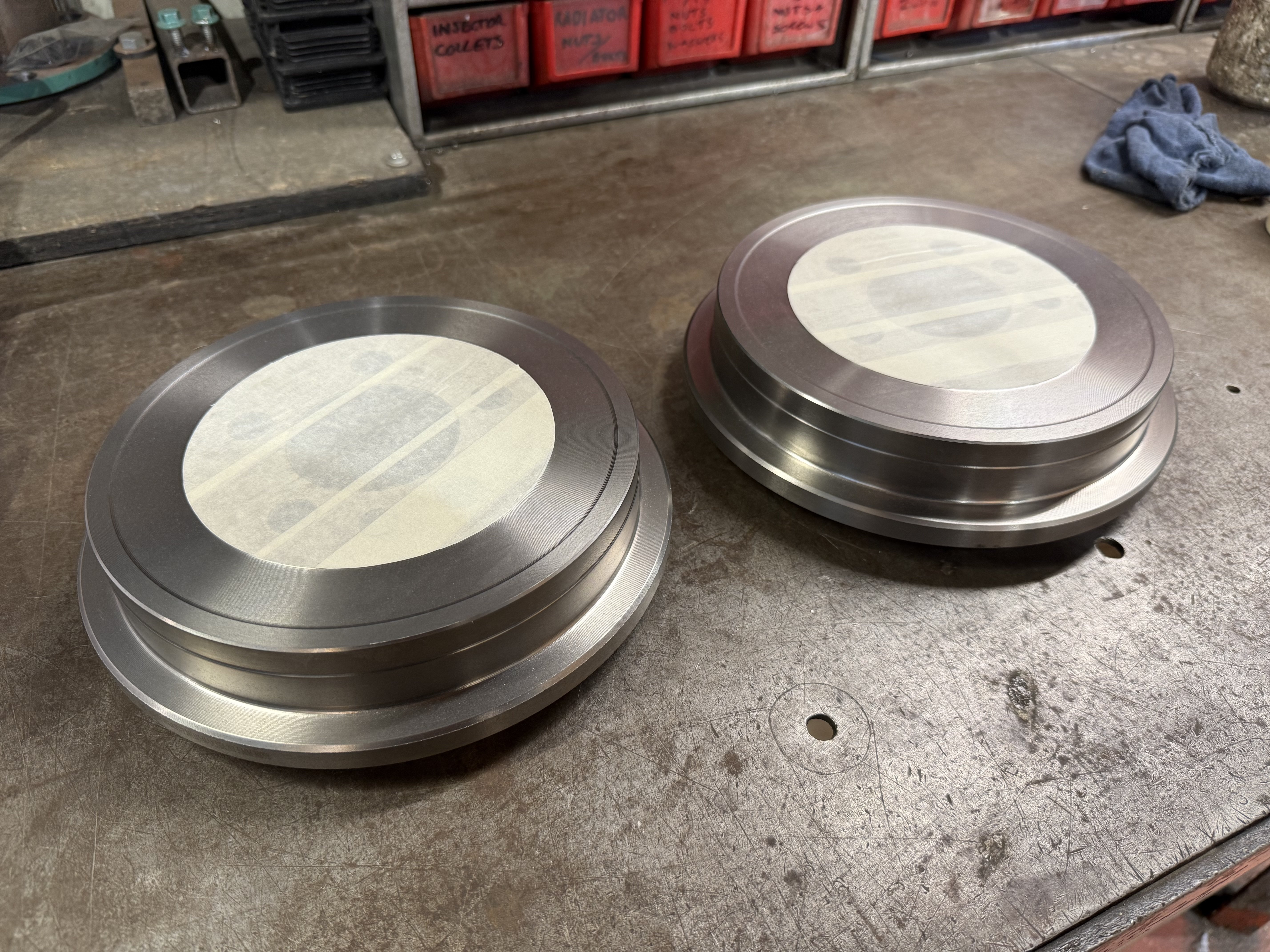

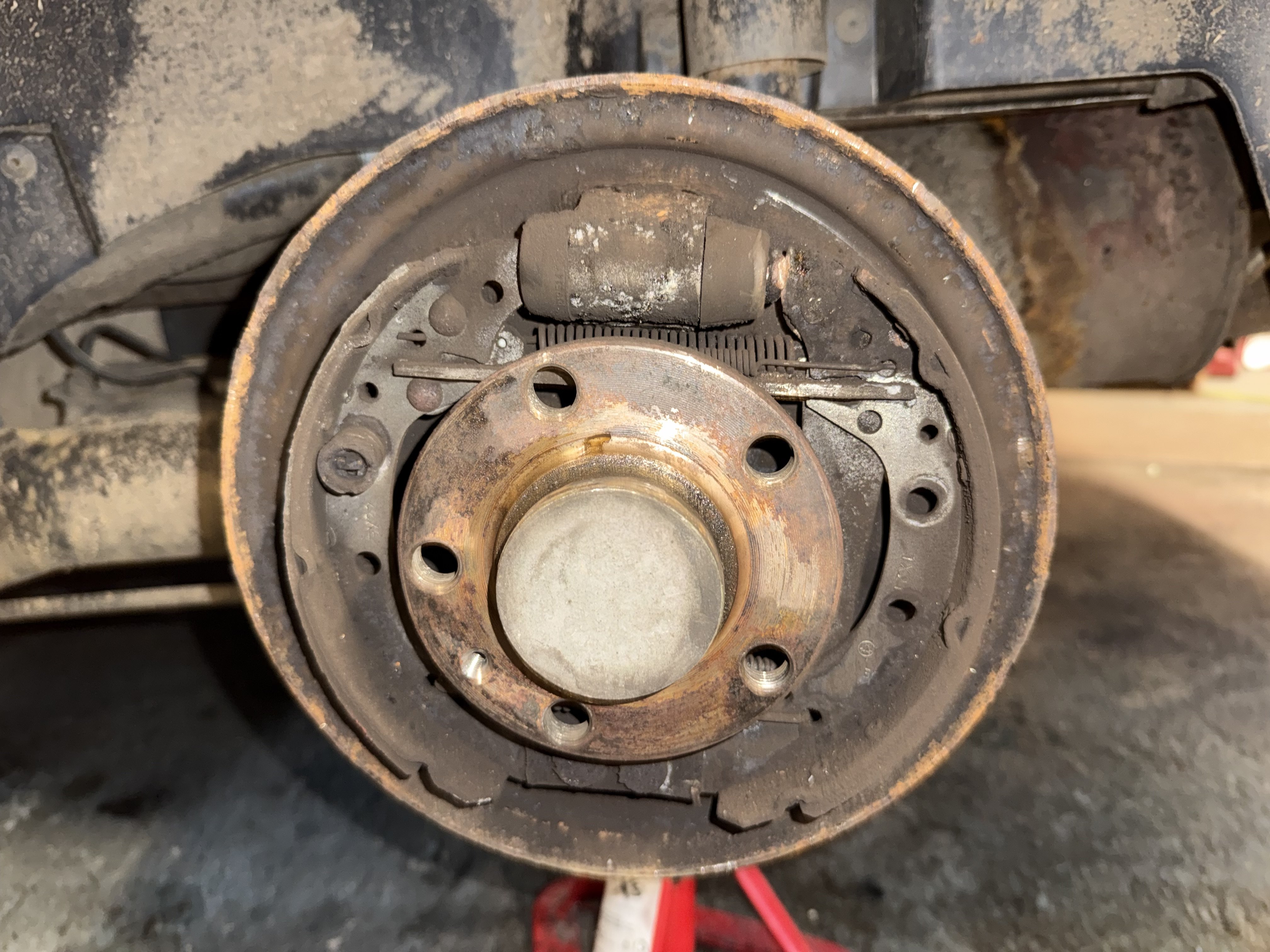

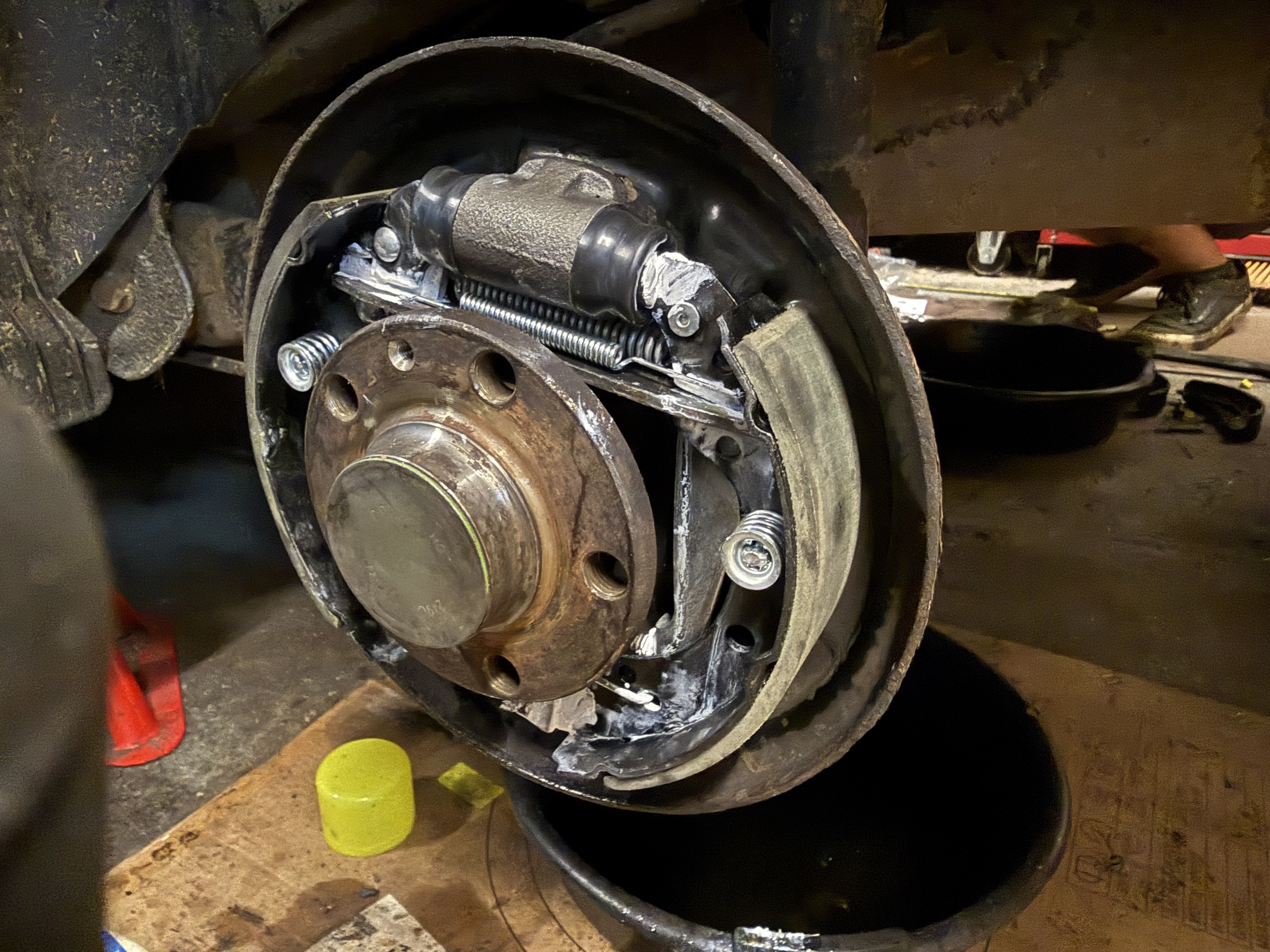

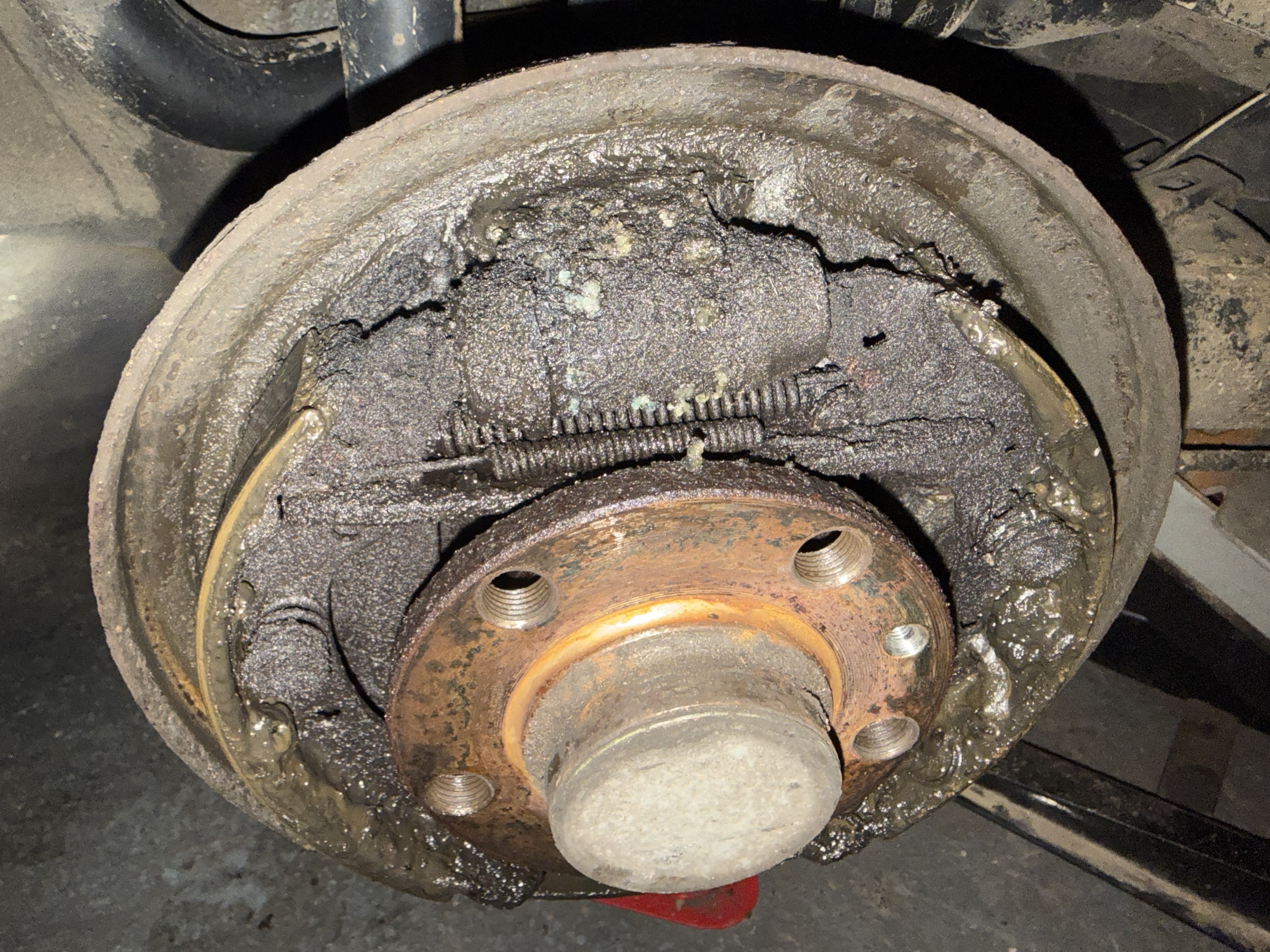

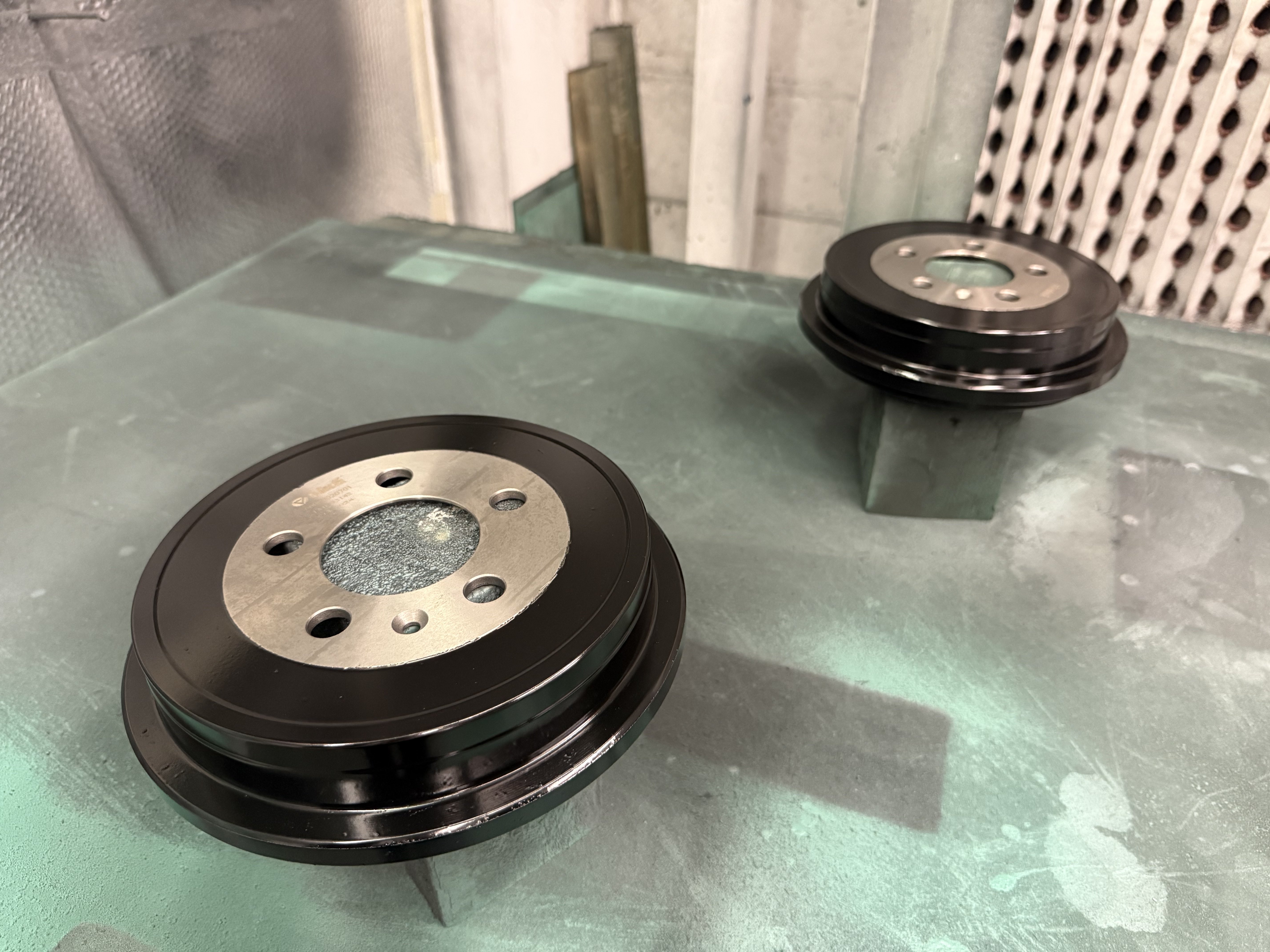

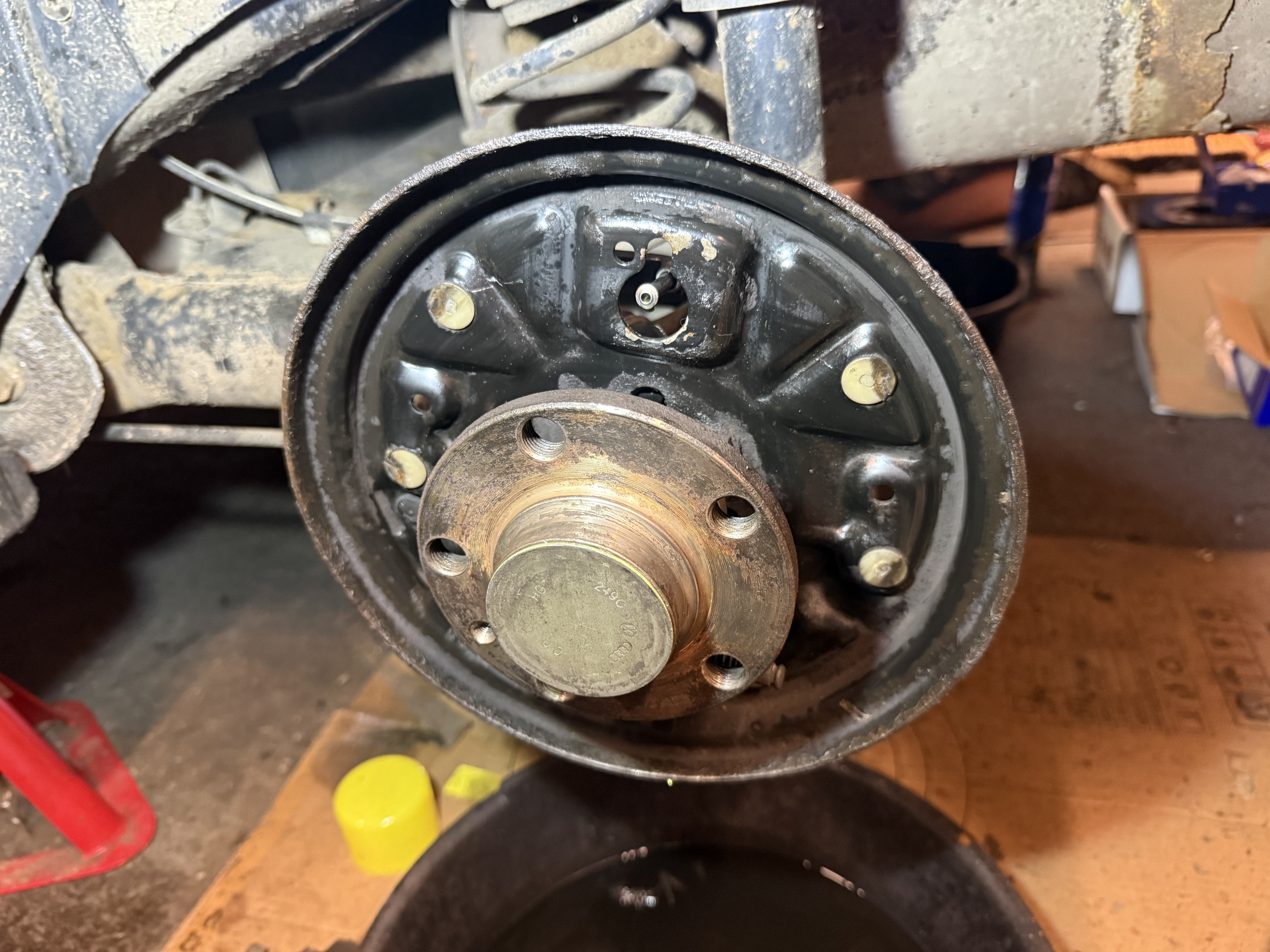

Next job was to strip and renew the rear brakes. There was a leaking cylinder on one side and the shoes and drums were in poor condition so everything was replaced to be sure. I even gave the drums a paint with black Hammerite to keep them nice and prevent corrosion.

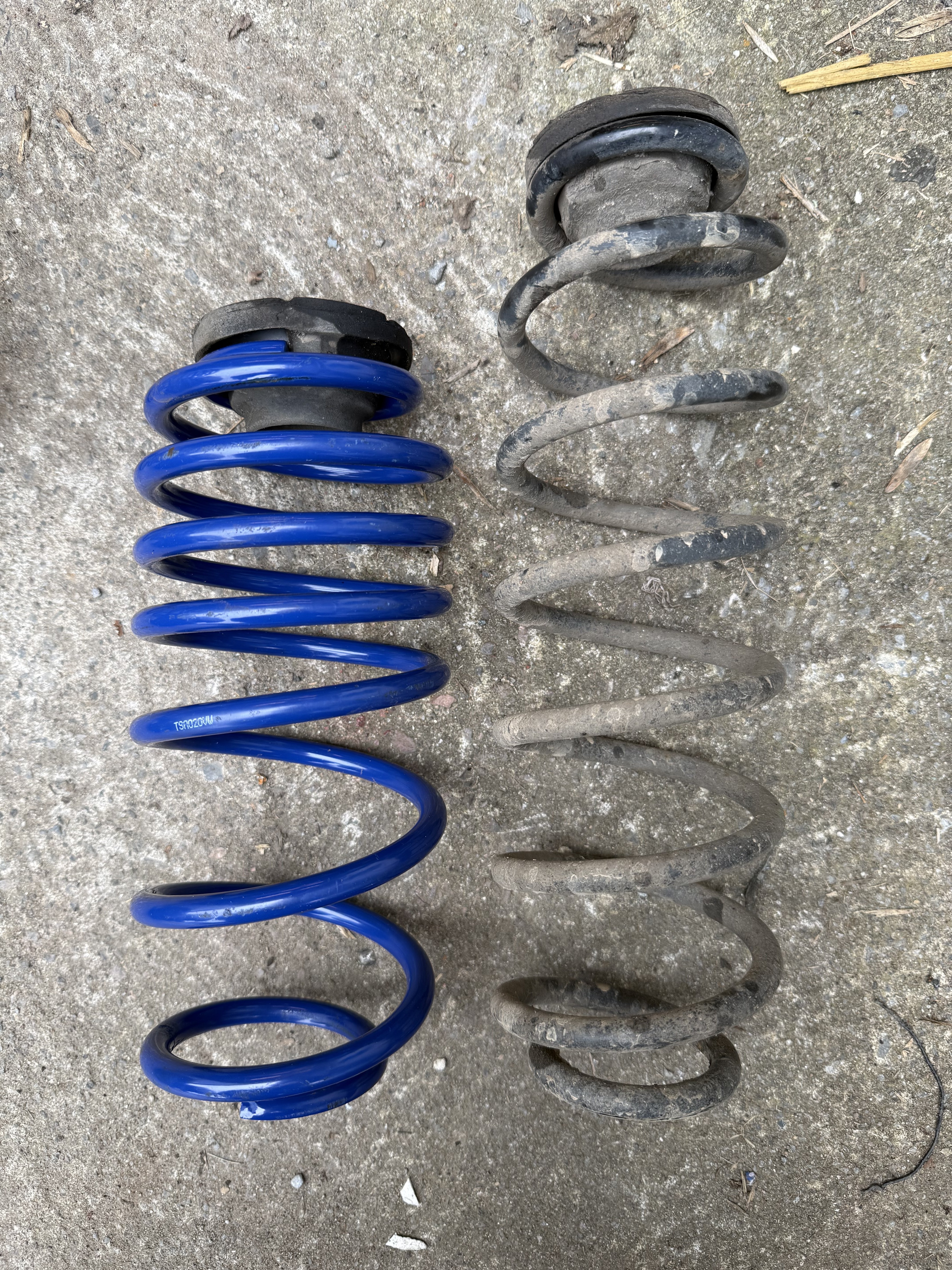

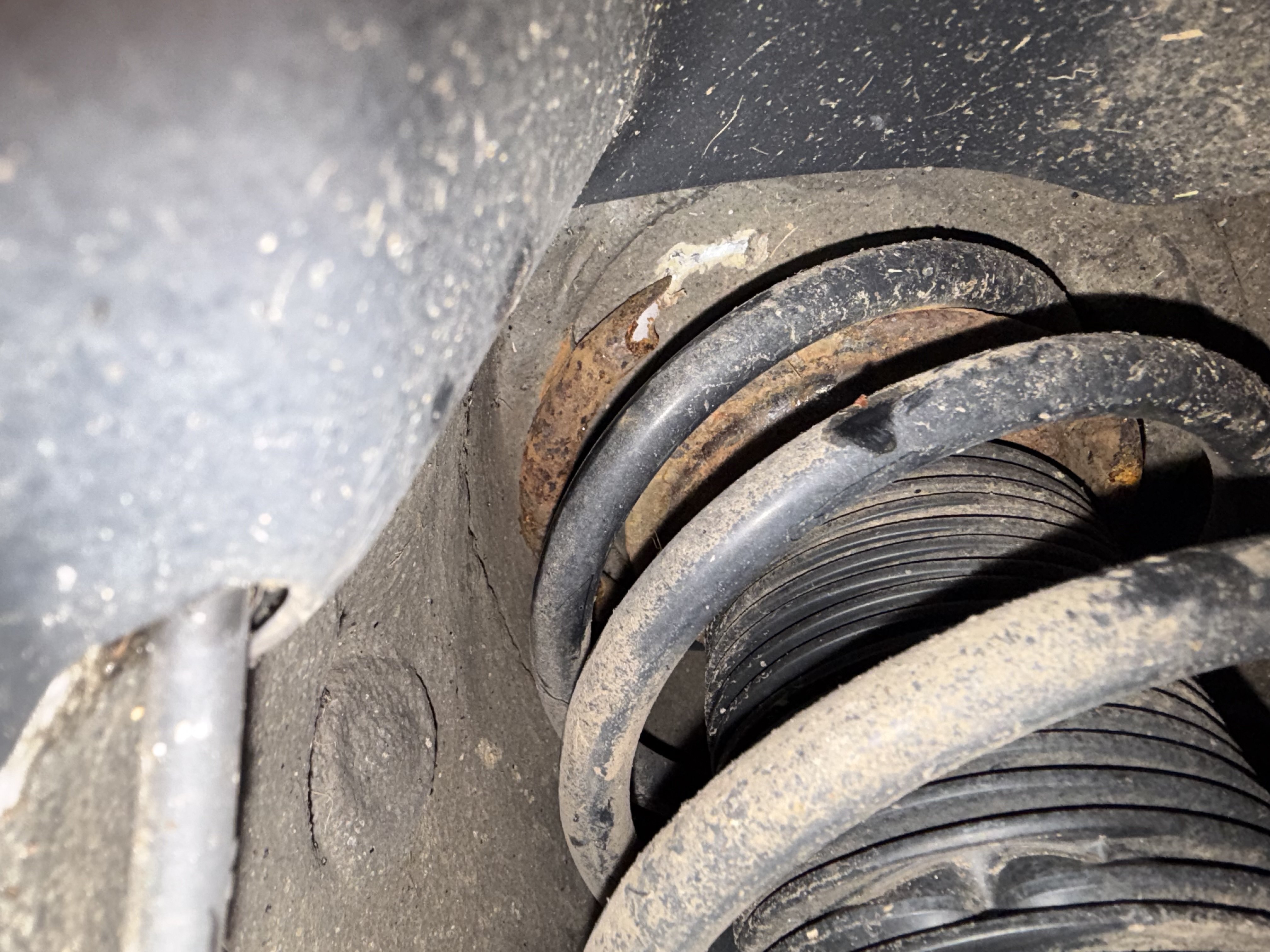

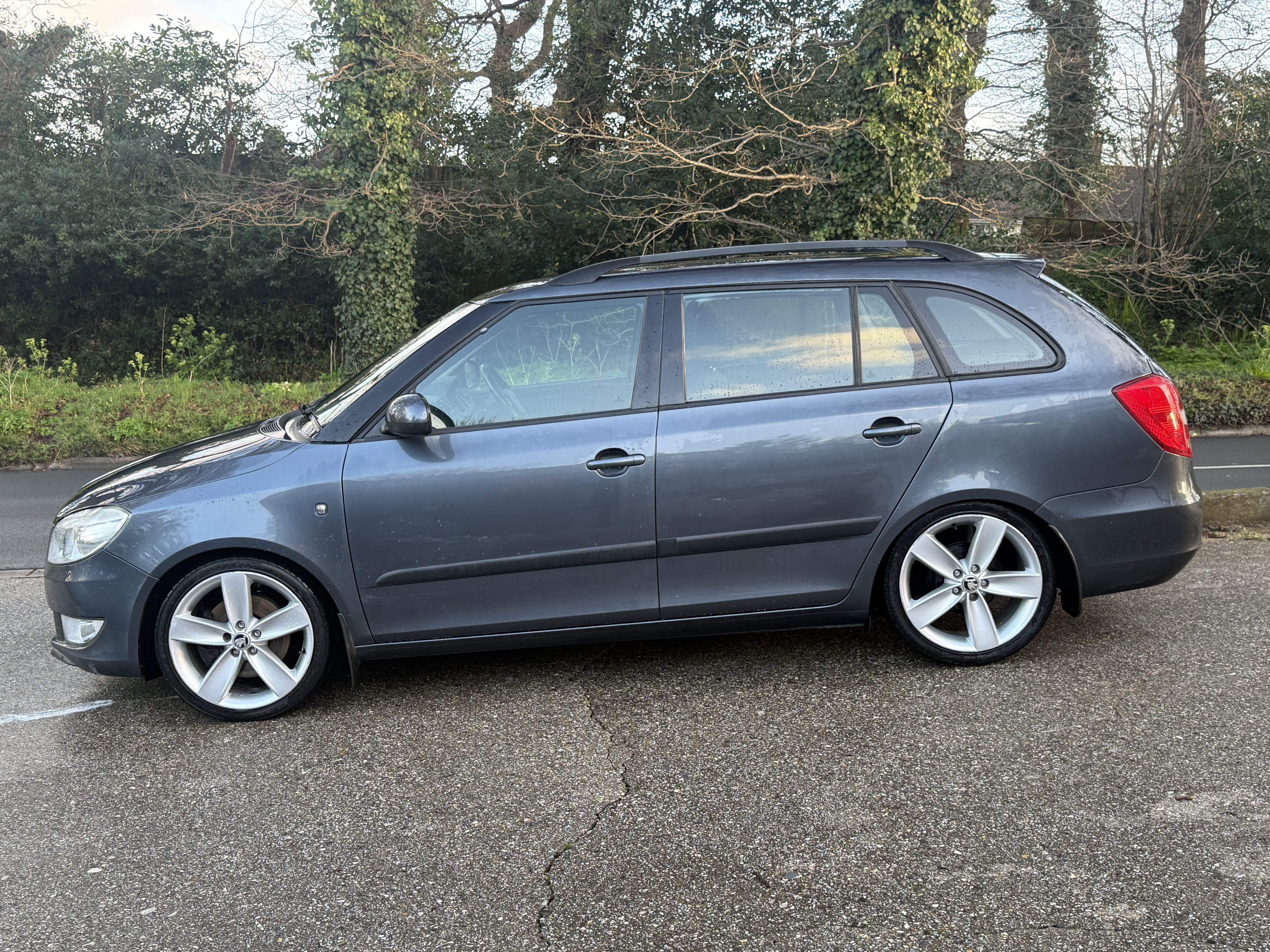

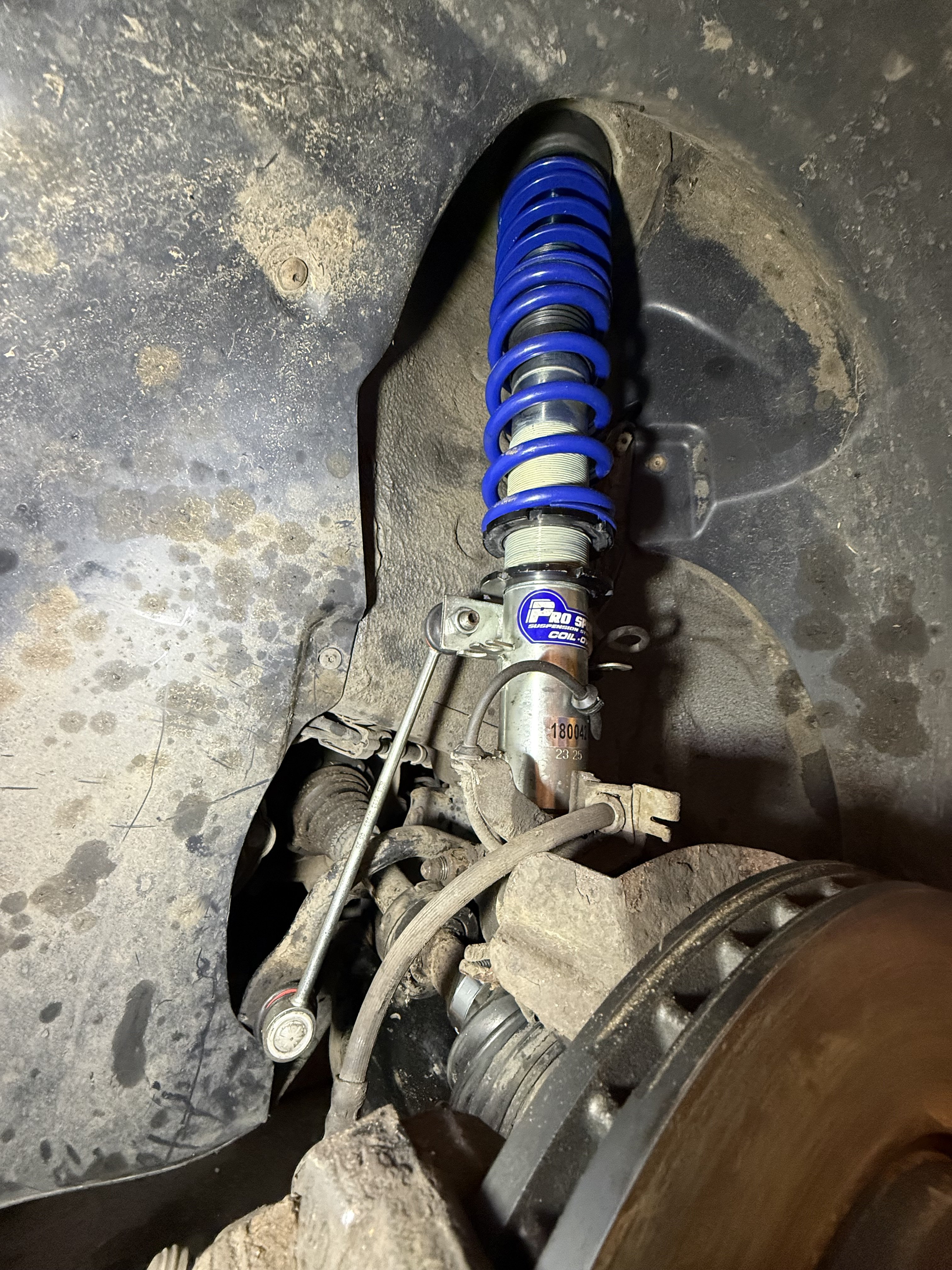

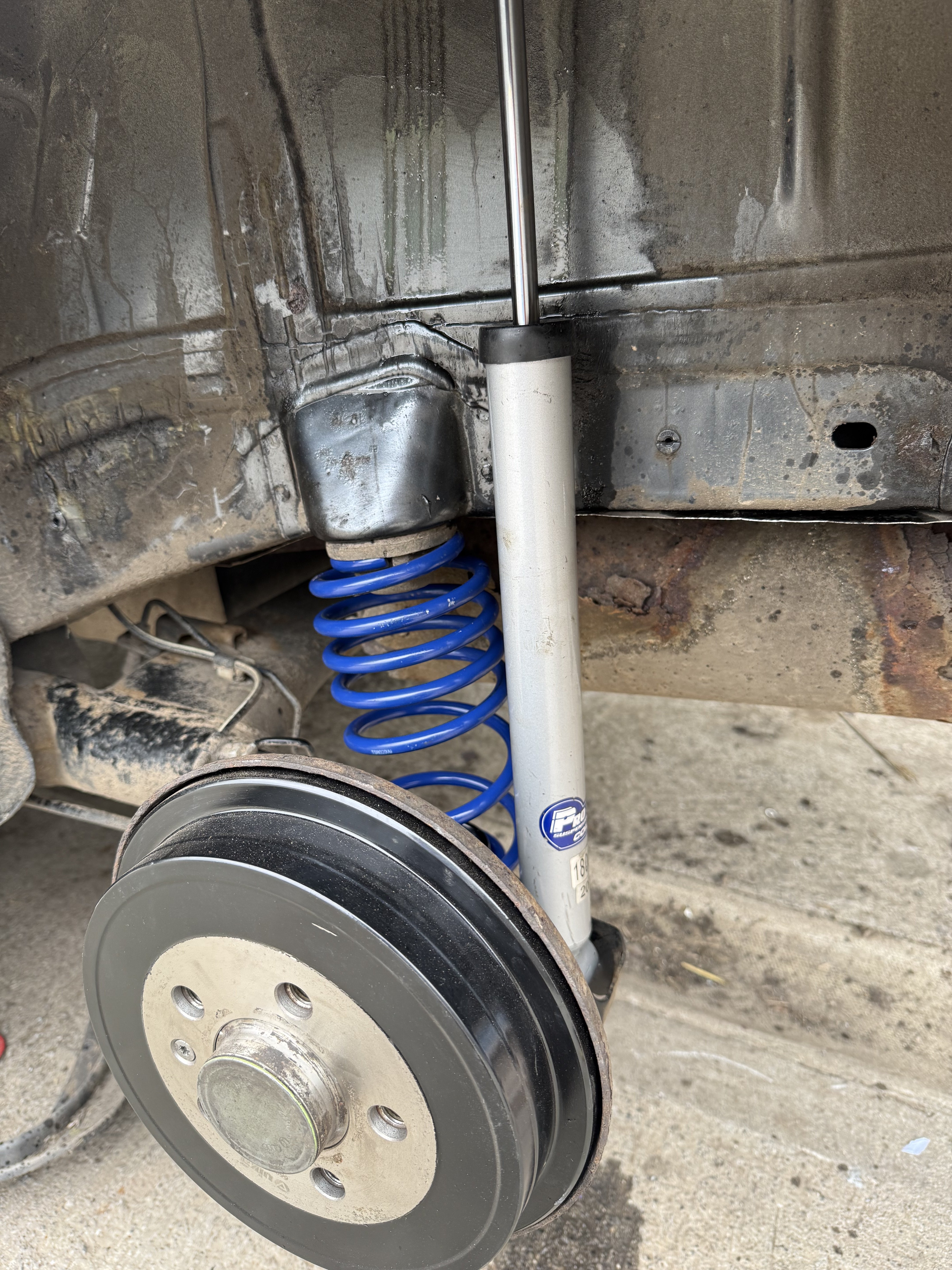

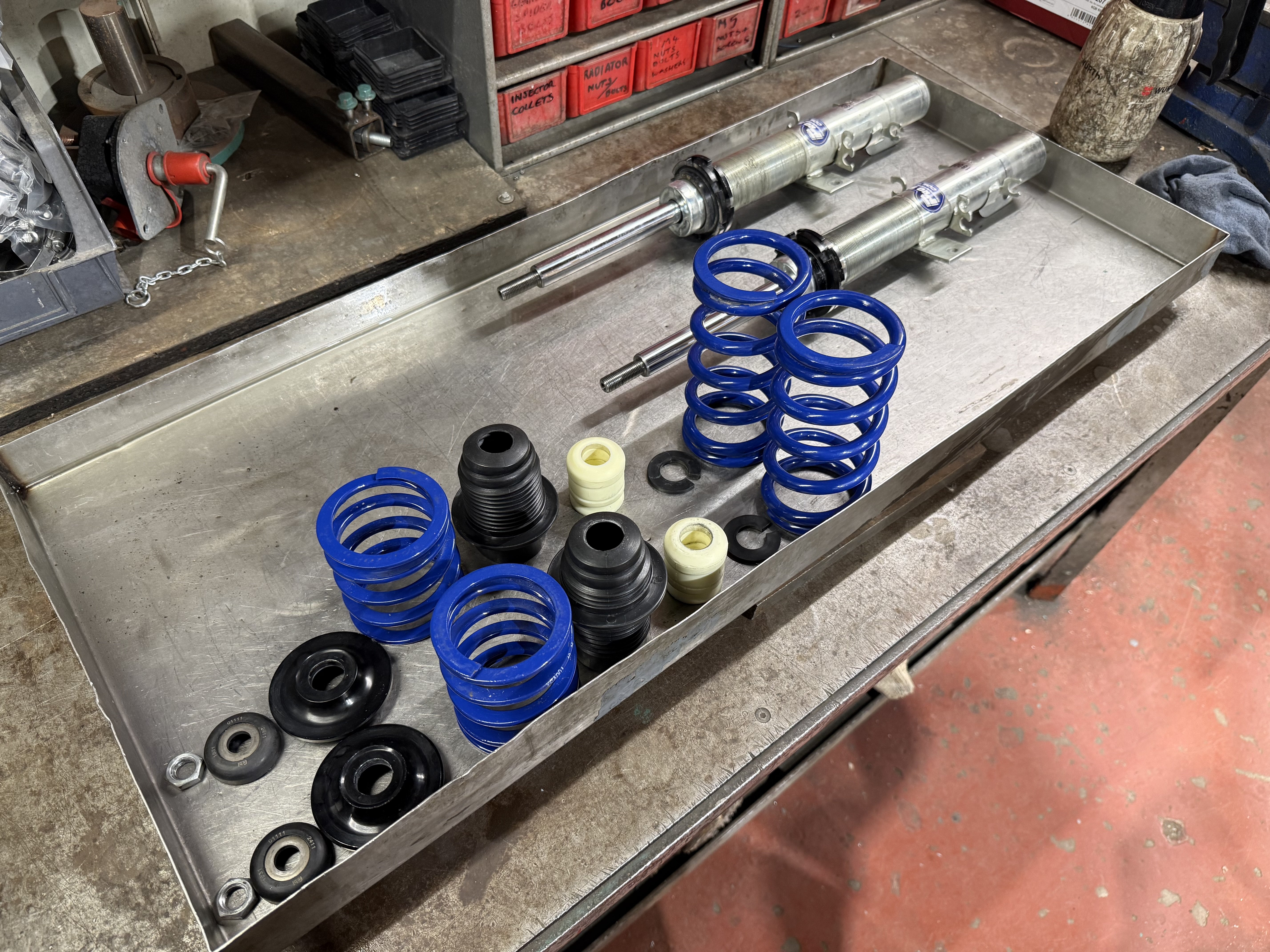

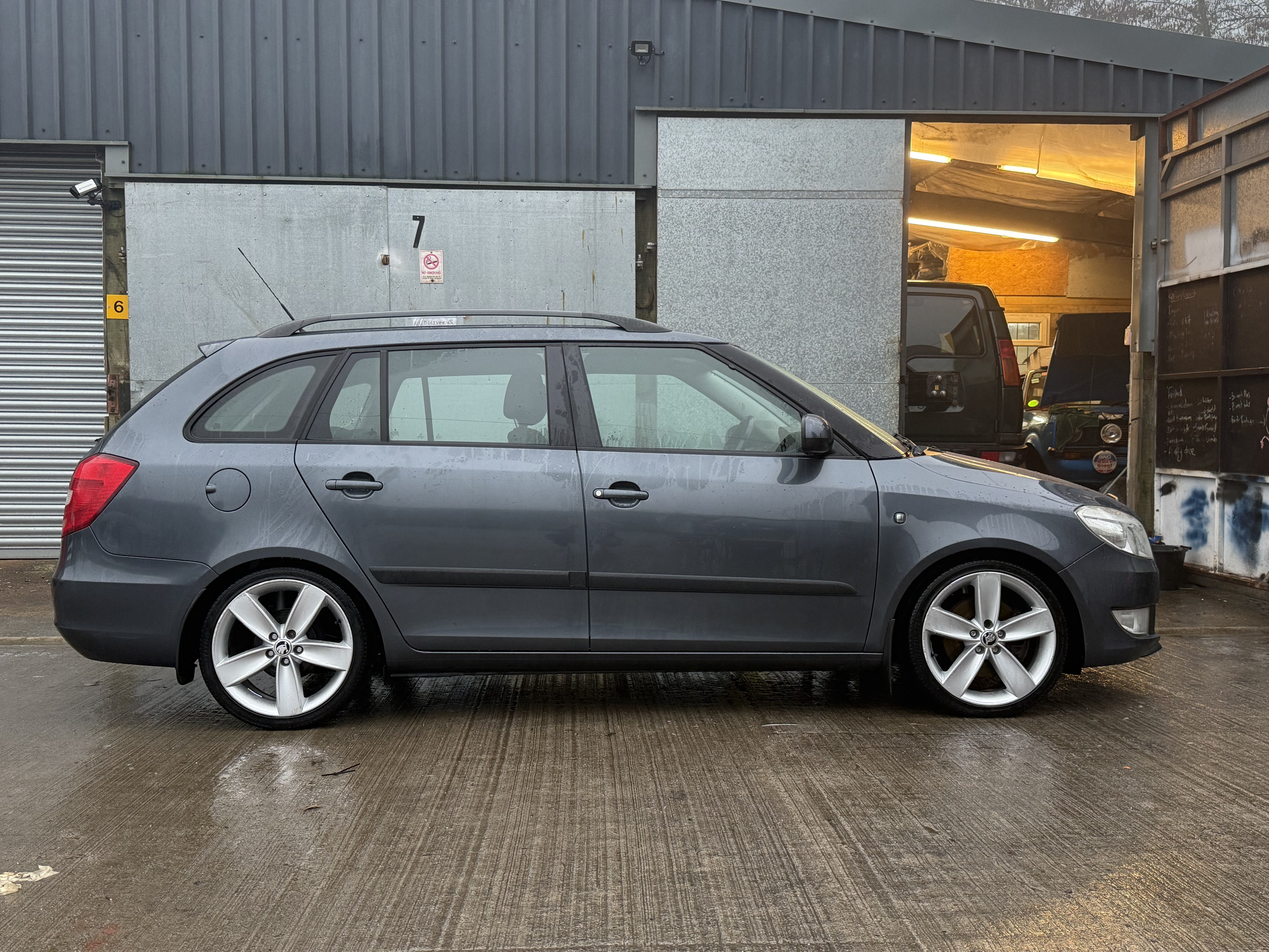

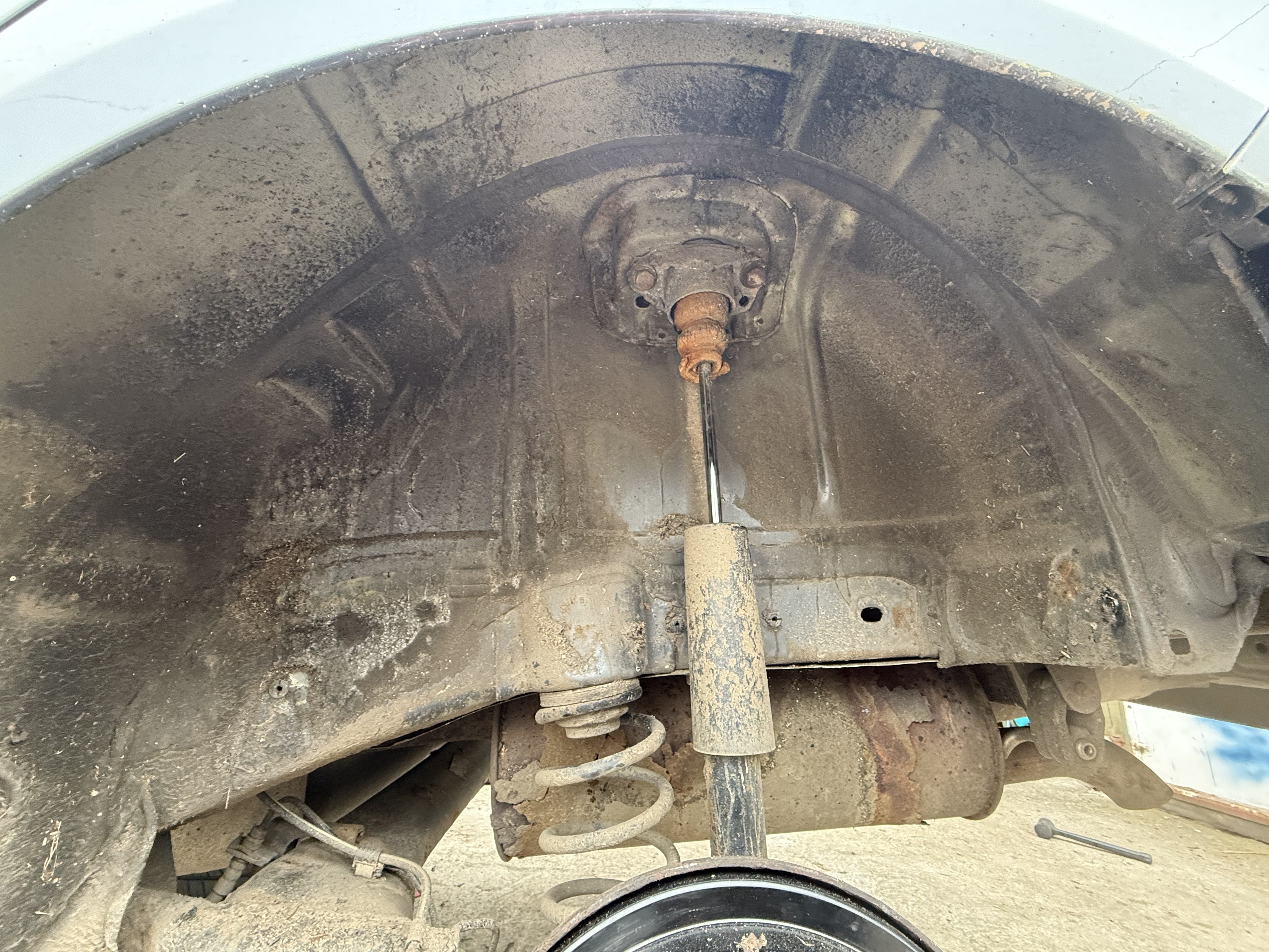

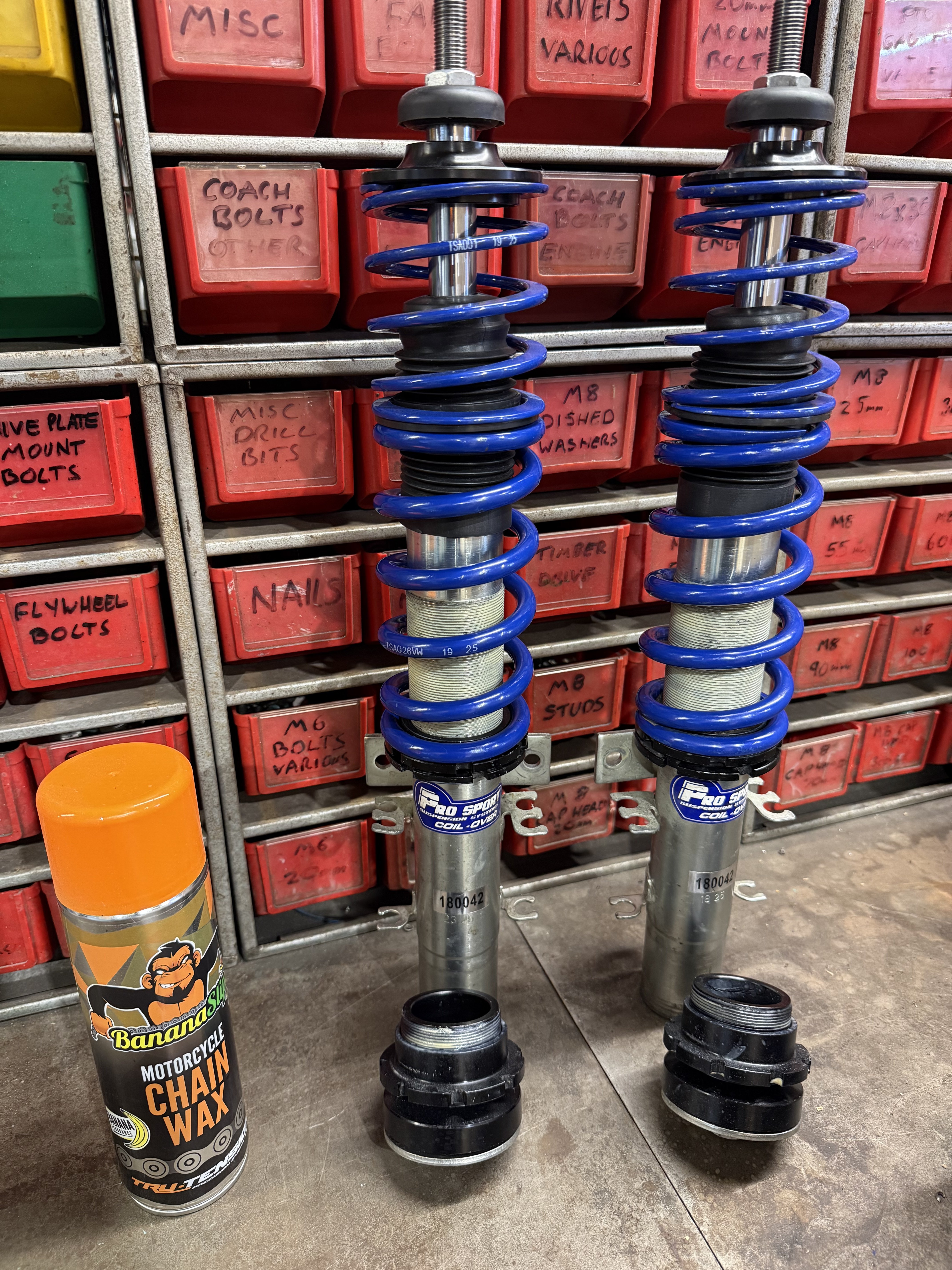

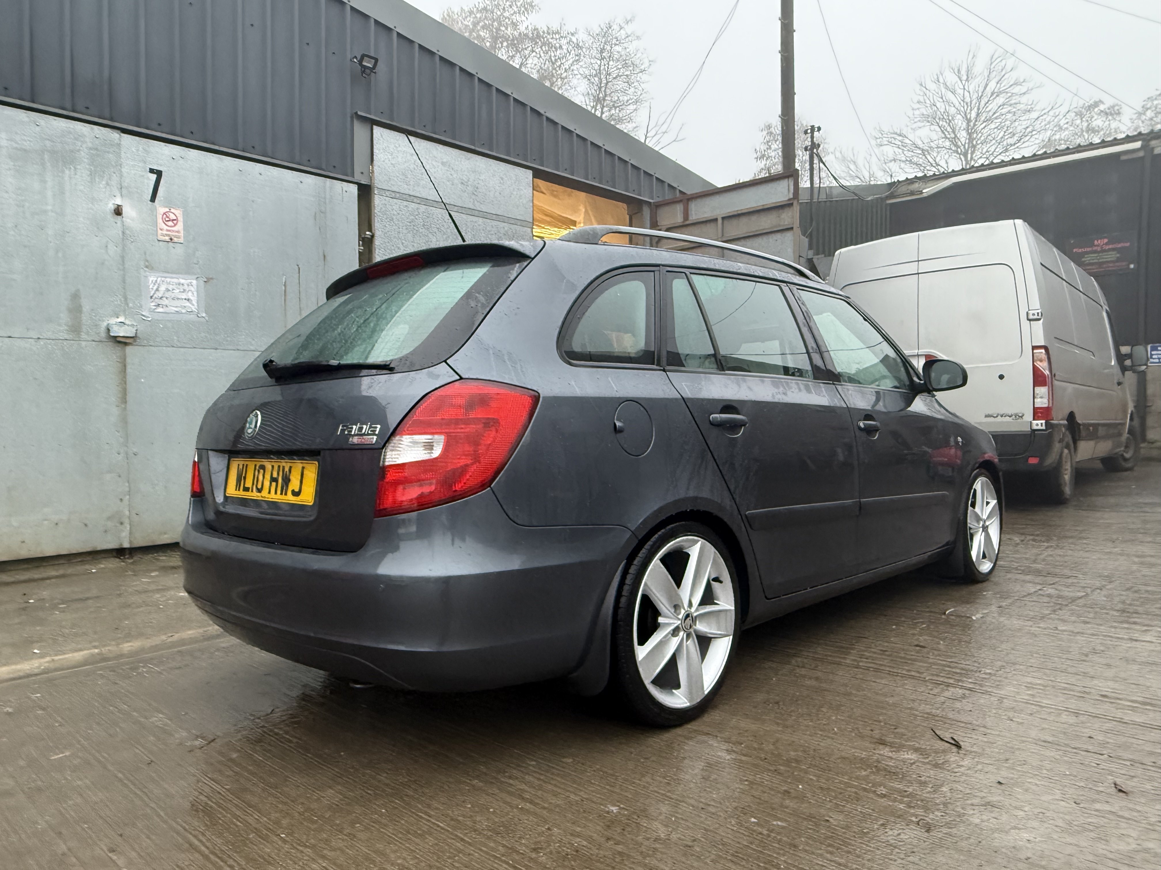

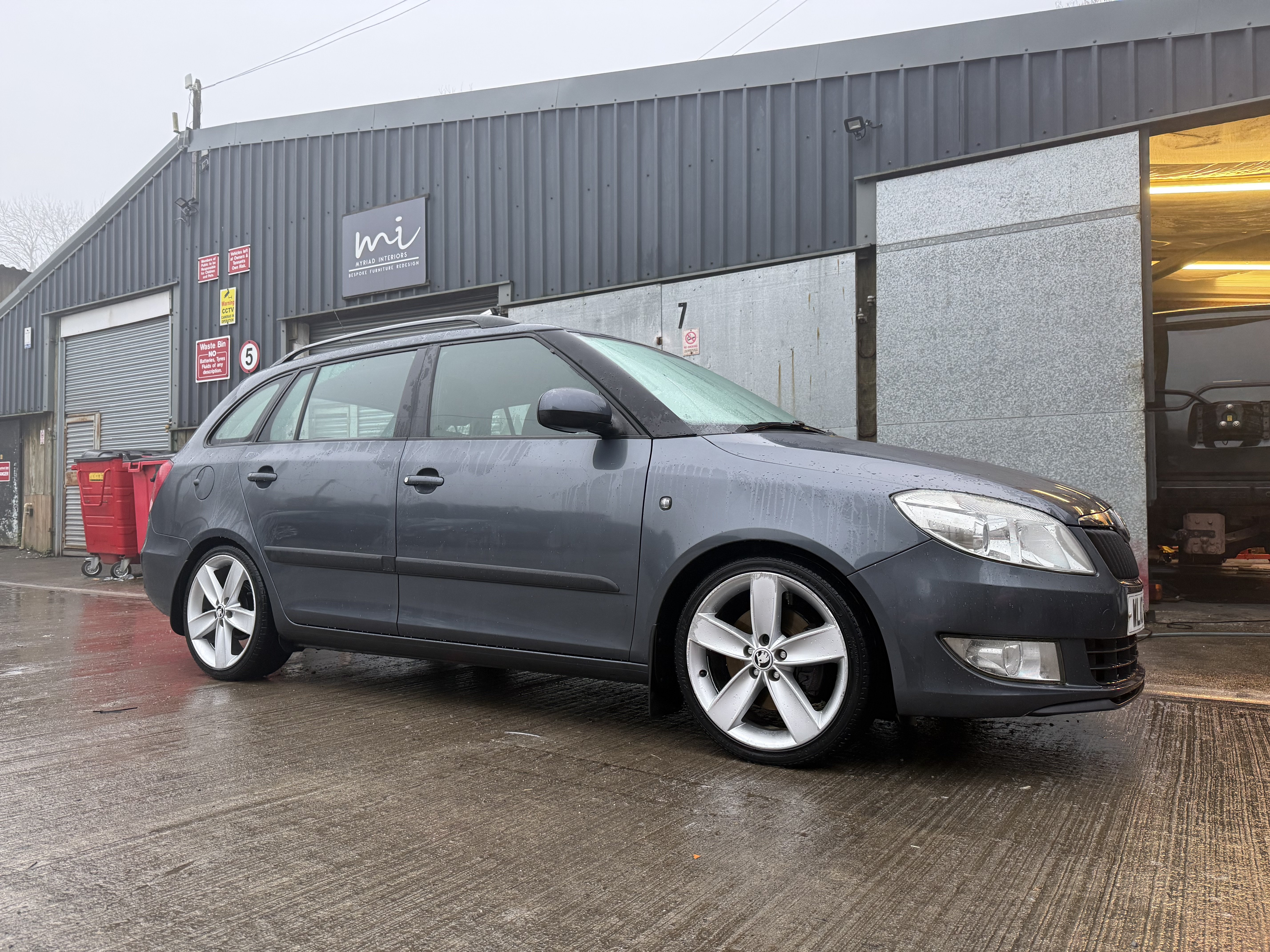

Well I’m a little behind on some updates so here we go again! 😁 On further inspection, I found the car had a broken suspension spring! Well I could have just replaced the spring, but where is the fun in that! I don’t need much of an excuse to mod and upgrade! 🤣 I looked on FB Marketplace and found someone selling a full set of Prosport coilovers with mondeo drop links at a reasonable price, so I bought them 👍 On delivery, I stripped and cleaned the coilovers which were almost like new, and I sprayed the threads with motorcycle chain wax to prevent the adjusters from corrosion and seizing. Next up was to fit the kit to the vehicle. I’m really happy with the results. I can’t go super low as I have a steep driveway to contend with but it has certainly made a difference!! 💪
