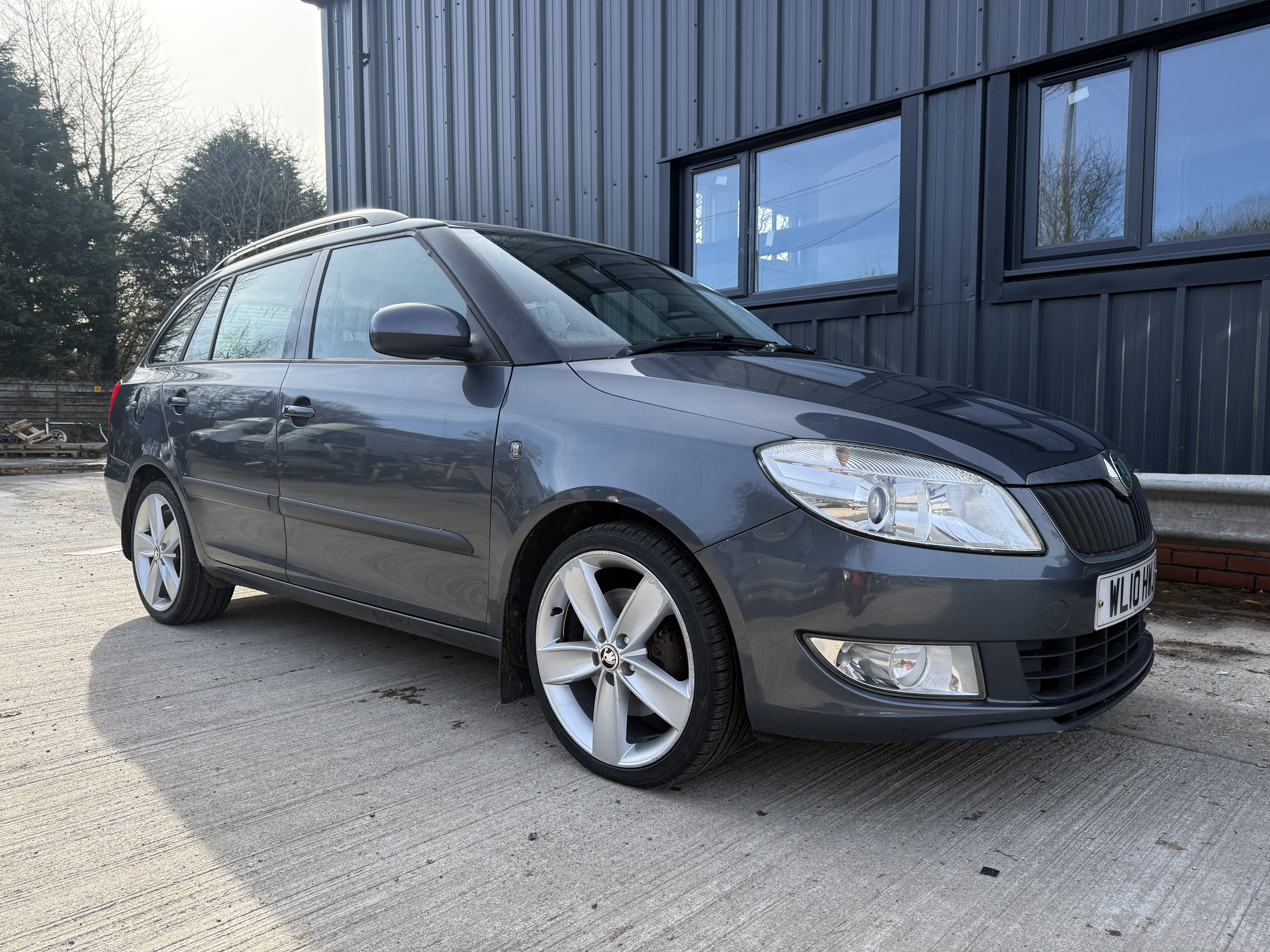

Well Iโm a little behind on some updates so here we go again! ๐ On further inspection, I found the car had a broken suspension spring! Well I could have just replaced the spring, but where is the fun in that! I donโt need much of an excuse to mod and upgrade! ๐คฃ I looked on FB Marketplace and found someone selling a full set of Prosport coilovers with mondeo drop links at a reasonable price, so I bought them ๐ On delivery, I stripped and cleaned the coilovers which were almost like new, and I sprayed the threads with motorcycle chain wax to prevent the adjusters from corrosion and seizing. Next up was to fit the kit to the vehicle. Iโm really happy with the results. I canโt go super low as I have a steep driveway to contend with but it has certainly made a difference!! ๐ช

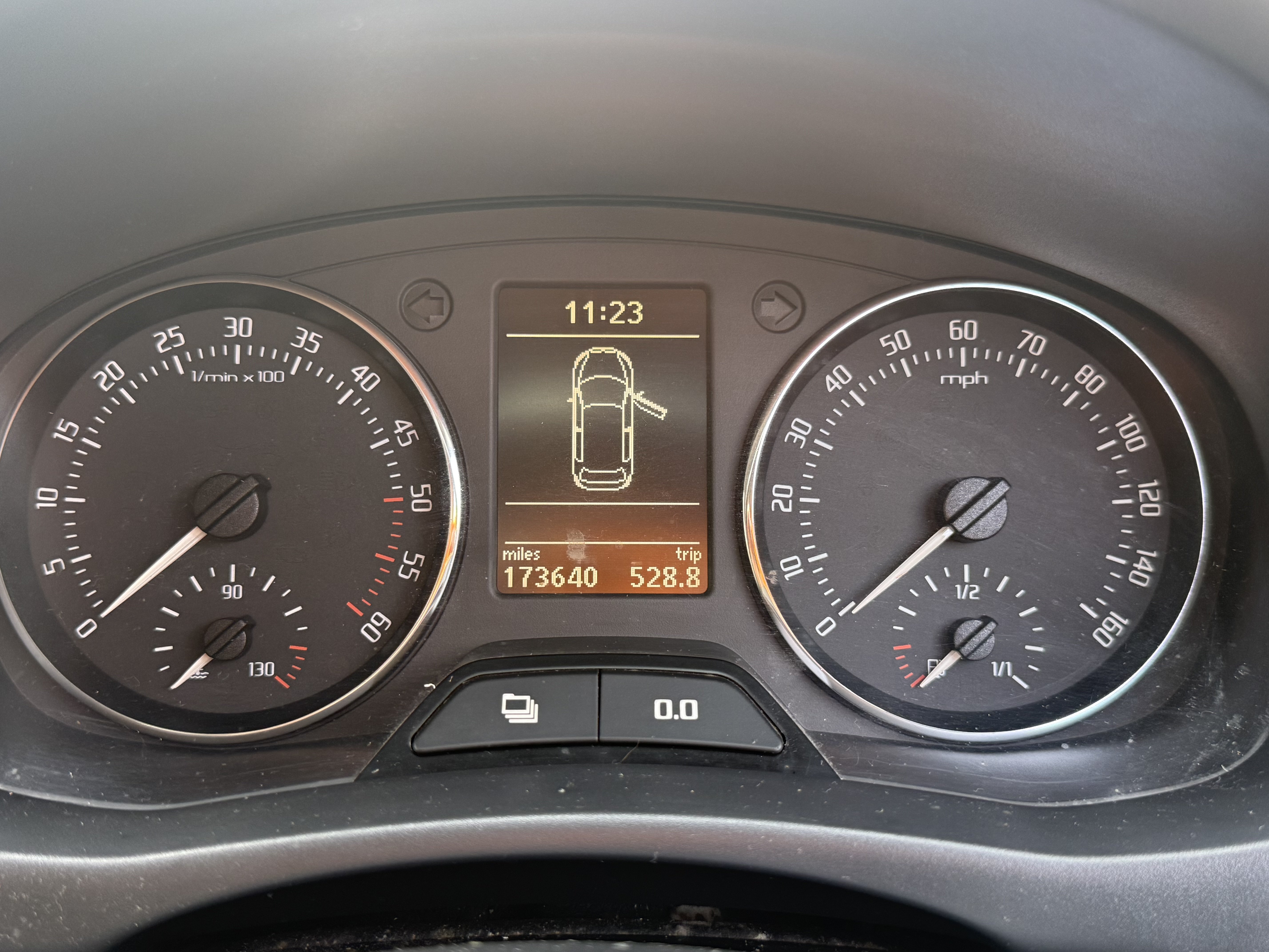

1.6TDI manual, displayed MPG over shorter distances?! So Ive been driving my 1.6TDI Fabia around for the last week since I got it in the road with a fresh MOT. Seems to be driving ok. Now Iโm still getting to know it as itโs a new car to me, so I was wondering what sort of MPG people are getting in theirs on similar driving to me? Currently Iโve been driving from home, about 3 miles around town, to the duel carriageway and then drive about 25 miles to my work which is just off that road. Travelling at 60-70mph using cruise control for most of it is getting about 38 MPG over that distance with the MPG creeping up over that distance. Today I did about 150miles, mostly on duel carriageways but some B roads and town driving too. Again 60-70 for most of it I was getting about 48 MPG. Now I hear of many people getting 60+ MPG from these but is that like a long several hour motorway drive at under 60mph to achieve that?? Car has just had an oil and filter change but I do still need to do air filter and fuel filter to complete the servicing. Wondering if all is good or I need to look into something? Thanks all ๐ EDIT: The last few days Iโm Also getting a high idle of around 1100rpm all the time even when hot, but if I blip the throttle it will drop to the usual 800rpm. If I start driving again it will go back up to 1100rpm almost every time I stop at traffic lights etc. getting annoying and didnโt do that a few days ago!

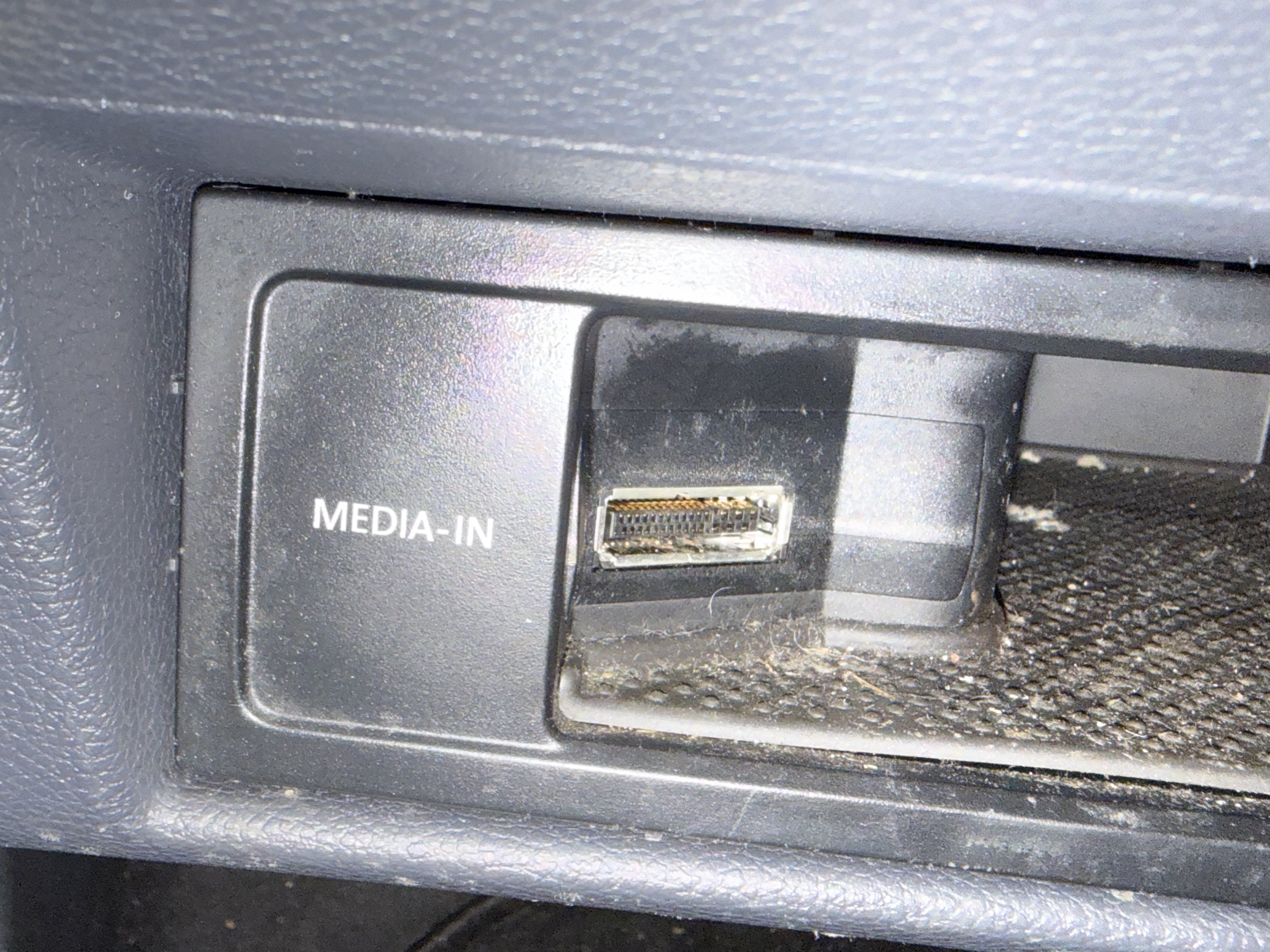

Yes thatโs what Iโm on about. I know my unit doesnโt have Bluetooth as standard. You can buy Bluetooth adapters and wired adapters to connect my phone to my current factory unit via this socket. Iโm just looking for information as to what ones are best and what are the different functions for each type. They are all on Amazon and EBay etc.

Thank you but I know what it does, but I want to know what different types of leads or adaptors are available and what they do? Bluetooth compared to wired connections and what functions each one gives?

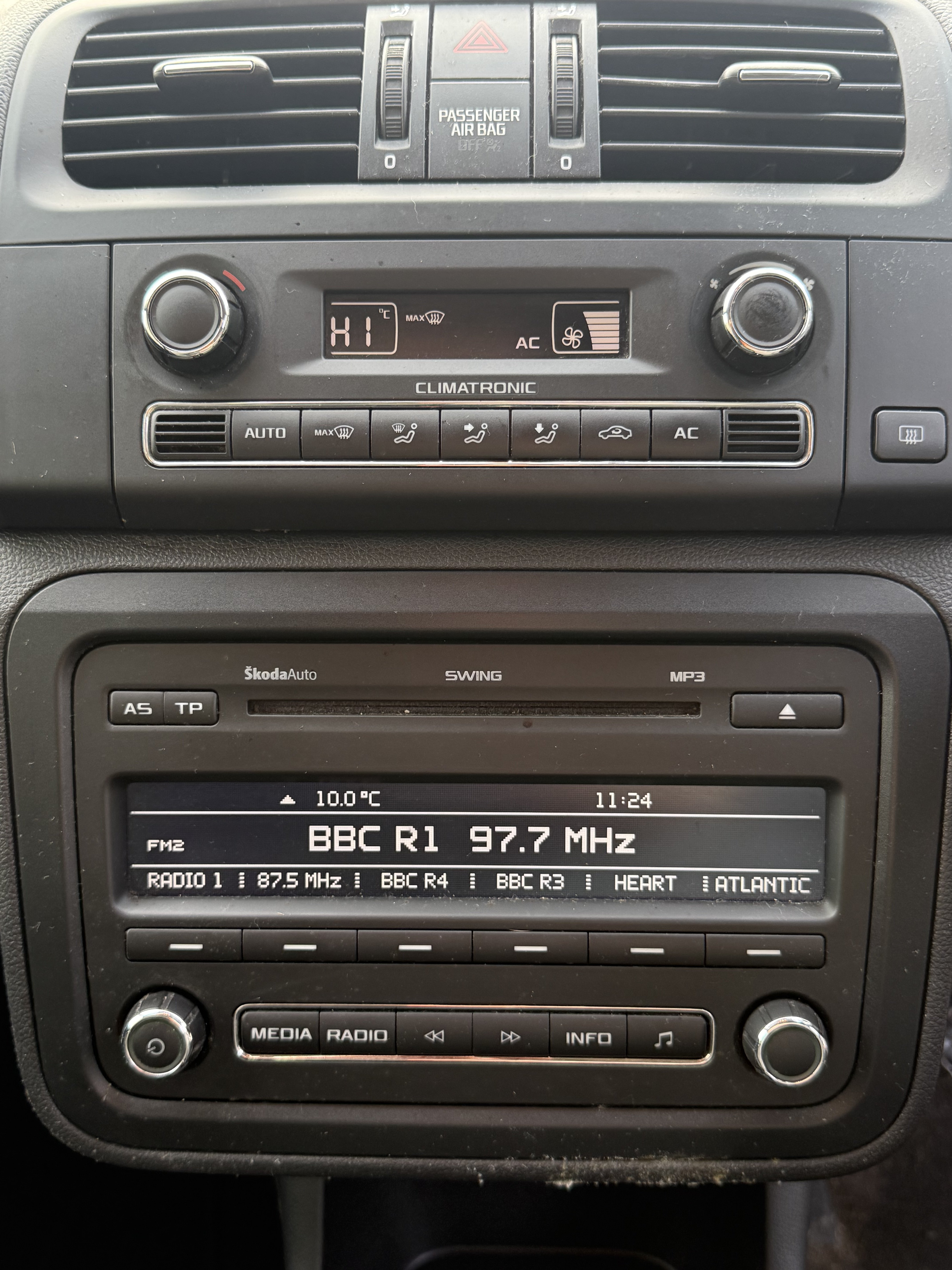

Morning all ๐ Iโve recently bought a 2010 facelift Fabia Elegance, and Iโve noticed itโs got this socket in a little pocket under the glovebox. Now, I know it is for connecting various music storage to the car stereo but I have seen it called various things across the VAG range with various uses. Can someone give me the heads up on what my ล KODA version is capable of and what modern gadgets are available to connect to it please? I have a newish iPhone 16+ which uses the USB-C type connection as well as Bluetooth. Iโm considering both connection types depending on the functions that each one can give me. Thanks all ๐๐

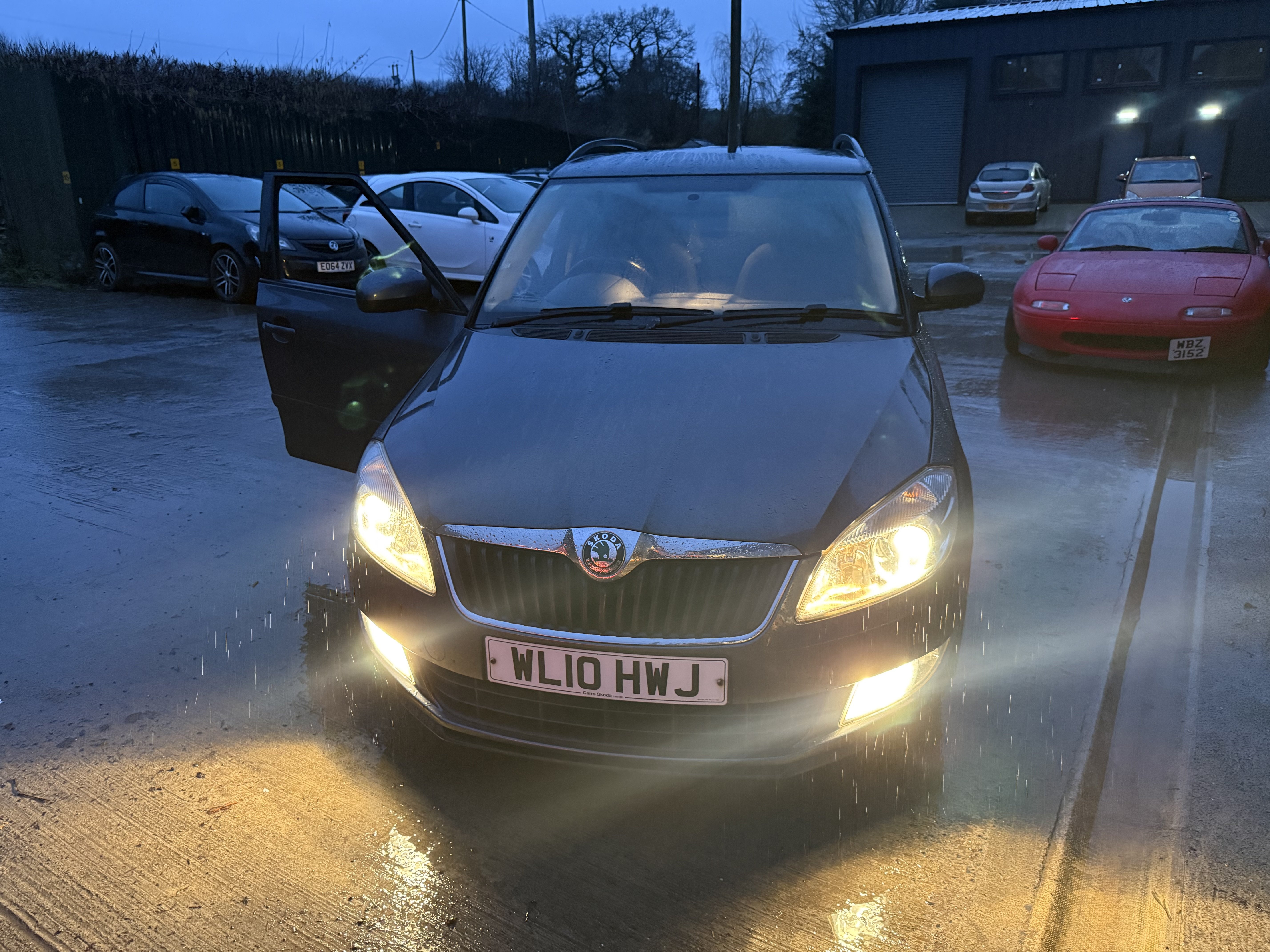

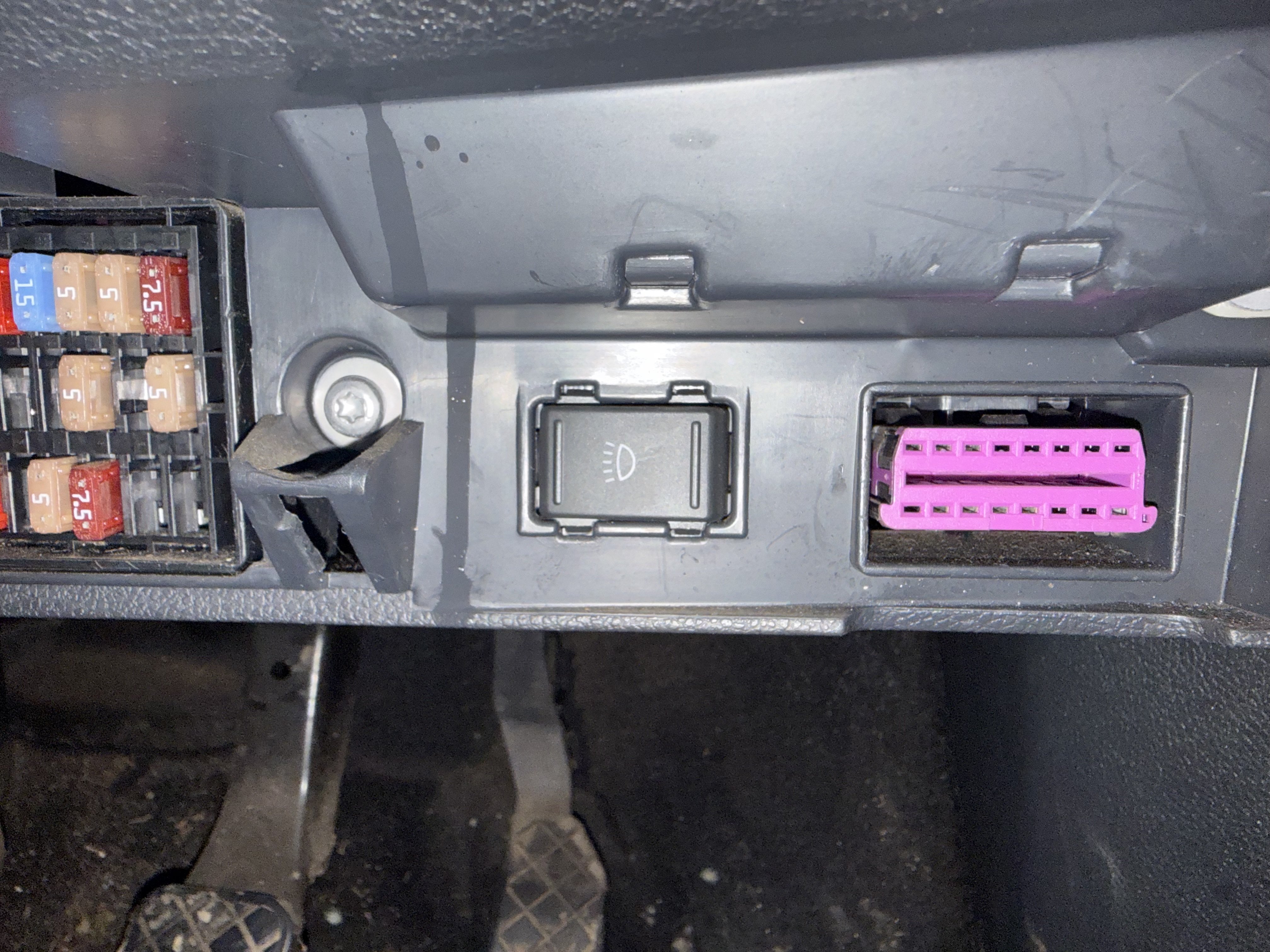

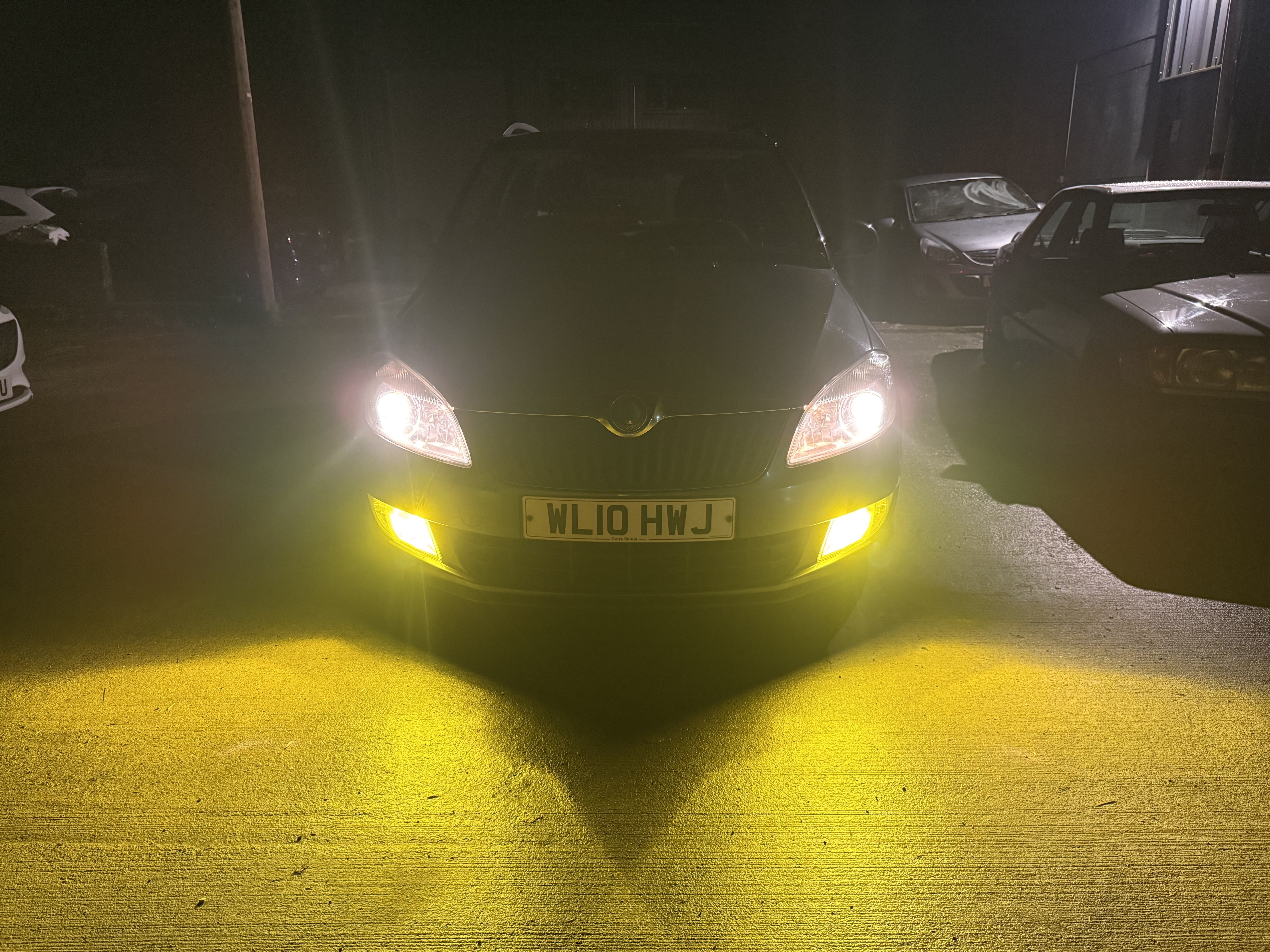

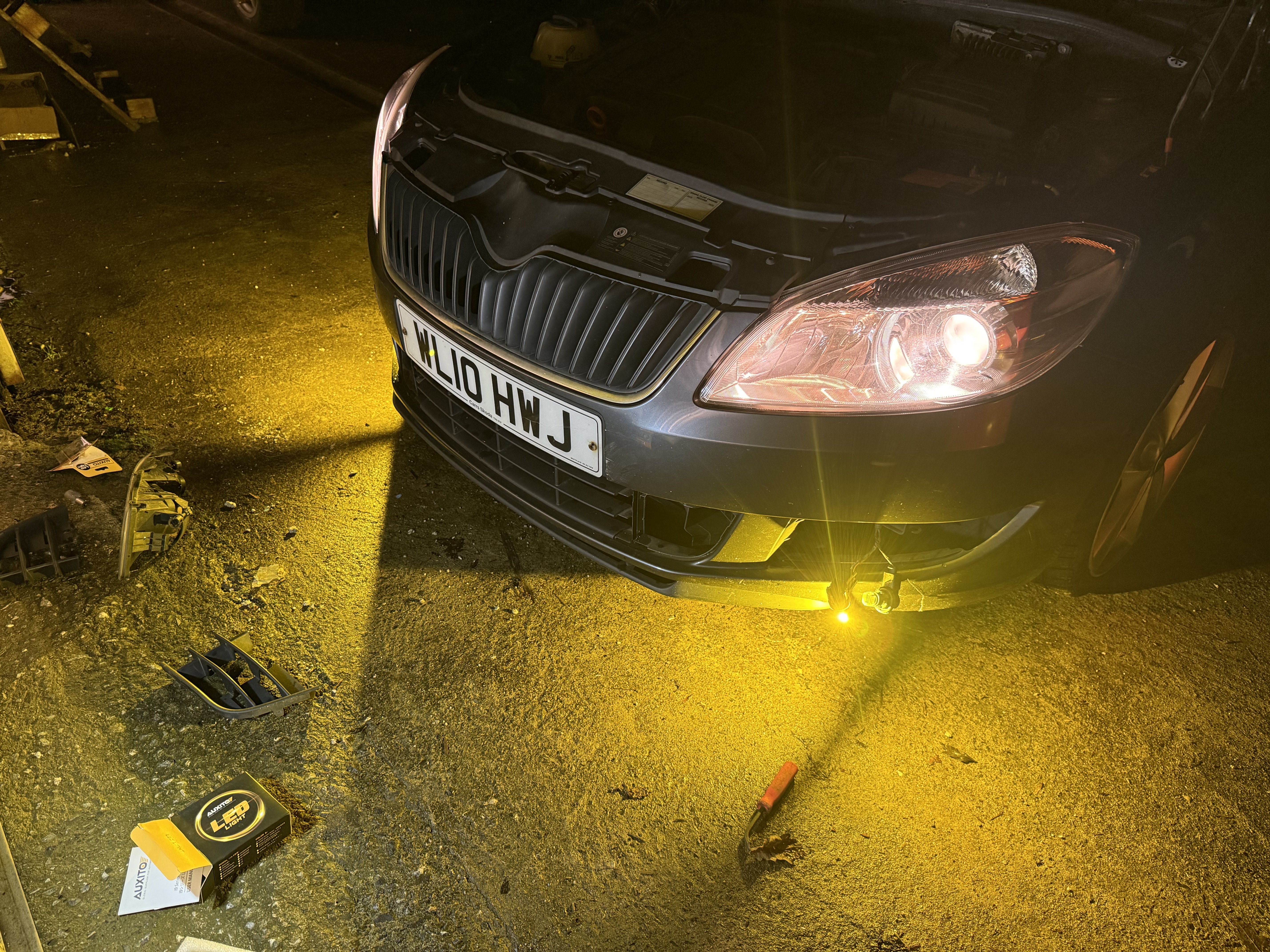

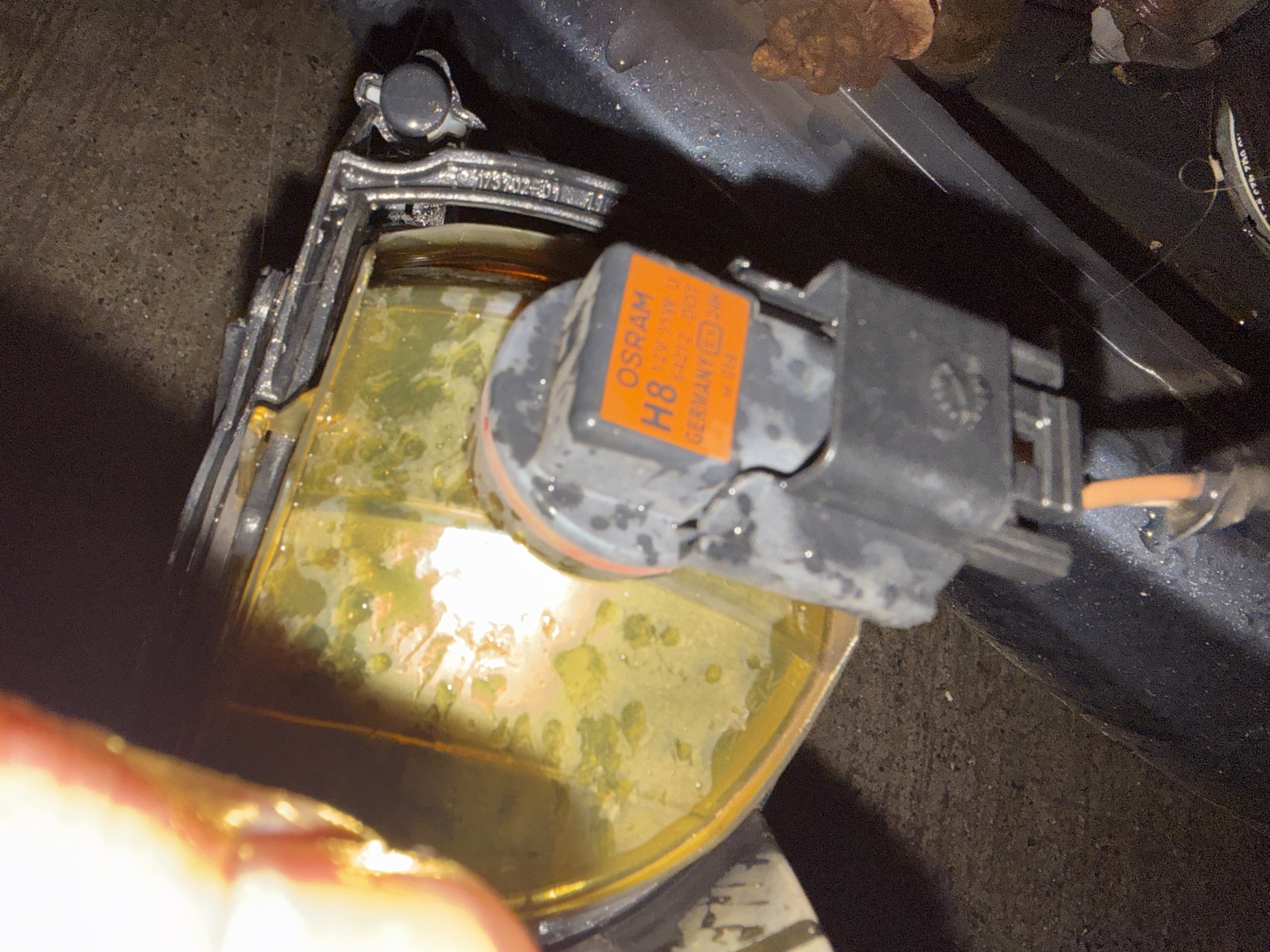

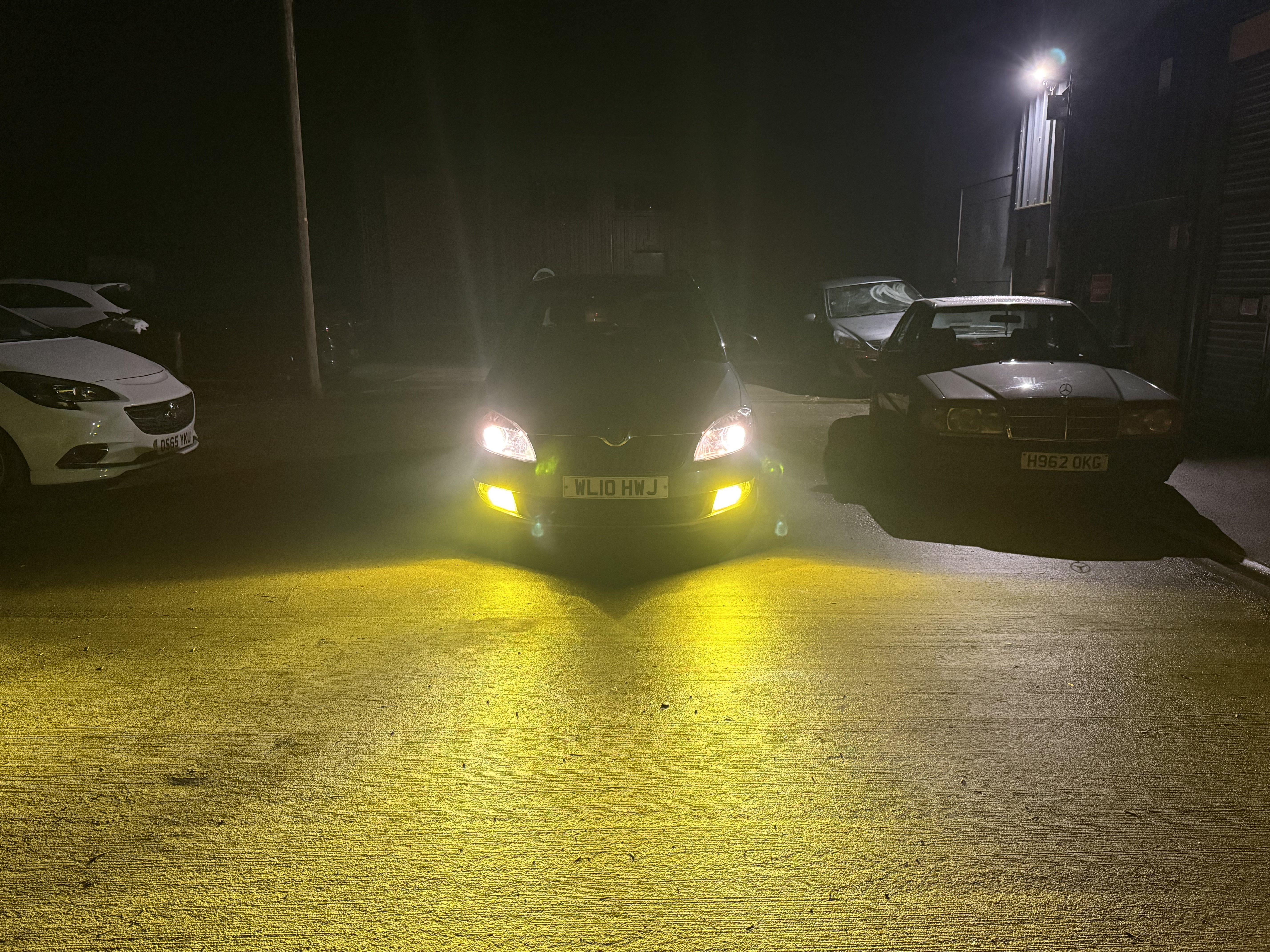

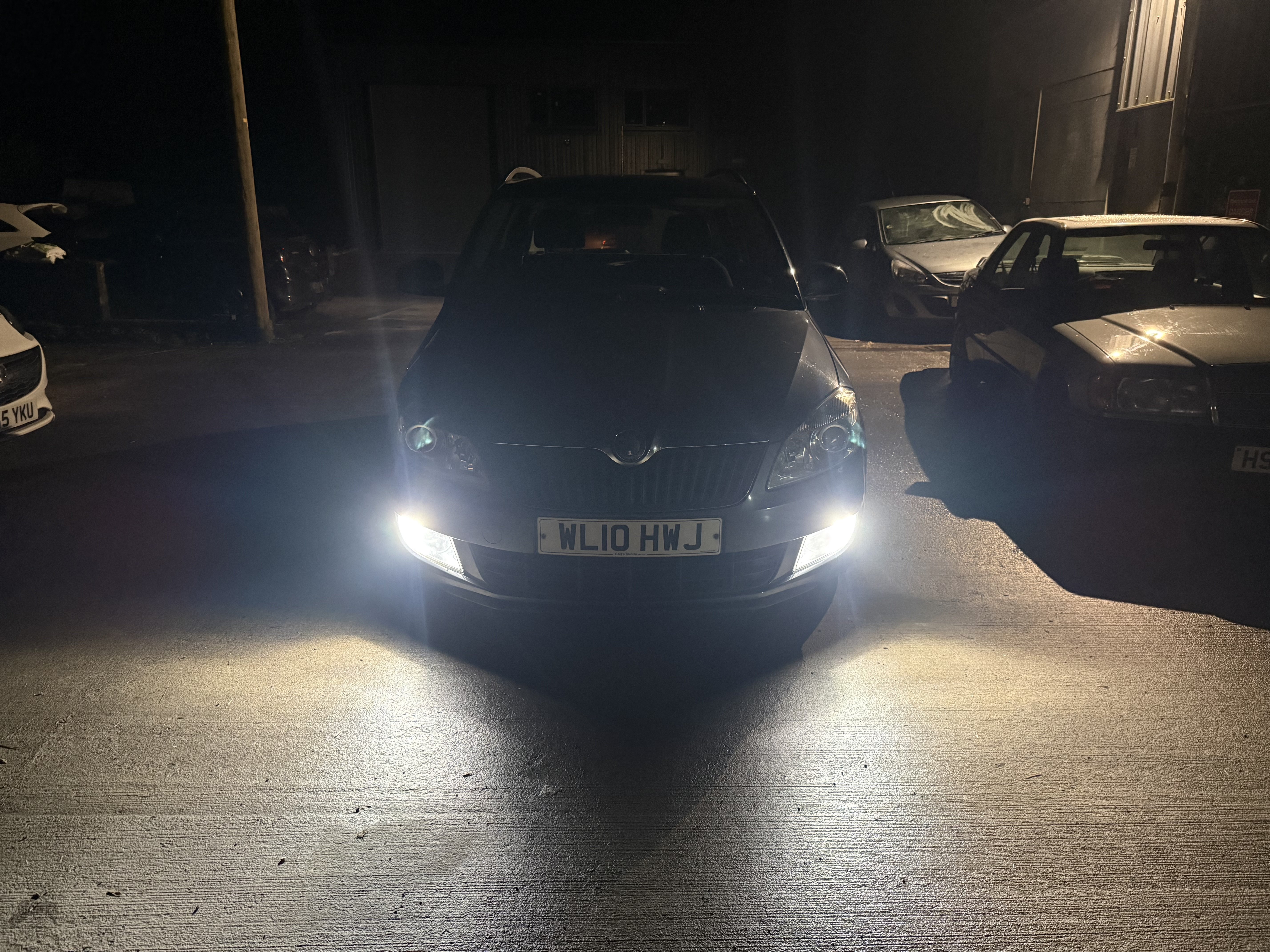

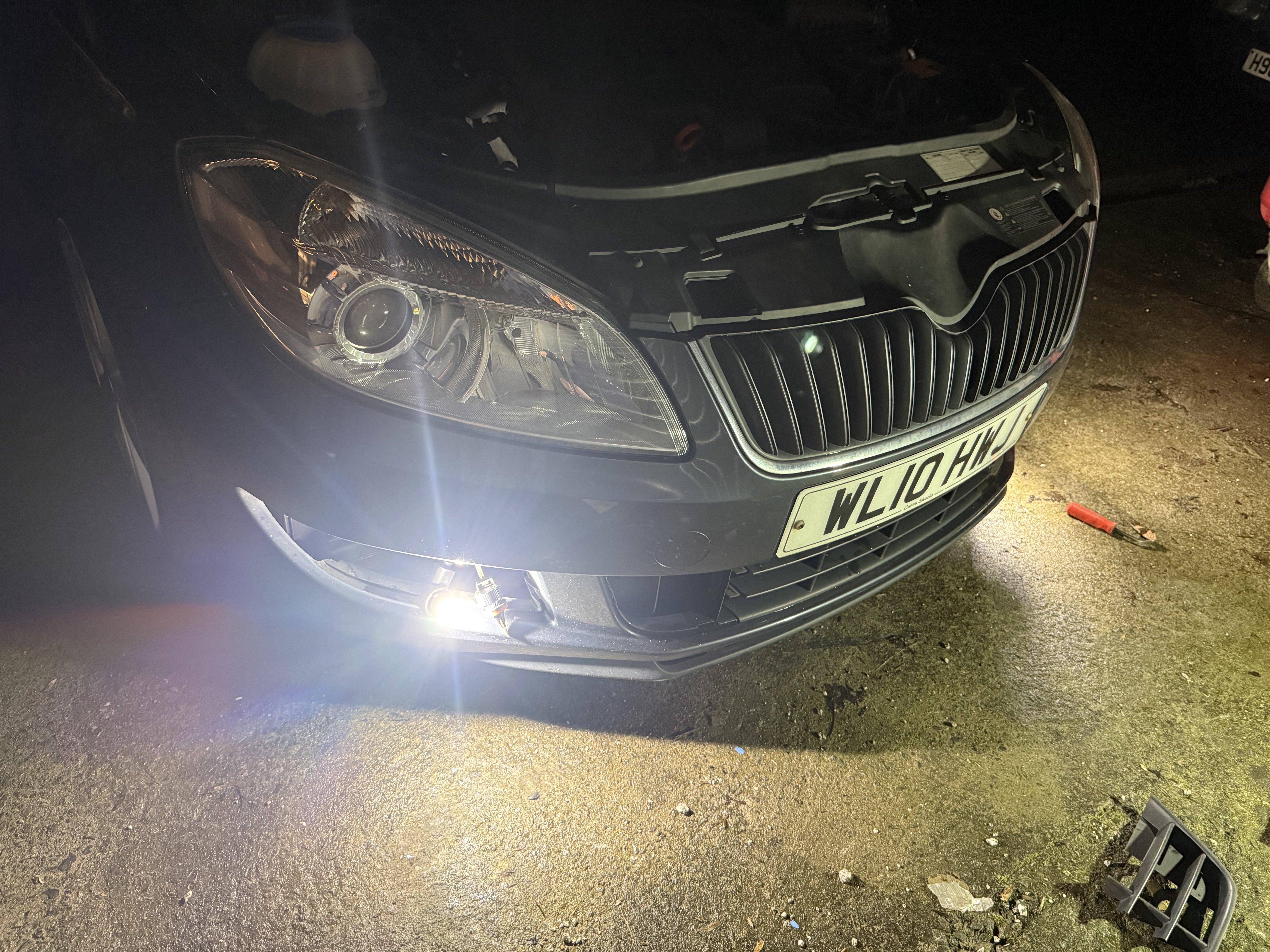

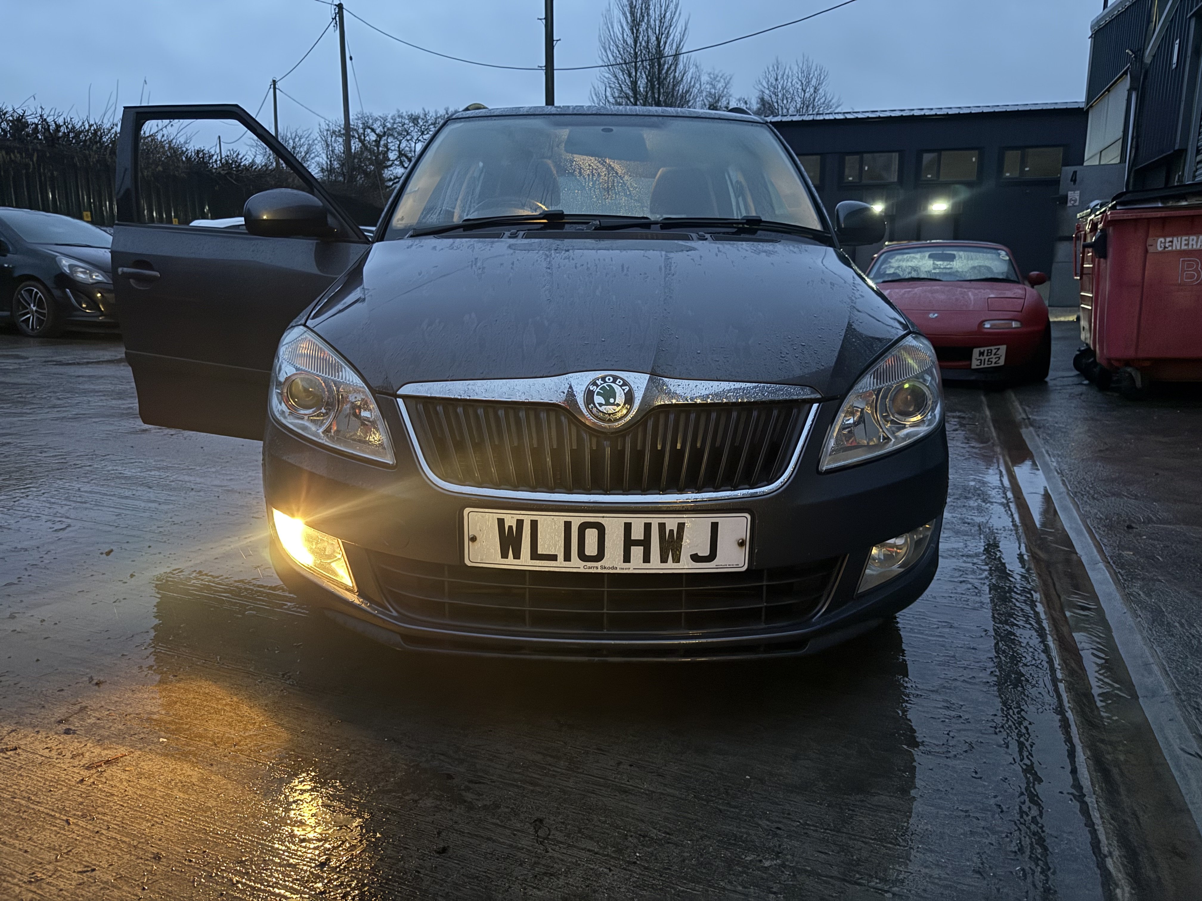

The next thing I did was to activate my DRLs with the switch next to the fuse box plus adding the fuse! The standard bulbs werenโt great and one had blown, so I changed them for some white LEDs. I also added some yellow LEDs for fog lights. Iโll probably upgrade more bulbs as I go! ๐

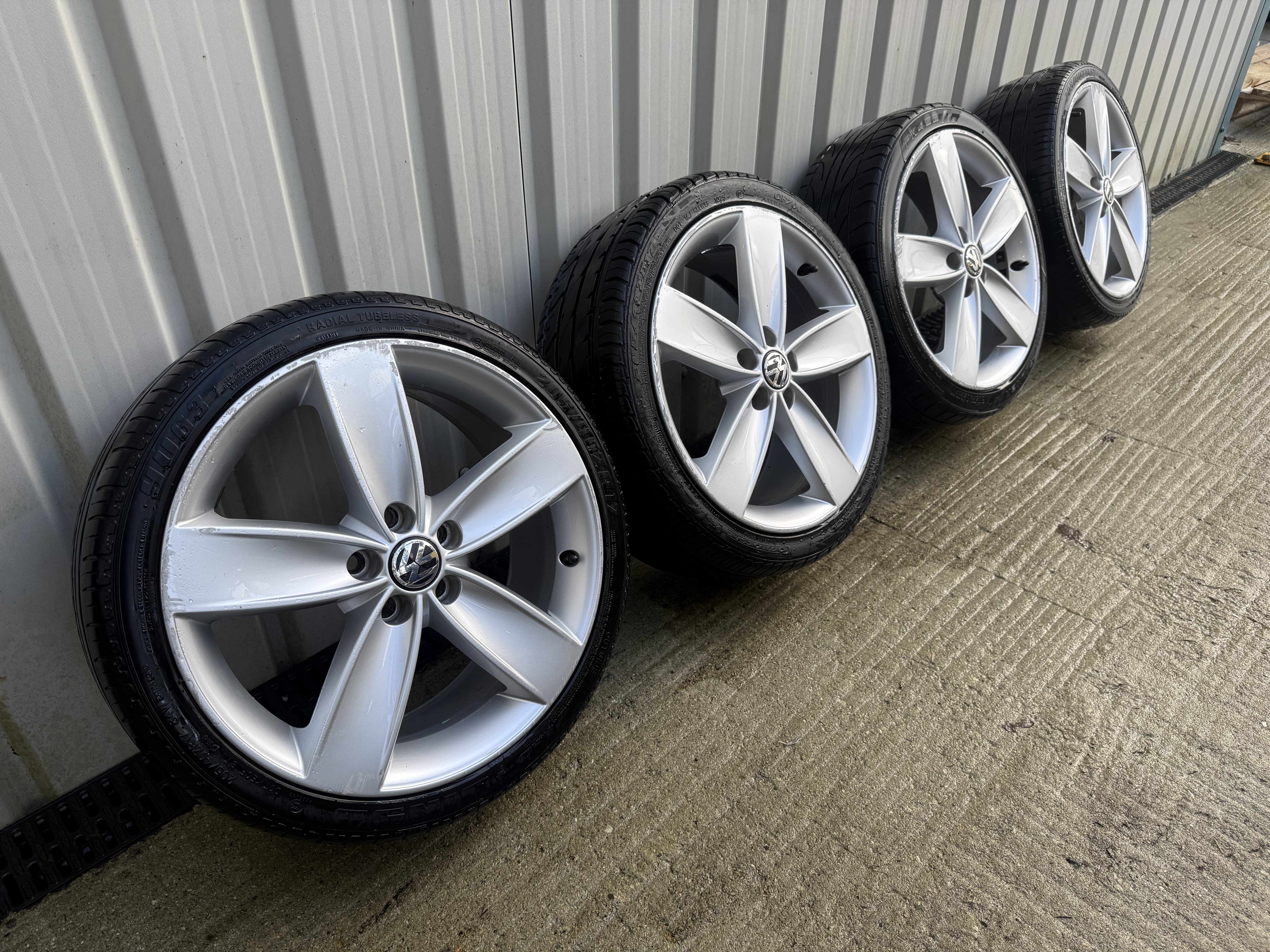

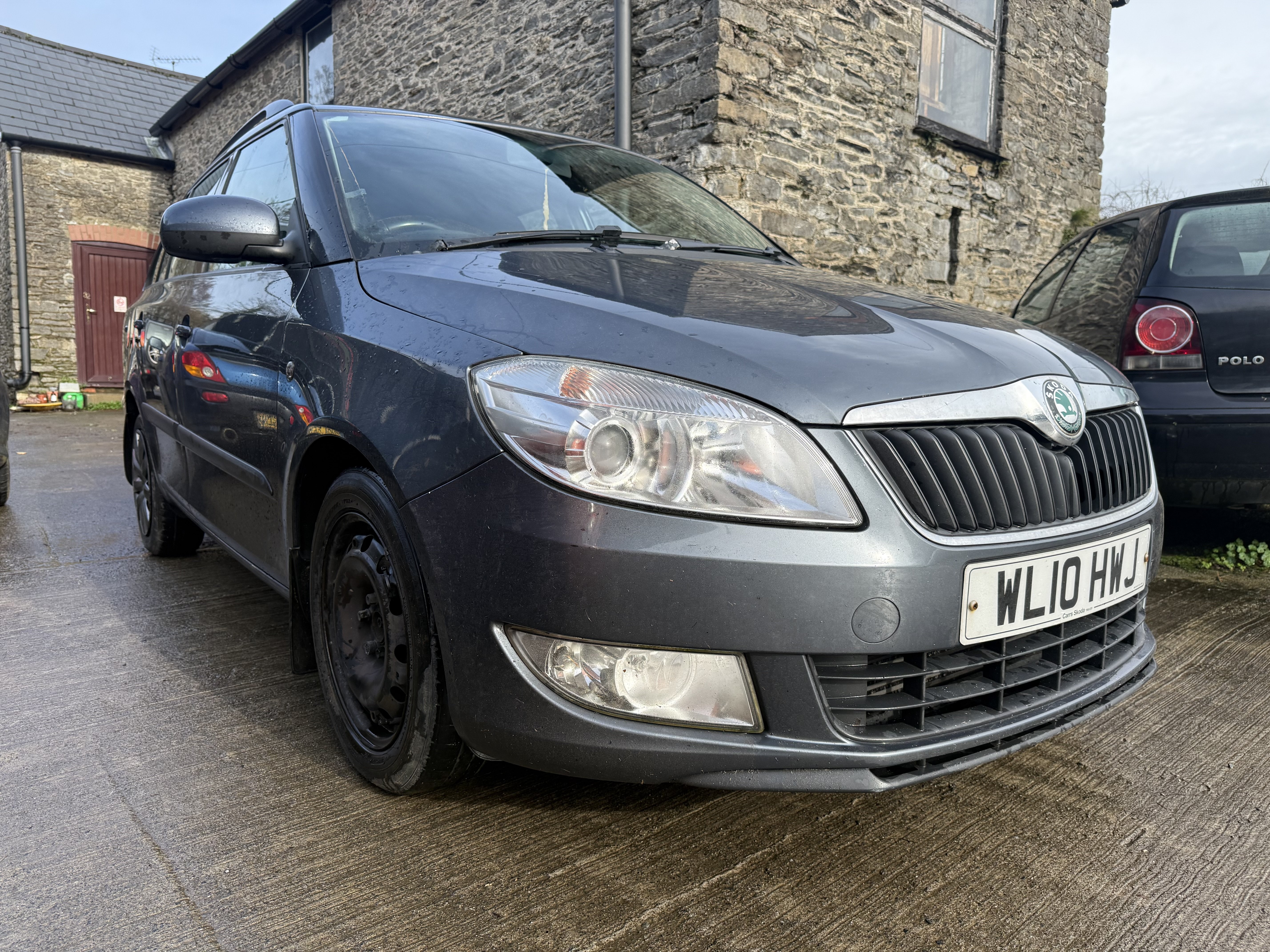

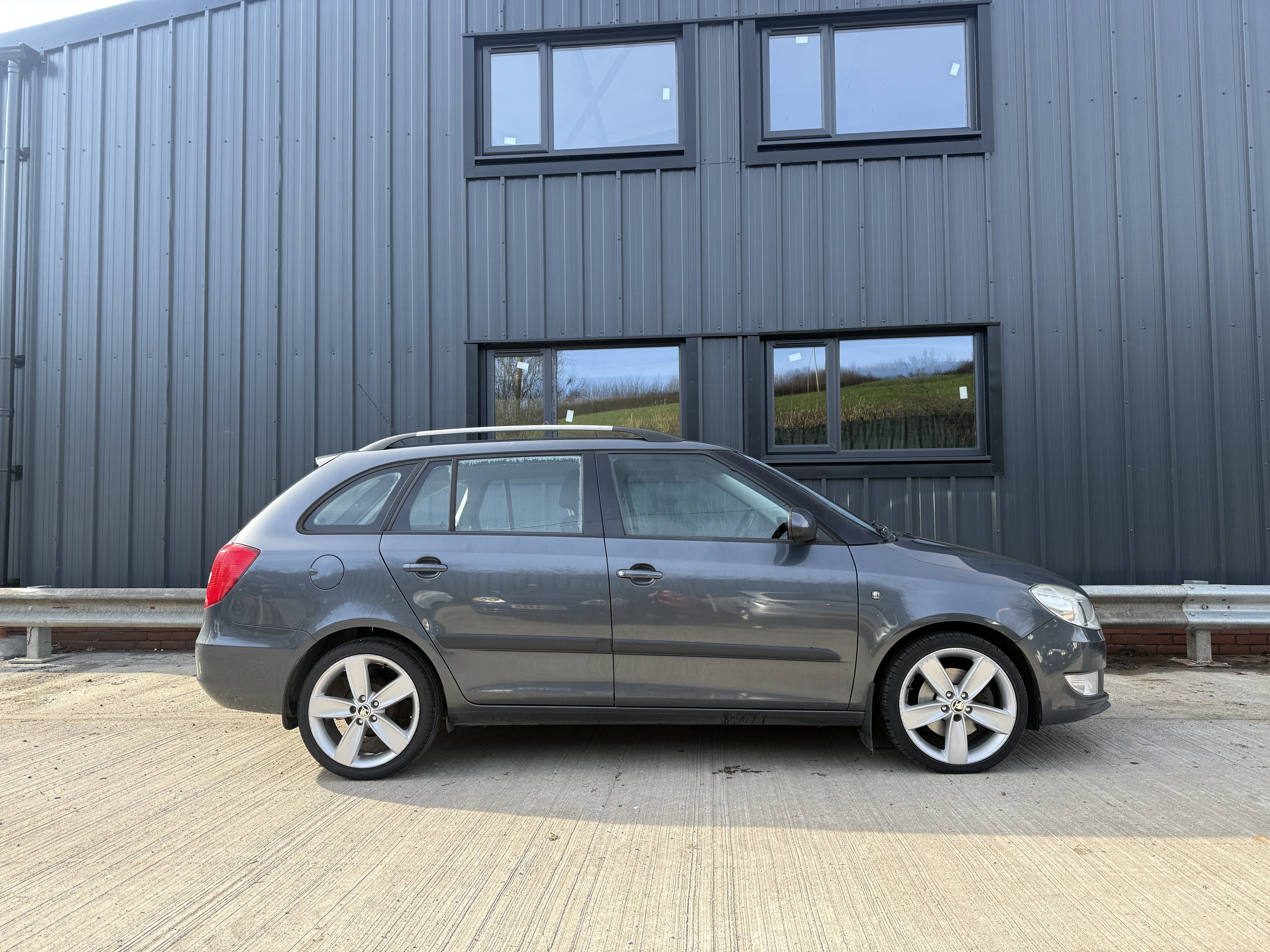

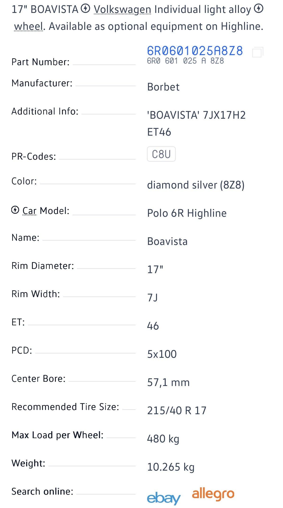

Its first mod time ๐ I needed some tyres, so I used that as an excuse to buy some alloys with tyres ๐ Keeping to my budget theme, I hunted on FB marketplace and found some slightly rare VW/Borbet 17โ Boavistas, which was an option wheel on the Polo 6R Highline. They were a bargain price (and I paid less than the advert states ๐) as they were a bit kerbed but Iโll give them a referb later ๐. Conveniently they are exactly the same size and offset as the 17s found on the Fabia Monte Carloโs so fitment is not an issue ๐

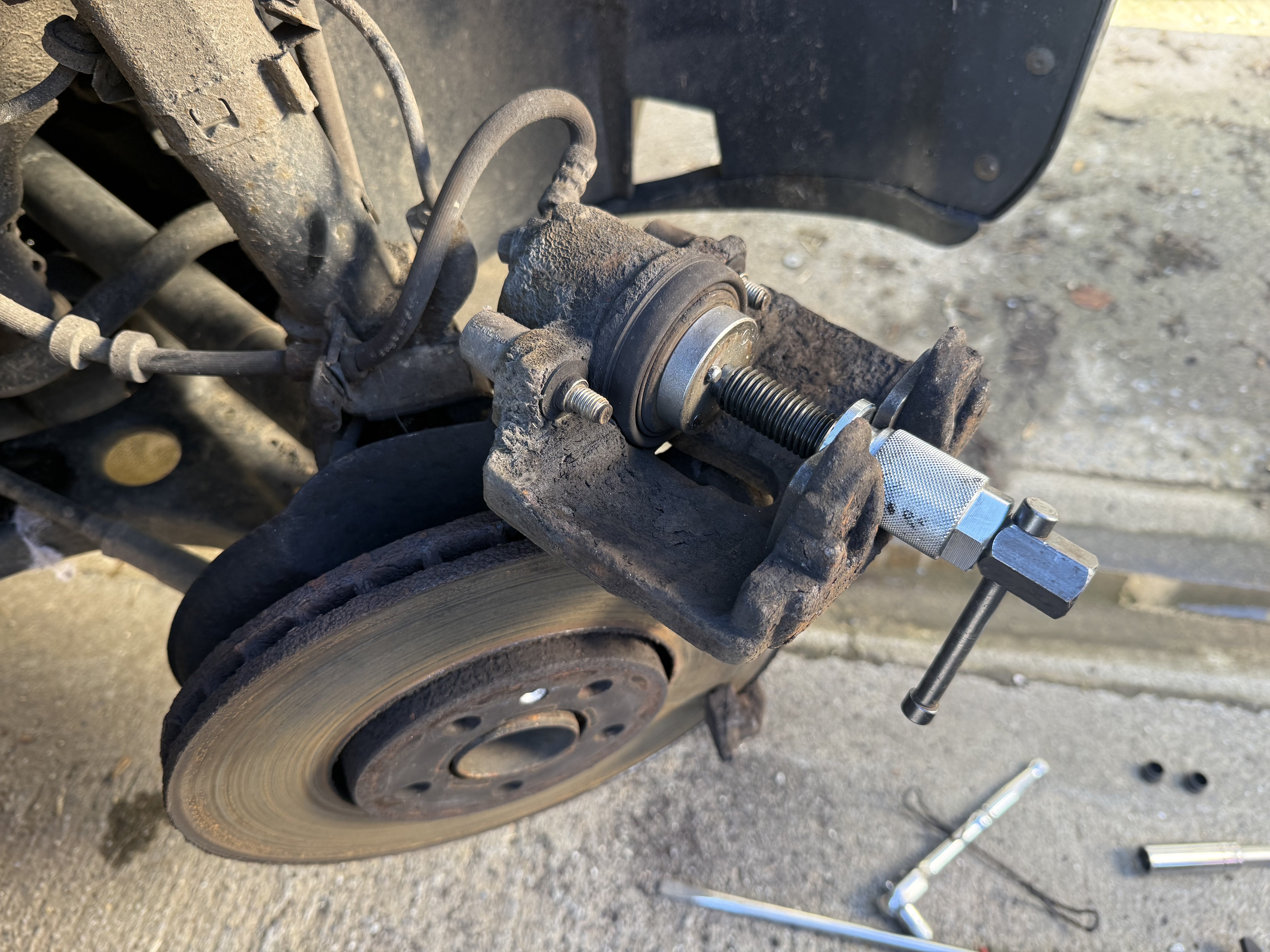

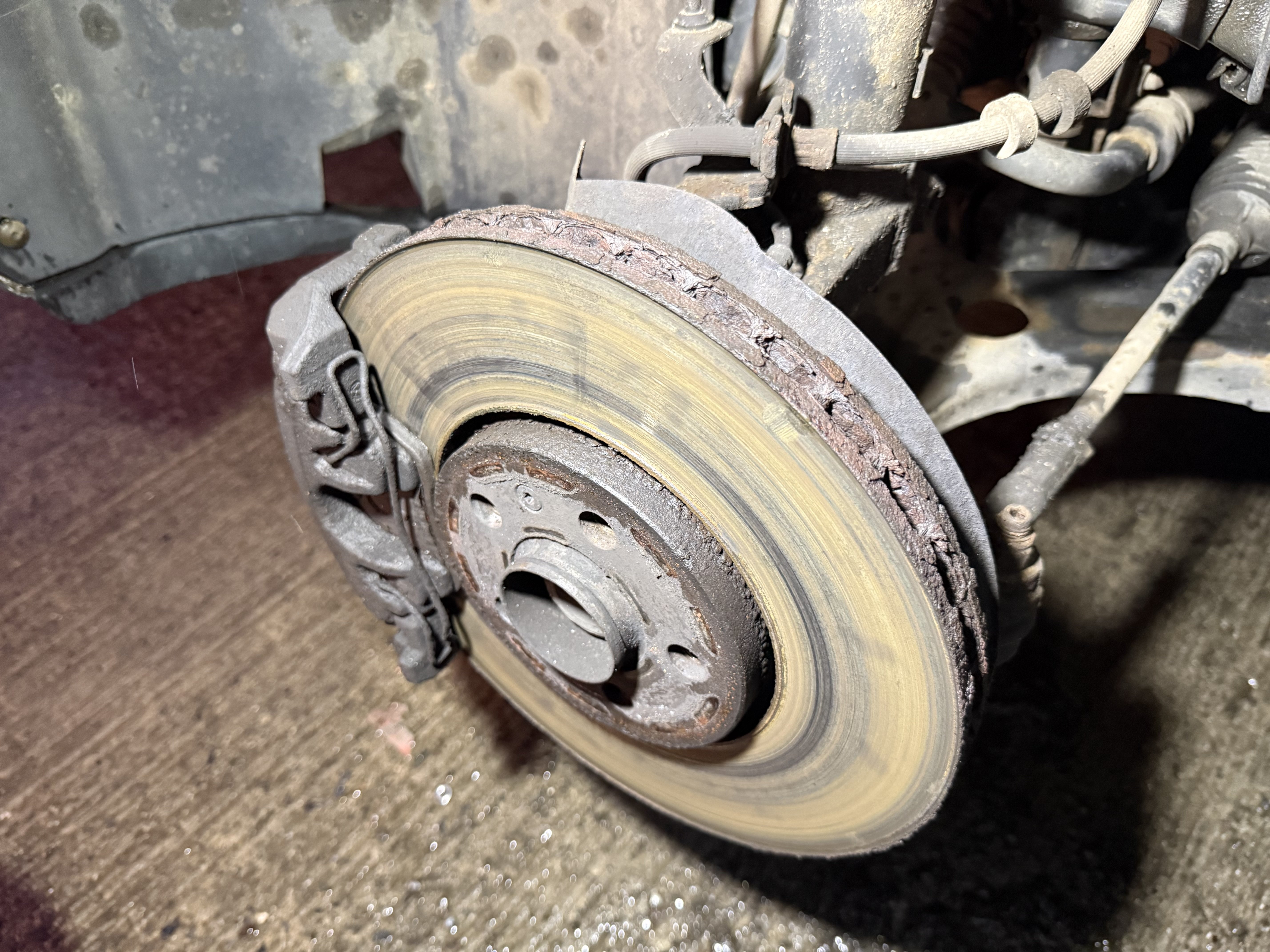

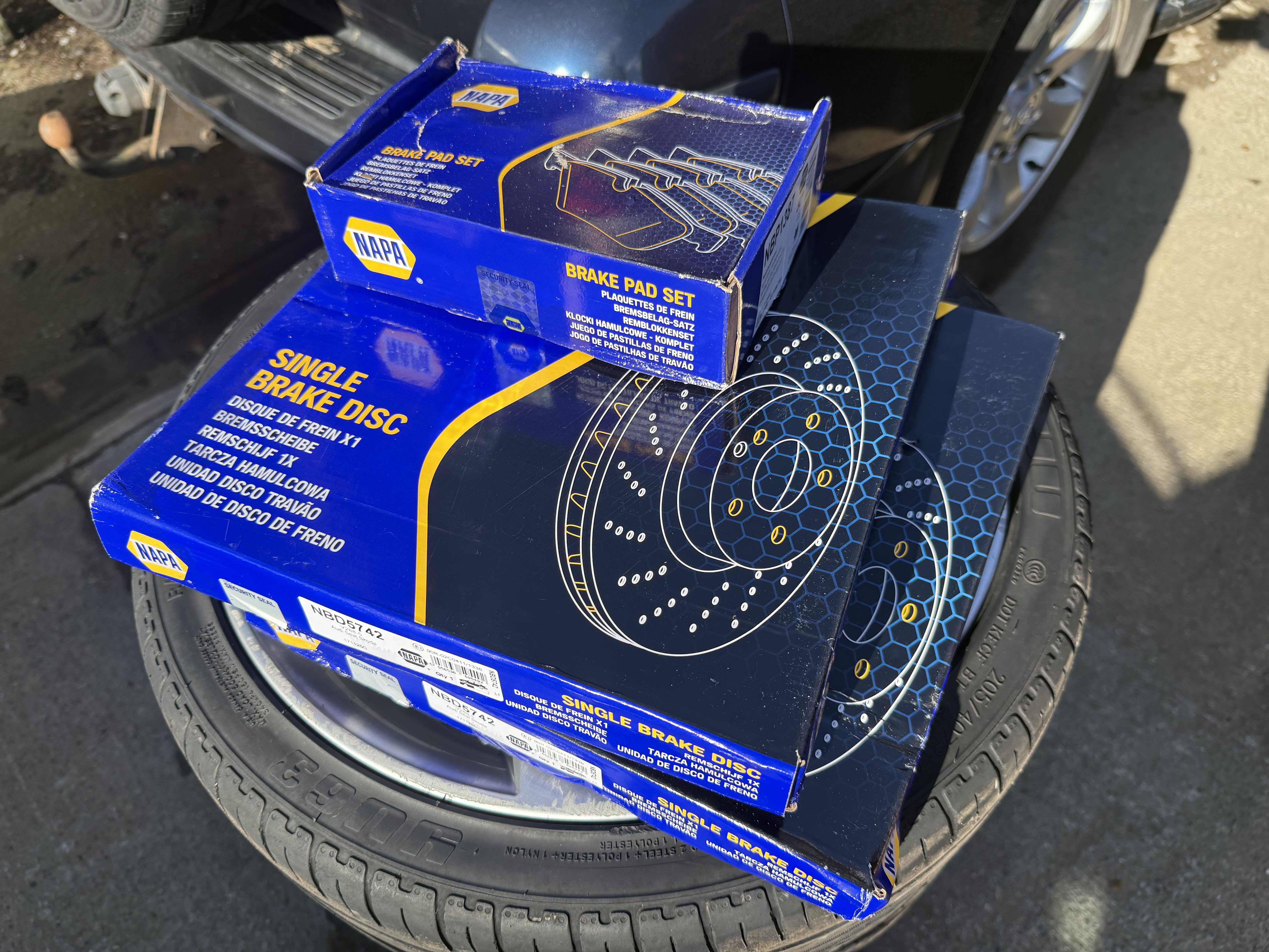

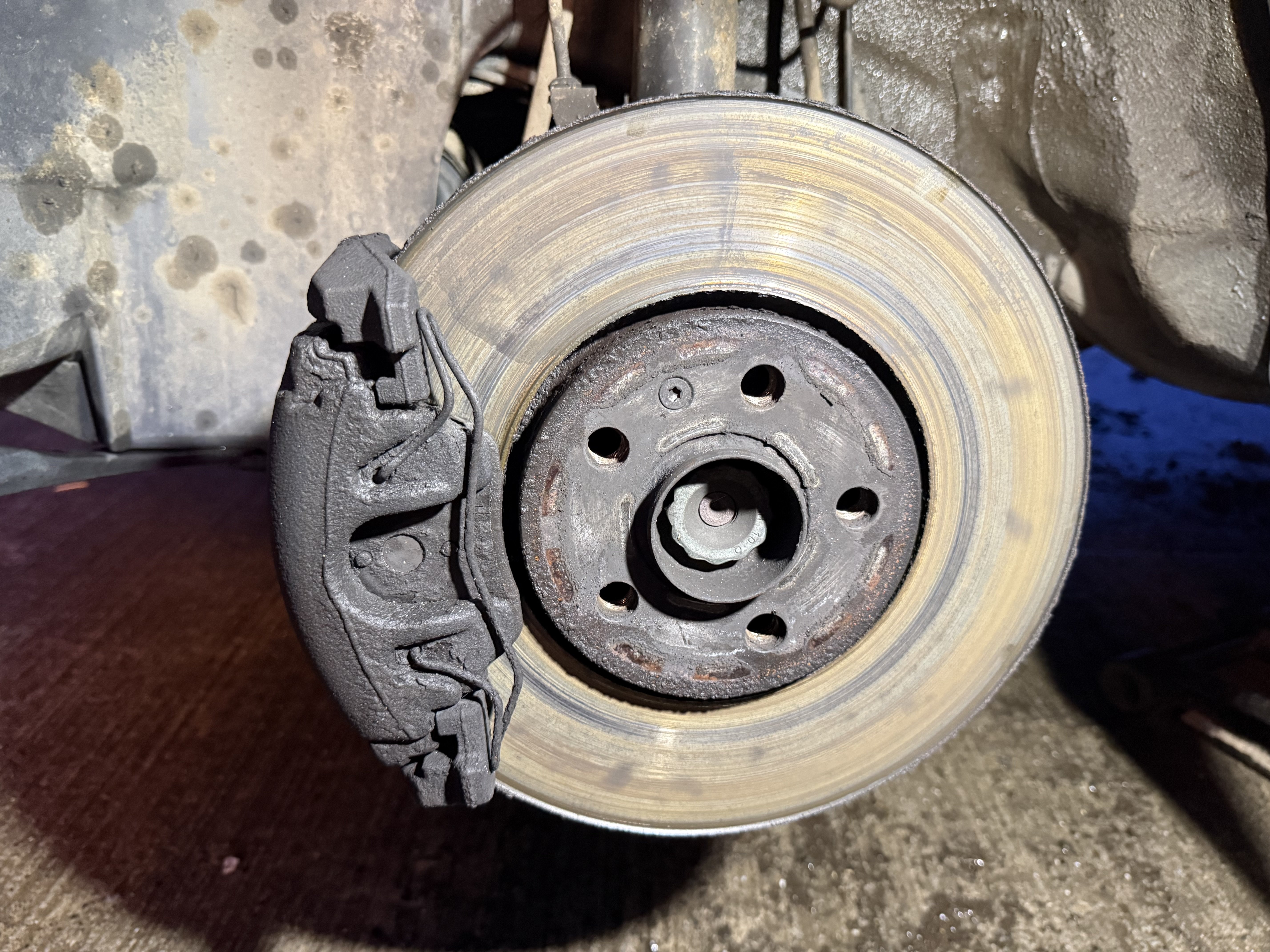

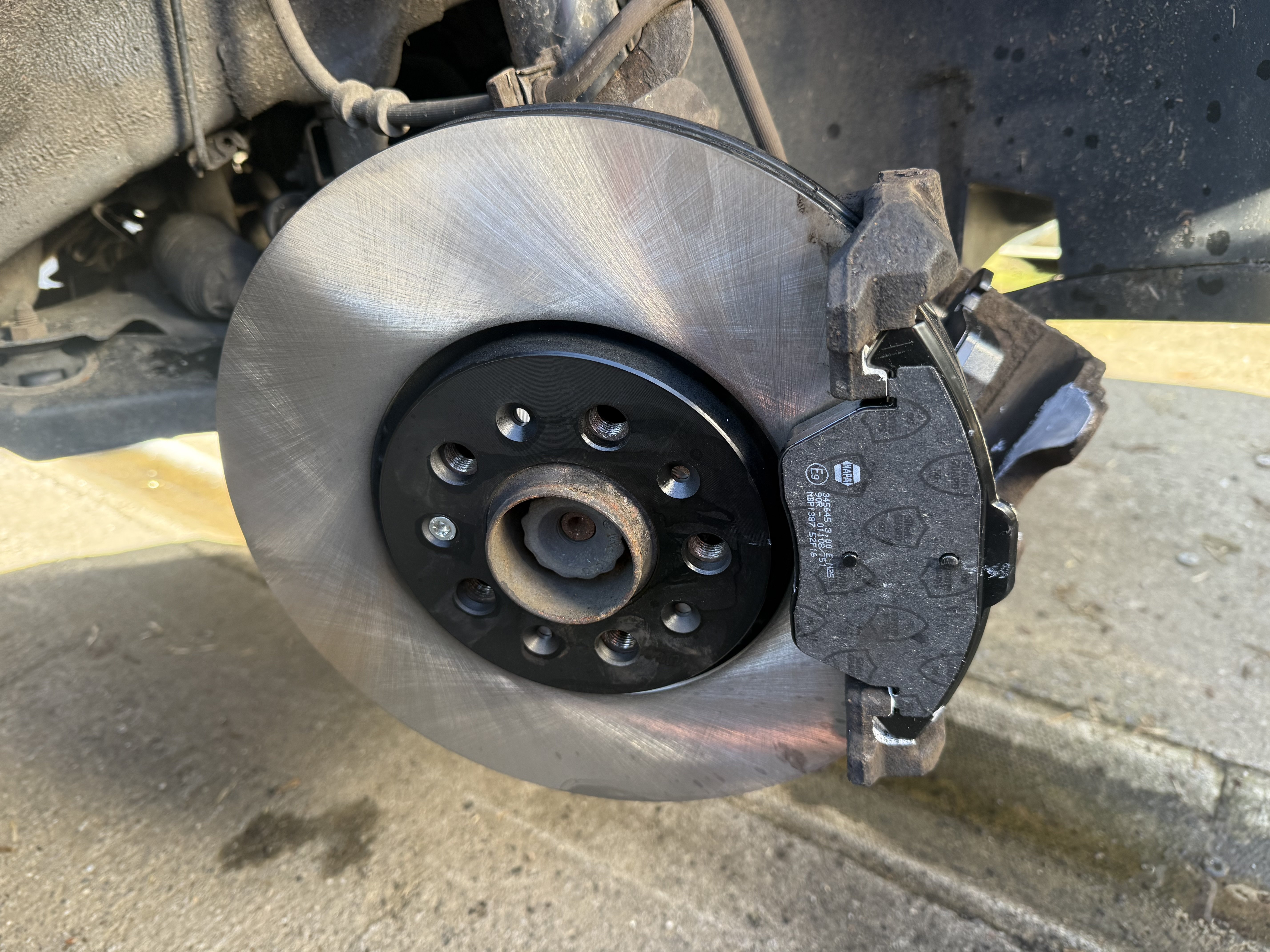

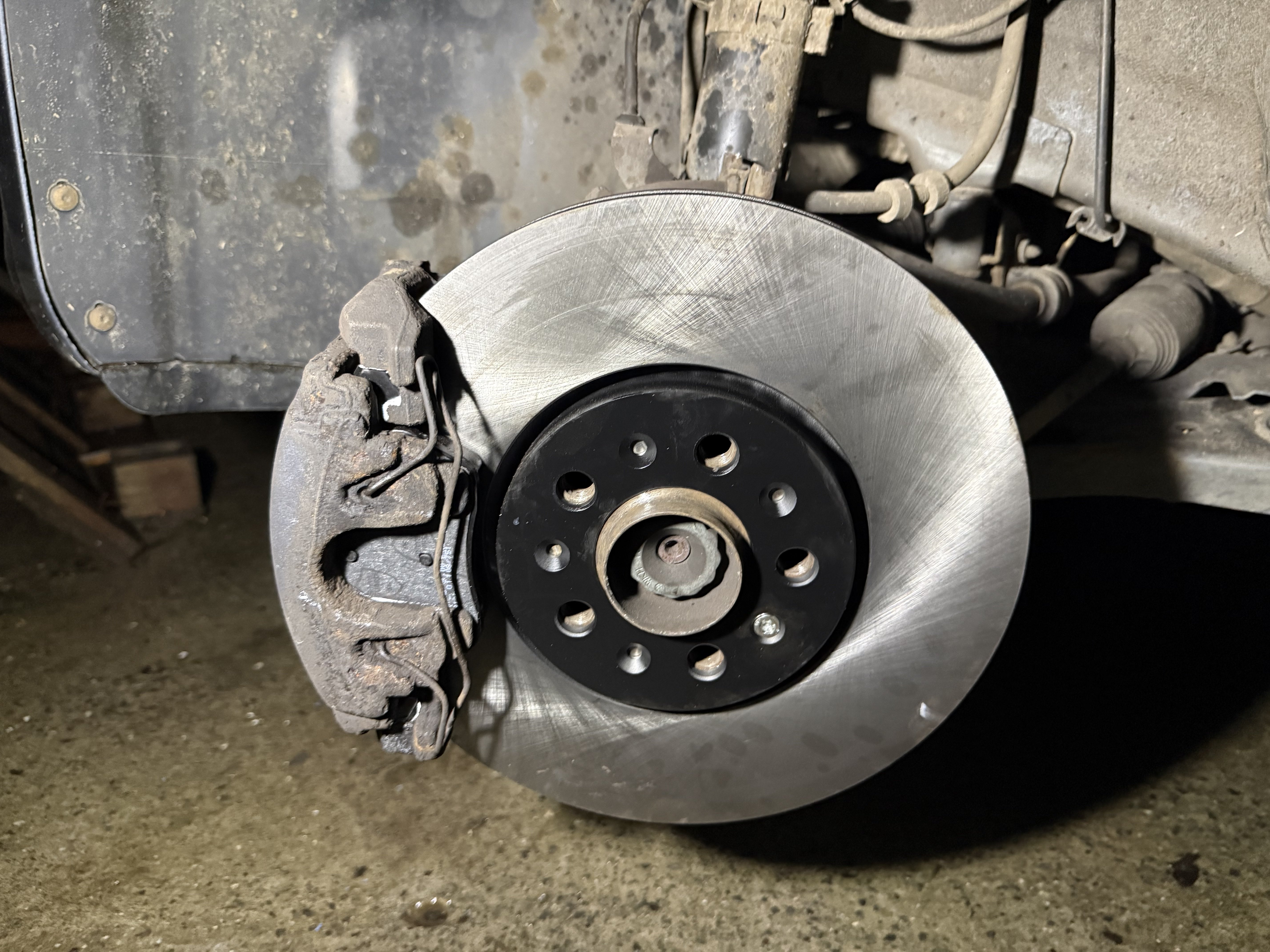

First mechanical jobโฆ.. replace front brake discs and pads as the ones on the car were down to the backing plates!! ๐คฆโโ๏ธ

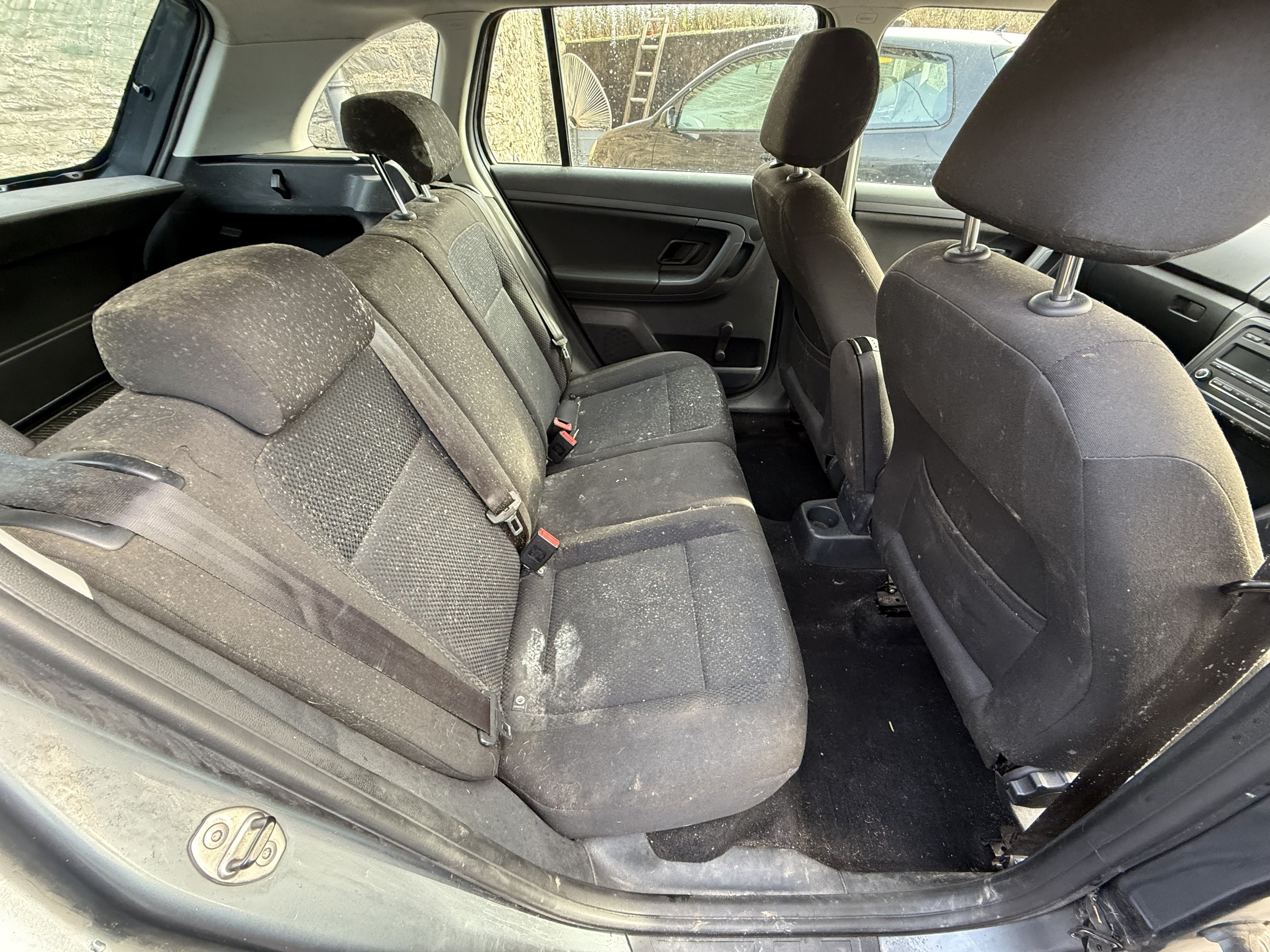

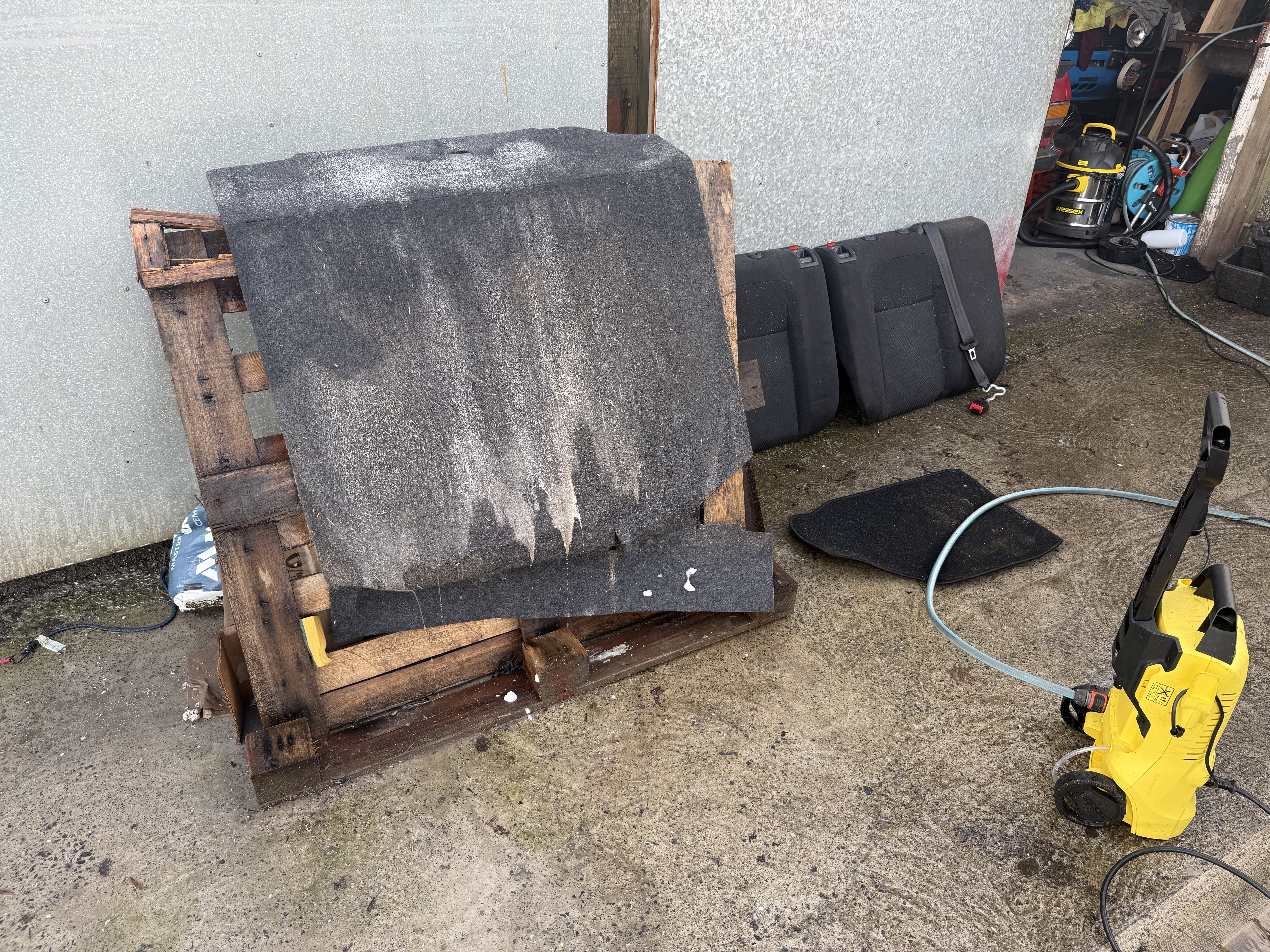

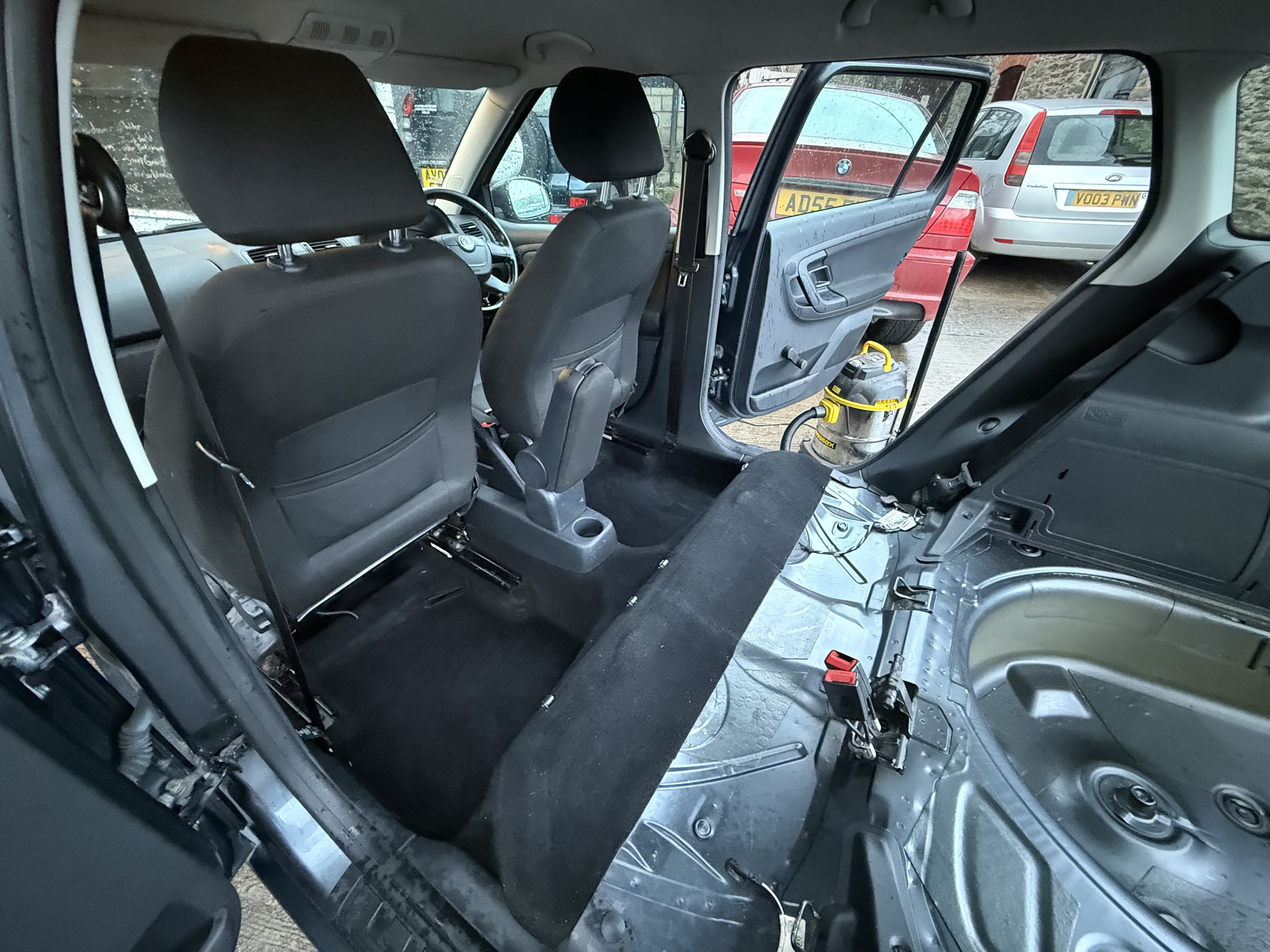

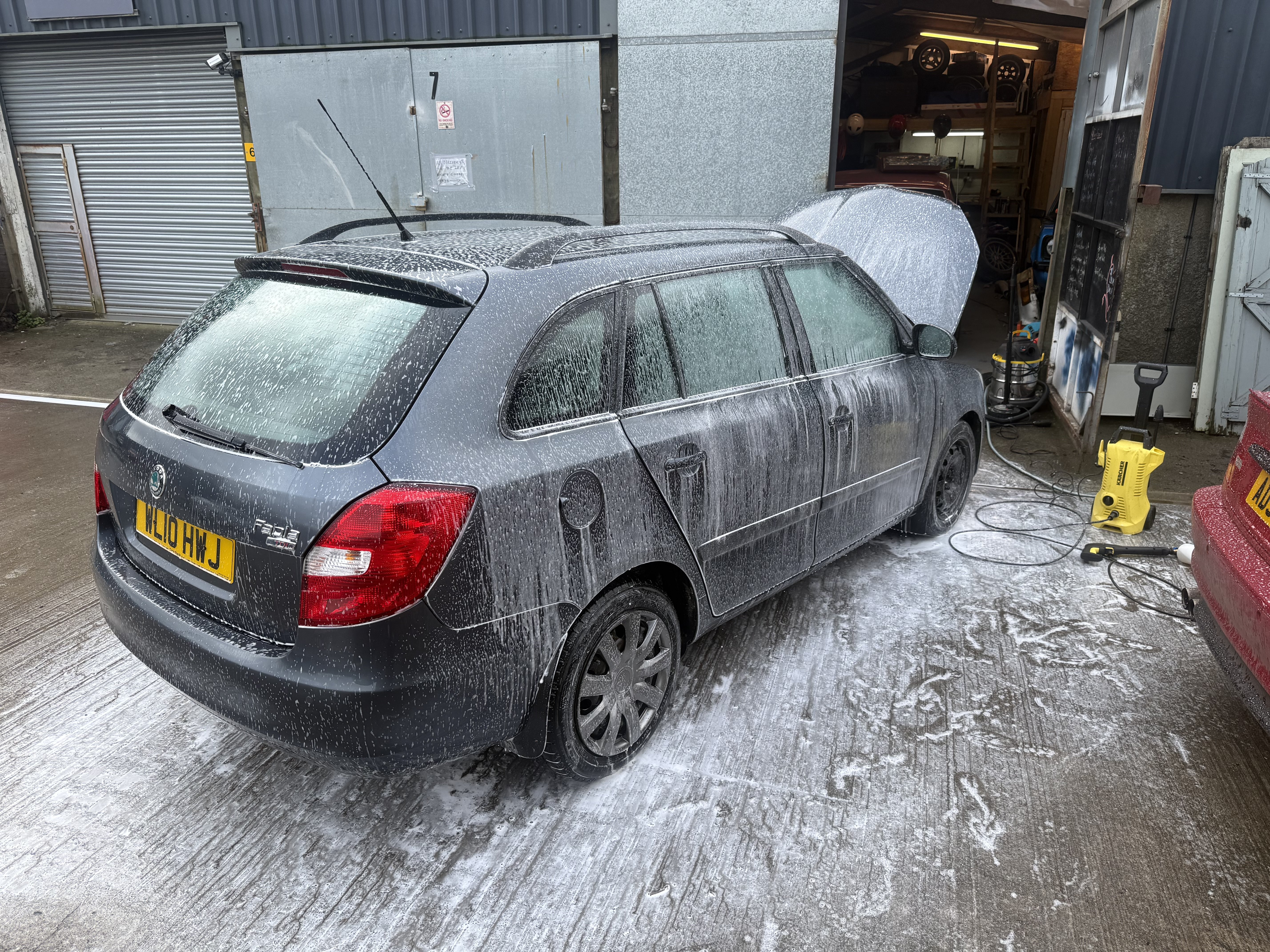

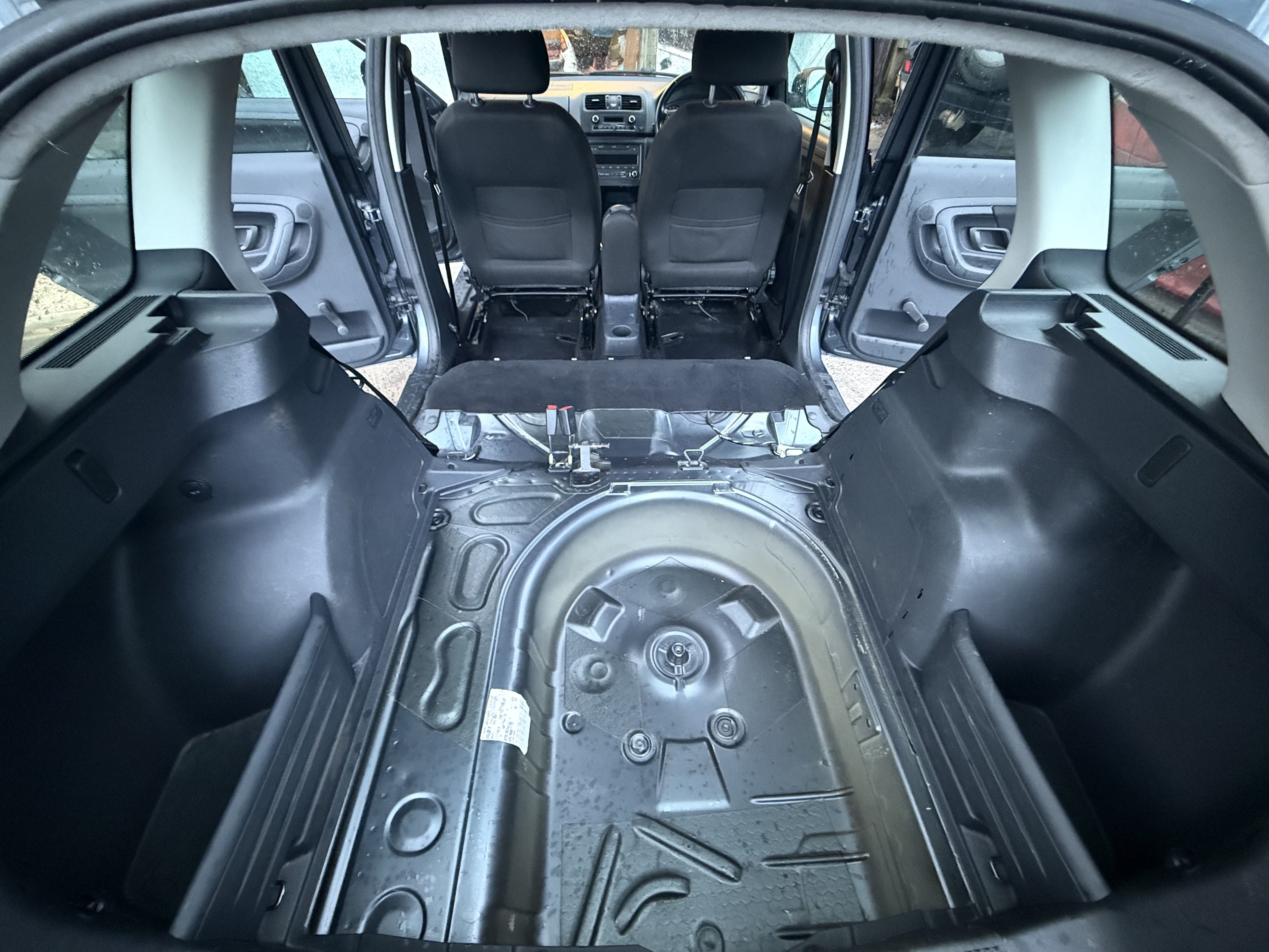

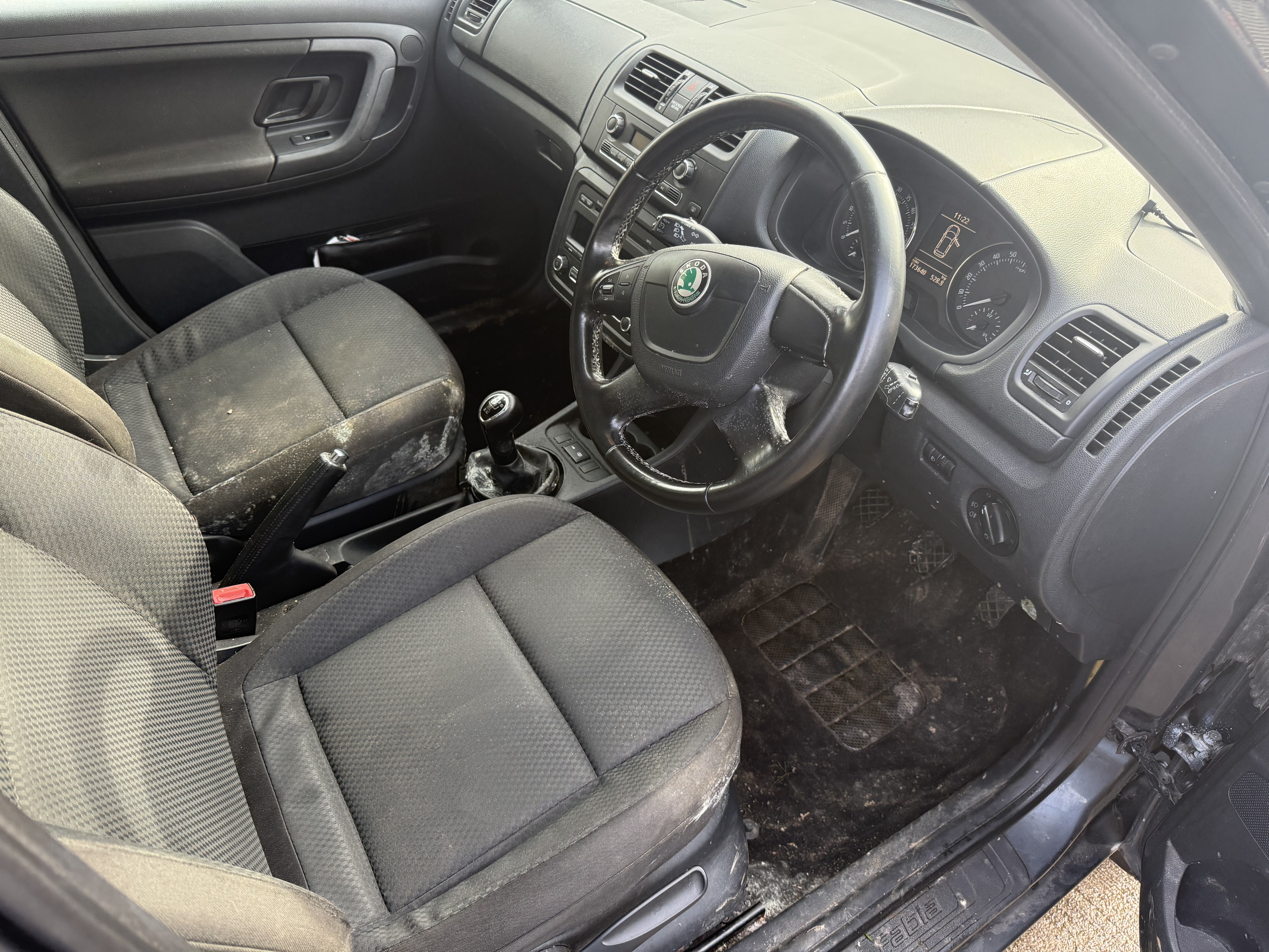

Now to give it a deep clean (well most of it. I still have the front seats and footwells to do and to put it all back together! ๐).

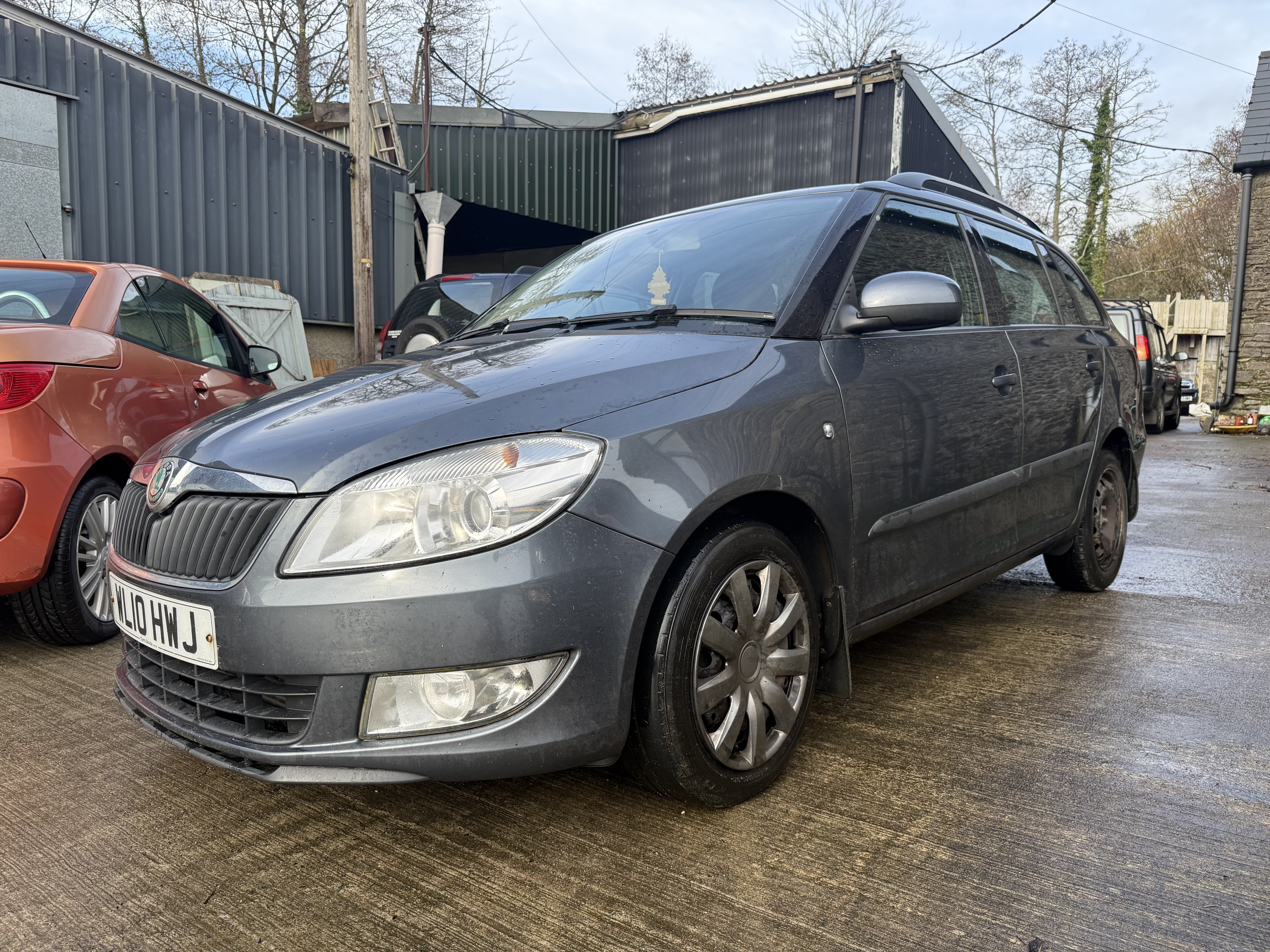

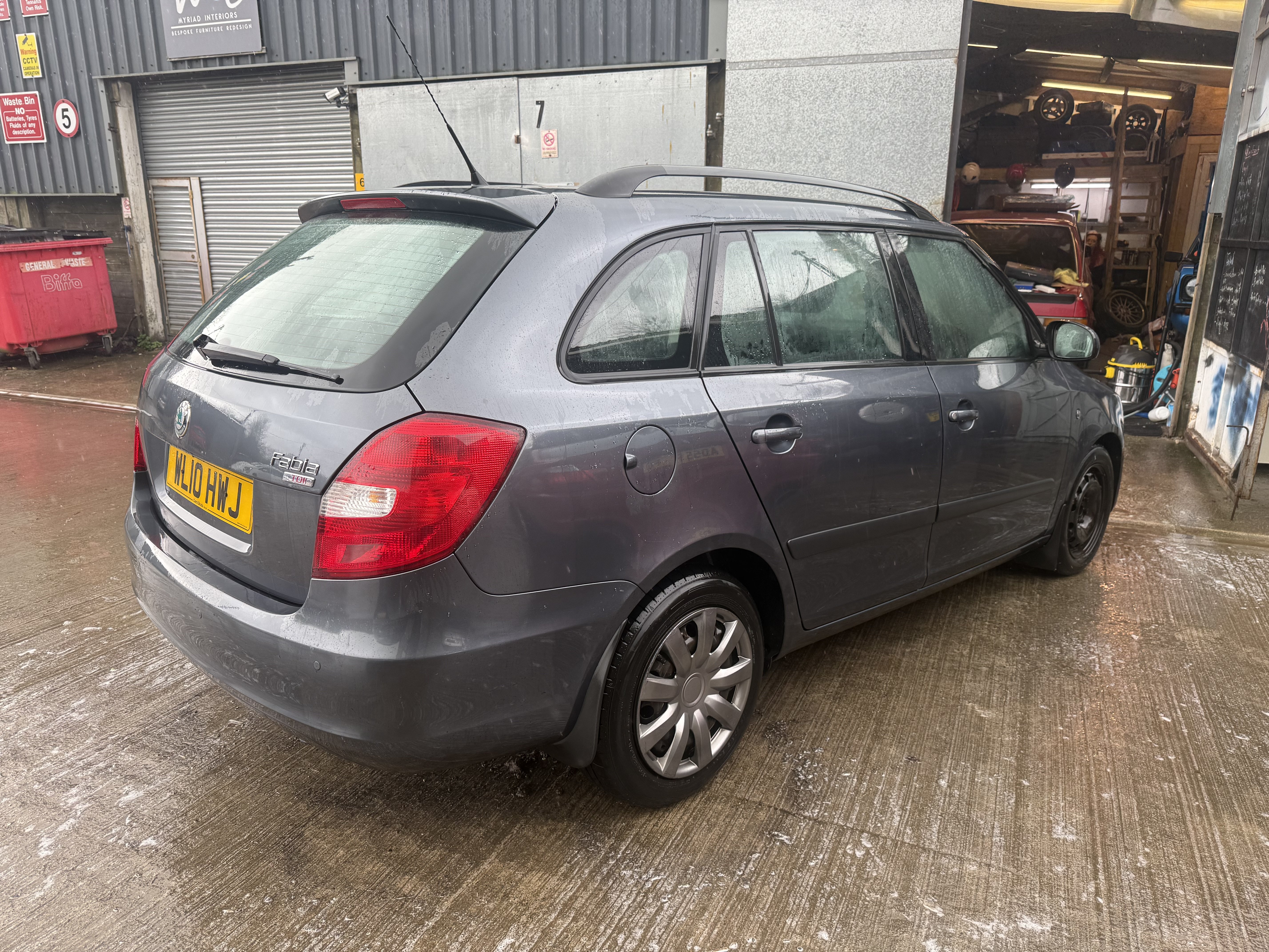

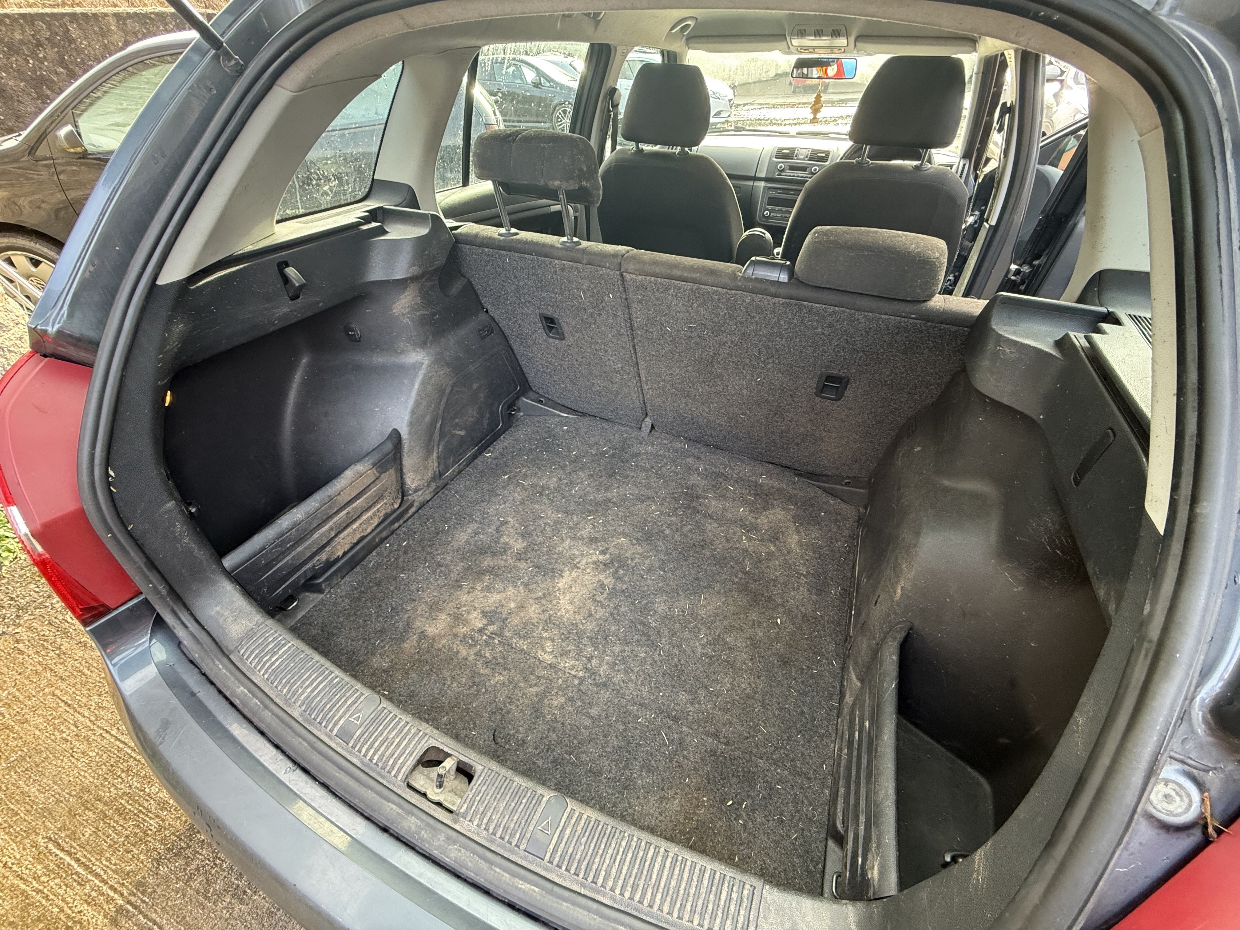

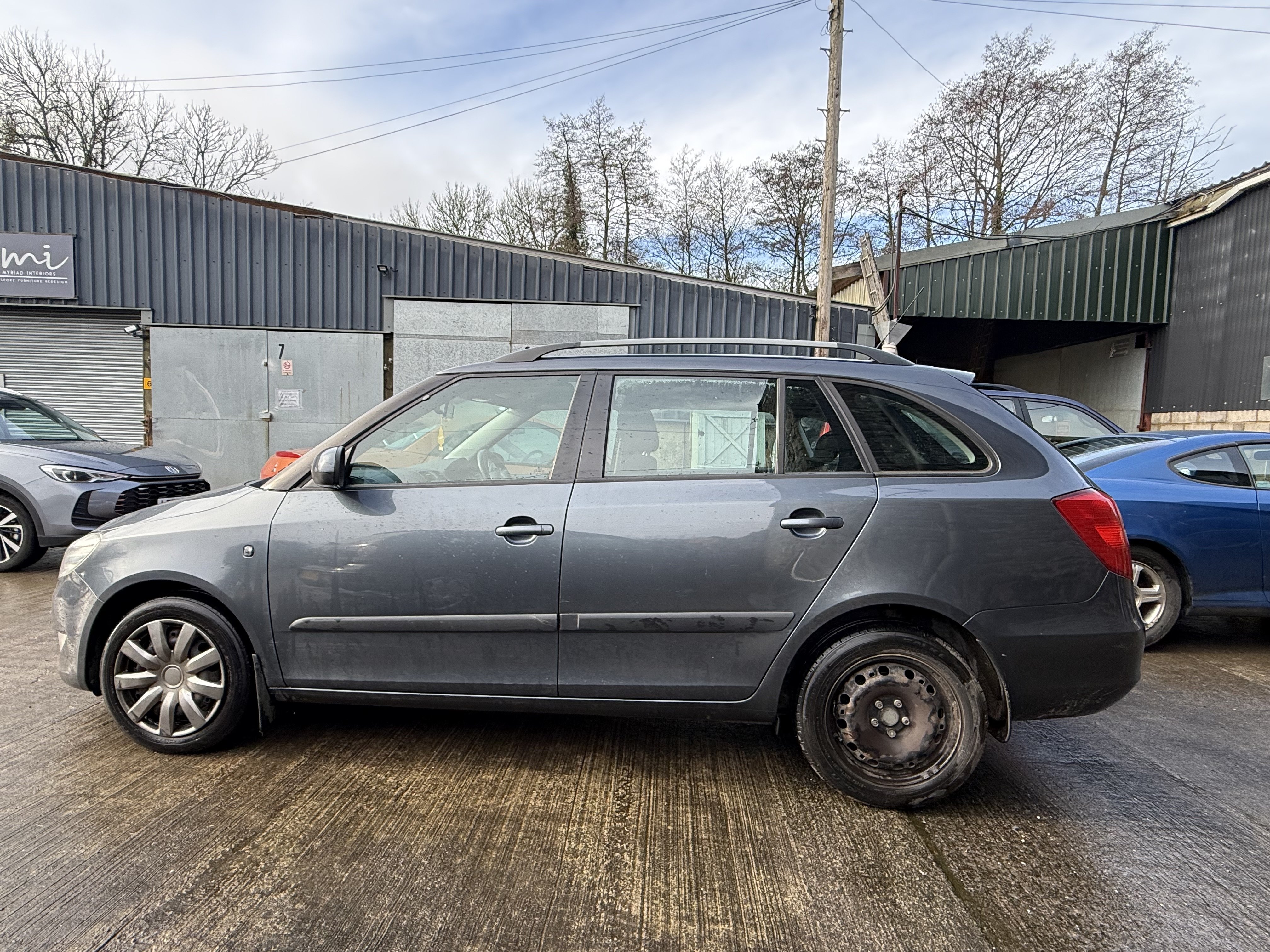

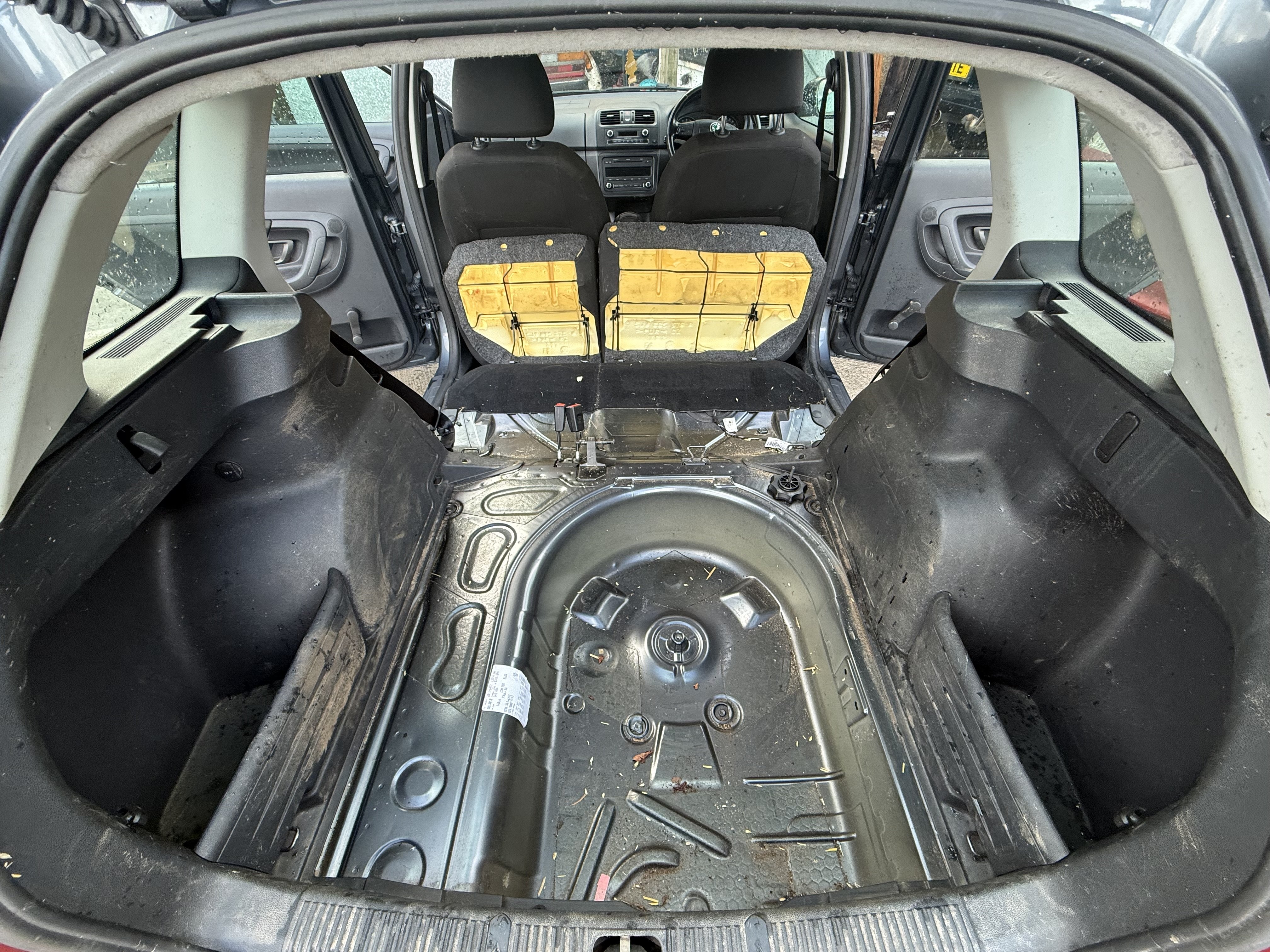

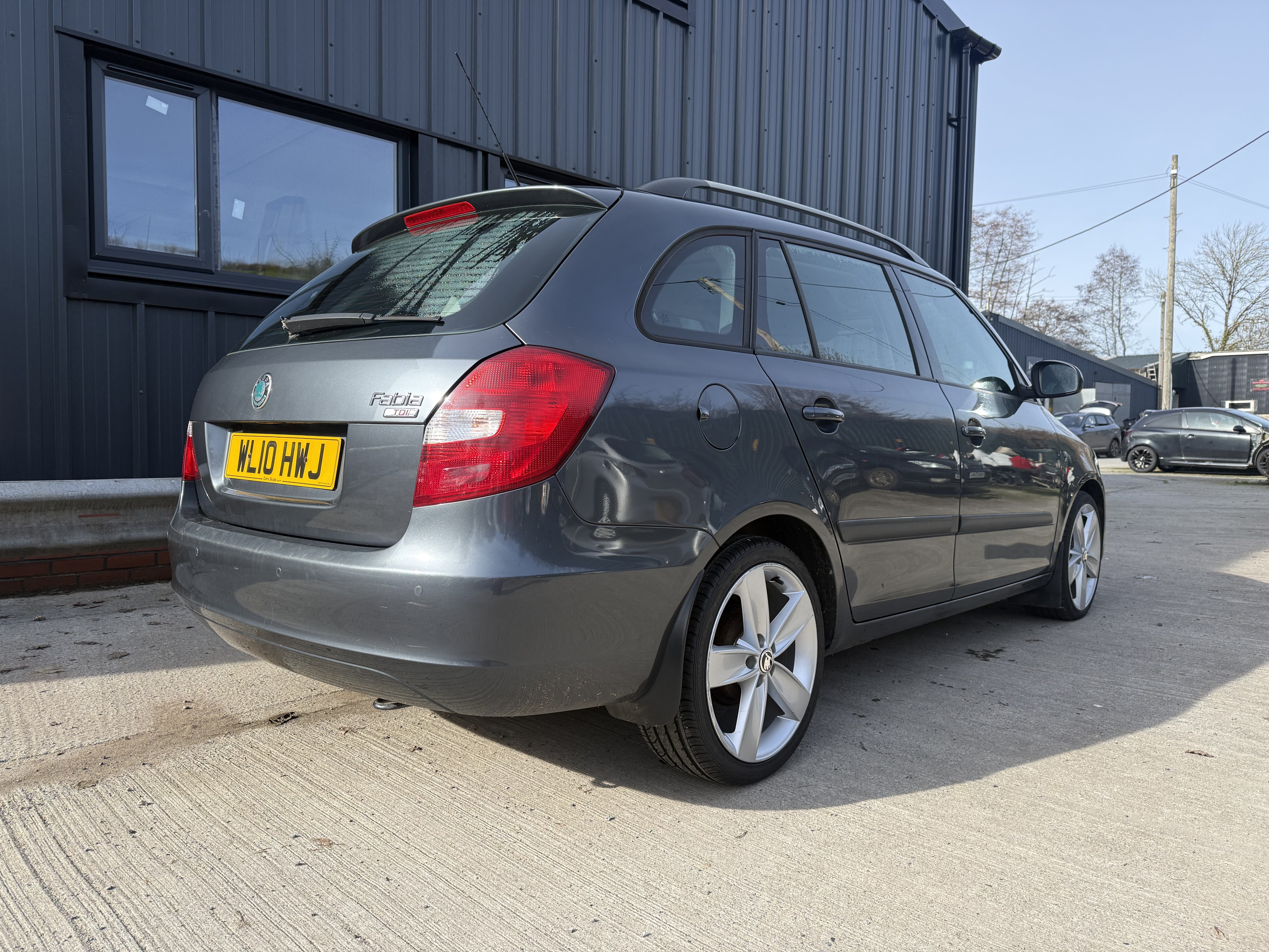

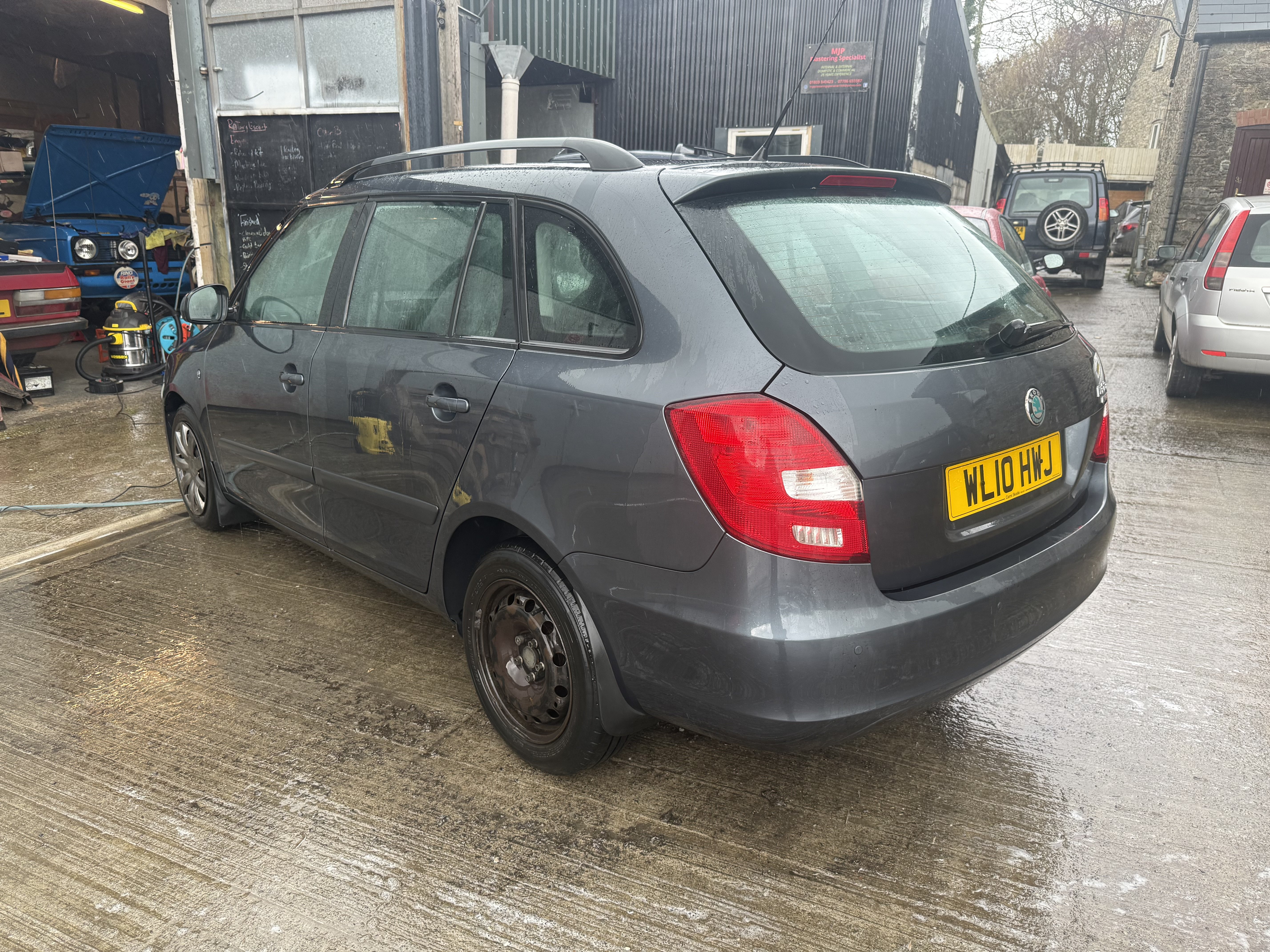

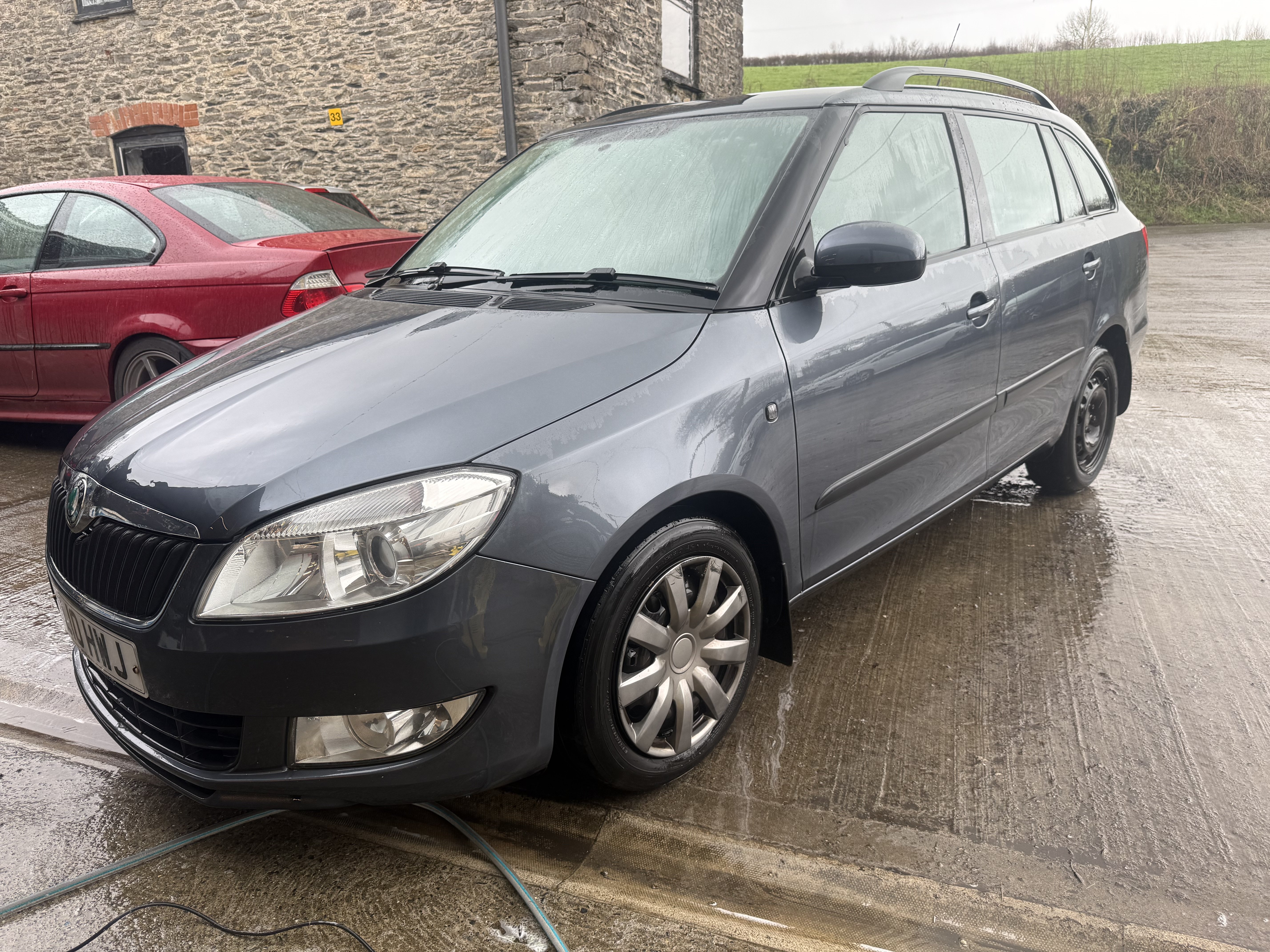

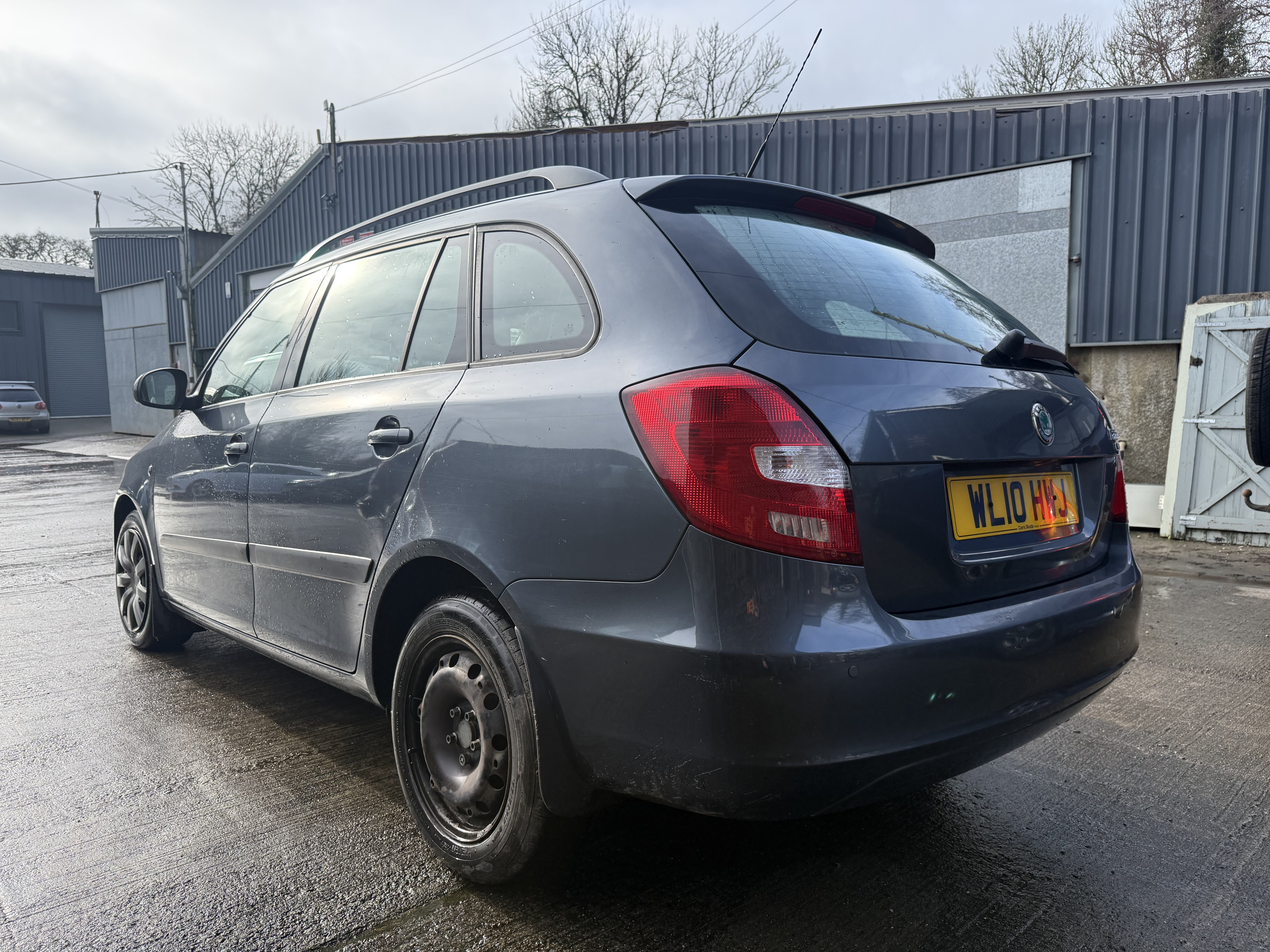

Right I can now post more photos so Iโll continue with my project thread ๐ So now off the trailer I get my first proper look around my new acquisition! Muddy โ Dog fur โ Horse feed โ Wheel trims missing โ Etc etc โฆโฆโฆbut it looks pretty straight for a cheapy!! ๐๐

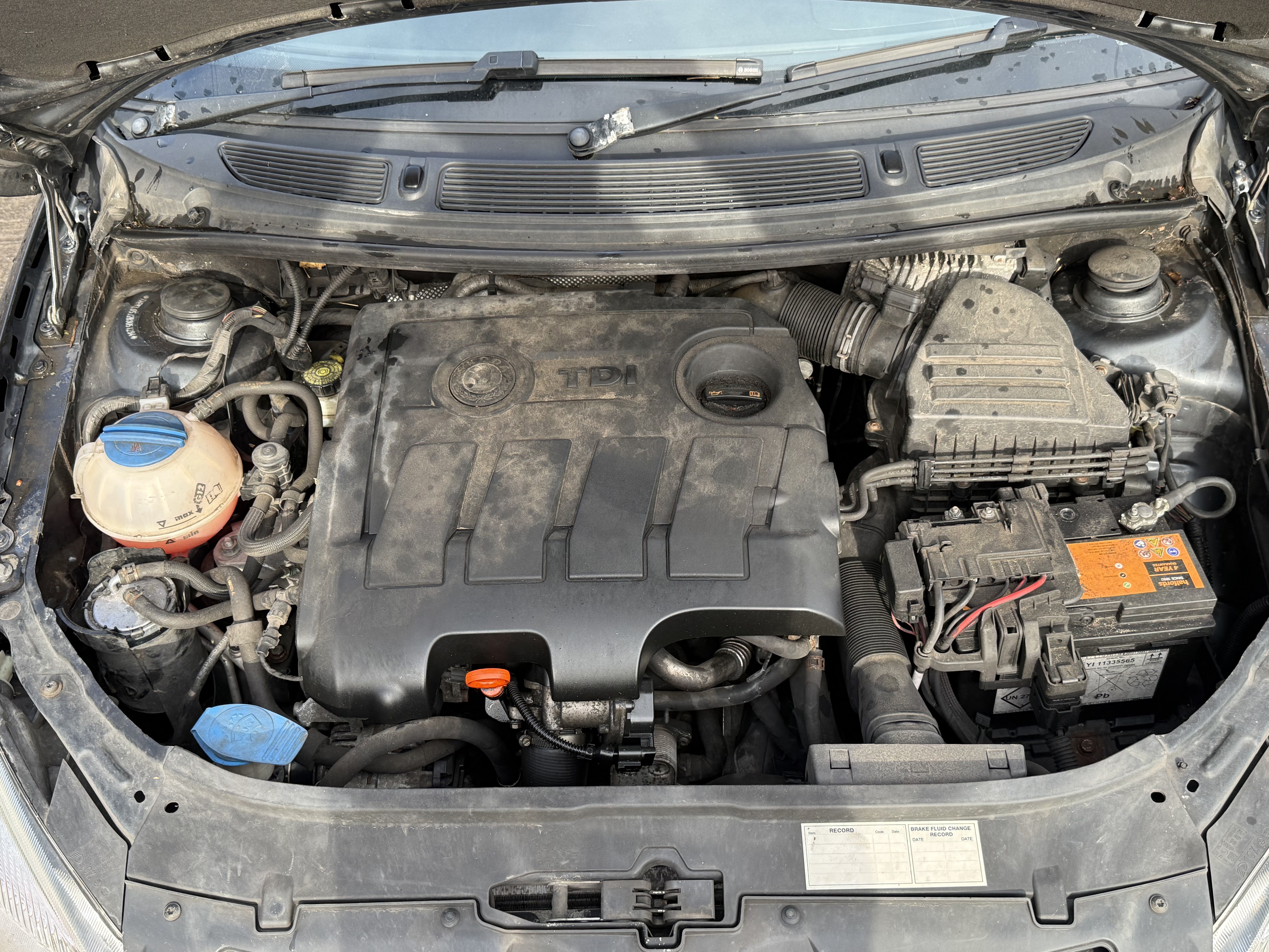

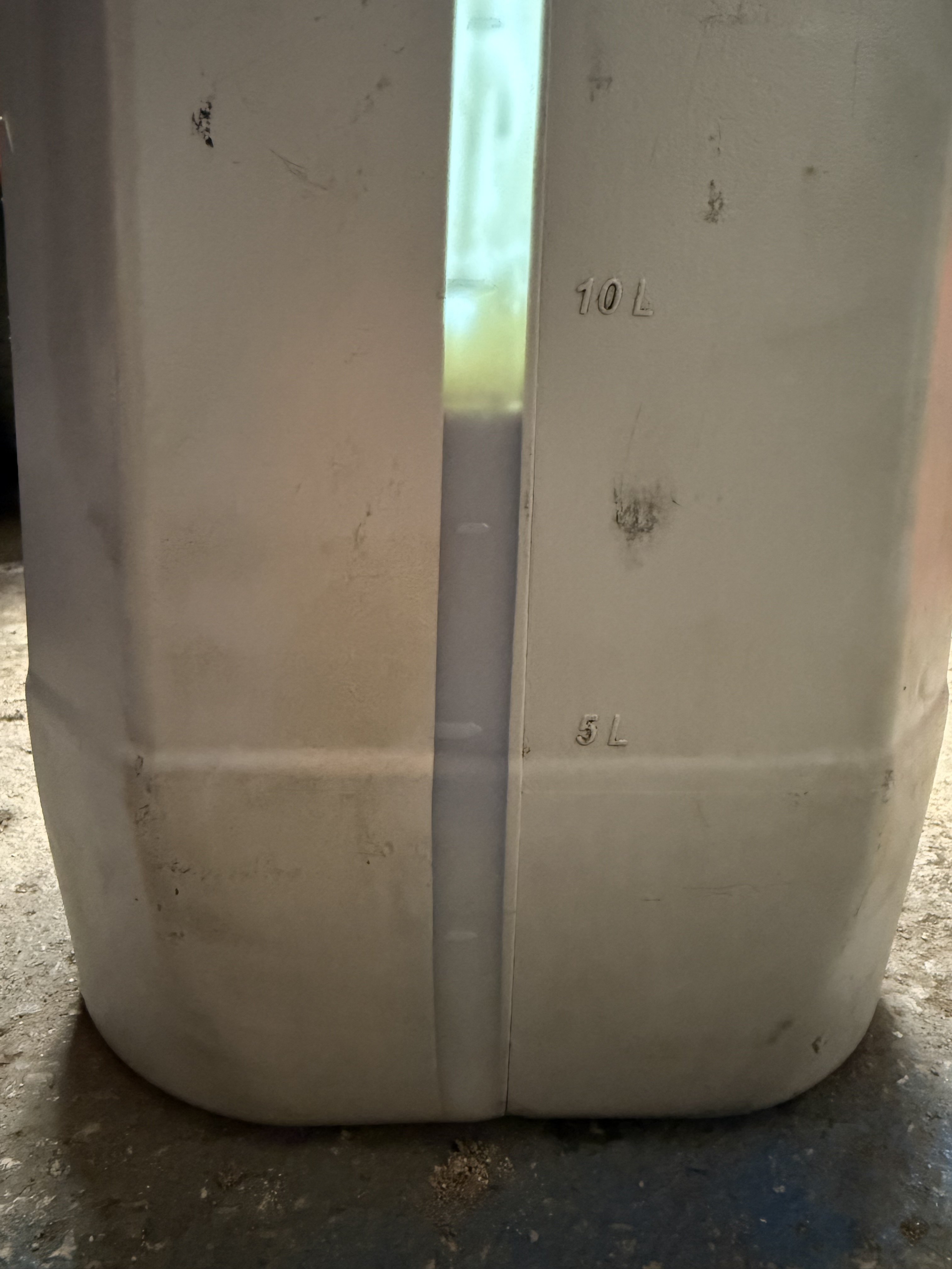

โญ๏ธ a little update for you all! Well after realising the oil level was high, last night I dumped all the oil out to see how much by! To my surprise there was about 8.5 litres in there!! Thatโs about double!! ๐ฎ. It also smelt of diesel and was thin like water so likely cause would be long term failed Regens by driving lots of short journeys. Yes it could be a failed injector but it still drive really smoothly so is looking less likely. I also had all the turbo pipes off and drained the small amount of oil in the intercooler as best as I could. I did find that the oil starts in the system from the crank case breather, which is BEFORE the turbo, so is now looking less likely the turbo seals are at fault ๐ค. So it now has the correct amount of new oil and a new filter. It now runs so much quieter but I havenโt taken it for a drive yet. Fingers crossed this may have sorted it ๐ค Thanks all for your advise ๐๐
