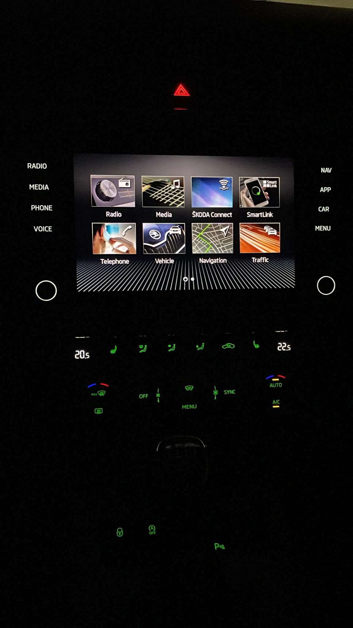

  1. Thanks to the help of @Cairus my device is in fully working state again! FW 0480 installed, everything OK Great man, always ready to help!
