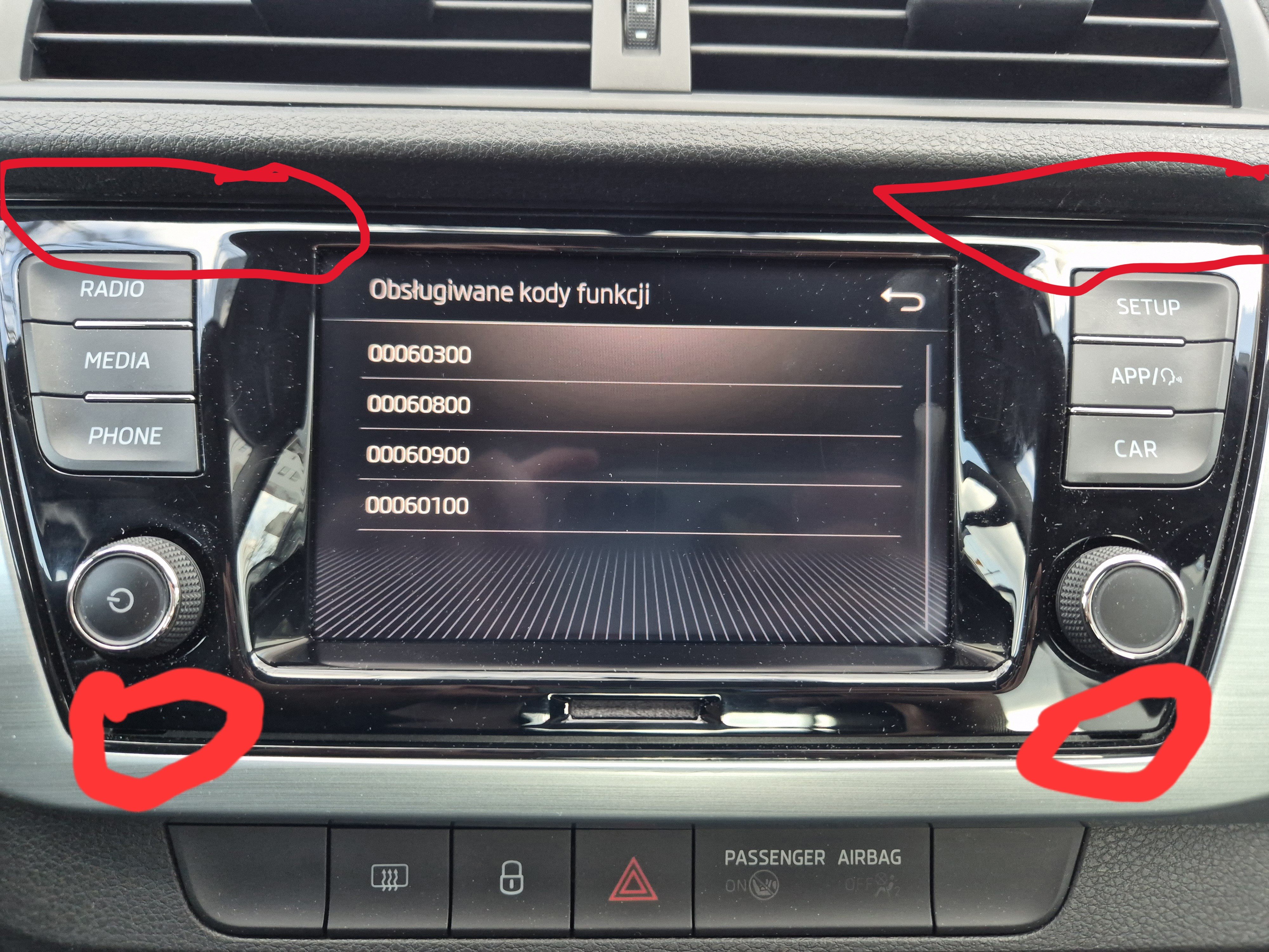

  5. Hello, any idea how to remove the radio from the car? I tried with removal keys on the bottom and plastic cards on top as in the picture below. Still doesn't want to come out - any solutions?
