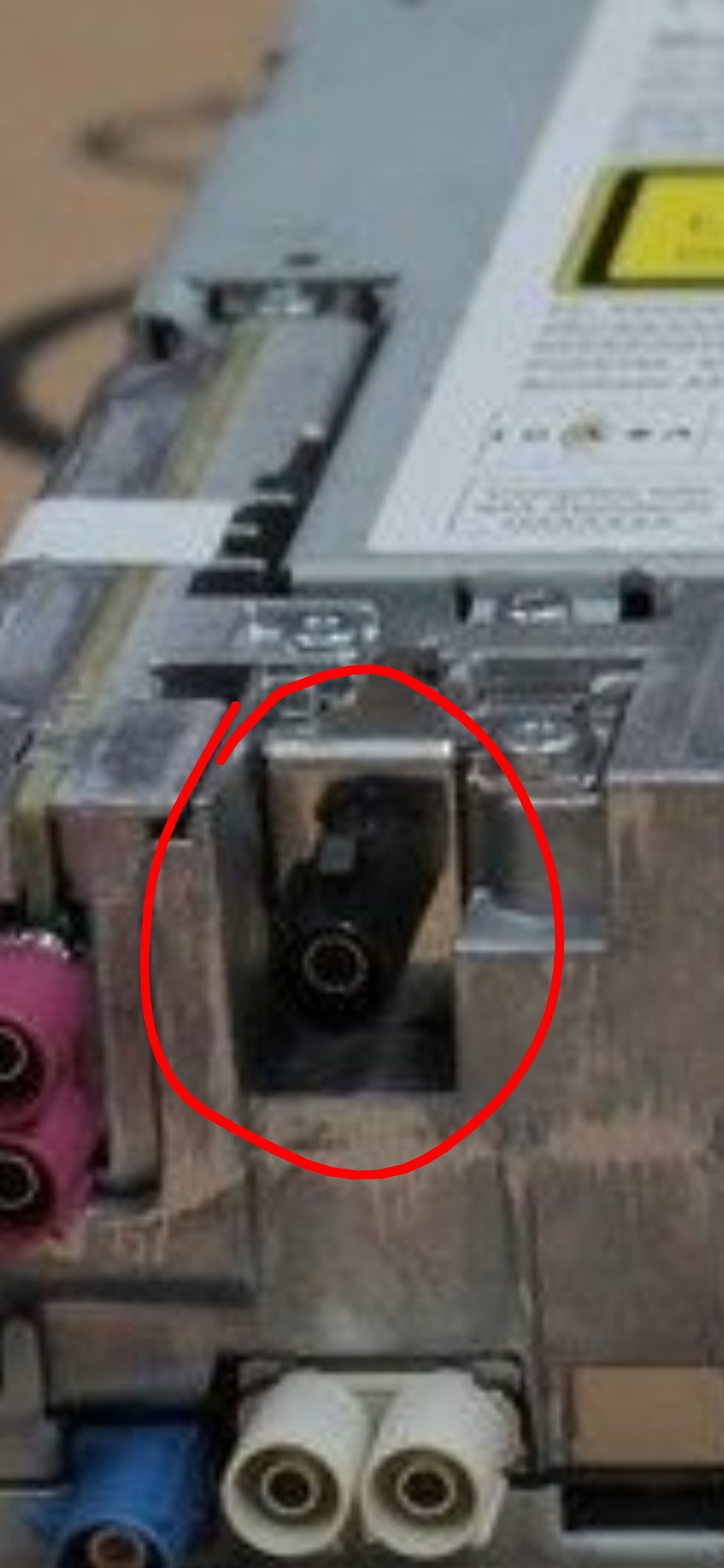

  4. Hi all, I've found this picture online with it saying that this (circled) is the dab Ariel port. I didn't realise that there are so many different fakra connectors. Can any of you tell me which one this is ? Apparently there are A,B,C,D,E,G,K and Z I've got no idea,

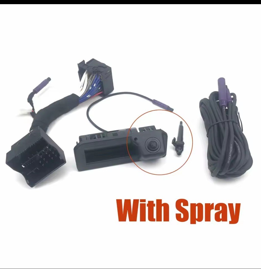

  6. Hi , I've just fitted an aftermarket reverse camera , the boot handle type. It came with a wiring harness which plugged into the back of the Columbus Head unit and to the existing harness. Everything work fine except I now have no dab . I've put it on the diagnostic and it says dab open circuit. Any ideas would be gratefully received
