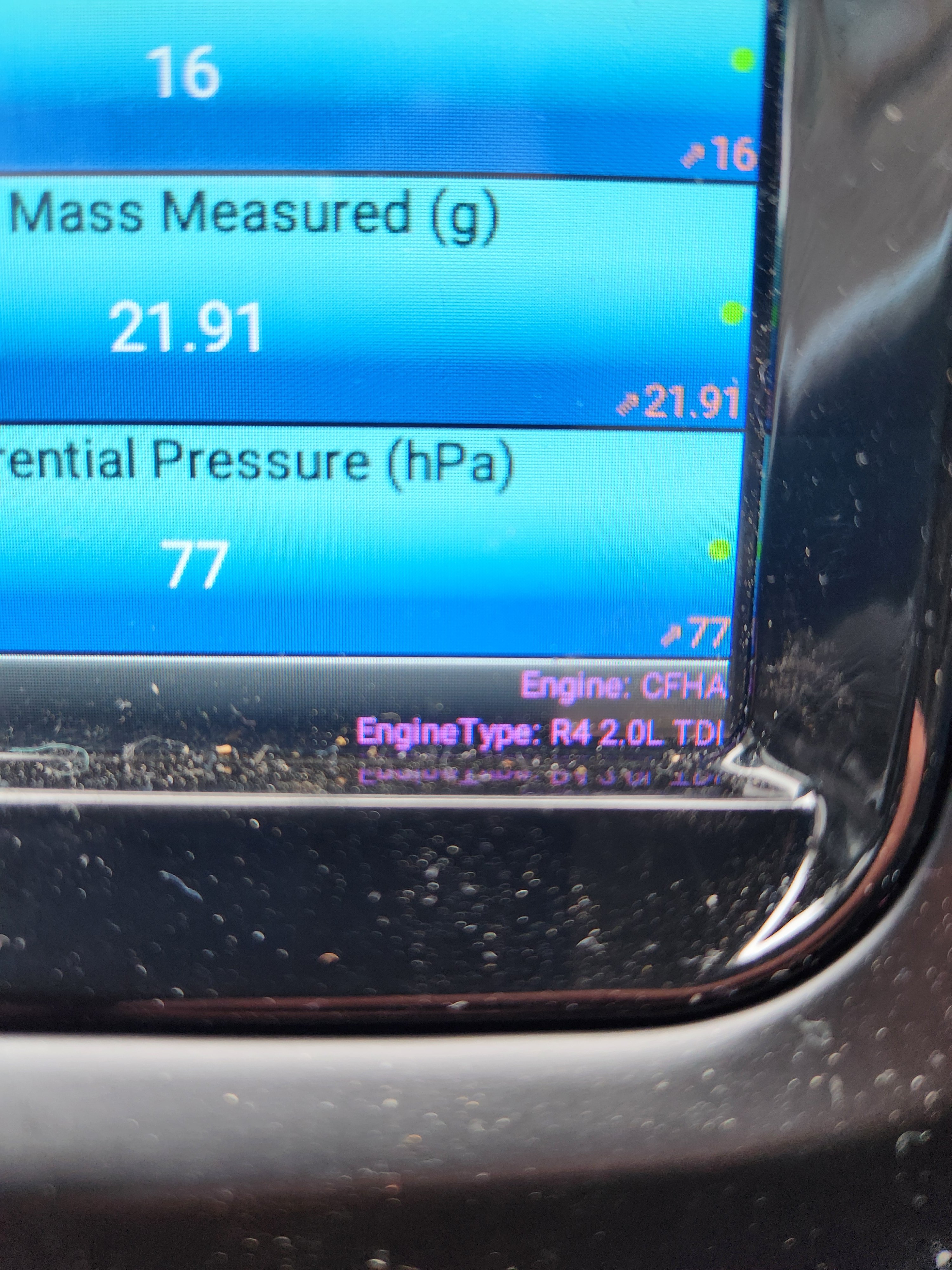

    I tried off engine types but auto sele ted one seemed best.

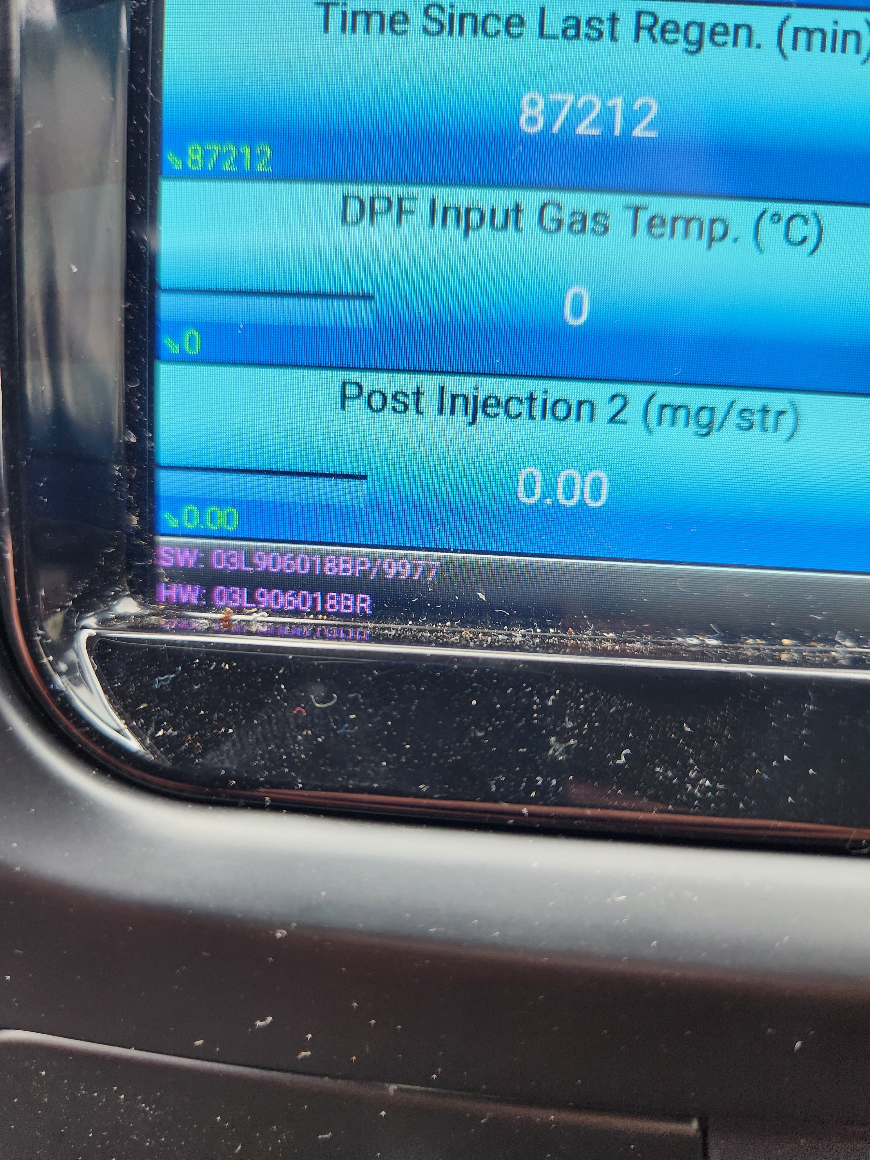

    I was looking at getting EA189 fix reversal (or Dieselgate rollback). But decided it was not worth it for me, Car has 120k on the clock. Sw Version is shown in bottom LH corner of vag app. Yes. Maybe older cars have different parameter interface.

    Same here. Two different OBD adaptors one bluetooth, one wifi. Used phone and android head units for the App. Similar readings. It's reassuring it's not just me, I was thinking of getting it looked at by a ECU remapper but won't bother now. I think I'll just scrap the VAG app and assume it's performing regens anyway. I have cleaned the dpf with some Mannol cleaner now. All seems ok.

  10. mad_dad posted a topic in Skoda Yeti
    I have got hold of my first Yeti. 2010 diesel 2wd, high mileage but sound. It doesn't seem to perform a regen. I have tried using Vag dpf to monitor it but the temperature sensor readings always show zero. Could both sensors be faulty, there are no errors logged?
