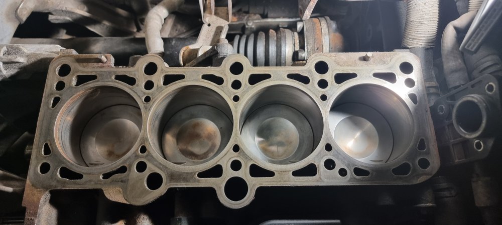

  4. No, just tiny marks. Only intake valves were bent and that camshaft was broken. Positive side on this was that there was not any counter force behind the valves because the camshaft was separated from the timing sprocket. And this all happened when I was starting the engine so there was no high rpm´s. As you can see from the pic, there´s tiny marks on the first and fourth pistons. I think I´m going to open a dedicated topic for this and do a full report of that cylinder head operation.

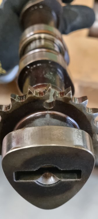

  8. Intake camshaft´s sprocket cracked loose and started to spin freely. Intake valves were bent.
