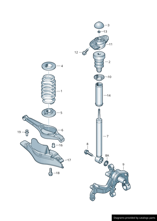

It wasn't quite the same noise as yours but my noise was the stone protection cover (tube) over the shock absorber shaft at the rear.  Sometimes this tube is part of the shock absorber but on the Octavia it is hangs down from the bump stop. If the bump stop fails (made of rubber) the tube drops down and rattles. Just a thought and easily checked.
Tube is part 14 and bump stop part 2 on this drawing:-

Thanks - mine are both hanging, bumpstops have long since perished. It's far too loud to be them I think. I'm fairly sure I can 'feel' thr noise wirh my feet, I convinced myself it was the exhaust, but im pretty sure it's coming from under the pedals, but its.nothing thet I csn see or recharge using axle stands and a trolley jack. I even wondered if I had dropped a spanner down there and it was now banging around!

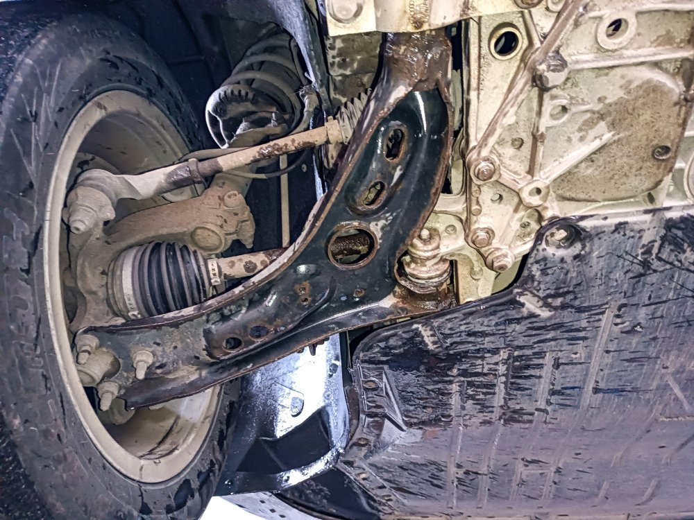

I have today discovered the cause. The front bush on the left Wishbone / Suspension Arm is knackered. I've ordered a replacement. Febi 39489 Wishbone / Suspension Arm. £34 +VAT from PartsinMotion.
https://www.partsinmotion.co.uk/car-parts/steering-suspension/wishbonesuspensionarm/febi-wishbone-suspension-arm-front-lower-left-39489-detail?
I post this just in case anyone else lands here after searching Google for rattle under car or similar.
On the 1.6 TDI 105bhp it's a steel sheet part. NOT a cast iron part. I order the entire wishbone, complete with bushes to avoid me having to fight with pressing out the old bush. Life's too short. And I order new bolt too £6. Stay Safe!🙂
If your unsure whether its a faulty bush, try this test. If your wheel moves this much the bushes are knackered.
