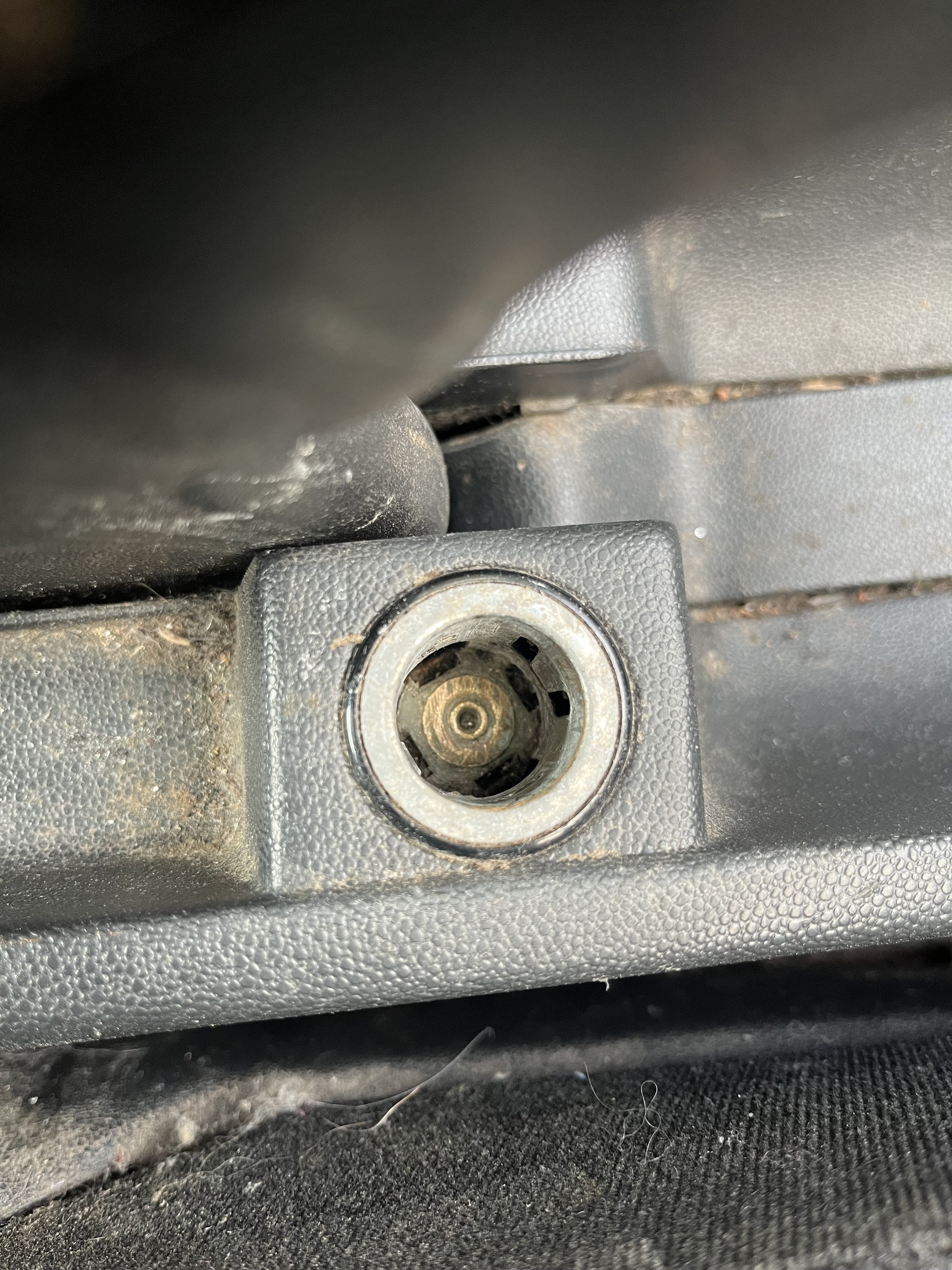

  5. That's a good shout - I'll give it a clean up. What substance would be best for cleaning it? Absolutely, no harm in doing so.
  6. Not that I can see. Mine is the Ambiente trim and I think it only has the one centre console socket.
  7. Interesting. I'll definitely take a look at them more closely, and I'll probably replace because they're cheap. I may also look into replacing/cleaning the socket as it's dirty. The charger is quite new but cheap so may have something to do with it. Thanks

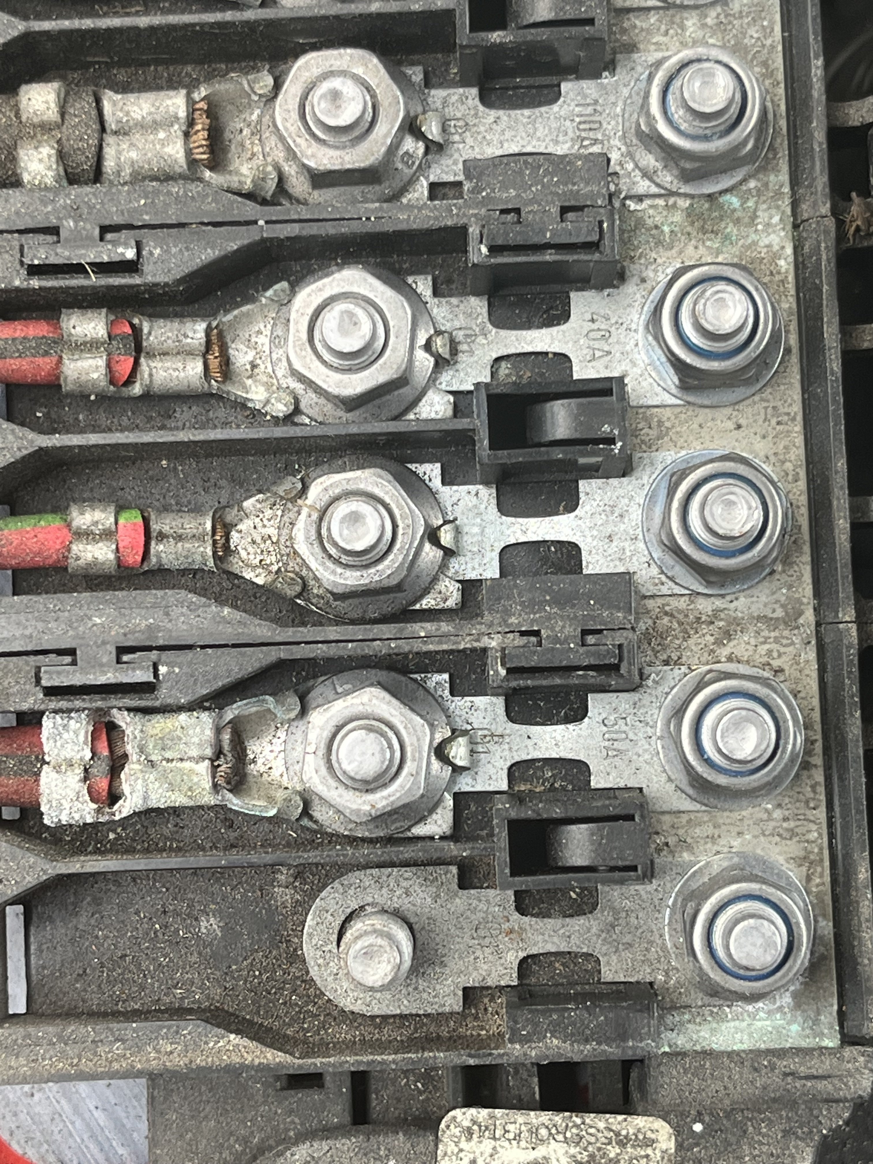

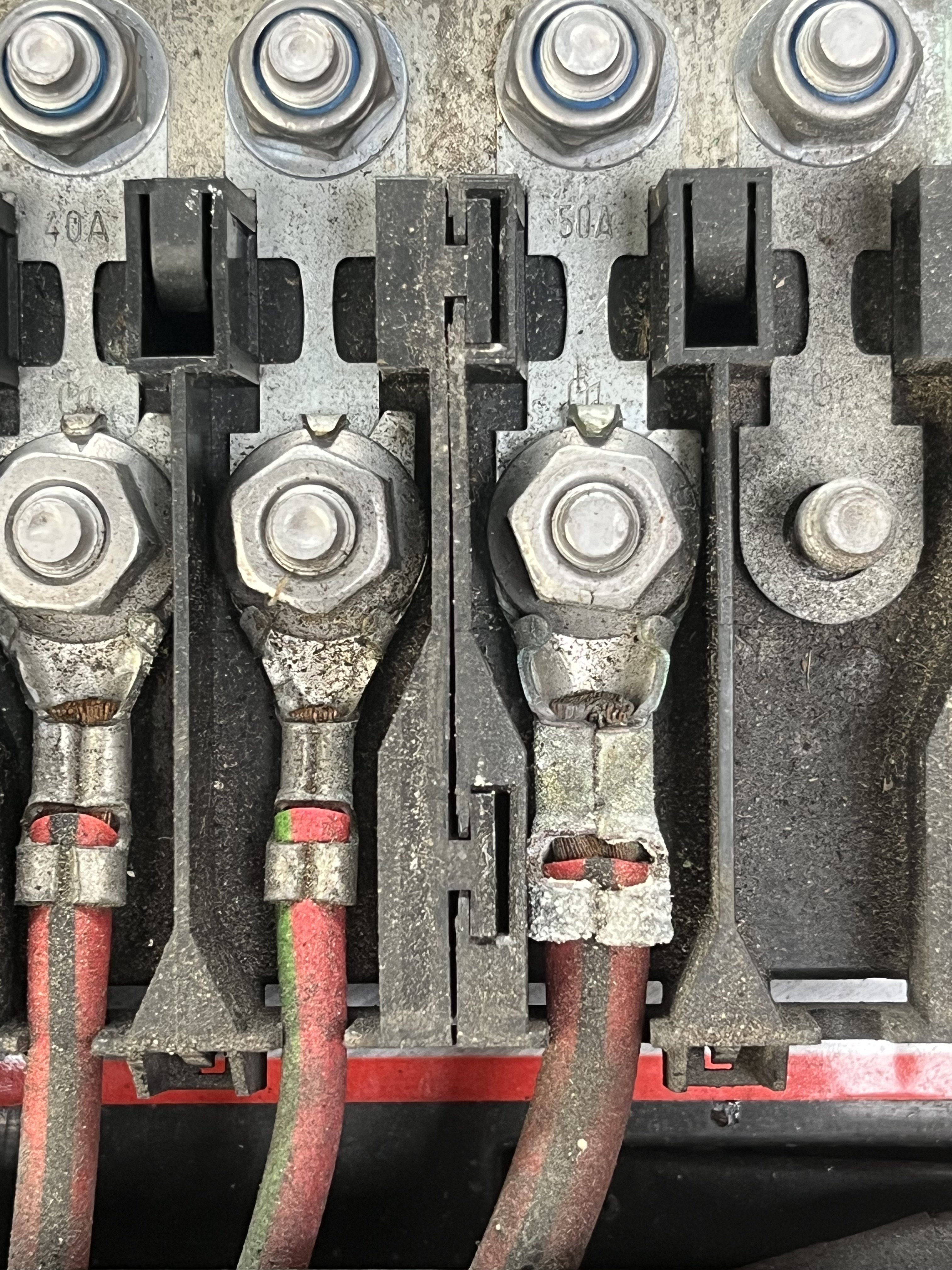

  8. Absolutely, here are some closer shots of the fuses. They do look quite corroded and on the PAS wire the connector looks quite bad as well. I might look at replacing the fuses and possibly the connectors - perhaps they could be linked to the issue? In the meantime I’ll try moving it onto that spare fuse as you said. They seem alright, though I was messing with the negative terminal quite a bit whilst doing the pump
  9. Thanks - here’s the battery-top fuse holder. I can’t immediately see any obvious blown strip fuses or cracks, although a couple of the terminals/cables do look slightly discoloured/oxidised from age. I’m guessing the steering pump is one of the higher-current fuses here so it would make sense if it’s dropping voltage under steering load.
  10. Hi there, Just a question about an issue I've had on my mk1 Fabia 1.2 HTP with electric hydraulic power steering. The power steering was going intermittently so I replaced the pump with a used one which fixed the issue. However, the other day I was turning at low speed whilst my sat nav was powered from the 12v socket ("cigarette lighter") and the power steering just totally died, steering warning light came on and no steering assist whatsoever. I unplugged the charger from the 12v socket and restarted the car and suddenly the steering was back again and lasted an entire journey provided I didn't use the 12v socket. I had previously noticed a correlation between using the socket and having intermittent power steering, as well as erratic handbrake & ABS light flashing & beeping. The only other issue I've had is the airbag light being permanently on since I replaced the pump, and I have no idea how to fix it, but it doesn't really affect driving too much. The battery isn't old and the alternator is charging it fine (I've checked). The cigarette lighter is pretty dirty but still works, I just have to twist the plug into the right spot to get it working. Car is running fine but it's odd that it can't handle anything in the cigarette lighter. If anyone has any ideas I'd greatly appreciate it. Thanks
