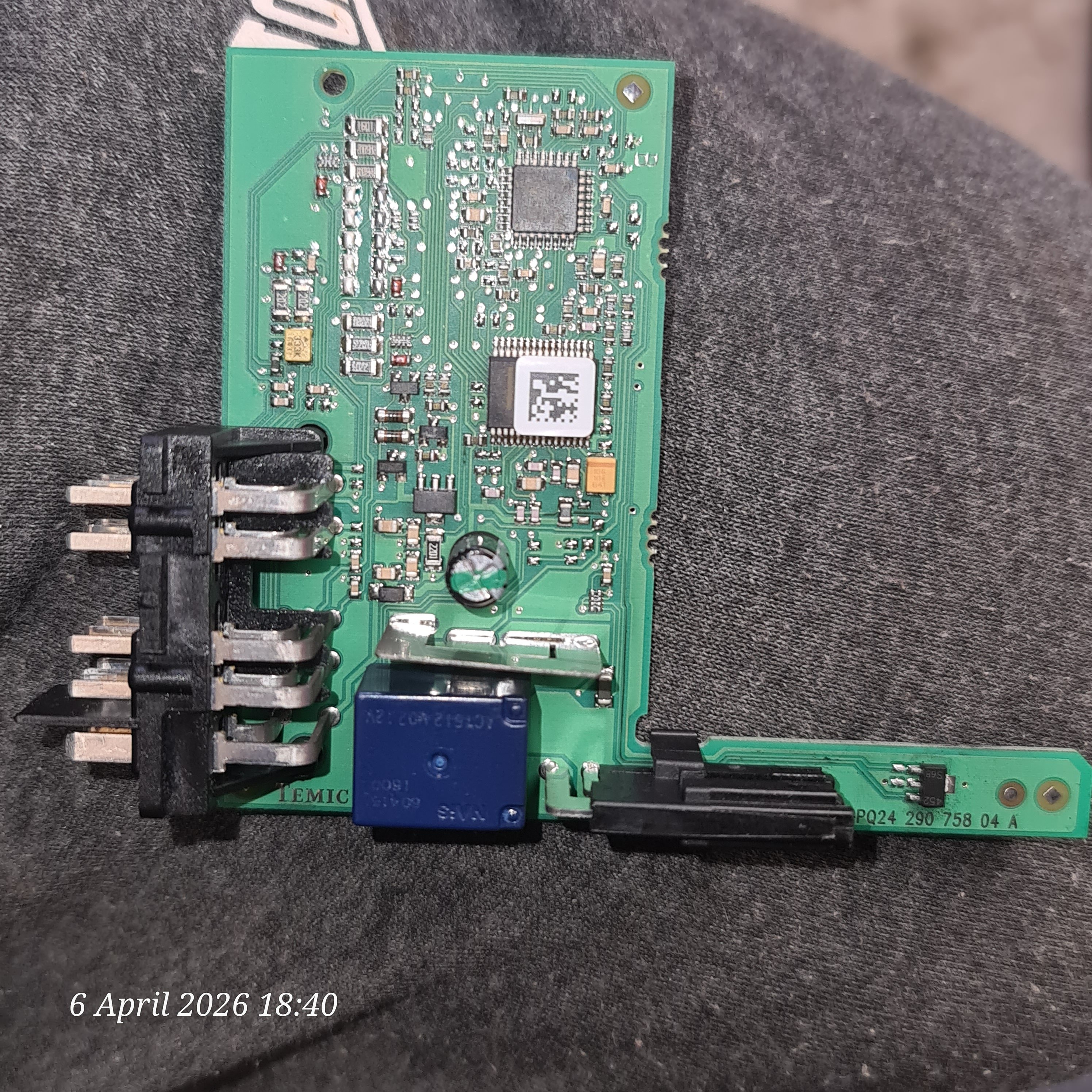

  1. Hi @Breezy_Pete Thanks for your reply. If I can replace the resonator I will but can you show me where it is. I Guess on the driver's window motor electrics board. Where can I buy the resonator? Or is it something I can find on old circuit boards? I have tons lying about. Cheers.
  2. Hello Guys. I am helping my son restore a 2007 MK1 fabia. we have come across a issue with the front electric windows not working, and no matter how much ive searched i cannot come across anything to fix them. both windows used to work until the battery died, then nothing worked. we replaced with a new battery and still nothing. i checked the wiring and repaired most of the wiring in the A pillars on both sides, some were cut through and some questionable. now im finding the passenger front will work intermittet from the passenger door swich but not the drivers, bought and replaced drivers switch and still nothing. i took off the drivers window motor, opened it cleaned the contacts/brushes and tested it with 12v and it worked fine, put the electric board back on plug it back into the car and nothing!! no noise, clicking or anything. can i presume the board is dead? or is there a fix for them, all the joints look ok under the microscope and the capaciter doesnt look blown., i can solder if there is a fix. failing that a new or 2nd hand motor? i am waiting on a kkl and hex-2 cable and vcds so i can check the control moduel under the dash but thats probably weeks away as coming from china. is there anyone with a fix or suggestions. thanks.
  3. @SilverTabby I'm glad you found the issue. My son's was the same it was intermittent. Now that one job down 100 more to do lol.

  5. @SilverTabby I checked all that I could and couldn't see any issues with the wiring. In the end I bought a new door actuator from eBay. My son fitted it and it seems to be working fine now. Sorry can't be any more help. The door actuator was only about £20 so It was worth a try at that price. I might buy an original now I know that was the issue.
