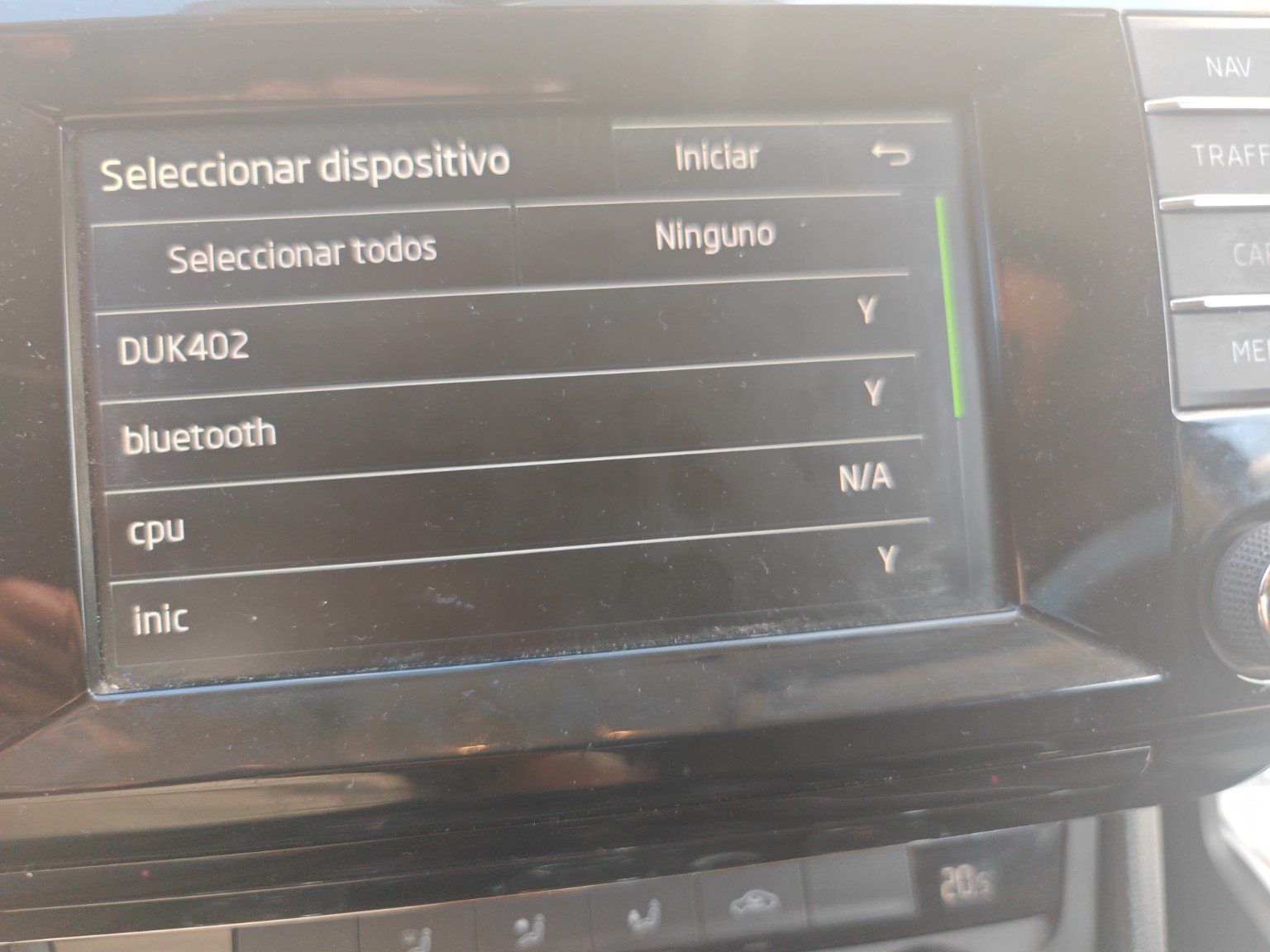

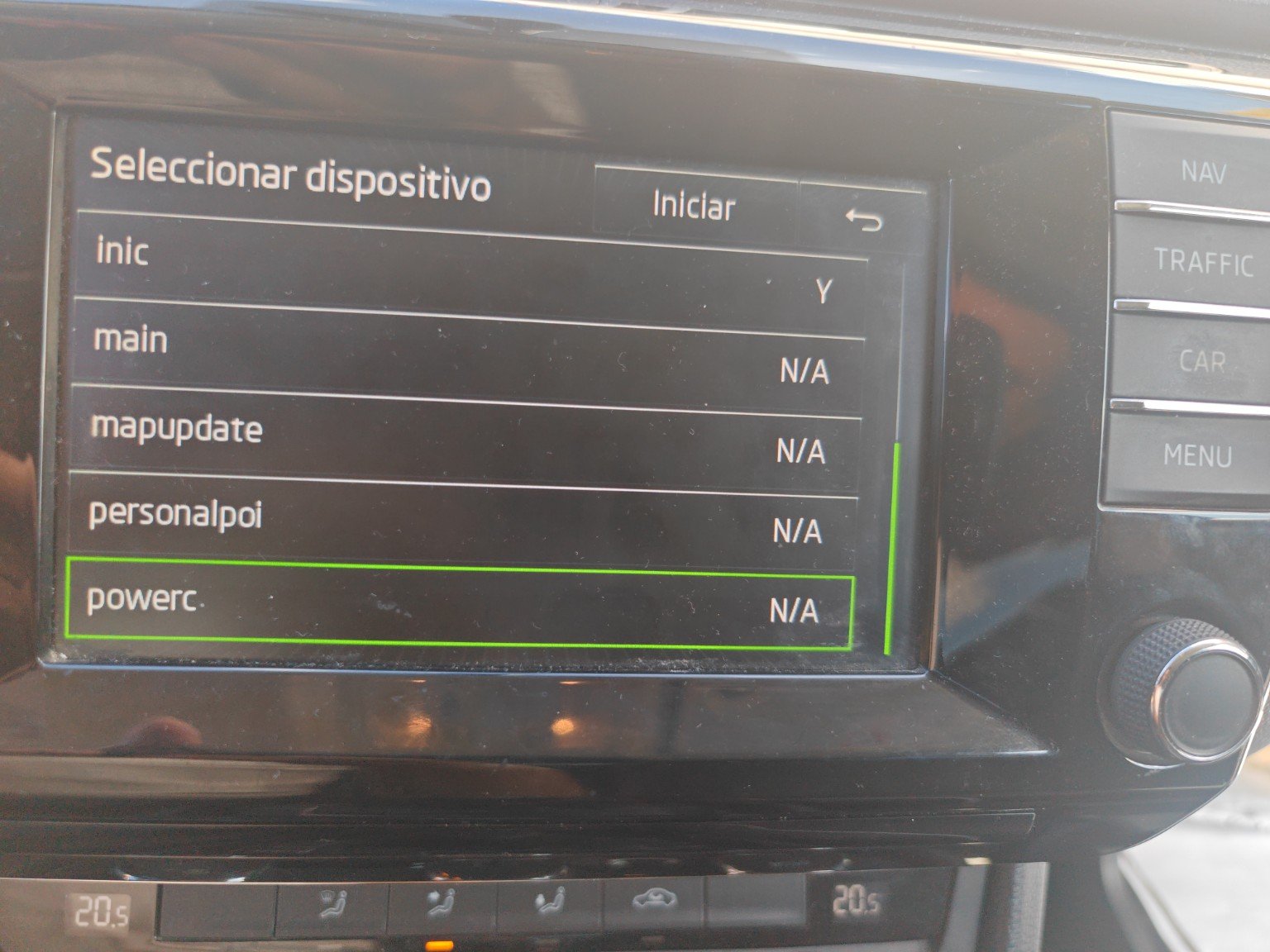

  3. Friend . Are you available?

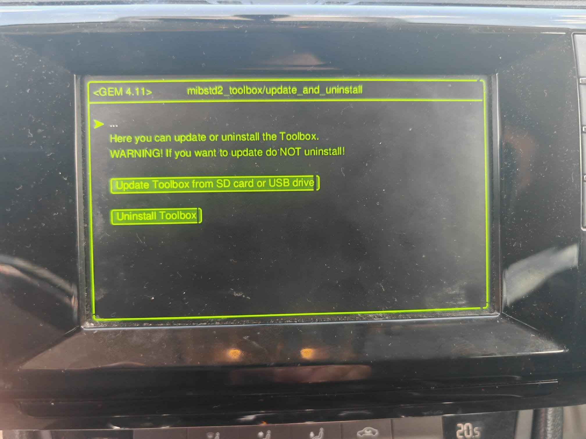

  5. There’s something strange going on because most of the packages show as N/A and only inic is available for update. cpu is also showing as N/A, together with main, mapupdate, personalpoi, etc. Does this mean 253T is too old and I need to flash an intermediate firmware before 480T? Also, during the update, should I untick/disable the esd_sec package to keep the toolbox and patches? I’m also attaching my modified metainfo2.txt in case you notice something wrong with it. metainfo2.txt

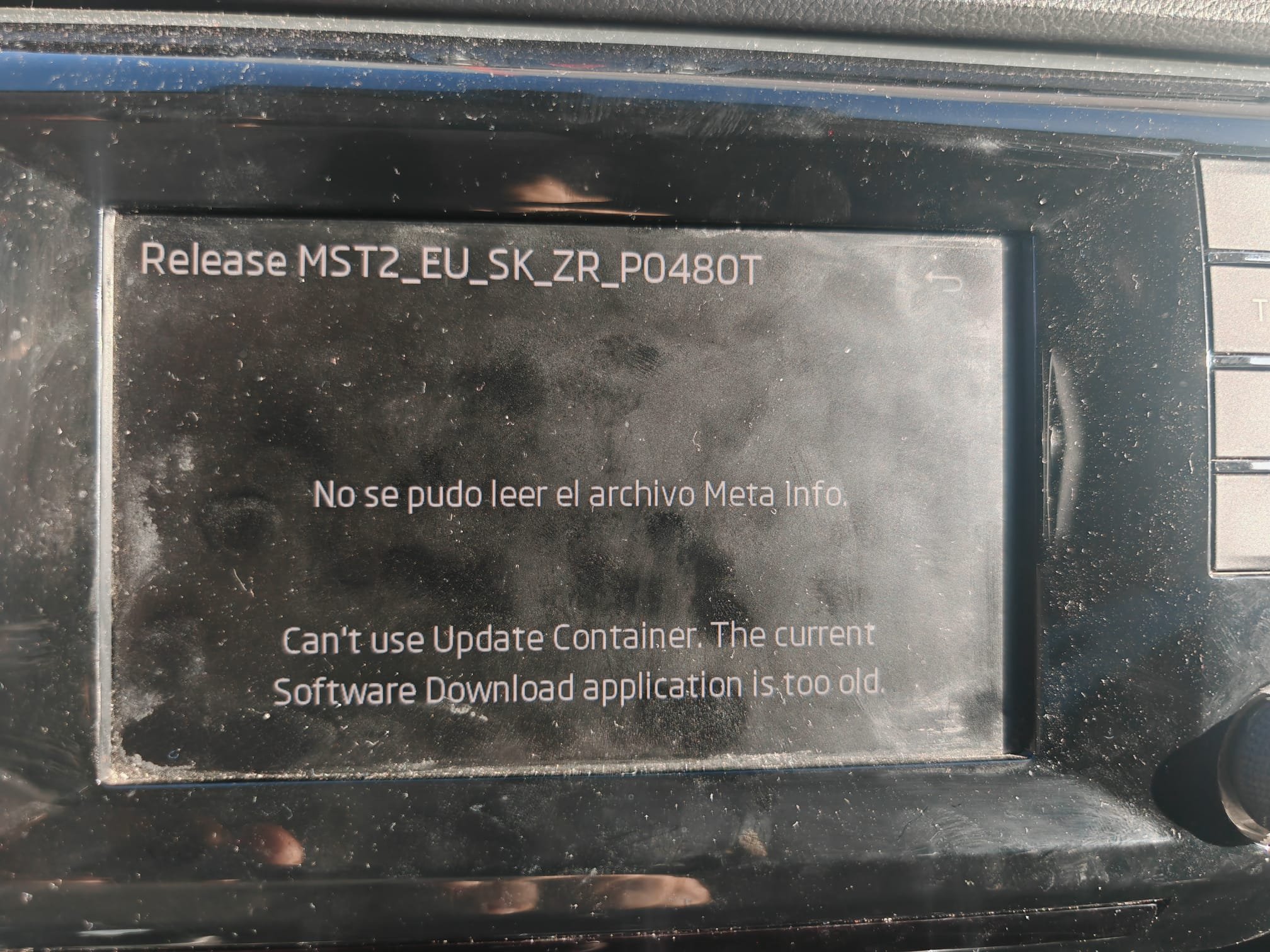

  7. Good Morning I already patched SWDL and modified the RequiredVersion values in metainfo2.txt to 0, but when I try to install the firmware from SWDL through Test Mode, it still says that the current software version is too old. I’m attaching a screenshot.

  9. I’ve already run the “Patch tsd.mibstd2.system.swdownload to accept any metainfo2.txt” patch. Can I go directly from 253T to 480T now, or do I still need to modify the metainfo2.txt first?

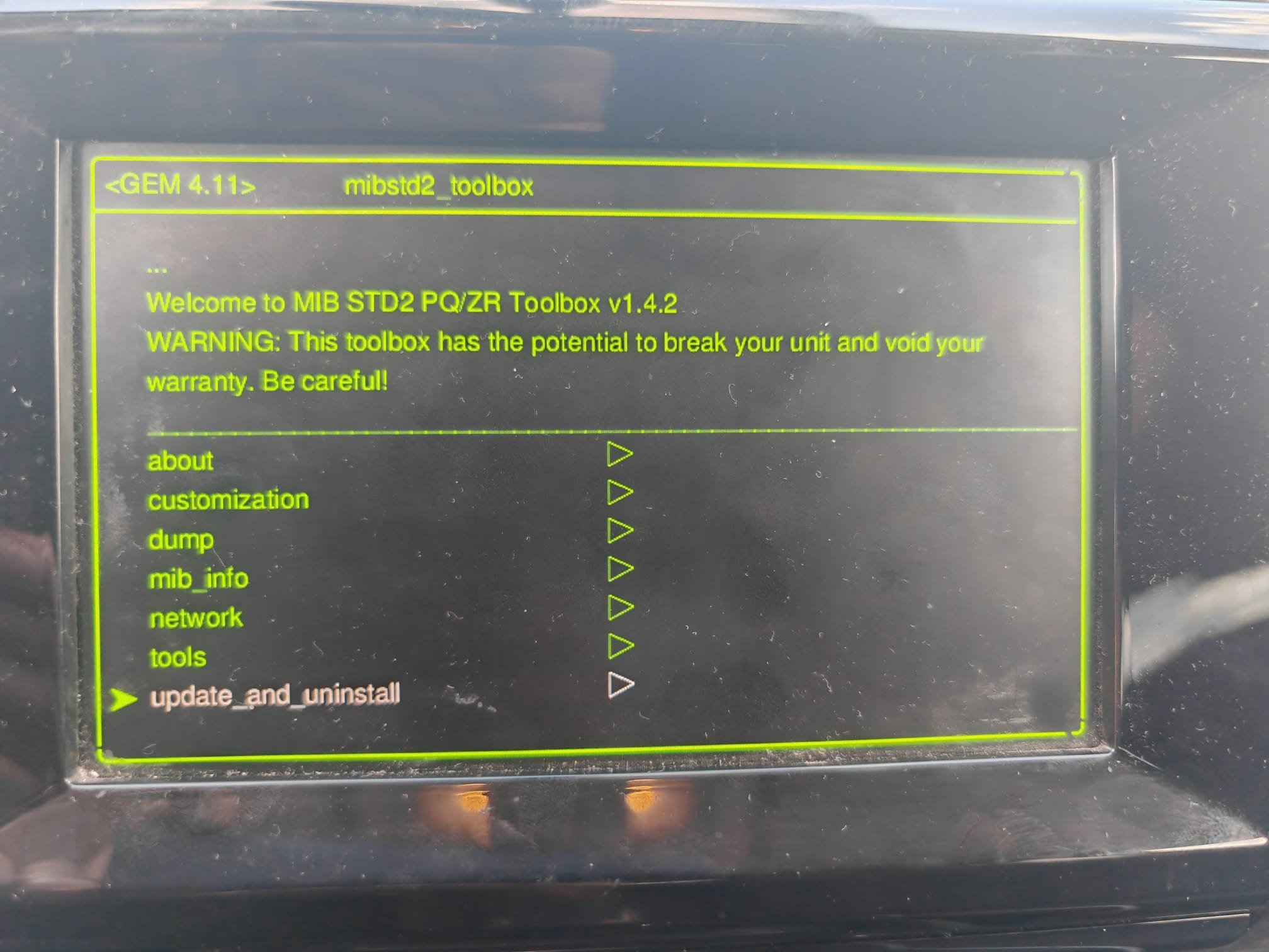

  10. The problem is that I don't know how to continue from here. I'm attaching screenshots.

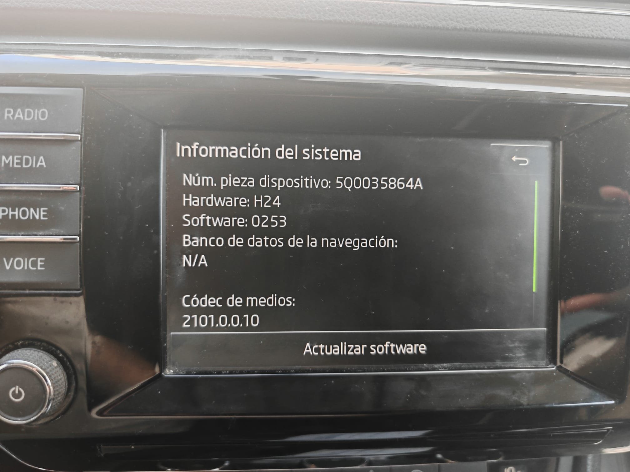

  13. Hello everyone, I’m trying to update the firmware of my unit, but I’m running into several issues when attempting to upgrade to a higher version. Currently, I have: Hardware: H24 Software: 0253 Unit: 5Q0035864A I’ve attached a photo with the system information for reference. I was able to install version 0253 without any problems, but when I try to upgrade to newer versions (such as 0366 or 0480), I get errors like “software too old” or the system doesn’t recognize the update package. Does anyone know if there is a way to upgrade from this version on this unit? Do I need to follow specific intermediate updates or unlock something beforehand? Any help or similar experiences would be greatly appreciated. Thanks in advance!
