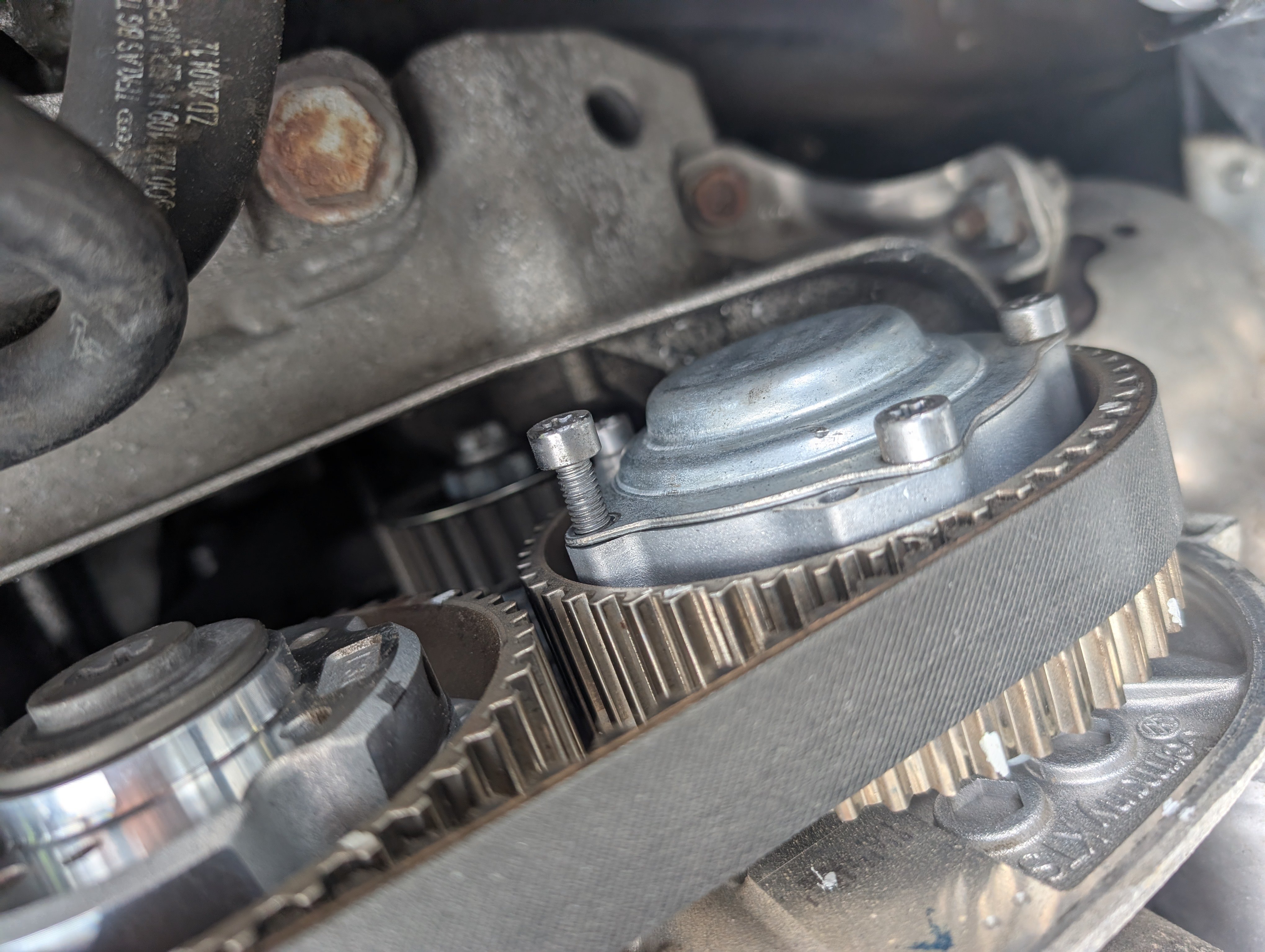

  1. Hi I just had this same failure on my VW Passat - the bolt backed out and started catching the aluminium casing just below the timing cover. The cover hadn't started leaking so I reinserted the bolt with a small amount of thread lock. The other bolts were all loose. It has had a timing belt done about 3 years ago. Would it be worth replacing the bolts, or just check they're torqued to spec? Ben
