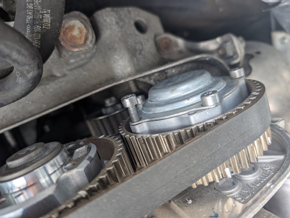

Hi All, just created an account on here as I've got an issue with my 2018 Leon's 1.4 ecotsi engine which seems to have been mentioned a couple of times on this forum before, e.g. here:
https://www.briskoda.net/forums/topic/517966-loose-bolts-on-camshaft-pulley-just-a-heads-up/

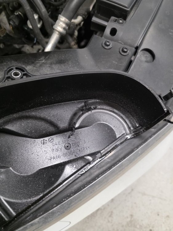

Basically, exactly as in that thread, some of the bolts holding the cover plate onto the end of the exhaust camshaft pulley came loose and one disappeared competely, scoring the inside of the belt cover before presumably falling into the belt well.  I retightened the bolts and replaced the missing one but now the engine is very tappety and almost sounds like a diesel.
I'm struggling to understand what's causing the engine to run badly now really as the dropped bolt doesn't appear to have fallen into any pulleys as there's no apparent damage to them or the belt and if the timing had been affected in some ways I'd expect a warning light.  The loose cover did leak a small amount of oil but not much.  Any thoughts on this?   I desperately need to sort this quickly as I can't do my job without this car!

The bolts come loose because engine oil leaks from the actuator which either softens any thread sealant if it was used or more likely reduces the frictional grip between the flange and pulley allowing it to fret backwards and forwards due to the clearance holes for the bolts, there is no drive dowel and they are not fitted bolts (possibly for timing set up), I am assuming its a clamped flange and not a cover plate, without seeing it I may be wrong.
Fitting new bolts does not stop the underlying problem of the oil leak which if severe will prevent the actuator from adjusting the valve timing or maybe its simply the flange having worked loose immediately.
It is telling that VAG say the actuator has to be replaced, oil and timing belts are not a good combination, I would remove the belt cover and look again, if there are any signs of fresh oil then replace the actuator ASAP.
Well I had another look today and have found the timing belt is slack between the camshaft pulleys, over an inch of up and down movement.  I'm going to assume that isn't meant to be the case right!?
My thinking is that the repeated "tug" on the belt as the loose bolt clattered into the timing belt cover on each rotation has knackered the tensioner, is that a reasonable theory?
If engine is now thought to be not running as well as previously, it is very possible that the belt has 'jumped' a notch on the pulley - the lost bolt could well have fallen between the belt and pulley when it was displaced. It also sounds as if the tensioner has failed. These issues need to be checked immediately before any further damage occurs.
Edited by Warrior193
correction
Yes absolutely, I think I've been extremely lucky here, or at least I hope I have.  It's booked in for Thursday at the garage so I'll get the belt and tensioner etc. changed and get them to check the camshaft adjuster.
Just to round this off in case anyone with a similar issue in the future finds this thread, it was indeed the cambelt tensioner.  New belt kit sorted it and it now runs perfectly again so all of the rattle sound was from the tensioner itself or the loose belt.  I also got the exhaust pulley changed just to be safe, although it didn't appear to be damaged.

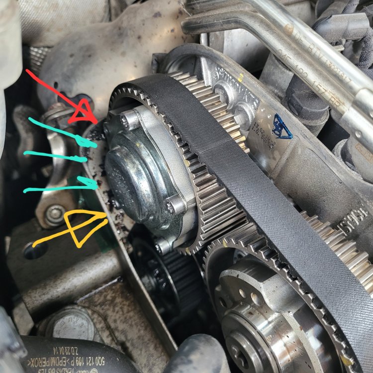

My 2018 Skoda Kodiaq 1.4TSI (52,000 miles) has a very similar problem.
Had the timing belt done at 5yrs old as recommended.
A couple of weeks ago heard a noise but couldn't figure out what it was, noticed a significant oil leak a day or two.
Now in the garage (that did the timing belt) and here's the issue:
One bolt is missing (red arrow) and another is loose (orange arrow). The missing bolt must have been loose and backed out, then ground to smithereens as the pulley rotated. The remains are sitting in the housing (teal arrows). The pulley has been squirting out the empty bolt hole, the timing belt is soaked in it.
Think I need a replacement variable timing pulley and seal behind it, plus a new timing belt. Does that sound about right? (I'm not going to do this myself).
Second question - could this be related to the timing belt replacement 18 months ago? Sounds like it's an oil leak that causes the bolts to loosen, but that was not an issue previously.
As a non-expert I would be thinking yes it absolutely could.
It's also very suspicious that the garage doesn't want the work to put it right.
I think you need an expert second opinion from a mechanic that can inspect the vehicle, and if they tell you the garage is at fault, chase them up for repair costs.
Who last worked in that area? - the garage that changed the timing belt.
Who should have noticed loose bolts or didn't tighten bolts correctly while working in that area? - the garage that changed the timing belt.
As @EnterName says it's very suspicious that they don't want to put it right. I also agree that you should get an expert second opinion and if he/she agrees with us then "have a discussion" with the garage that changed the timing belt.

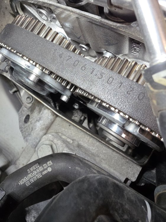

Same here, same engine, VW Passat 2018. Happened yesterday at 107700 km.
Timestamp on belt is 2018-01-15 - last 6 numbers, meaning noone been replacing it before.
Going to loosen bottom cover tomorrow to see if the bolt has fallen down.

How do you know that shavings gone into engine?
The whole construction of cogs, wheels and the belt are hanging outside the engine with 2 plastic and 1 metal covers barely sealed, dust and other particles are getting inside all the time, but they never reach inner engine.
I'm mostly worried about shavings damaging the belt itself, creating tiny cracks that could get larger with time..

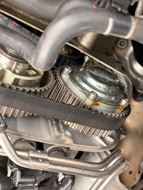

I did this myself today, was hard to get the bolt out without disassembling alot of stuff, but managable.
The shavings were soft aluminium flakes from the middle cover and plastic from the top cover. The bolt was not too damaged, meaning it didn't drop many flakes of hard stainless steel.
I guess I was very lucky that bolt didn't hit somewhere hard. But I did stop the engine as soon as I heard the knocking sound and never started it again until fully cleaned up.
The bottom plastic cover has 3 top screws, but it partially lays behind the largest wheel that rotates the generator belt. So I could just bend the plastic in order to get the nozzle with compressed air inbetween, then used a small telescopic magnet to capture the bolt. It took a while, blowed at many different angles, and finally it got stuck.
Then total cleanup with alot of compressed air again, moving the camshaft manually by hand, centimeter by centimeter. The belt looks good, so I'm skipping the replacement this time, don't really have 1500 euro to throw away right now. But yes, if the belt got damaged, then I might be fu*ked up at some point 🤦‍♂️

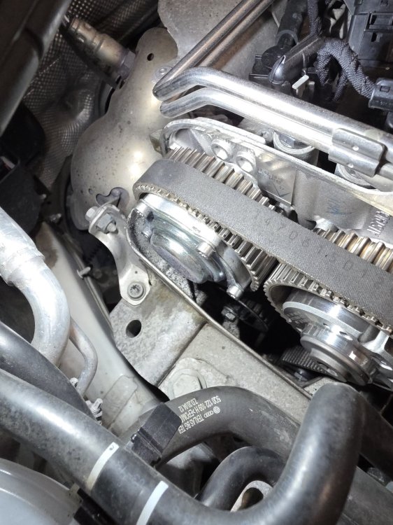

I just had this same failure on my VW Passat - the bolt backed out and started catching the aluminium casing just below the timing cover. The cover hadn't started leaking so I reinserted the bolt with a small amount of thread lock. The other bolts were all loose. It has had a timing belt done about 3 years ago. Would it be worth replacing the bolts, or just check they're torqued to spec?
26 minutes ago, bbroadbent said:
Hi
Put locktite on before tightening.
If you’ve caught it that early I think you’d be fine just tightening the bolts to spec like you suggested just use some thread lock on.
