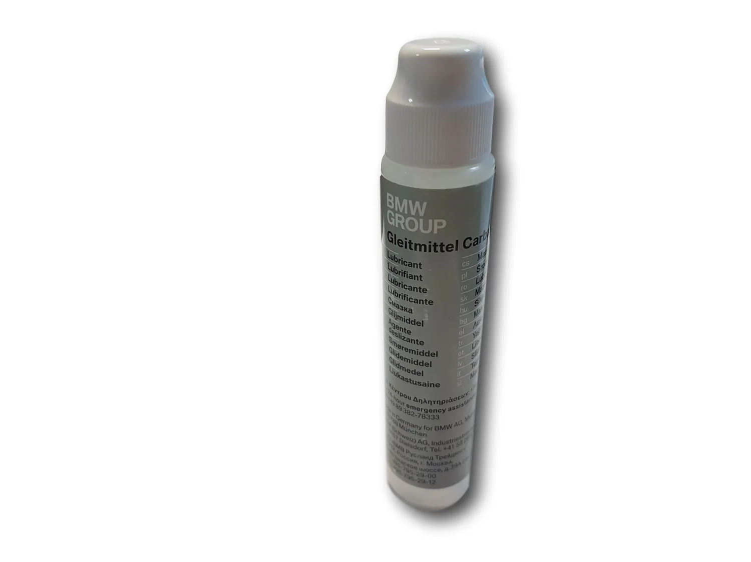

  2. Hi, I am writing to update the product details I posted recently. The correct product should be BMW Carbaflo KSP 105, or Krytox GPL 105 as a plan B. Sorry for the mistake.

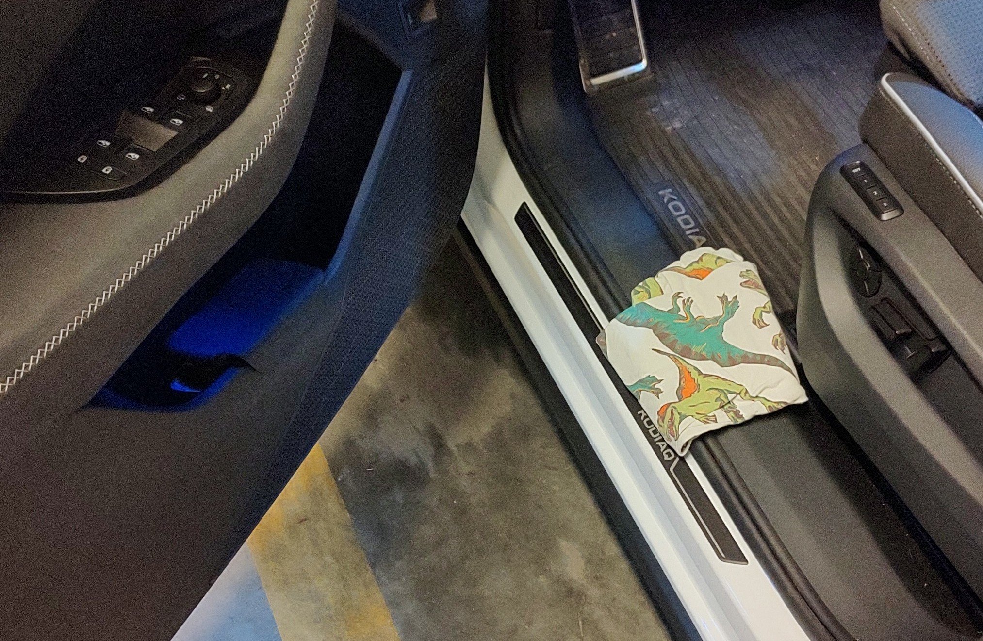

  4. I have great news. My Kodiaq has never been so quiet :). Skoda has solved the problem. I'll describe the whole situation along with recordings, and hope it'll help you get rid of that rattling sound. Let's start from scratch. I had a rattling sound on the driver's side of my Kodiaq. I noticed that if I push the driver's door a bit with my elbow while driving, the rattling stops. Another way I could eliminate the sound was by placing a cloth in the bottom of the door jamb before closing it. If your noise sounds like the one in my recordings, then you probably have the same problem as I did. I tried applying a rubber care product on the seals with no effect (but thank you to BudgieUK for sharing that solution). Before dropping the car off at Skoda, I recorded some audio and video so you can hear the sound and see what I did to make it disappear. Please check out the audio and video files from the OneDrive folder. The rattling sound happens only when I close the driver's door. When it's open, there's no noise. Kodiaq-Rattling-Sound Yesterday I got my Kodiaq back and everything is okay now. The problem was the driver's door striker plate. See the photo below. They simply adjusted it, and the rattling sound is completely gone. Give this a try if you are struggling with the same issue as I did. Hope this helps. Thanks to all of you who tried to help me out.

  7. Thank you for replying to my post. I don't think it's the door card. If I push the door at the top, center or bottom while driving, I have the same effect. No sounds. Another way I can eliminate the rattling sound is by placing a cloth in the bottom door jamb before closing it. I think this creates a bit more distance between the door and the door opening. Please see the attached photo.
