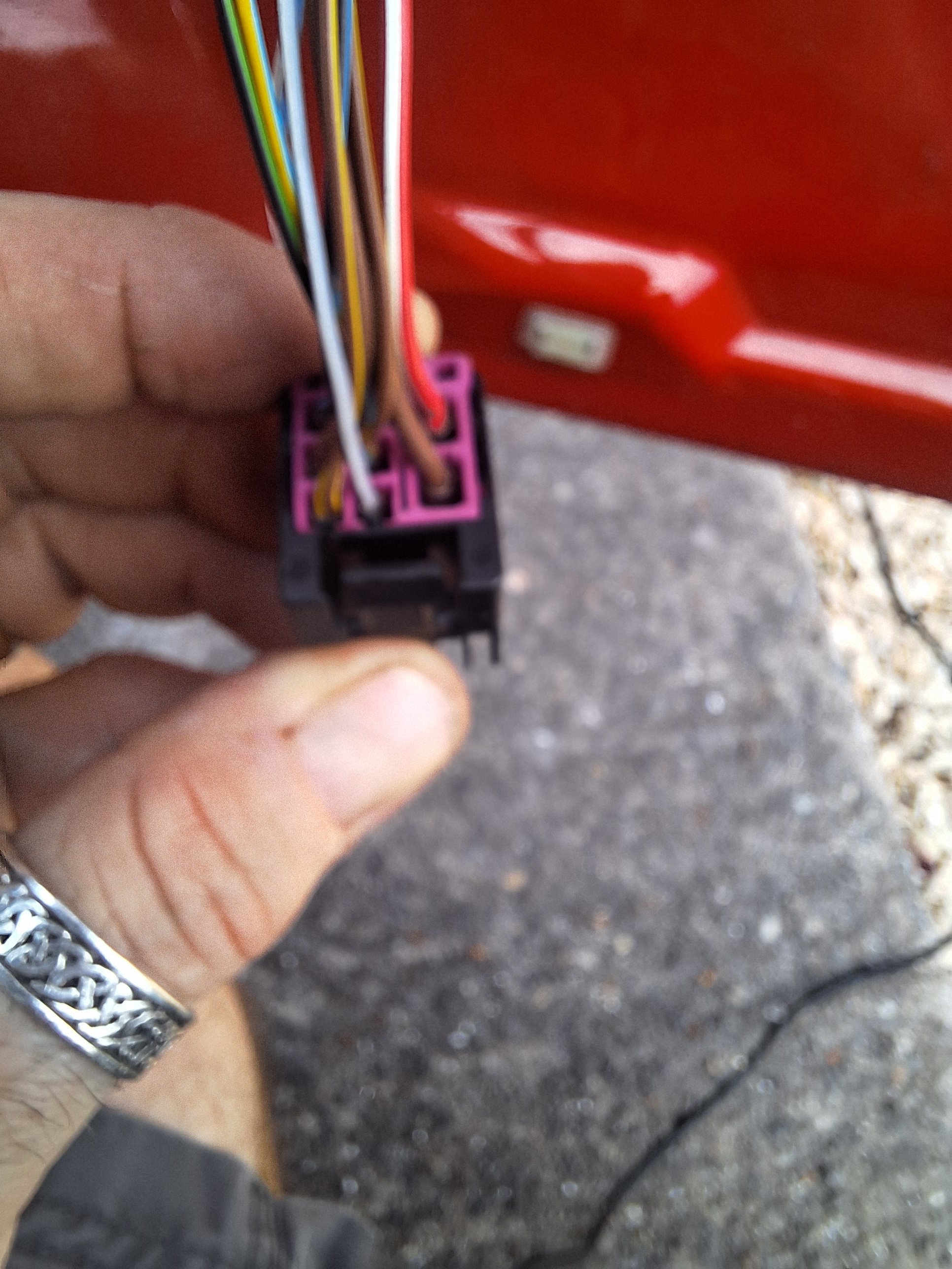

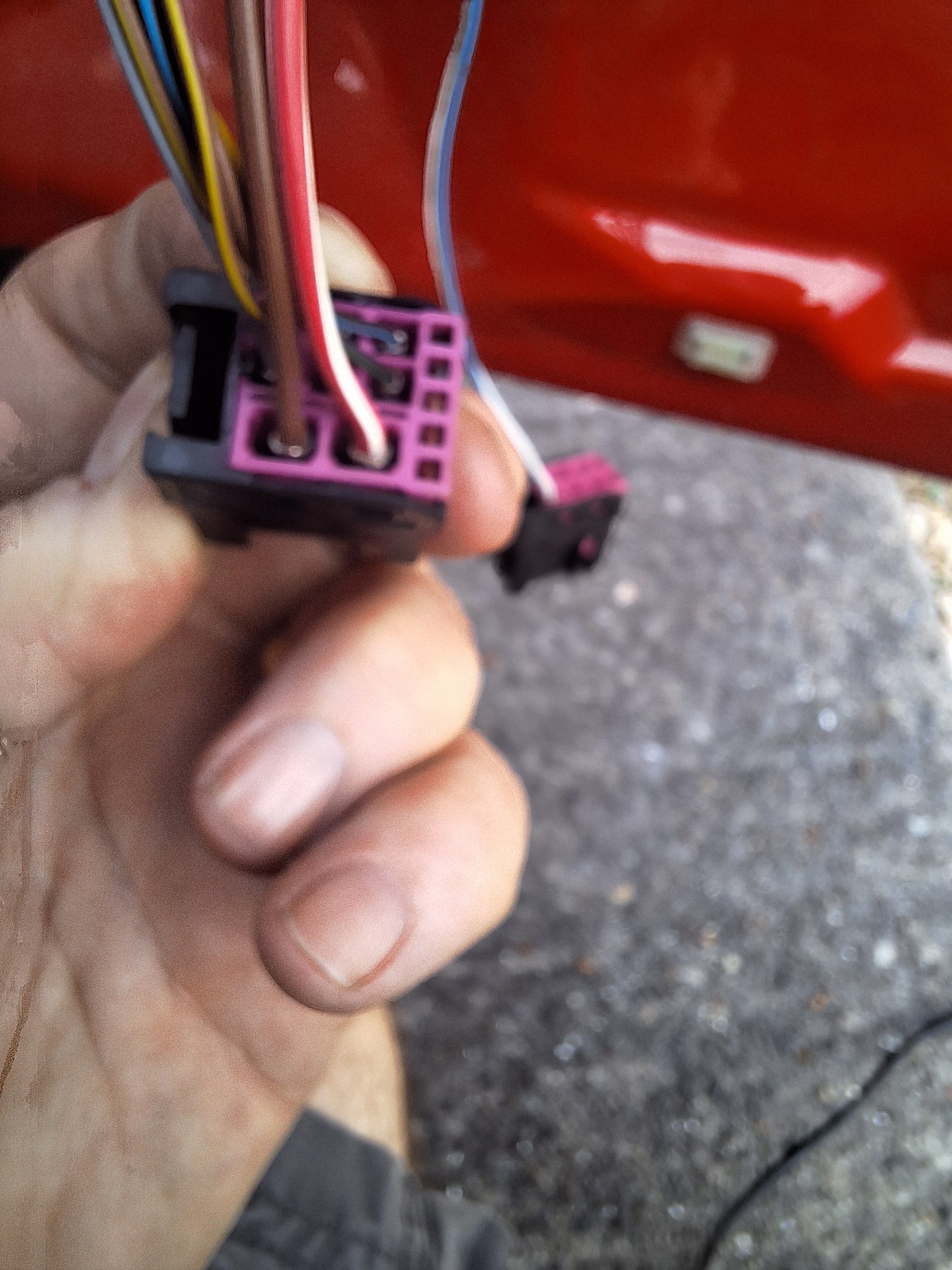

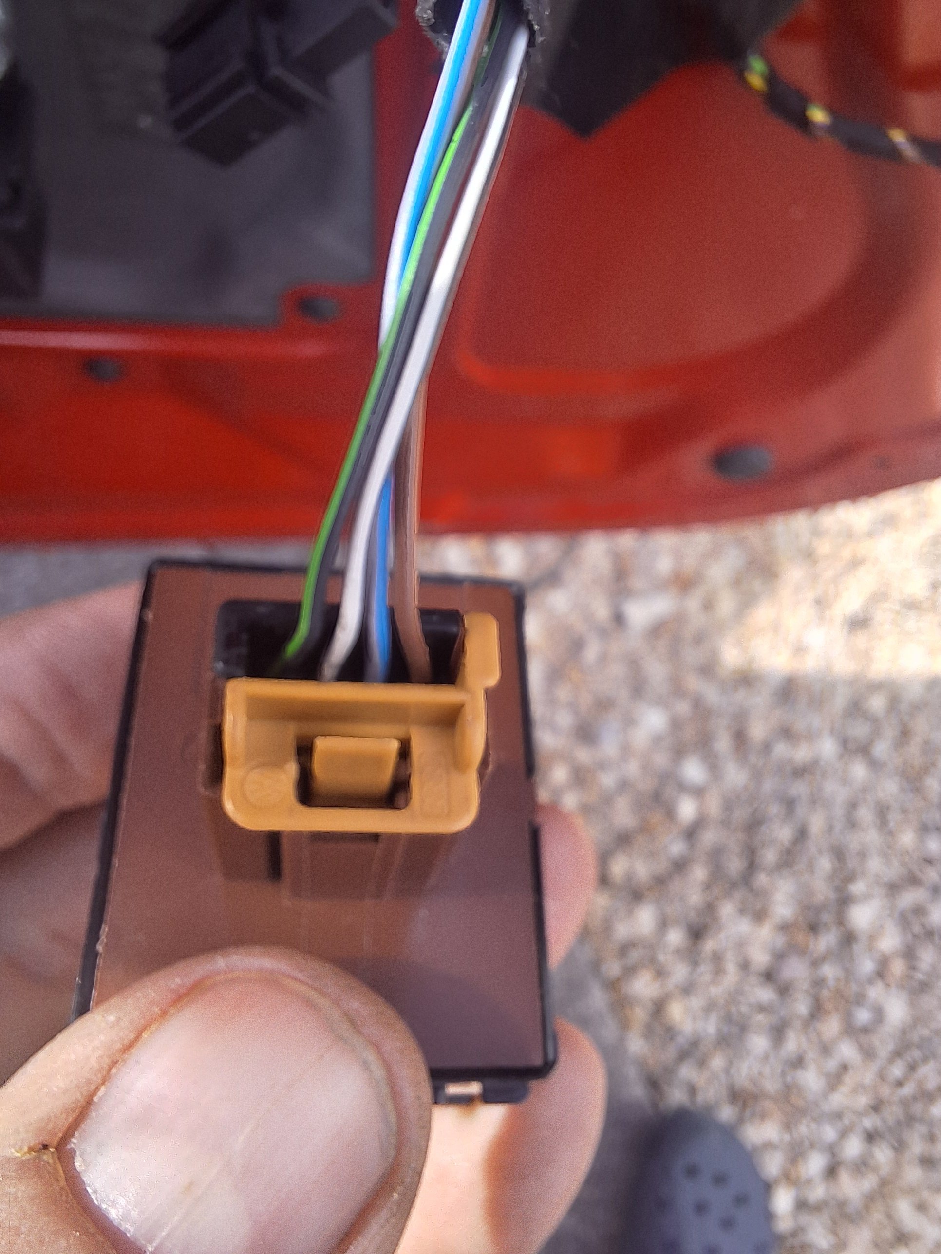

  7. Hi again. Fuse 11 is ok. 7.5 amp? But stays live the whole time.. The blue black wire in the small plug stays live all the time with ignition on. . The large brown wire on the motor is an earth. The red and white large wire is live with the ignition. On. Extra info. This time the passenger window stopped after about 10 minutes. Door shut. The drivers window stayed working for a long time with the door open! Stopped after 10 minutes of door being shut. So time starts on door closed signal being detected? Also drivers window works the wrong way round. Up is down and down is up. 🙄 Passenger window only works on passenger door. Drivers side swith has no function. I have attached some images

  9. Hi, that's useful information. Thank you. I'll double check that tomorrow. Nightmare with out wiring diagrams. Where's Highworth? Robin And thank you!
