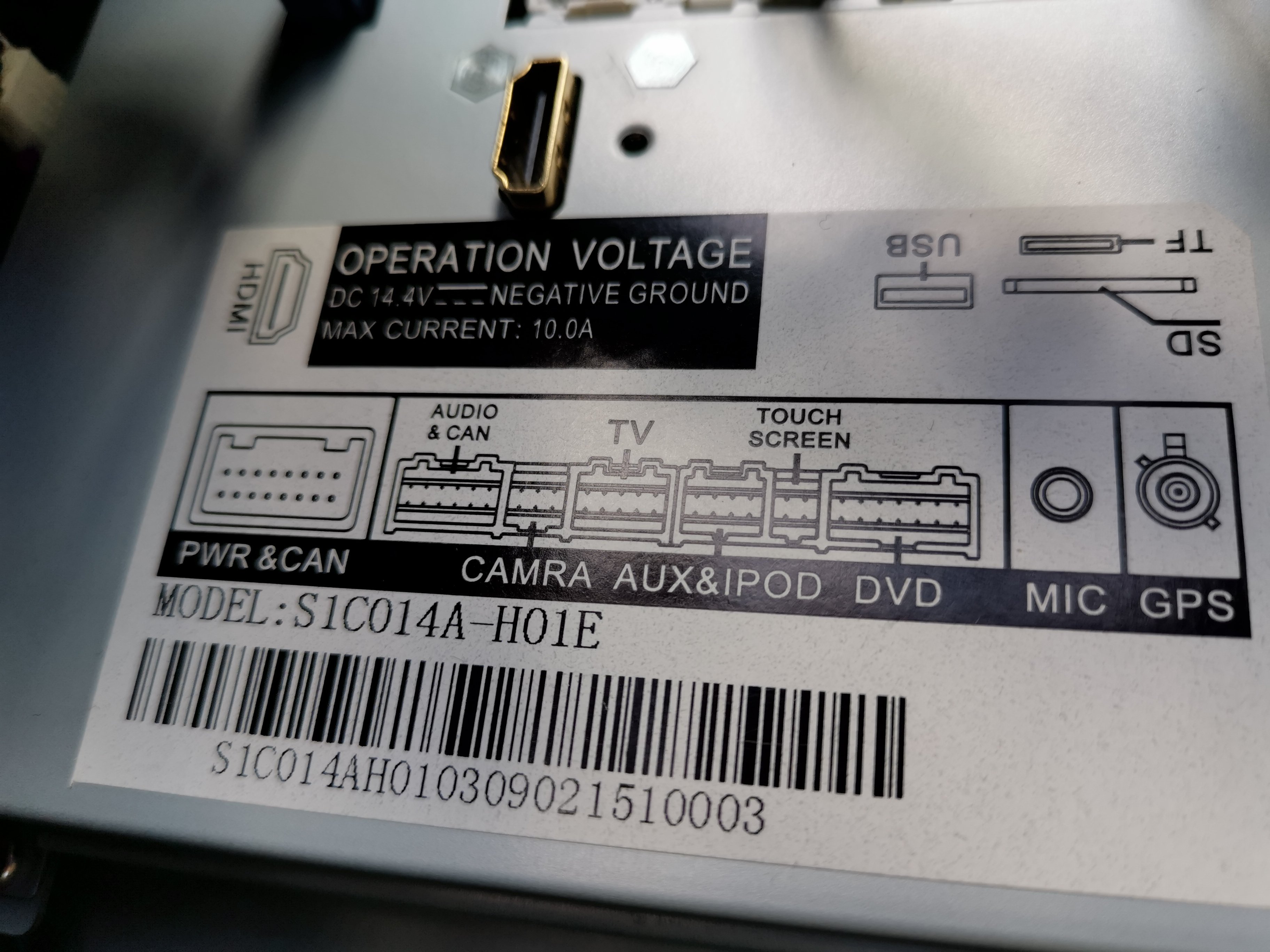

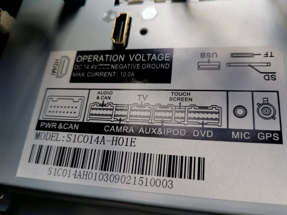

Hi A bit of an update to this.... I contacted Car Audio Medics and they informed me that the unit is a cheap Chinese copy and they have no access to spares or replacement parts - so it's finished. I sent this information to Skoda and asked them what they are going to do about it - as when they sold the car to me, they told me the system was an 'upgraded' model... Anyway, after some 'discussion', they are going to replace the unit - with genuine parts. Can someone tell me what model I should be getting and ask for because I still want the Bluetooth and DAB to work - or do all the models do that? I don't want them to fob me off with some crappy old model. I'm quite happy to pay some money towards an upgraded version if its going to be noticeably better than whatever they offer me. Any advice appreciated. Cheers BTW - car is 2014 vRS MkIII.

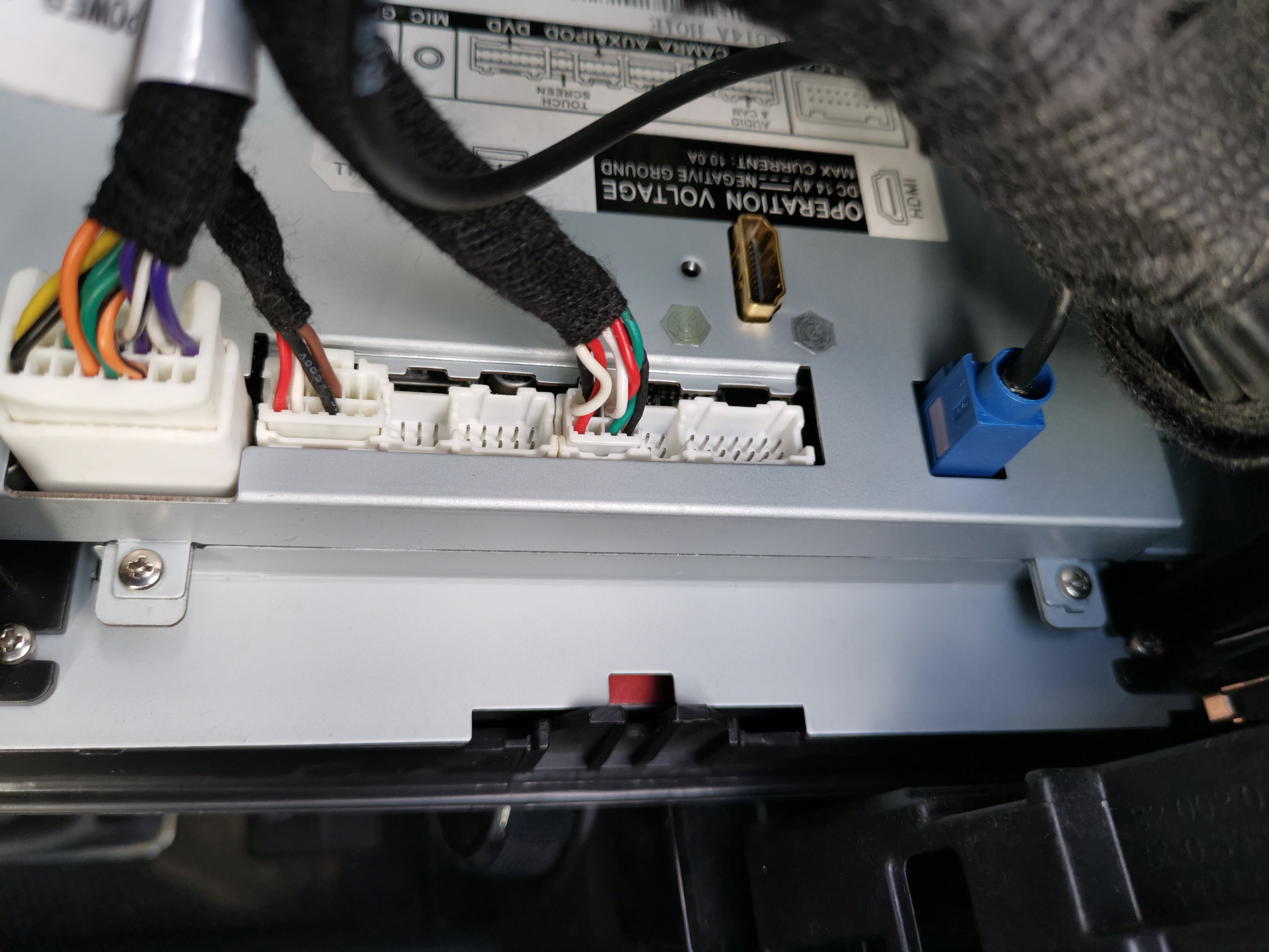

Yeah it looks nothing like the normal connector - but that might work in my favour if it those connectors fit in a standard cheap Android unit. Anyway I've actually found these guys not too far from me... https://www.car-audiomedics.co.uk/ So hopefully they can just fix the screen. I really don't use the actual unit for anything other than DAB but even could get away with not using that as I have everything on my phone. The Nav is completely useless in my opinion and out of date from the moment it was installed - I can't see why anyone would use anything other Google Maps - so my phone is fine for that. Also I use my phone via Bluetooth for Streaming music - so don't really want a complete new system. The screen really is used just for changing options in car that I can't access from anywhere else. I'll look at removing the glovebox part but and see what is connected anyway.

Sorry to keep posting but can I just buy a cheap Android 10 unit and swap it over? Will I still be able to see the car information and menus?

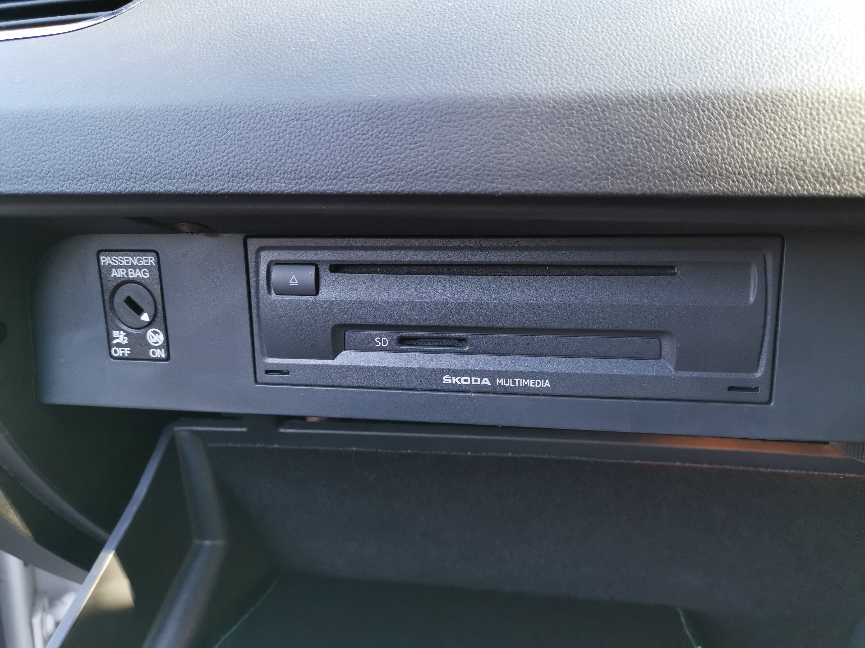

Searched the internet and that model does not come up anywhere... Bit odd.

Finally got some keys to pull it out. Found a fuse behind it but it's fine. Screen still blank.
