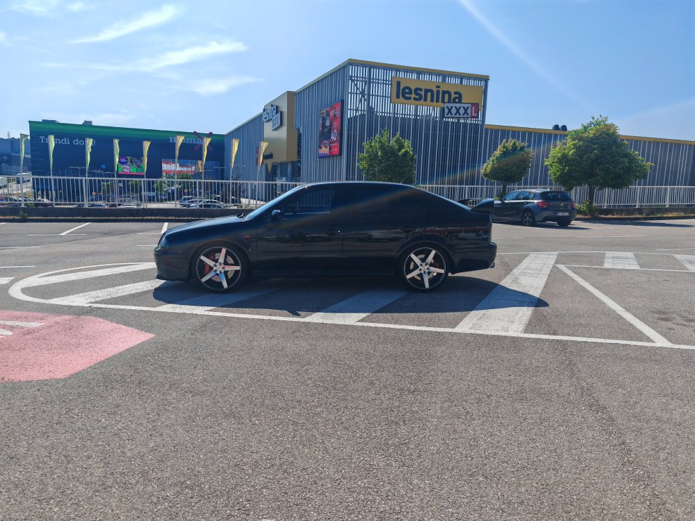

Thanks, goes like hell but will go even better with my all new setup. This is the track I drive my car
AUTOMOTODROM GROBNIK
Here is teh fastest croatian driver Marin Colak from WTCC with new M3 1.43.000, and next to that Maazda MPS 1.49.000( guy drives it like hell), most of the GT3 are between 1.49.000 and 1.52.000. For the moment I did my best lap time on rally tires Matador 610/605/16 1.58.013 with old coils from Jamex and only with camber settings upgrade to -1.5. I can't wait for my new lap times:D

those wheels look so nice does 19' effect it much on the track ??? would have thought they would be a little to big.... car also looks so shinny in the first pick
