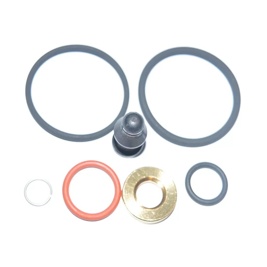

  4. Ok. Got it… What about testing the injectors with the spare AL ARL injectors? Swap and see what happens…I have a slight misfire, tractor sound… The mechanic has used an injector kit like this so I suspect he has done something wrong…

  8. Has your BLT run fine with the Egr deleted and EML on? or did it experience a loss of power? I have removed the EGR, but I also changed the cam and injector seals, and now the car is down on power…
