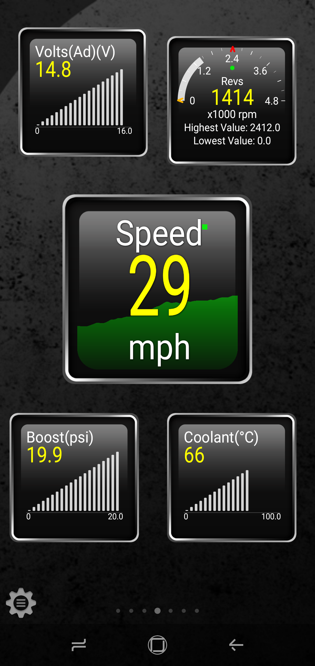

Android phone, screen or dash holder, Torque app, Bluetooth OBD2 - does it show any boost when driving - YES or NO. Example is from a 1.2TSI Polo so boost will not be same. Baseline data will allow people to review rather than assuming the typed word which does not always contain full, applicable or correct information.
Not sure I'd trust any of those figures, because I'm seeing the alternator overcharging enough to boil the battery and fry the electronics, and the radiator overcooling enough to kill the fuel consumption if those values are accurate.
