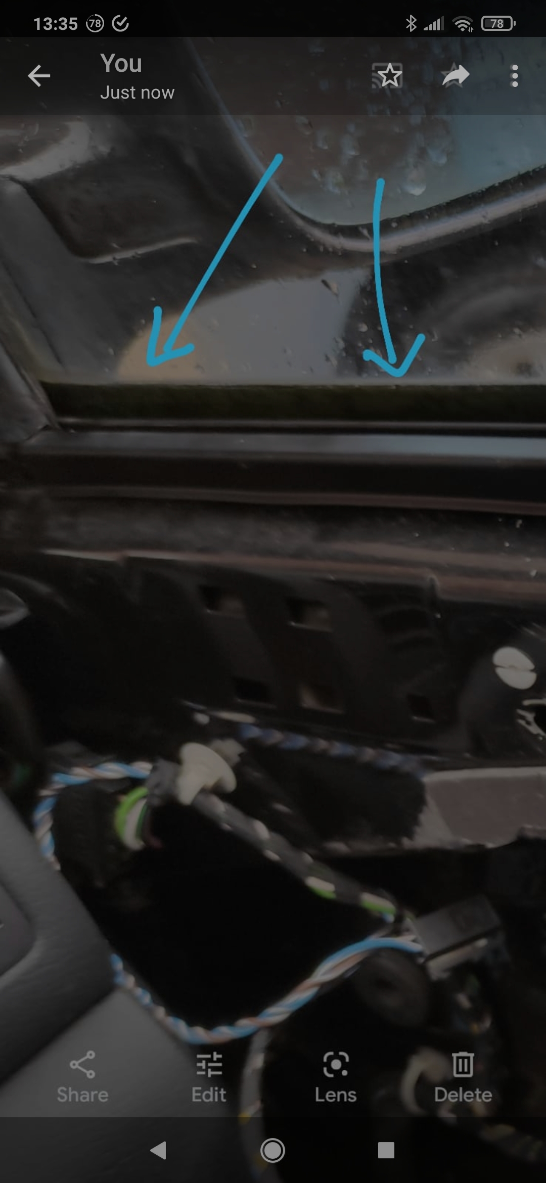

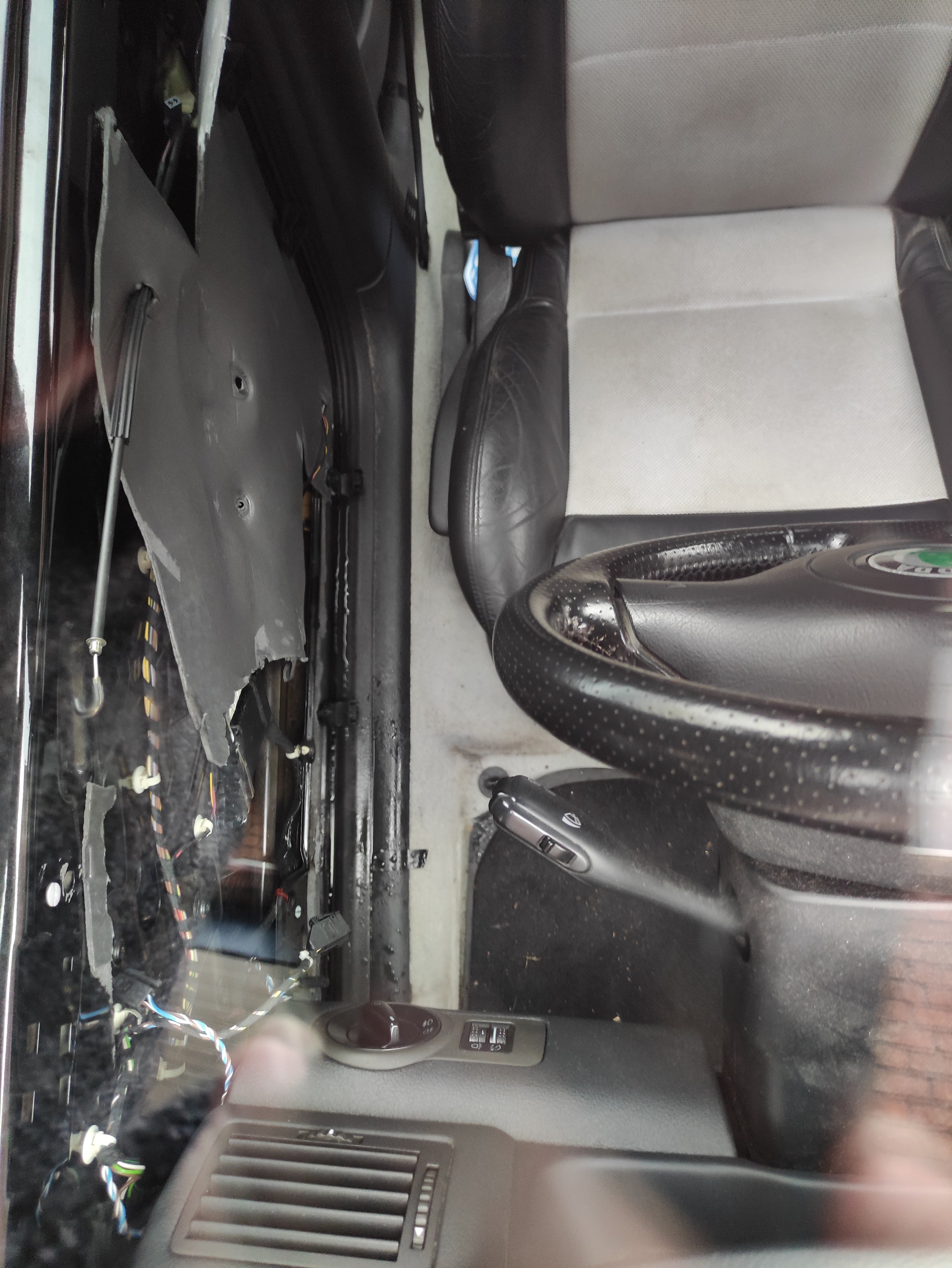

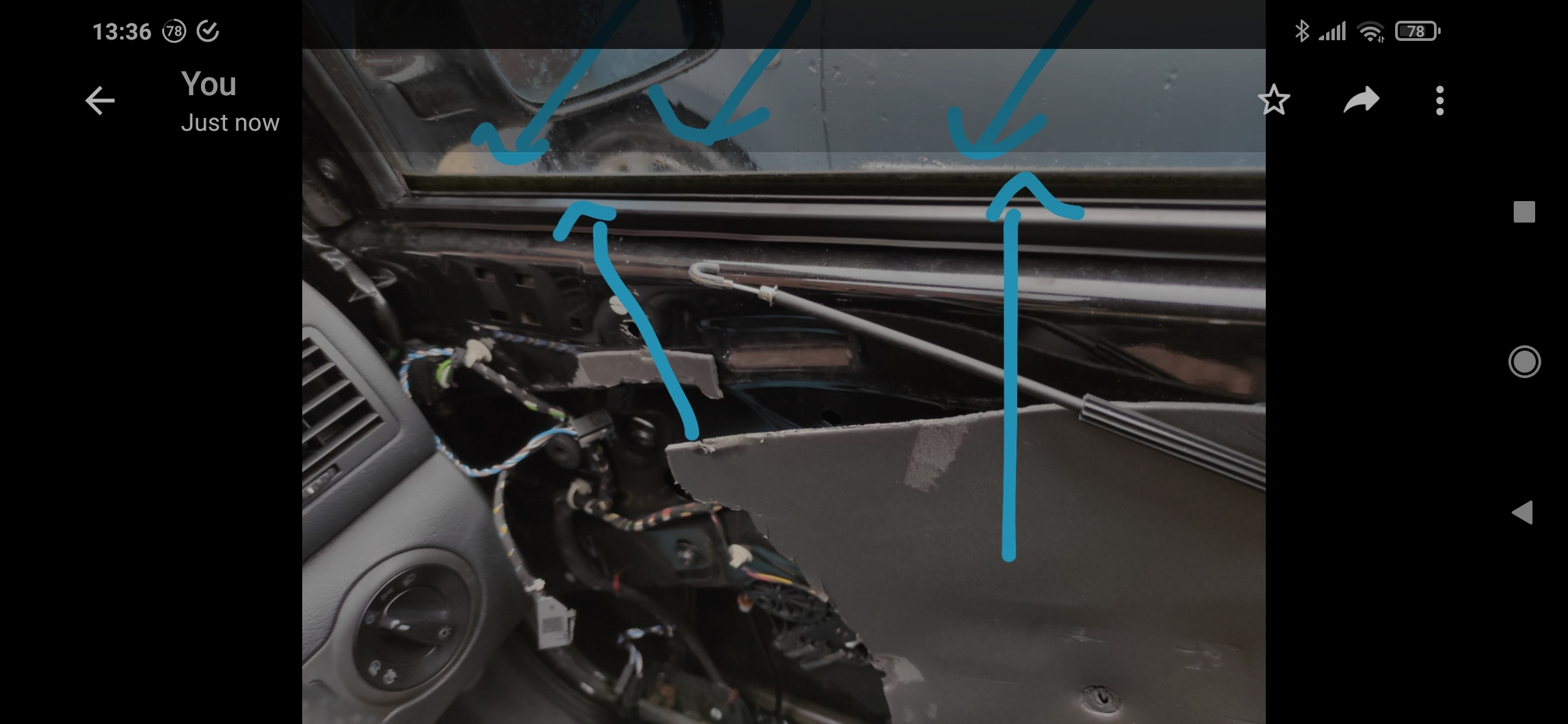

  8. So it's been mega slow progress, starter, spring and mounts are all sorted. Only the leaking door to go, the heavy rain forced my hand yesterday with this one. I still need to line the door, but I was able to see where the water was coming from inside the door, looks like the seal on the outside between the car body and the bottom of the window is just letting water pour in. Trying to find replacement part numbers for that with little joy at the moment. The bottom door seal is letting water in eventually but I still think it's doing a decent enough job to not be the main cause. Thinking replace the external one described and see how it goes then.

  11. For anyone that's used the plastic sheeting DIY method, how did you handle the speaker side of the door? Presume it's just a case of allowing a bit of slack? Talking about where the foam ones are concave to allow for the depth of the speaker.
  12. I was under the impression that was by design? Are there part numbers available for the seals or are we now stuck with third party OEM ones?
