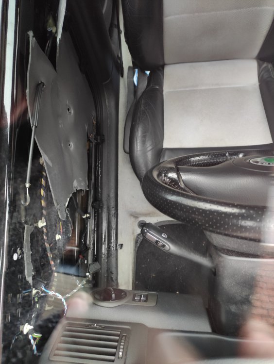

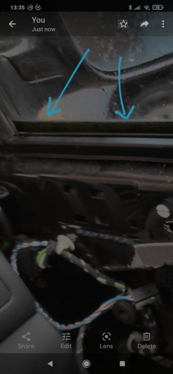

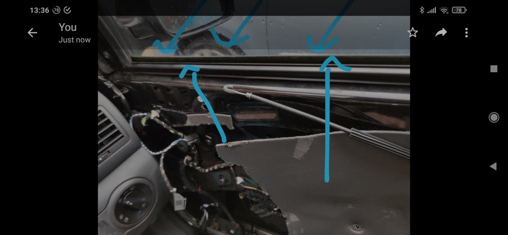

Loved reading this thread @DeanVRS20VT. Got things dried out and have managed to get time to strip the door down. There was more of the panel film there than I thought there would be, but it was torn in two. The window regulator was swapped out last year and as you can see from some of the photos with blue arrows there is wet that's caused some of that replacement to corrode. The cable near the red cable tie with the blue arrow was wet, and to the right of it I appear to be missing a clip. I'm going to see if I can get replacements, not convinced sealing it up will make much of a difference though. Suppose the best approach would be to seal it then put a hose on the car before I reassemble the door? Only other thing I wasn't sure on was whether there should have been something in the hole toward the top of the door where the arrow is.
