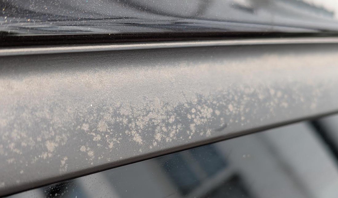

  2. Hi all, does anyone have any ideas on how to repair/fix the weird mottling on the rear windows on the Octavia Estate? It looks like it was most likely sun damage after a product was applied perhaps. I presume the only remedial action is a bit of a cutting compound to even the surface? I've tried a few products for rubber and plastic care but apart from hiding it in a greasy film it never fully resolves it. Cheers!
