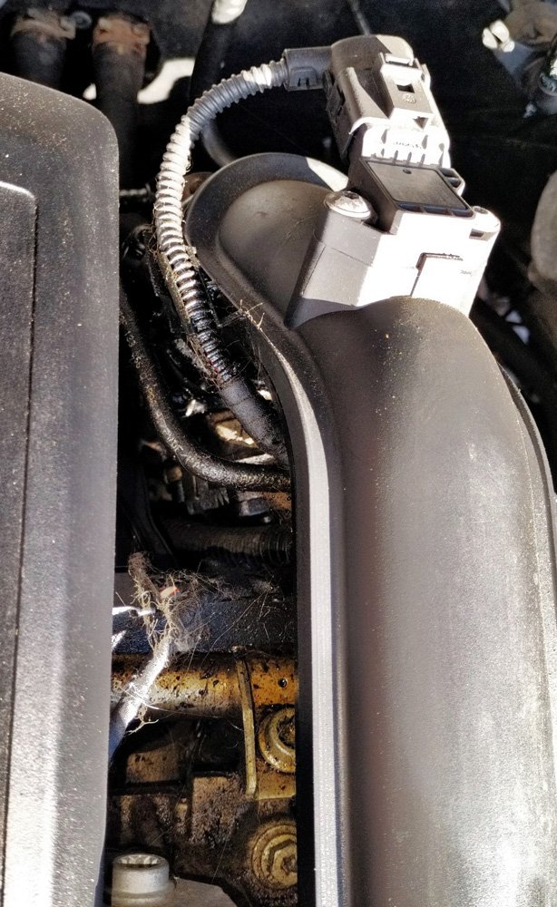

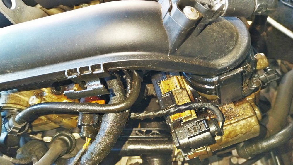

  6. Well, it is solved by 90%, but I still smell a bit once in a while especially when standing and then going - i.e. surely fumes from my car. So, I checked the engine and I found this: Clearly it deposits itself and then burn and smell! Fuel?

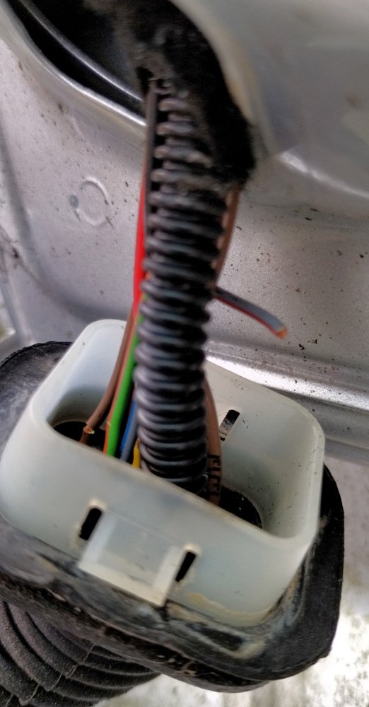

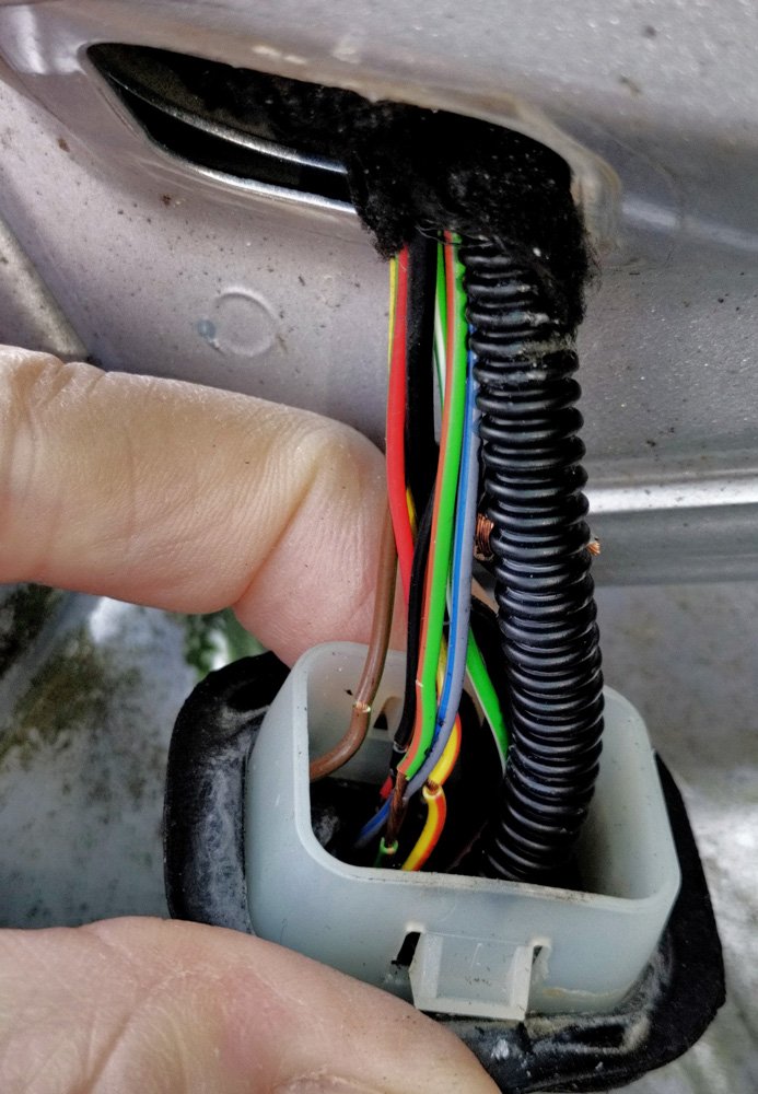

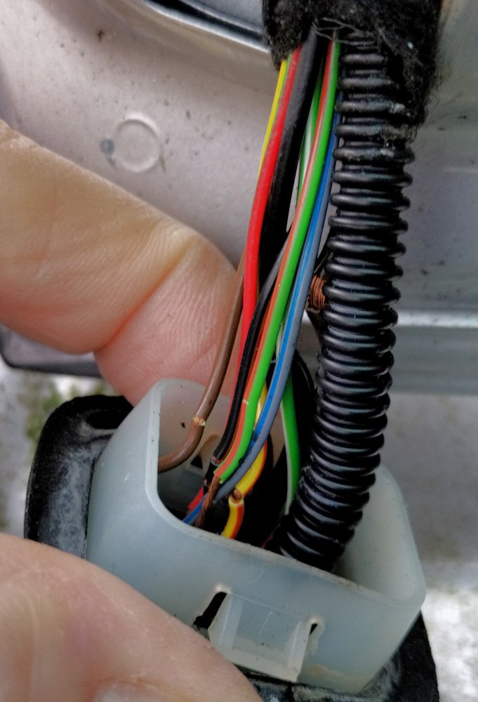

  9. [SOLVED] Yep, did open that cabling boot - although officially called grommet (wrong word) and I obviously found what expected. Right side License Plate light wires both snapper and several others - including two large ones (I suppose for the electrical lock). Insulated them all first, then added a 5-6cm long extension and re-soldered the light wires - all works fine now.
