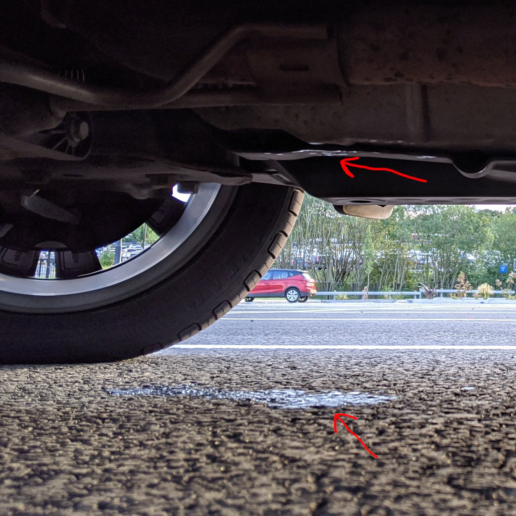

  1. Got back to the car this evening to find a puddle of liquid. Checked, it's definitely just water so not super worried. But I am curious where it could have come from. It was further back than the engine - approx under the driver's footwell. Our car is an L&K with the pano roof - would this be drain water?
  2. If you don't mind sharing, where are the drain points, what do they look like and how do you clean them?

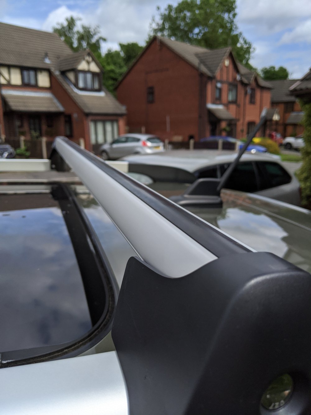

  7. I had the same thing with headlamps for our L&K Yeti. FL xenon lamps are circa £500 each for genuine Skoda items. Bought a Magneti Marelli one from a parts place for £280. Absolutely identical.
  8. Thanks everyone. Managed to work it out. Posting here for anyone in the future wondering... FIrst, use some kind of lubricant. I sprayed the bars and rubber liberally with silicone spray. When trying to push the rubber strip into the track, don't push down - it won't go. The trick is to push from the side, causing the rubber to flex and it just pops in. I've tried to draw some diagrams to make it clearer Don't try and slide the rubber strip in, even with lubrication. You just end up stretching the rubber and shaving bits of it off with the sharp ends of the aluminium Hope that's helpful to someone in the future!
  9. Yes, that kind of thing. Trying to slide it in from one end is hard and stretches it which doesn't seem ideal. But it's also too stiff to just push into place.
