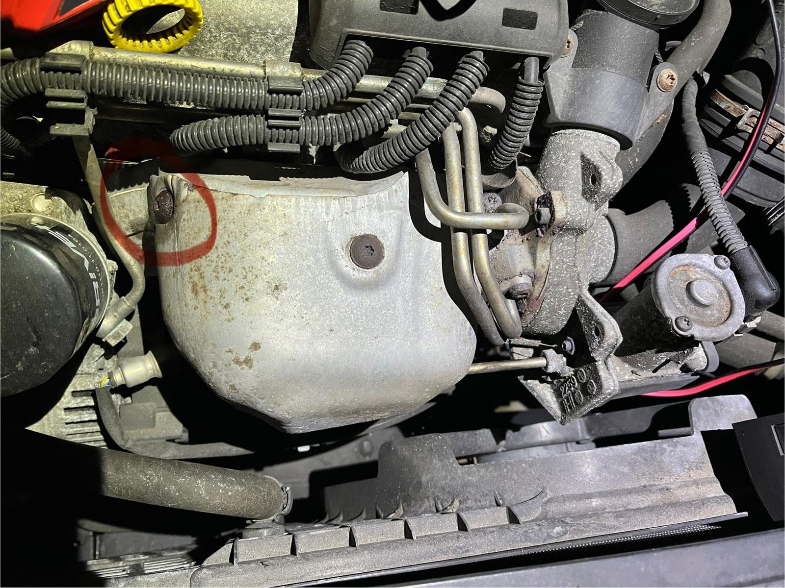

Thank you for the replies gents. Firstly apologies I've posted this in the wrong section of the forum, it is a 2013 MK II. I had a decent battery charger and left that on it overnight, battery was good and holding charge this morn. tried to free the arm up using mole grips to grab the arm and move it left and right, seem to get looser but kept getting stuck when it retracted. cleared the codes and when for a drive, was ok for 3-4 miles but then throw EPC light when accelerating past 2k revs. I'd put some wd40 on the bolts of the heat shield early morning so went back home to have another go at removing. Eventually after going to buy a diamond T30 bit i managed to get them out! Got the heat shield out the way enough to remove the clip and disconnect the actuator arm. Luckily the waste gate its self was really free and flicked back and forth with the arm detached with no resistance. The actuator its self was really stiff and when retracted took one hell of a tug to pull out again so pretty conclusive that was the faulty part. Getting it out was a nightmare! undid the 2 bolts to pull it out to the right but the part that does through the hole in the mounting bracket sheared off and took lots of patient tapping away to brake to bits and remove trying not to damage the bracket its self. see the video i sent my friend asking for help and advise. Anyway with his help we have now removed it. So now I need another one, found this one which looks slightly different ( aftermarket redesign? ) but hoping its going to fit / work as its the only one i can find that 1-2 days delivery: https://www.ebay.co.uk/itm/315618102782 Its just the top cylinder part that looks a bit different. Hoping if it fits it will work without coding all be it not 100% efficiently so my daughter can use her car when she comes home Thursday. The I guess I need to find someone / somewhere to get the software calibration run. snapped off dammit.mp4

Found it is the turbo actuator, see attached vid, it tries to move but guess not enough. I see you can buy them and it connects via 2 bolts. However the 2nd bolt i tried to undo on the heat-shield that need removing (to disconnect the arm from the turbo) is seized. Don't know how I'm gonna get round that yet. Does anyone know where I could get a new turbo actuator ( think part no is 03F145725G ) on Monday in Southampton area or anywhere with next day delivery ? turbo actuator stuck.mp4
