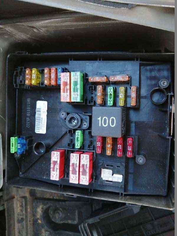

  5. In the following photo its the one with 100 written on it. This is inside the box to the right of the engine.
  6. I had a similar problem with intermittent starting. I replaced the main relay in ignition circuit and have not had the problem since.
