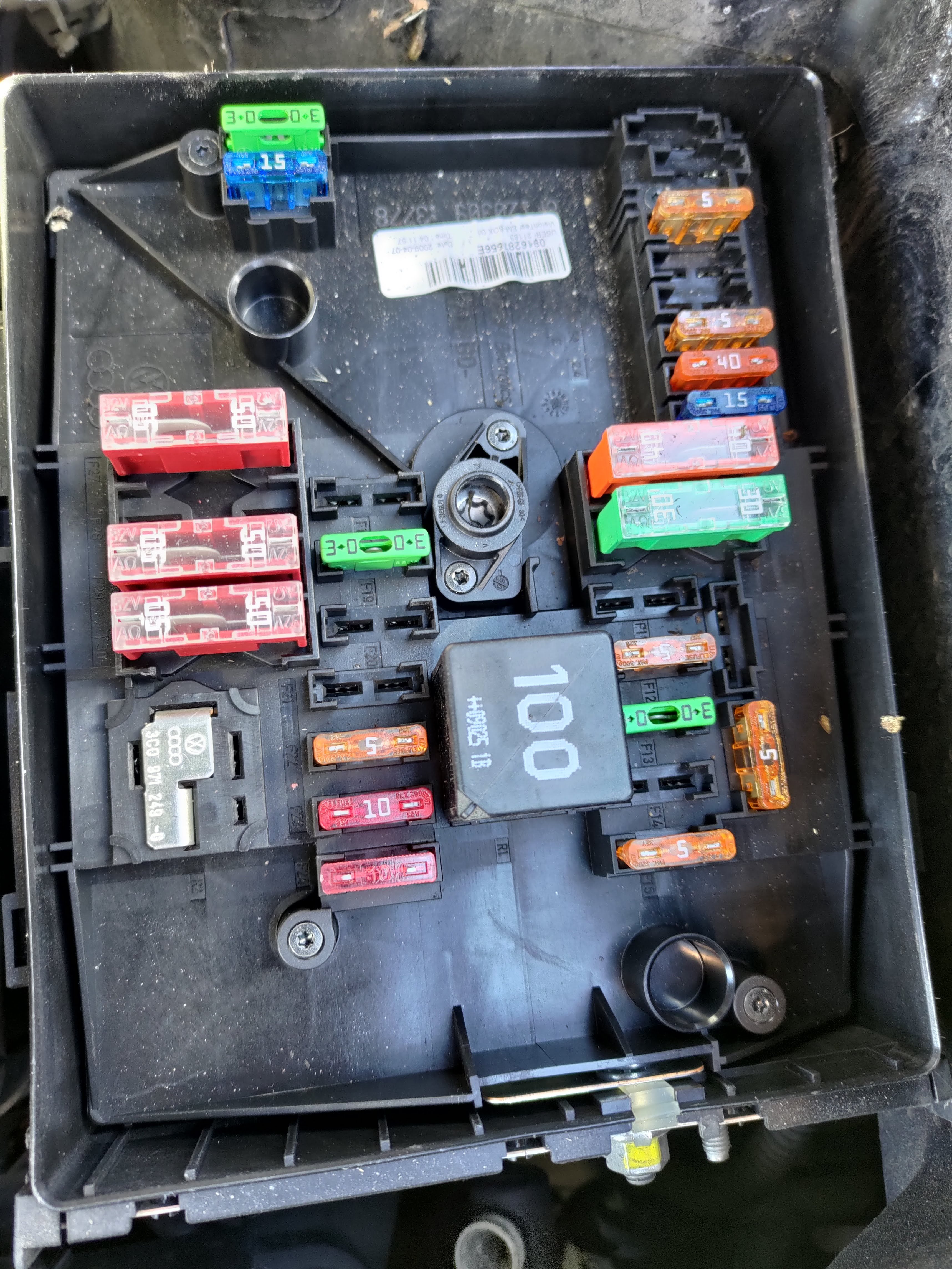

Hi. I have a FL Mk2 2L Diesel. I had that problem where no lights came on on the dash when the key was turned, and the car started briefly and then died. Looking at older posts it seems this is related to the engine bay fuse box - maybe the relay or poor connections on the fuses. After removing and replacing these, the issue was "fixed", but I now don't trust that relay and want to replace it.
Does anyone know where I can get a new replacement quickly please? I need the car this weekend and don't want to be stranded.
It's the big black relay marked 100 on top - see attached image.
Part numbers on the relay are:
AE SN7
95VW 10K705 CA
7MO 951 253 A
V23136-J6-X45
>PA66-GF25<
Is there a Skoda part number I can use to search for?
For info, OBD errors were:
- P157000 - Engine Control Module (ECM) locked
- 00927 - Terminal 30, right: Open circuit
Plus a bunch of "No signal/communication" errors.
Edited by Basirk
59 minutes ago, Basirk said:
95VW 10K705 CA
This is the Skoda/Audi etc part number. It is used as an ECU relay and also another for the fuel pump and perhaps in other places too.
Search this part number on-line and you will find it - and also many second-hand relays.
Thanks!
Will get one ordered.
I replaced mine with a Hella 4RA 007.507-051 several years ago.
