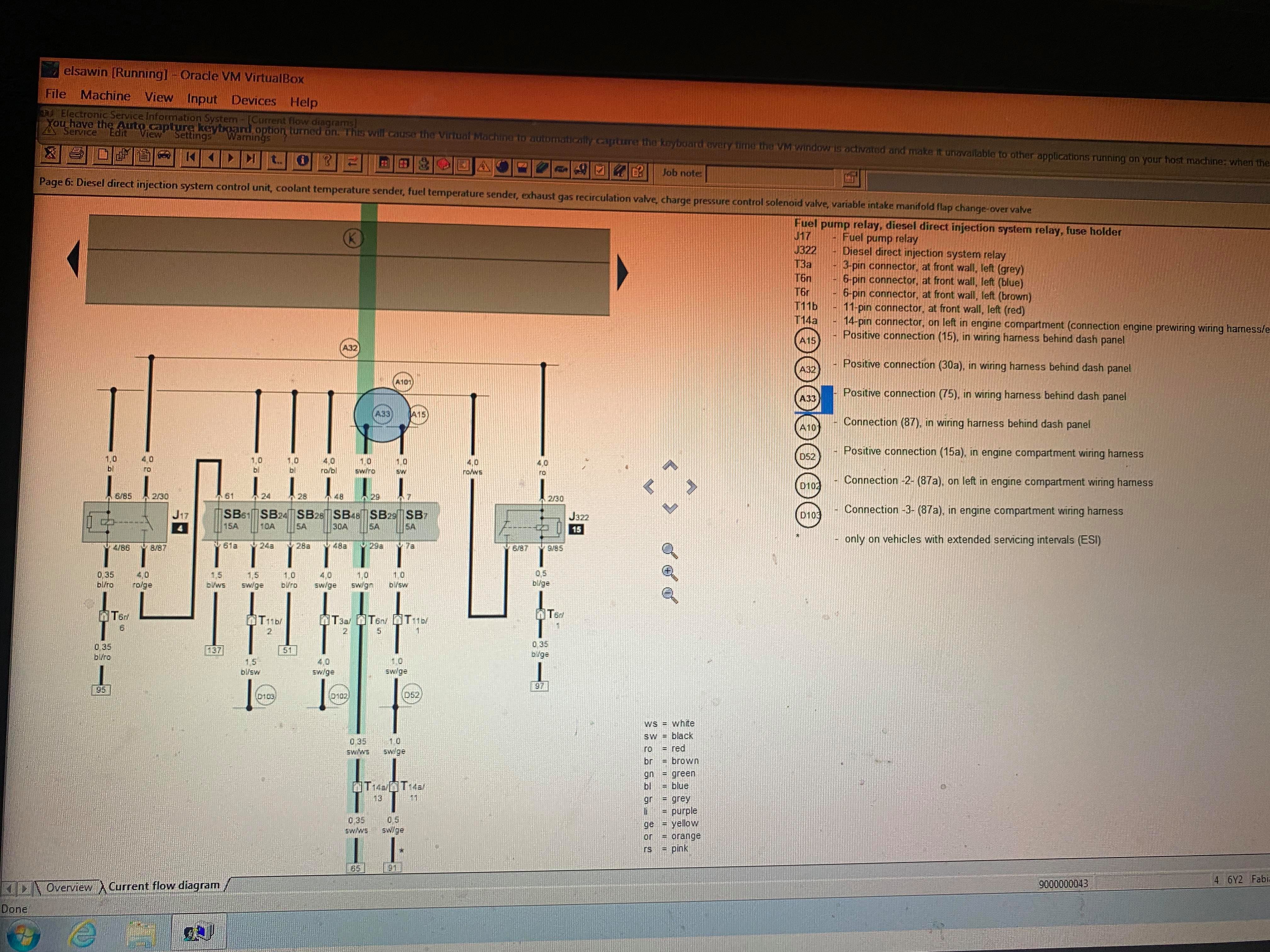

  1. Does anyone know where or what Positive connector (75) is? Its said to be located in the wiring harness in the dash of my fabia vrs - On the diagram its marked as a a33
  2. Hi all, Looking further into my speedometer issue... Ive realised there was a single black and white wire that went to pin 88 on the ECU (on the the smaller ecu connector). Looking on elsawin, this seems to go to SB29 which is a 5a fuse, and then to A33 which is the positive connection (73) in wiring harness behind dash panel. Would anyone happen to know what this pin is for on the ECU... Should probably mention its a 2004 vrs with ASZ engine.
