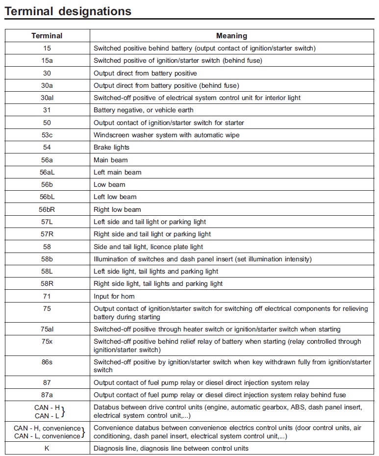

Does anyone know where or what Positive connector (75) is?
Its said to be located in the wiring harness in the dash of my fabia vrs - On the diagram its marked as a a33
