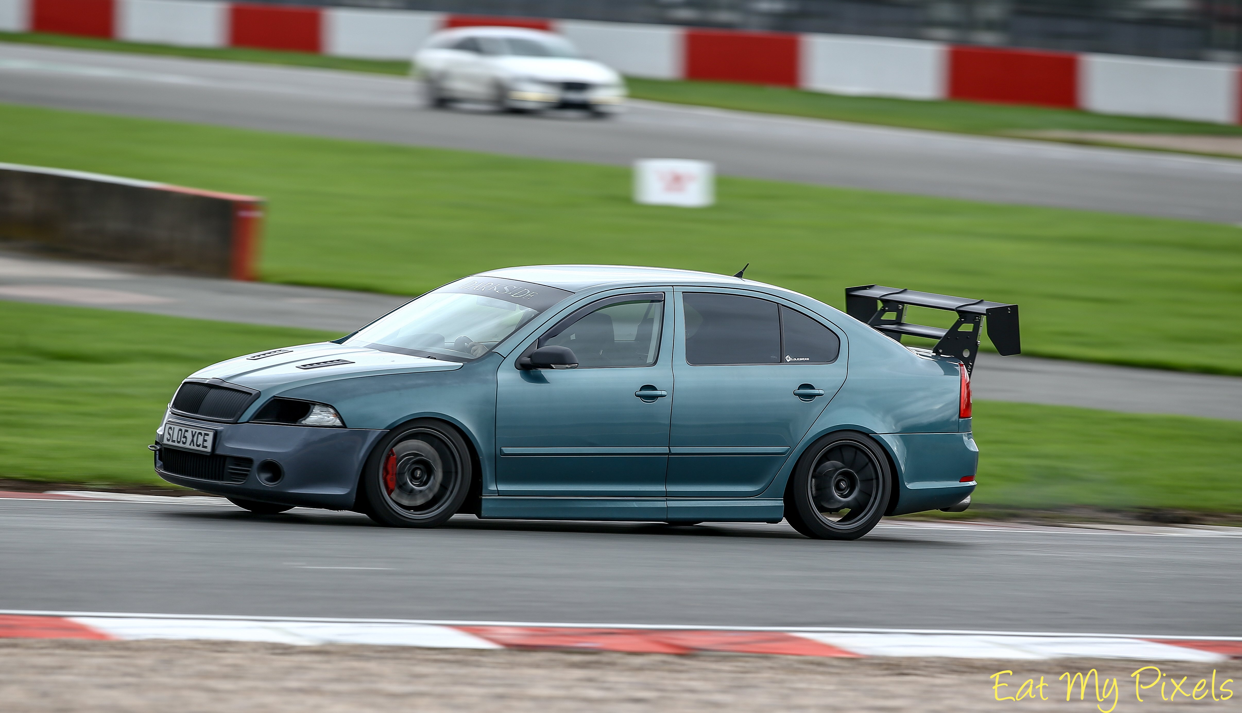

  4. Track day successful. Didn't blow up or slide off. But got black flagged on the first outing for being too loud.
