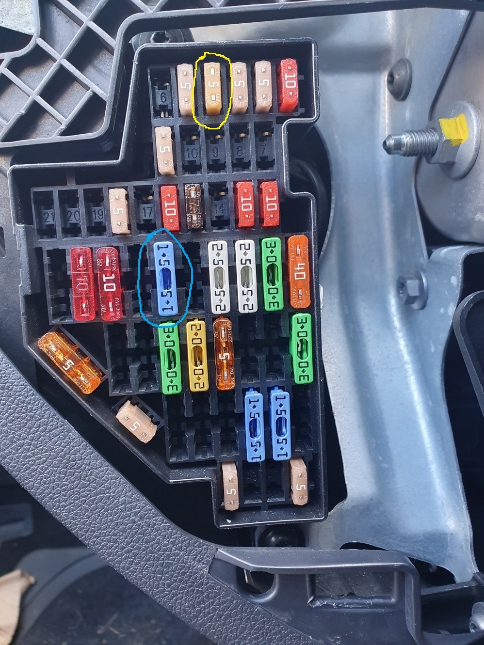

  4. All sorted. Shorting wire caused battery to run down so no start. Charged battery, traced short to air con sensor. Disconnected air con sensor and no4 fuse now operating correctly. Will check oil sensor at next service. Thanks for all the advice.

  6. thanks for prompt response. Fuse diagram attached. No 4 fuse, circled yellow, is Heating, Air conditioning, Electrically adjustable seats No 27, circled blue, is fuel pump relay. I was paranoid about the no27 fuse being in the wrong place but I think it is in the right place. The "socket" next to it has no connections. The fuse is OK by the way. Just been to car. Started but cut out immediately. Weirdly both radiator fans came on when I switched on the ignition. I have no indicators, side or headlamps. It does make me think I have major wiring problem somewhere.
  7. 2005 Octavia Laurin Klement 2.0PD 283,000 miles. Problem - Car will not run. Car starts but then cuts out immediately. No warning lights working whatsover on on the dashboard. History - Last week - Engine Oil Sensor workshop light. No reversing sensors. Took to local garage and put on diagnostic and read Oil sensor open circuit. Thought could be sensor itself or wiring loom problem. Drove home. Reasoning being that oil level is fine, car running OK therefore chase problem when oil is due to be changed as would need to drain to change oil sensor. Today I thought I would check all fuses. The 5 amp no4 fuse keeps blowing. (circled in yellow.) I took fuses out one at a time and replaced hopefully back in the same position! (Is 15 amp blue in correct position?) It is Saturday, my garage is shut and I can't drive it anyway to get checked anyway. I am with SilverKnight home rescue but thought I would ask on here first. Any ideas from the collective knowledge?
