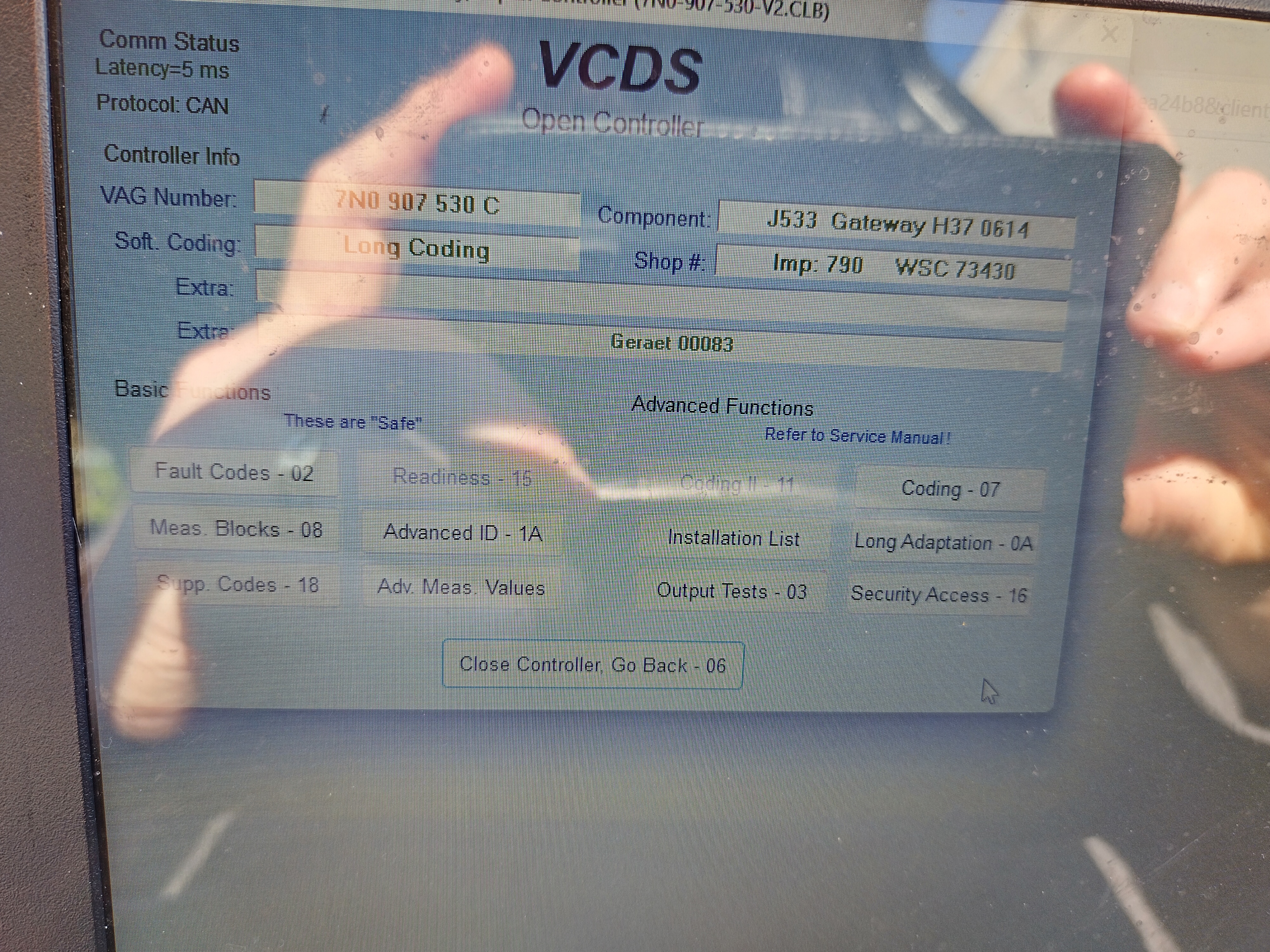

  3. @varooom just had a look at VCDS on my car, trying to follow the battery coding info. I do not have 10 Adaption listed when I go into the 19 Canbus option, and can see no obvious way to code for battery change..

  10. I have used bike racks that hook over all four sides of the tailgate and never had an issue with damage to the glass as the metal parts that would touch the glass normally have inch plus thick rubber pads around them. Have had three bikes on one of these. You can adjust the vertical straps to keep the bike away from the number plate as needed.
