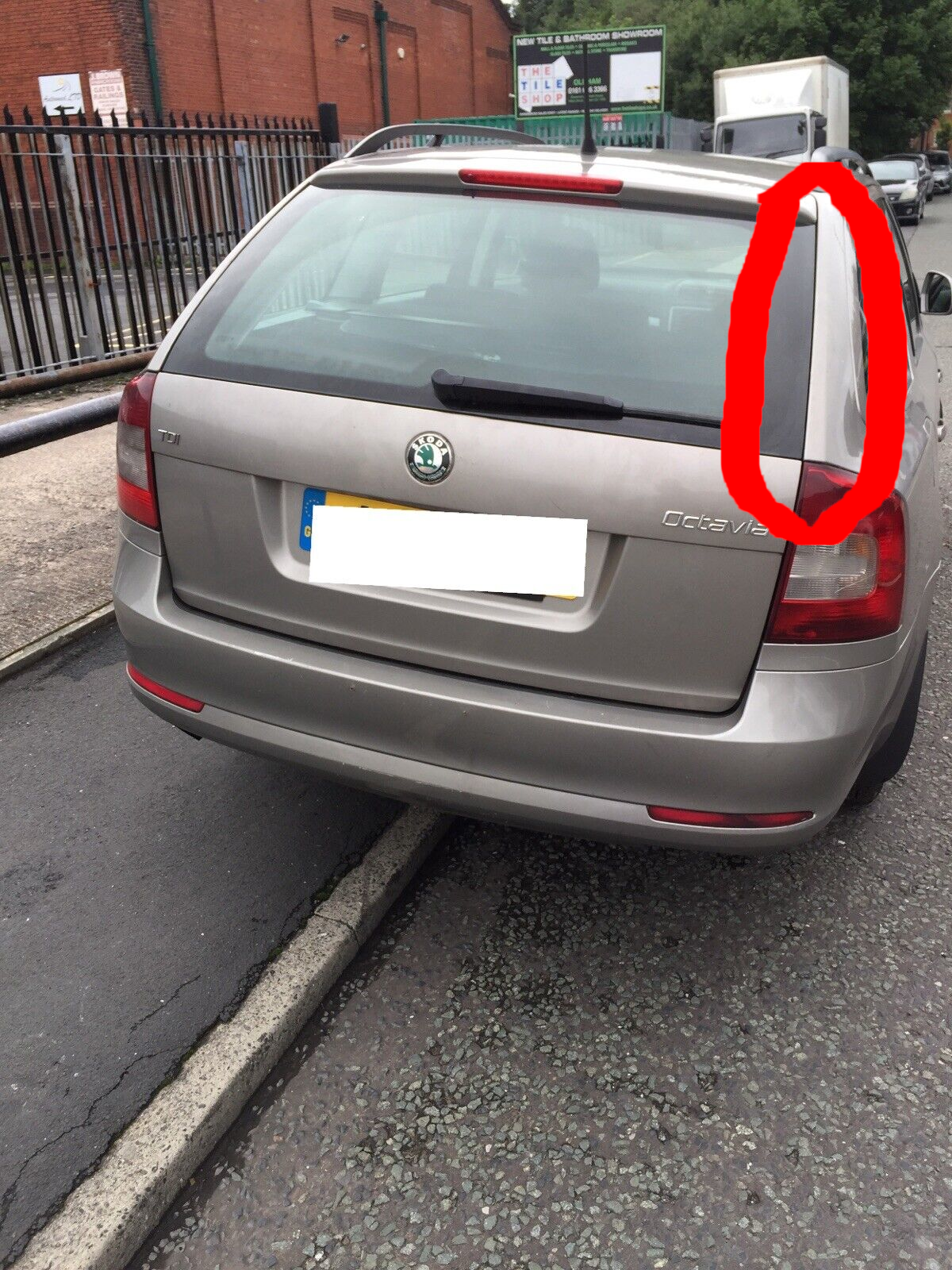

My concern is that some of the cheaper kits require a mounting strap around halfway up the rear glass. As the estate boot lid is just glass here (and not metal) I'm concerned it'll damage the glass (or shatter it). See generic image of an Octavia with a highlight (not my actual car but the same model).

I have used bike racks that hook over all four sides of the tailgate and never had an issue with damage to the glass as the metal parts that would touch the glass normally have inch plus thick rubber pads around them. Have had three bikes on one of these. You can adjust the vertical straps to keep the bike away from the number plate as needed.
Yes, really don't think you will have a problem with the glass .........
Think how some of these tailgates get slammed shut, maybe some folk wishing someones head was in there, Lol.

the outway looks pretty well engineered. I would also be worried about other solutions that requires tensioning at the side glass overhang. There’s very little room in that closing gap for one. Secondly tensioning against the glass lip overhang could end in disappointment. Glass may be relatively strong to lean on or place a load on, spread out,  but pulling at its edge, on a overhang,  wouldn’t be what I’d want to do.

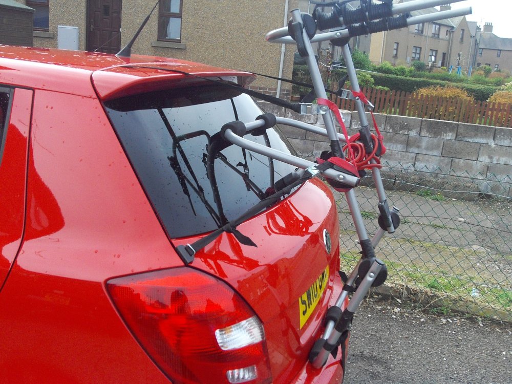

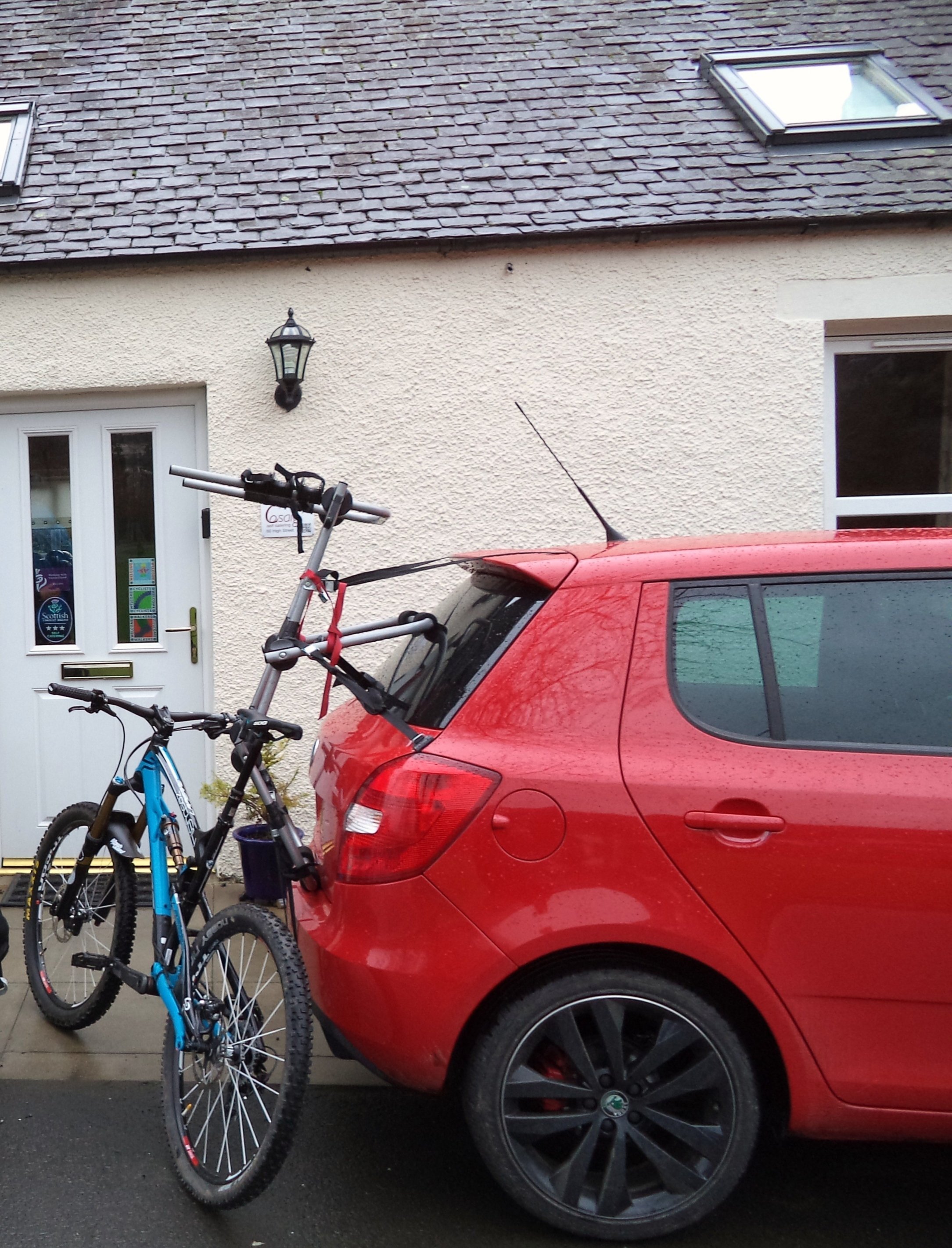

You need to have the rack set with as much weight supported on the bumper and the roof and the clamps to the glass are for sideways movement, then you need helicopter tape on the glass.
The bikes are then too high really IME.
