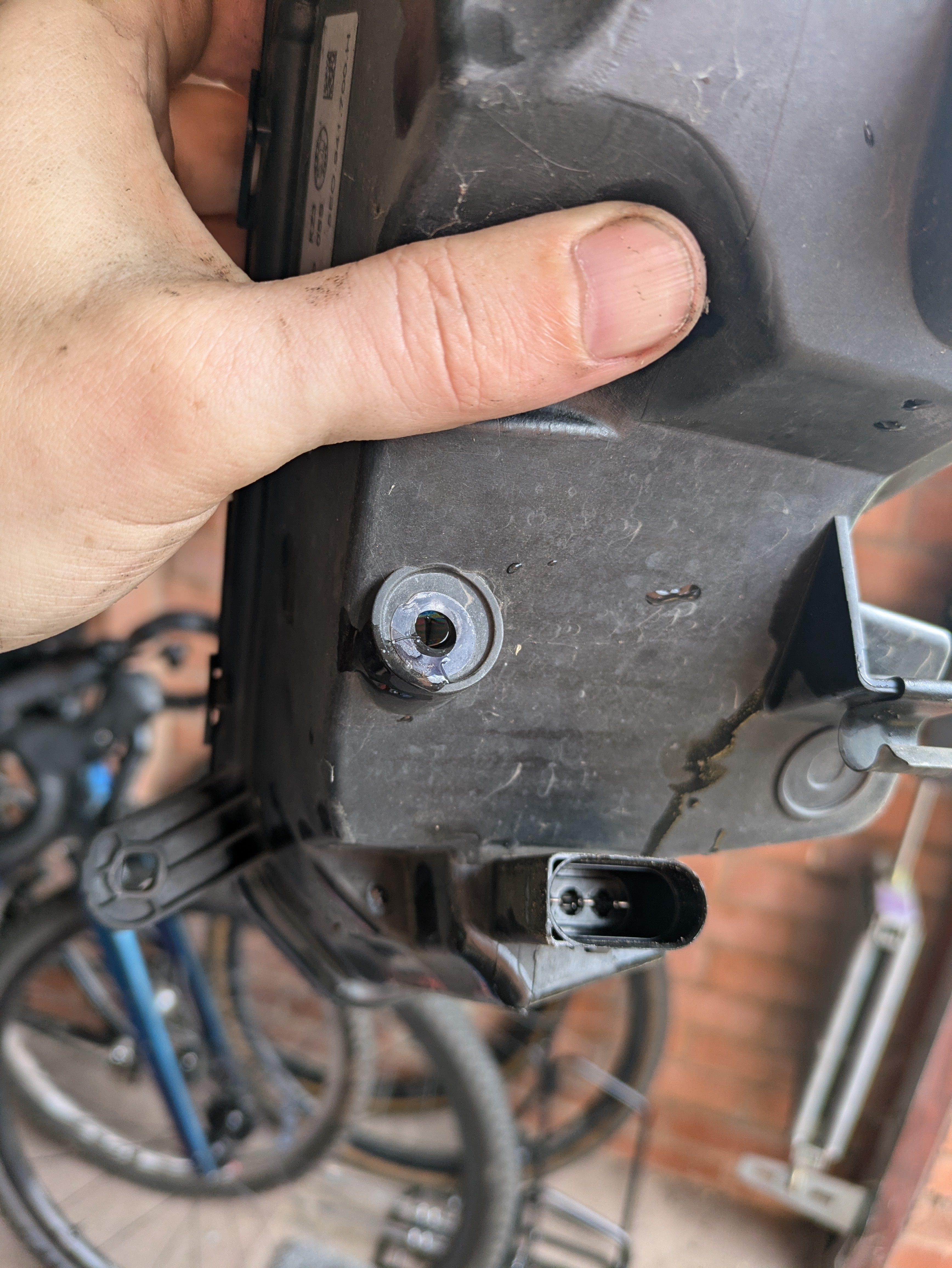

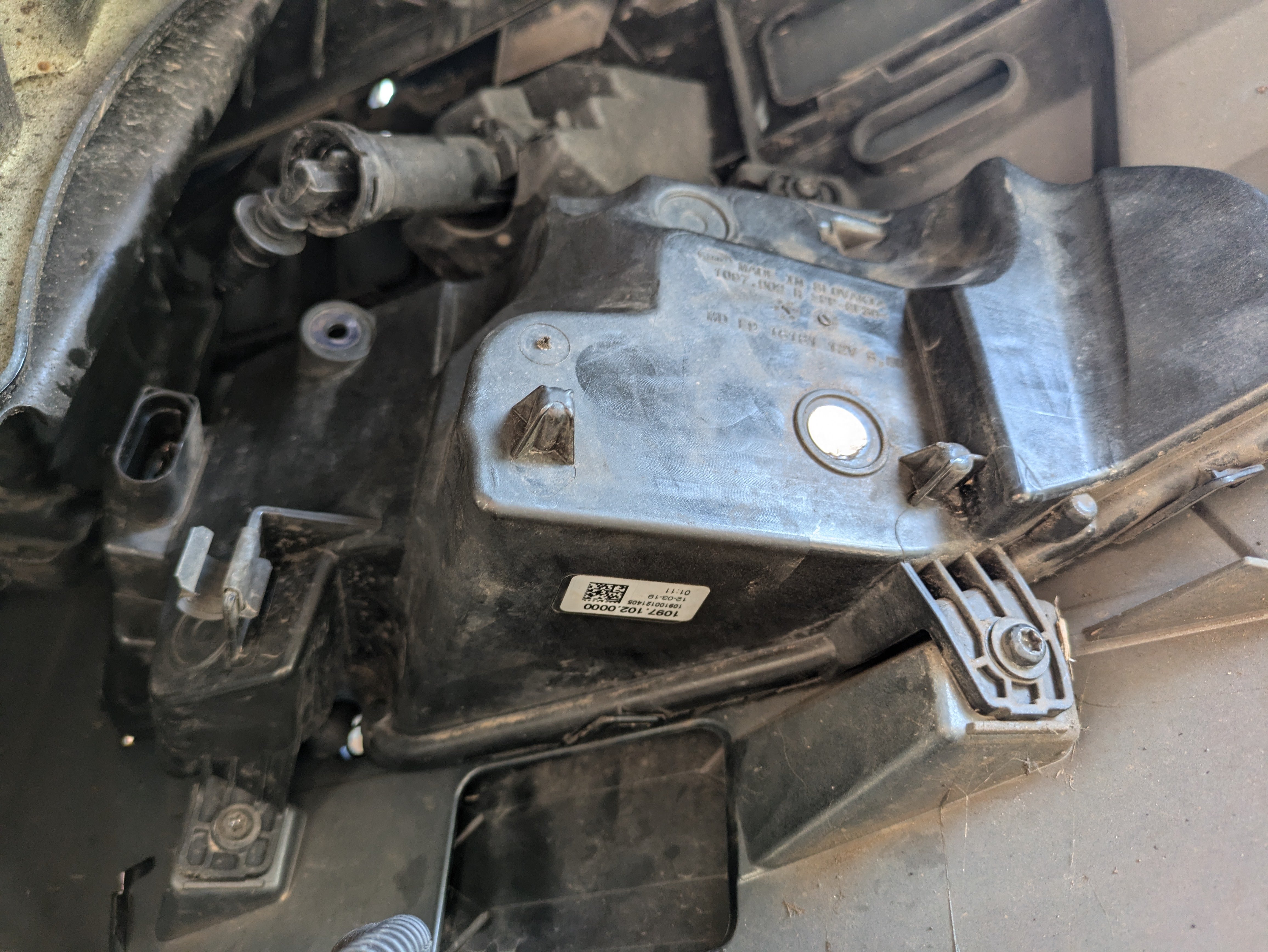

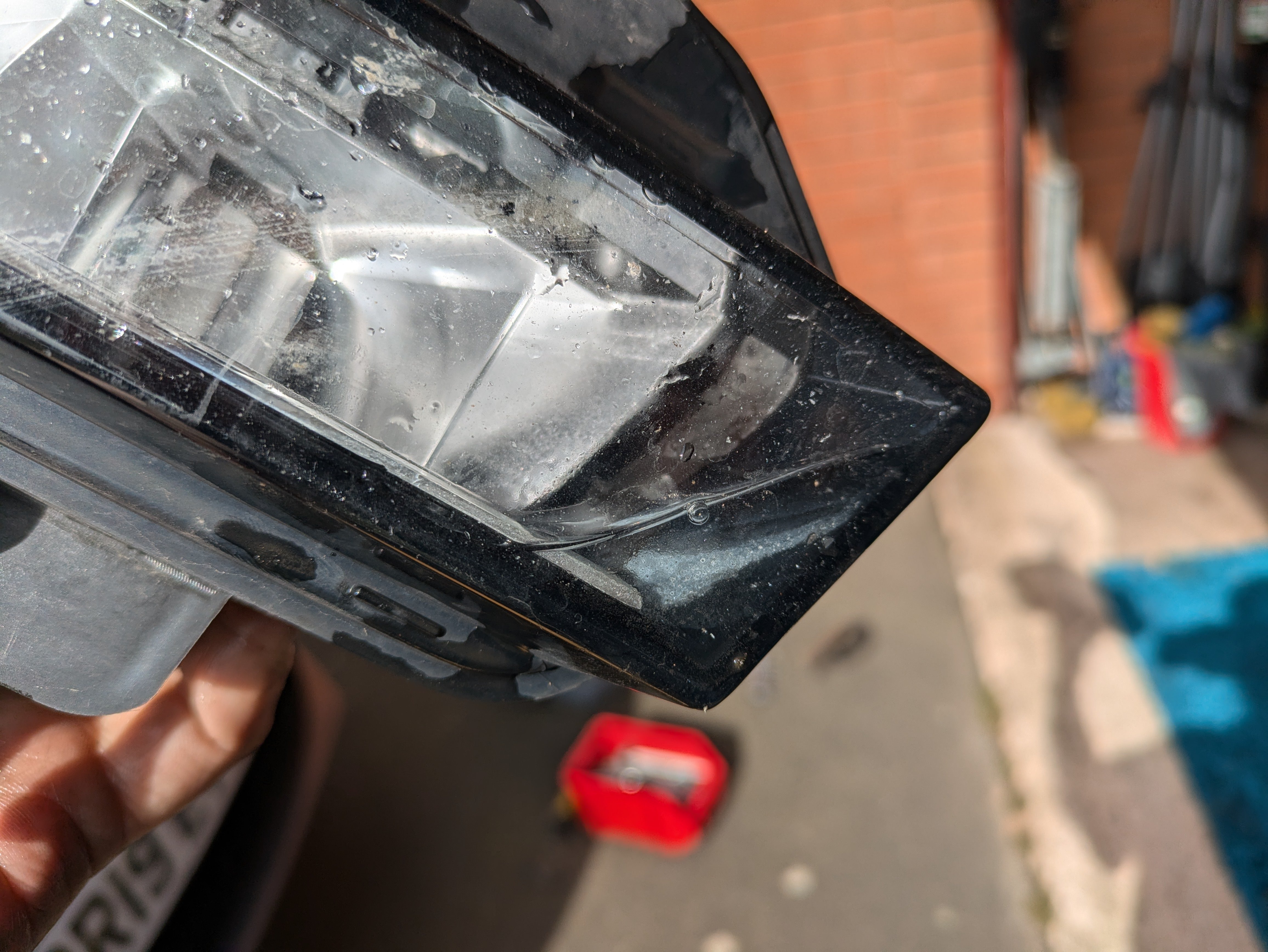

  1. I fixed this today. The light comes off from behind the bumper skin. It's actually pretty easy to do. You just need a T25 screwdriver. Raise the front end. Take the wheel arch liner off and you can easily access the 4 screws from behind. You'll need to unclip the headlight washer jet water feed and it'll pour washer water all over you. Mine had loads of water in and apparently a missing breathable seal near the top. I just kept on moving it around to get the water to run out of the hole for ages. It shouldn't need to get bone dry and I've parked it in the sun to dry the rest out.

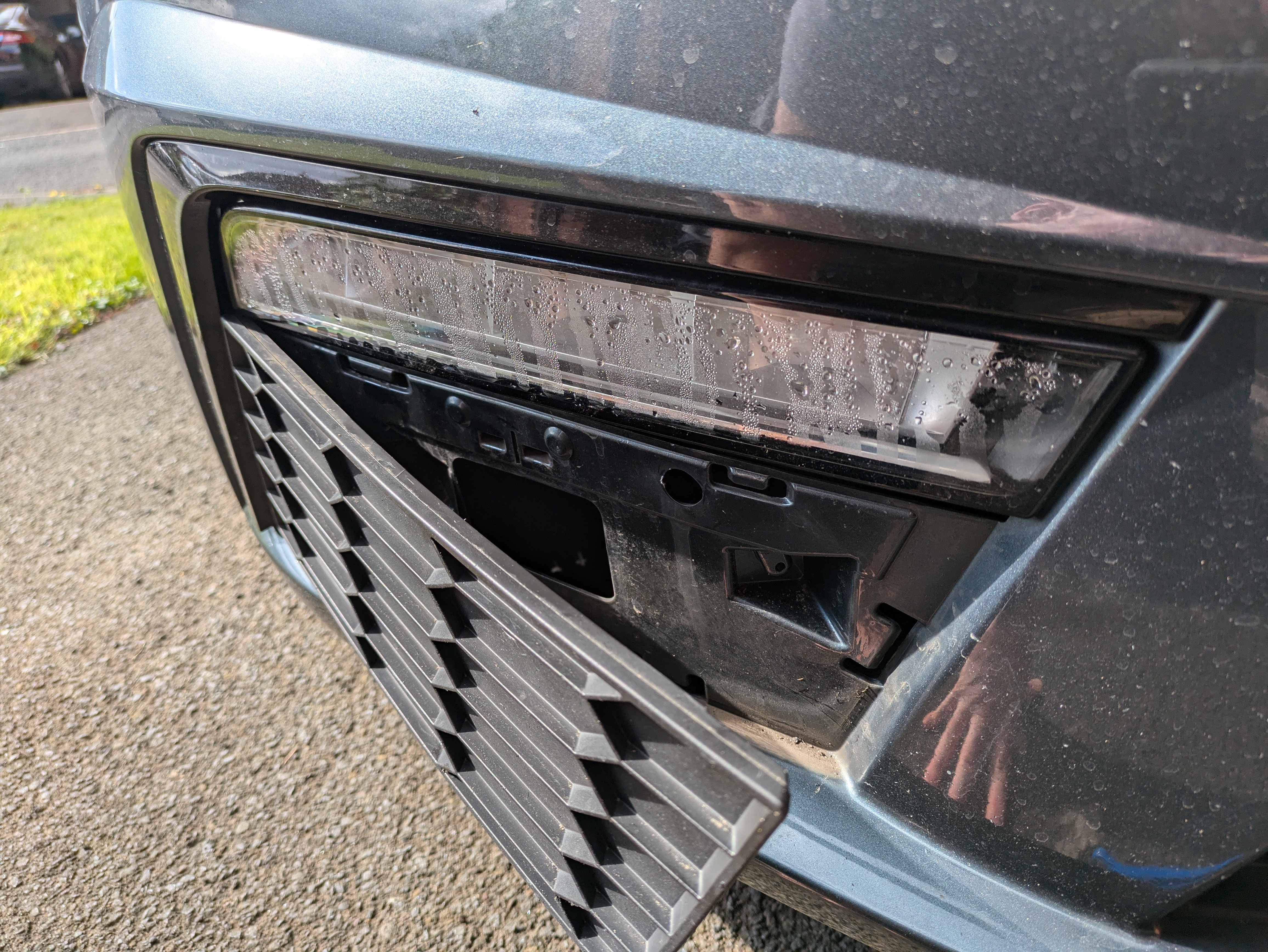

  2. For anyone finding this, it can be unclipped but it's pointless because you can't get to anything behind. It's in pretty tight too. So to get to the fog light I'll have to get the under engine cover off.

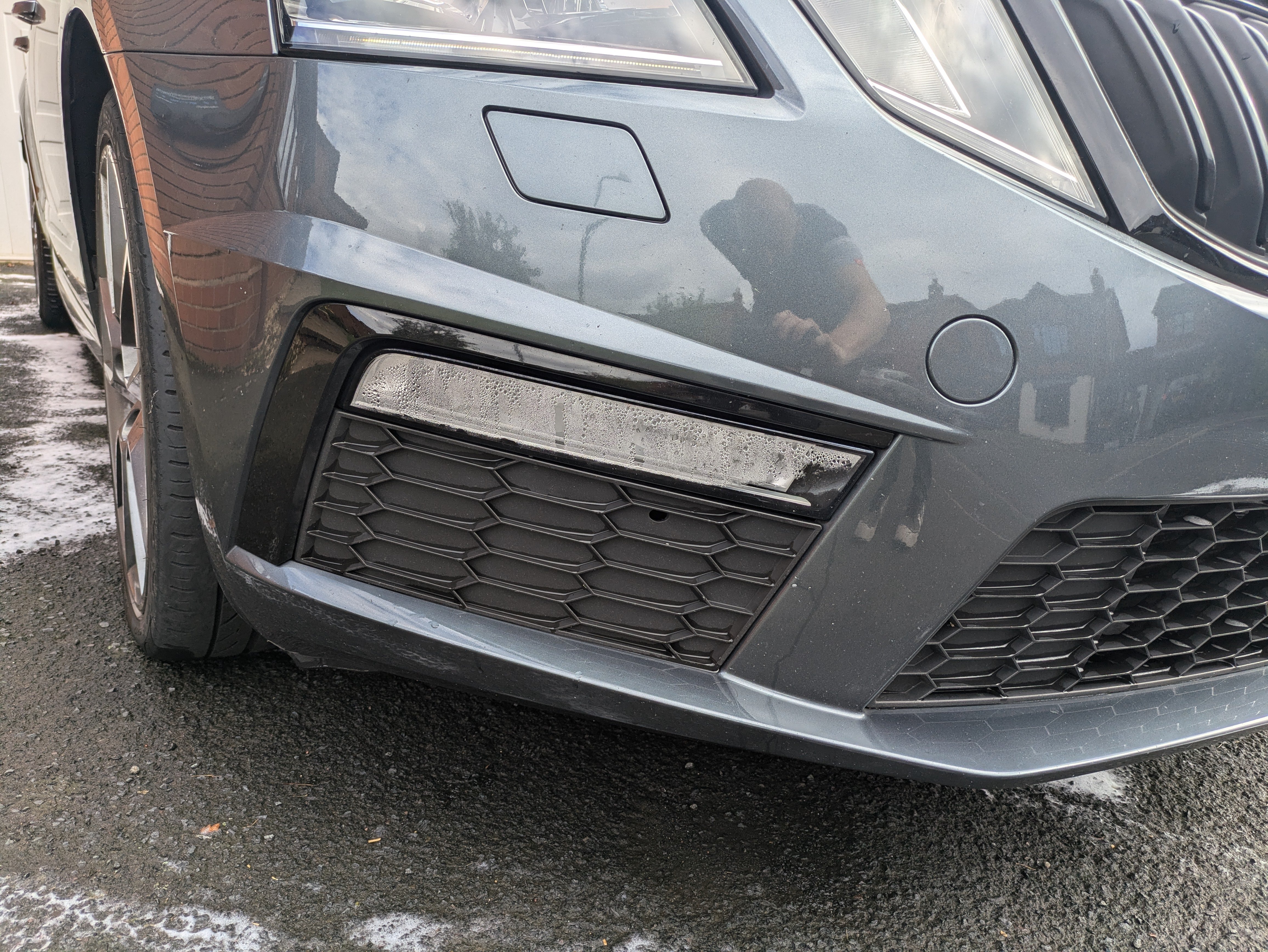

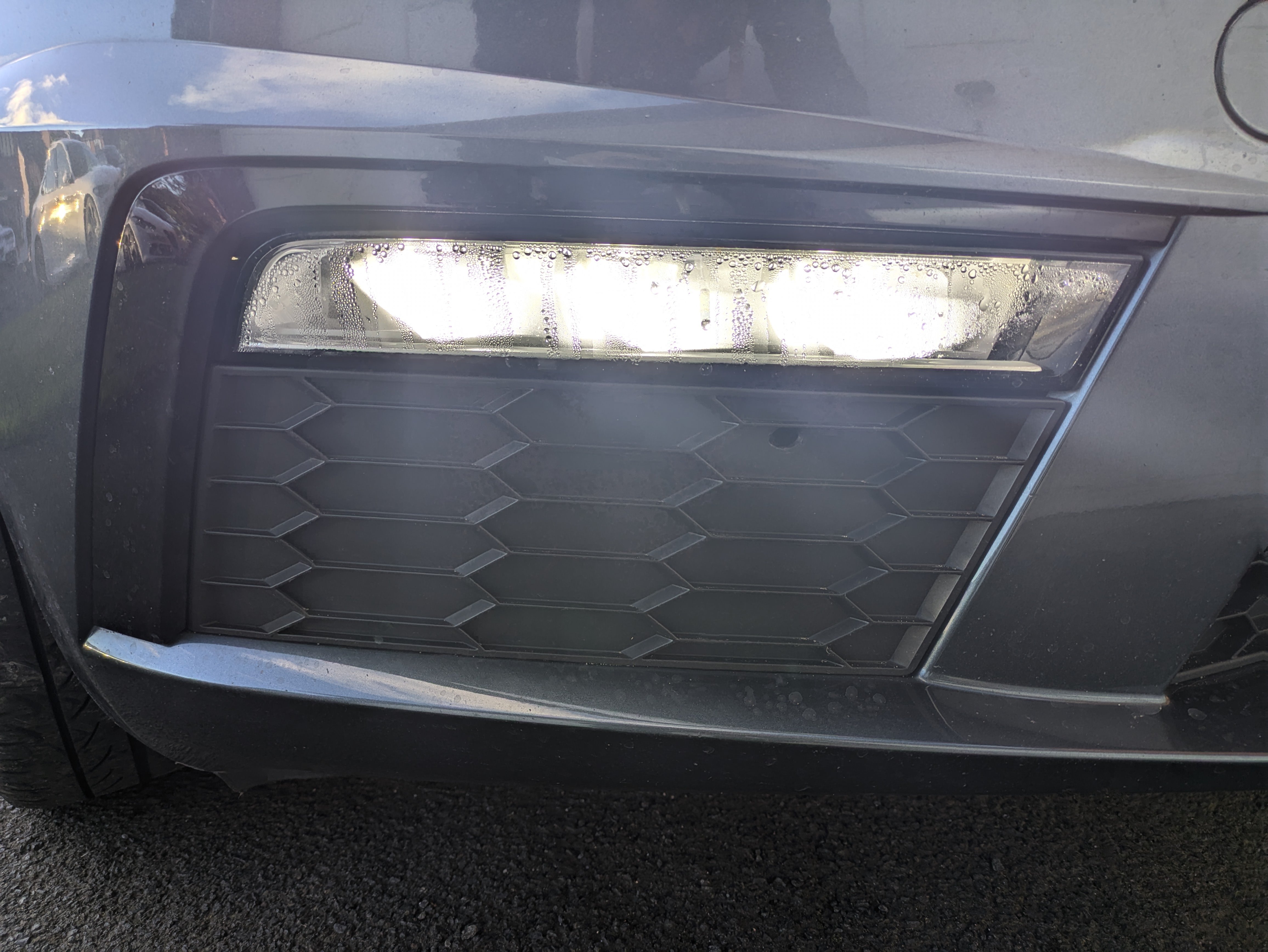

  3. Thanks but I'm not sure mine is either of those? I'll try pulling on the hole anyway.
