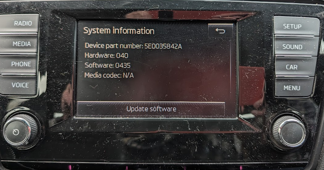

  1. All updated - many thanks. Unfortunately still glitching when playing bluetooth audio. I guess I'll have to go with a aux bluetooth adapter which I've tried and it works fine but no steering wheel controls and no track/artist info.
  2. Hi, this is the FW page (yes, my car needs a clean inside and out!);
  3. Hi, I've enabled developer options and tried pretty much every combo of AVRCP / MAP / Disable Bluetooth A2DP offload, etc and no difference unfortunately.
  4. Hi, my 2014 Octavia vRS is struggling with bluetooth audio since I upgraded my phone from Pixel 8 pro to Pixel 10 pro xl. Bluetooth audio is stuttering. Is there a FW available to help;
