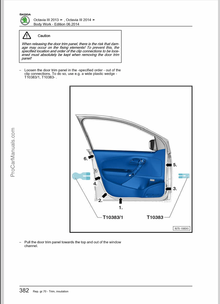

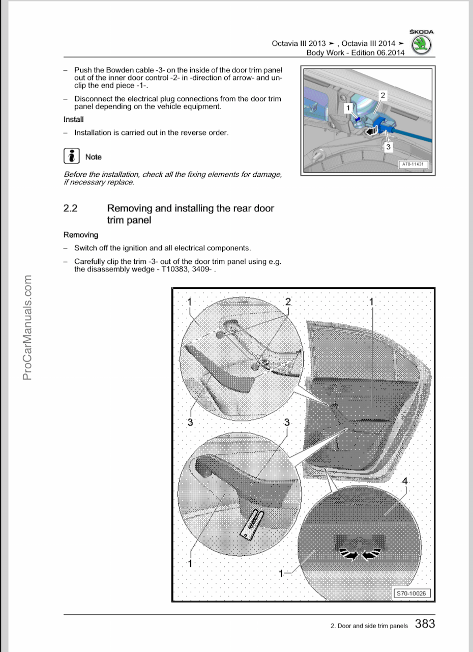

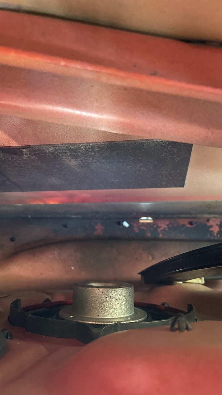

  4. That's a really good point that you make about the warmer weather and I will certainly try to crack on whilst we have some lovely sunshine! I did not break any clips when deadening the doors, but I did purchase a trim removal tool set and this proved invaluable. I also used the steps in the workshop manual (available via a Google search and pasted below) to help me see exactly where the clips on the door cards were located. From memory, the drivers side was more difficult as it had the master window control module to remove which seemed difficult to do without breaking. I also have enclosed a photo of the factory sound deadening - if you can call it that! I was honestly surprised that they thought it was adequate to leave the factory with so little. But then I suppose that VAG must have some differences between the marques. Finally, I thought I would enclose a photo of the area that rattled the most from the lows that the speakers were playing. It was the plastic area I will show below. I actually removed the plastic panel and wrapped the edges with felt tesa tape. That really seemed to improve the seal created between the door panel and the plastic panel and eliminate the remaining rattles after the Dodo deadening was applied. I also removed the module that has connections going in (that you can see in the photo) and tesa taped underneath it, as this also was rattling! I would highly recommend choosing a playlist of songs that you can play once you think you have finished and you can then made sure there are no nasty noises left before you reassemble the door card. I did this, but not well enough! Therefore a week later I had to remove the door card again to chase down a couple of additional rattles that I had not eliminated the first time around. I found the track Ribs by Lorde to be especially demanding of the front door speakers so played this quote loudly with the bass on the head unit EQ set to about +4 to test that I had covered all the rattles and vibrations. I hope this may help and thank you again for the tips on the boot, I'll be trying that very soon!

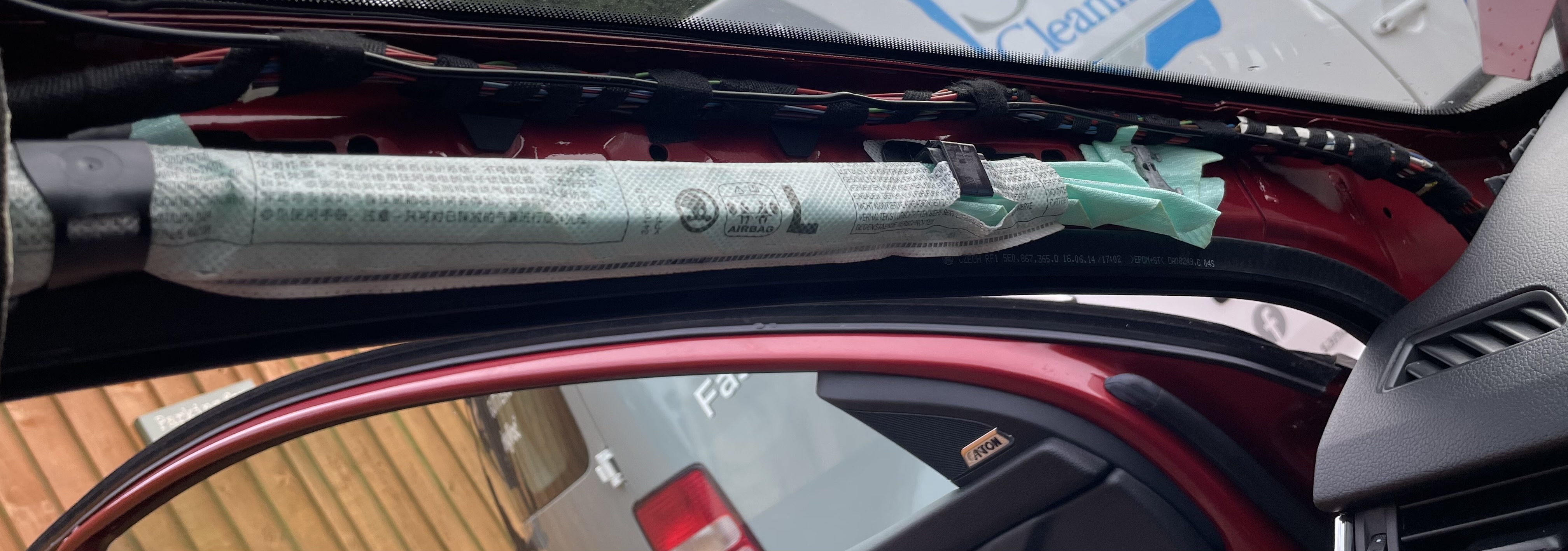

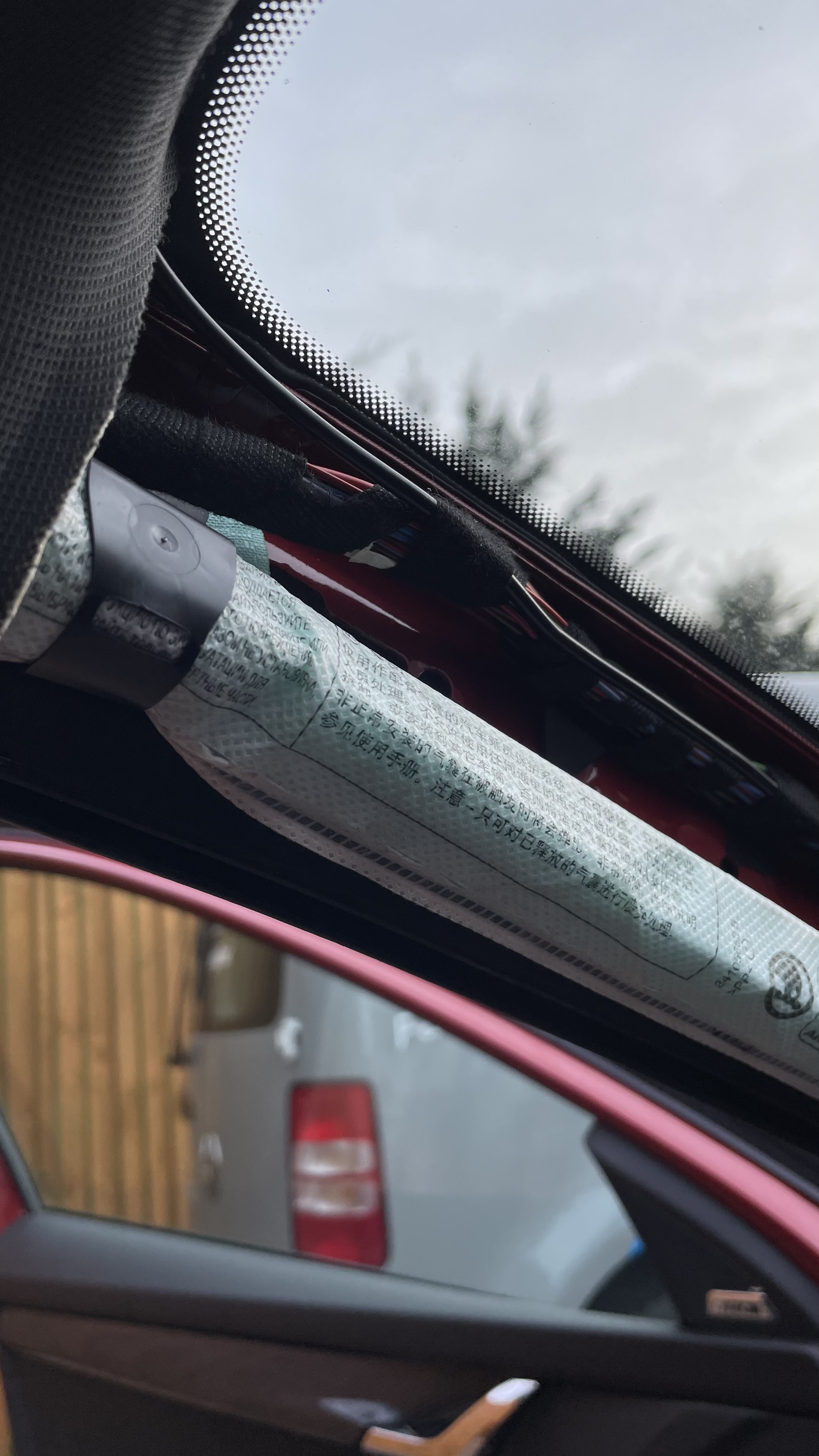

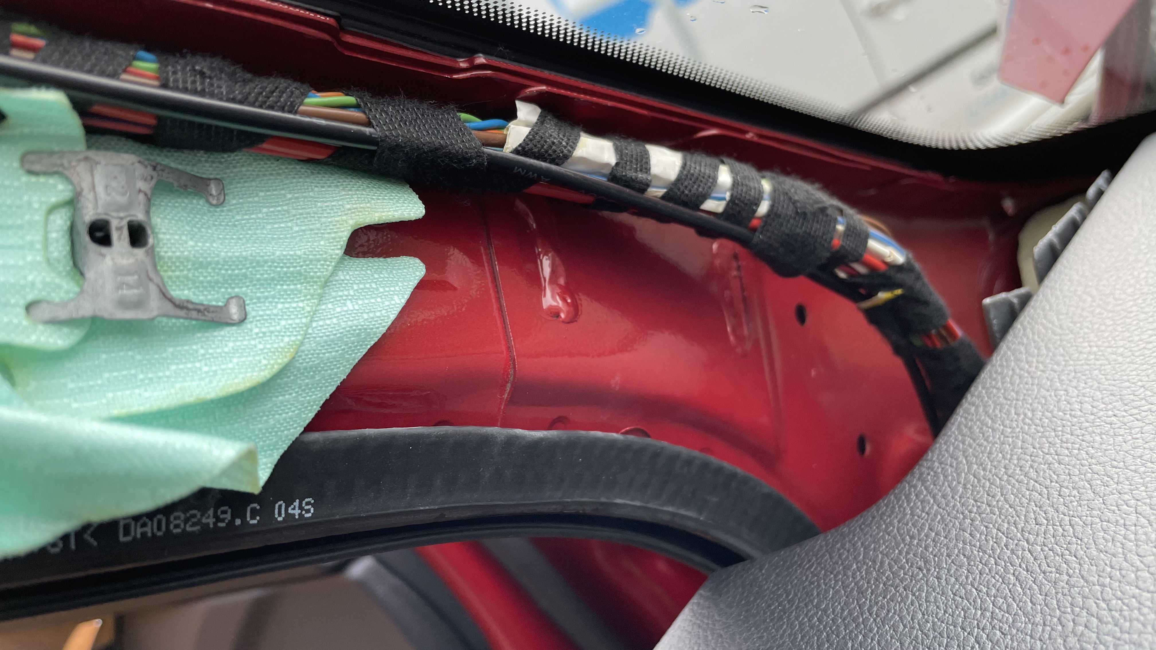

  12. Dear Briskoda forumites, Thank you for all of the fantastic information that I have been able to glean about our new family car already. We are the very happy new owners of our '64 (2014) Octavia 2.0 TSi vRS Hatchback. Purchasing it used, it just "happened" to have an option of a panoramic roof fitted, it wasn't something we were looking for. Reading the issues that many have had about the drainage channels of the panoramic clogging (and a small dribble of water appearing from the bonnet release catch), I decided that these channels needed to be investigated. I poured water down the drainage channels and from my reading on the forum, expected the water to drain to the plenum chamber. However, it actually appeared at the top of the windscreen and made it's way down the side of the windscreen ... I decided to remove the A-pillar to investigate further. The attached images are what I found…. I could not see the green drainage pipes that others unclogged. As I mentioned, our is a '64 plate and I wondered if perhaps there was a design change at some point in the life of the MKIII, or perhaps if it is something to do with being the hatch and not the estate version. Any feedback, ideas or suggestions on the lack of drainage channels would be greatly appreciated. I do have a hardwired dash-cam that I have installed and this is the black cable you may have noticed running alongside the wiring loom in the A pillar. Thank you very much
