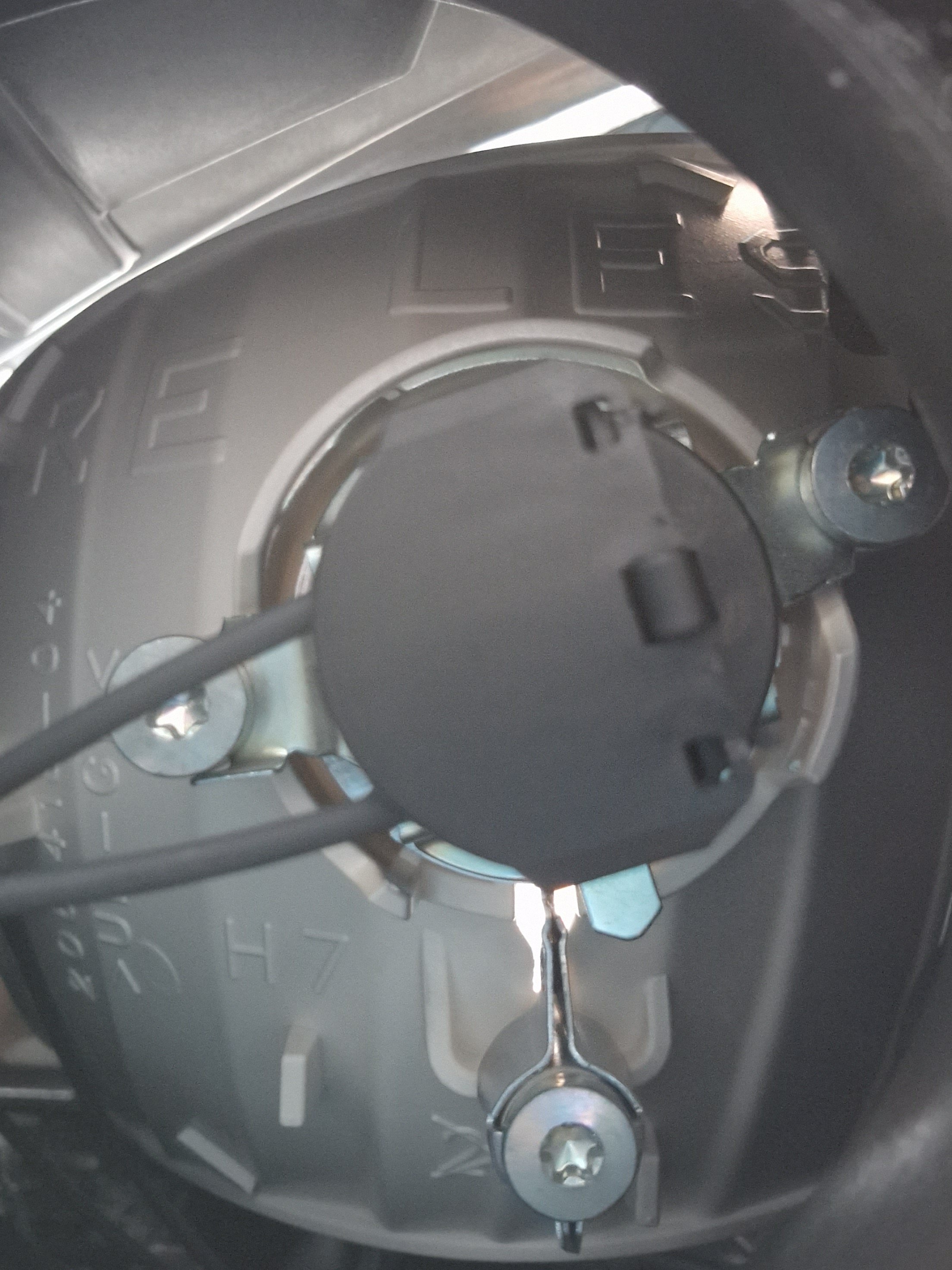

worked it out.. they're just twist in and out. not that it was very easy getting them back in. getting the metal lugs to slide under those torx was hell. a few bits of missing skin. 😞
umm. so i got some nightbreakers today. Went to fit them expecting to have the usual metal clips holding the bulbs and was confronted with what looks like torque or alan key type fittings? Can anyone confirm it's these that need removing and or loosening. I'm slightly concerned about dropping one into the engine bay.
